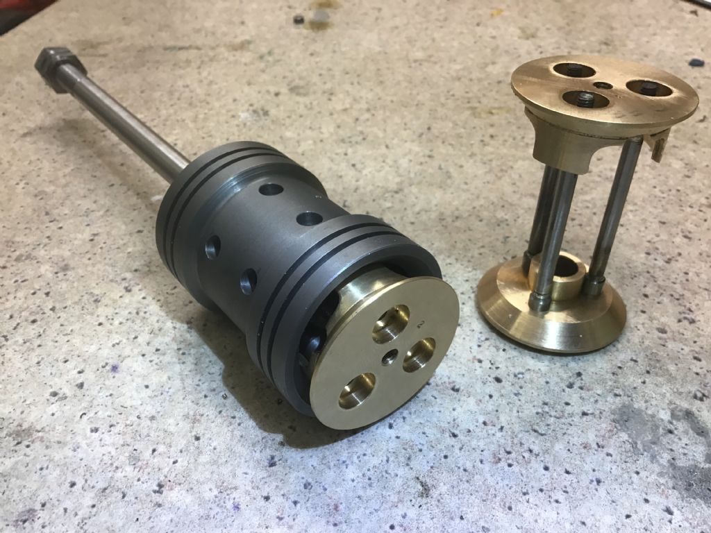

      This is the piston for my uniflow engine which I am remaking, incidentally the full assembly has 23 individual pieces of metal including  the fixings!
      My question is that I want to lap the fine machined valve heads of bronze into the piston body made from cast iron . So which do I get, the type for ferrous metals or for yellow metals?  In addition for those who have used itimesaver, which grade do you suggest for this task.   The piston is 1.75” diameter

                It was difficult enough to get all the bores and 45 degree seats concentric in the first place, I think the only way to lap them is how we used to grind car engine valves, ie one pare against the other. This is why I want to use Timesaver, as it’s non- embedding and it wears down to nothing. Separate laps for these components would be very difficult to make and get a fit. But thanks.

                      I have used it but only on a steel shaft into a cast iron bore so far. 1 1/4" diameter, I used the green, no science, was what I had! I need to ease some bronze bushes in the second shaft bearings (bronze bushes, steel shaft) this year and will probably use yellow for that. Seems really good stuff, worked well on the part I did.

                        I have used to to lap both the saddle and tailstock to the bed on an old Churchill Cub lathe I am renovating. I know that sounds like a foolish thing to do but the amount of material removed would be hard to measure.
                        The quality of the fit afterwards was quite remarkable, these components just glide over each other on oiled surfaces
                        In this case I used the green Timesaver
                        Regards Brian

                          Best to ask the folk who make the stuff. There is a contact form on the website **LINK**. Unfortunately the link to the information booklet download doesn't work (for me).
                          My understanding was that the yellow soft metal version breaks down more quickly to avoid over-lapping softer materials. Which makes sense considering that the basic process is to keep going until the material is "used up" and turns to slurry.
                          However its reported that the green ferrous metal version has been used to finish lap old style babbit big end, crankshaft et al bearings in situ by simply adding a prescribed quantity to the oil and running the motor off load. There are references suggesting this was a normal process for marine and other big engine rebuilders. Not a bodge shop or field expedient.
                          Which suggests it probably doesn't really matter so long as you keep an eye on what you are doing.

                                        "Do not use Hard Metal Compound (Green Label) on Babbitt, brass, aluminum or bronze. For this work, use our soft metal compound (Yellow Label). Timesaver can be used on any hard metal friction surfaces where accurate fits are required, such as valve seats, machine tool wars, tool room applications, etc. "

                                          Timesaver Compounds absolutely do not embed or charge into any metal surfaces. Therefore, do not attempt to make a lead, copper or other soft metal laps to lap hard metals, as is done with emery, ground glass, silicon carbide or other similar charging abrasives. The lapping plate should be at least as hard as the surface to be lapped and harder if possible. The softer of the two metals will get the most wear.
