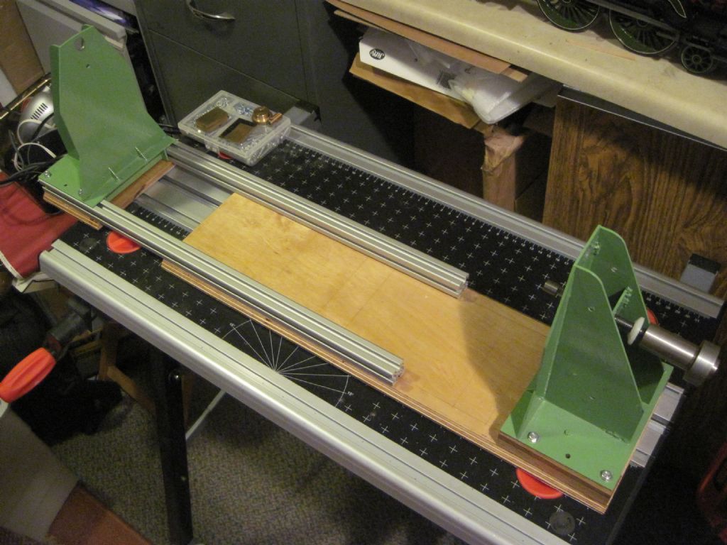

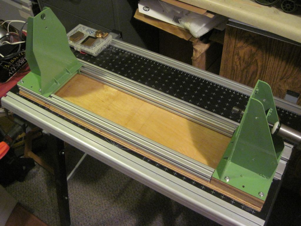

                I built the 2.5" gauge (for my Gauge '3' engines) version of the MEL engine stand a few years ago. It works well and the laser-cut parts saved a good deal of construction time. There may be simpler ways to do this but the MEL kit worked well for me. I assume that the 5" version will be very similar but just scaled up a bit.
                The kit came with two 1 metre lengths of '2020' extrusion as the base. I found this to be a little too long, so cut one 2020 length in half and made a new base with a fixed end and a double sliding section. It's a little easier to move around now but will still take all the engines I have (or plan {some distant day} to build). You may need the two full 1 metre lengths for 5" engines of course.
                I mostly brass-brazed the kit but it could have been fully silver-brazed – and Malcolm says it can be assembled with 2-part epoxy too if required. Have a look in my photo album ("Brazing" ) for some idea of the construction.
                Here's the modified G3 version I now use…one end is fixed – the other can slide, as can part of the base if required. The "spare" 2020 section is going towards the construction my new (replacement) rolling road.
                Hope this helps.
                Regards,
                IanT
                Stand in closed position Stand in open position

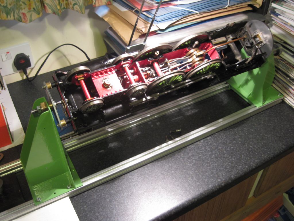

                  Here is a photo of the frame in use (before the recent mods).
                  The circular plate to the right-hand side is the locking plate – the loco is rotated by loosening the hand nut that locks this – and the engine can then be gently spun for access. I don't know if the 5" MEL version has some form of geared rotation. I've seen some stand designs that have. It's not necessary with 2.5" engines. As you can see, it does make access to an engine much more convenient when working on piping etc.
                  Regards,
                  IanT
