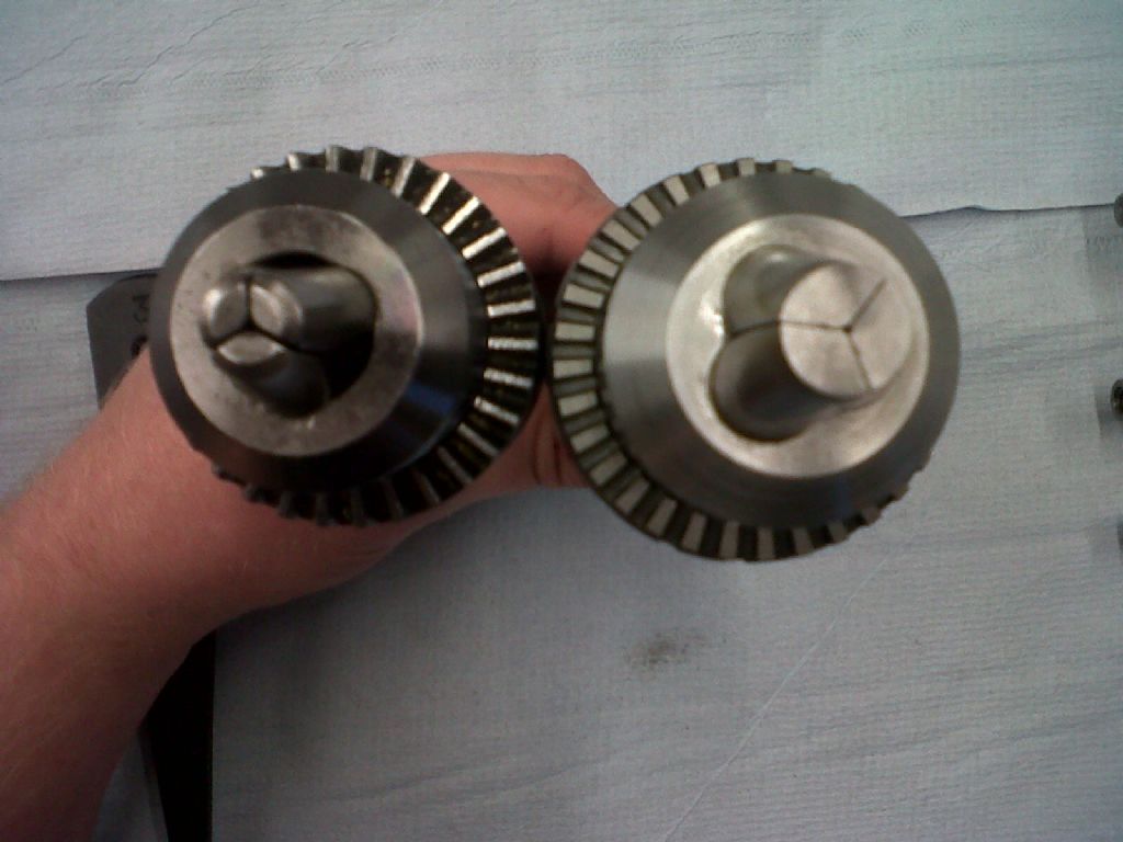

                          One thing that really struck me is how precise the jaws are; chinese to jacobs comparison.jpg
                          You can see how the Chinese chuck on the left has very rounded rubbed jaws whereas the Jacobs has very sharp, to a point jaws, this allows you to hold drills to 1mm shank accurately. The pinion teeth are wider, heavier duty too.
