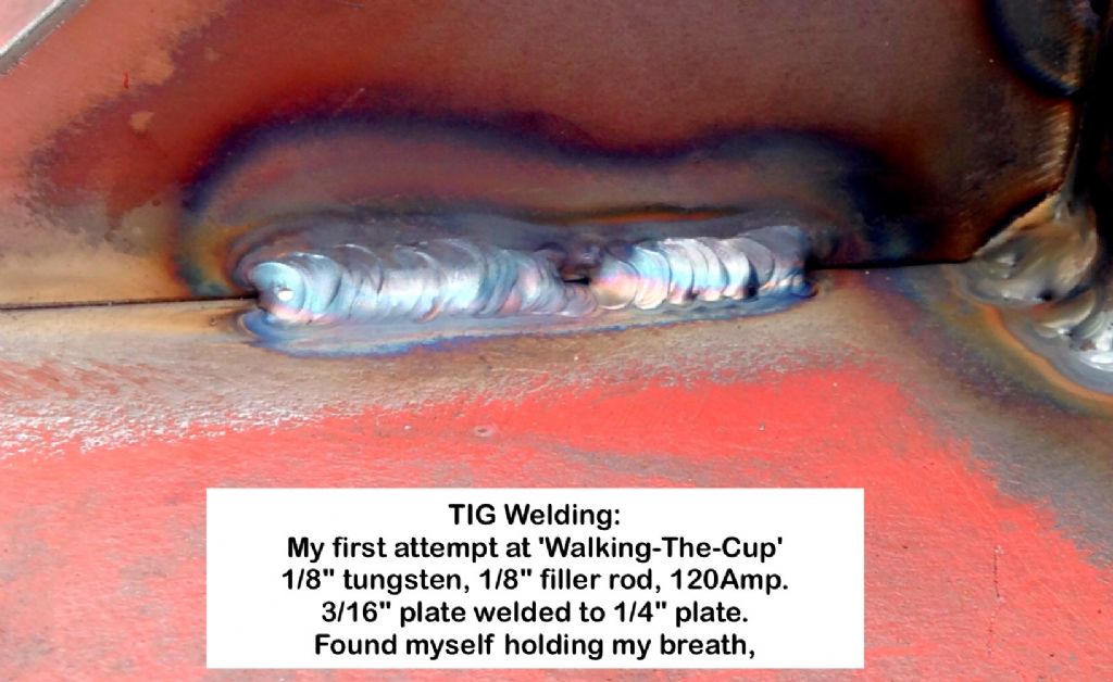

              #191157
              OuBallie
                @ouballie
                Update.
                Photos say it all.
                TIG Welding
                TIG Walking-The-Cup
                This is the limit for my machine, set to its maximum amperage, and thankfully I won't be welding 1/4" every day.
                This is the vice stand, photo to follow.
                I will now only use MMA for quick and dirty welding as I spoke far too soon at my improving.
                Well I did improve welding flat joins, but a real dogs breakfast on the type of corner weld I've 'succeeded' with using TIG.
                Still need to do a lot more practice, but oh my word, what control you have.
                Can see why people rave about using TIG.
                Geoff – TIG for me from now on.
