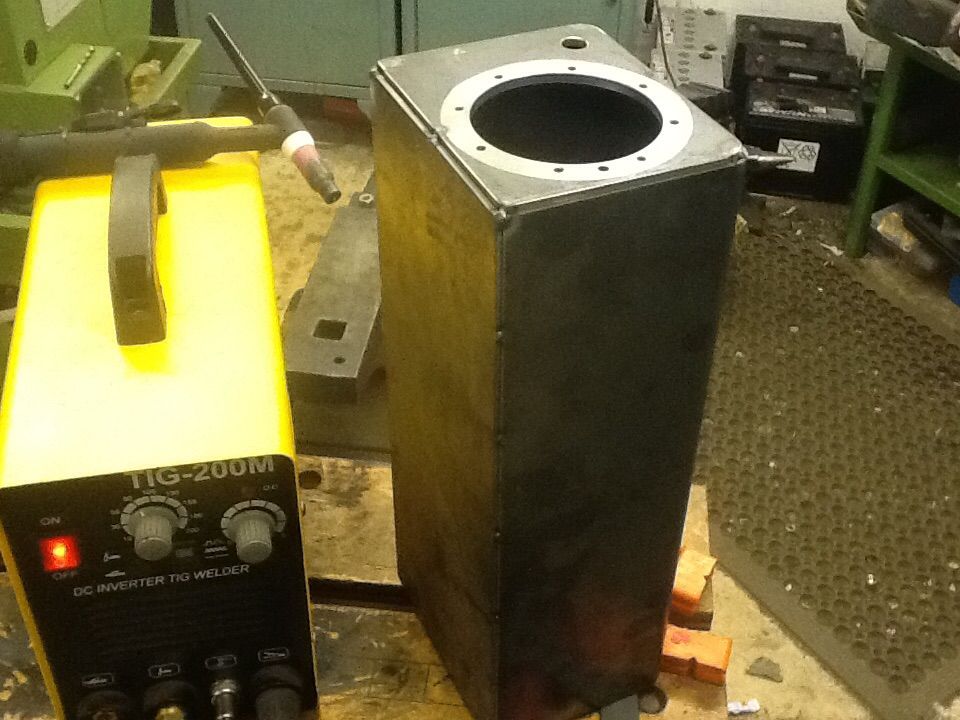

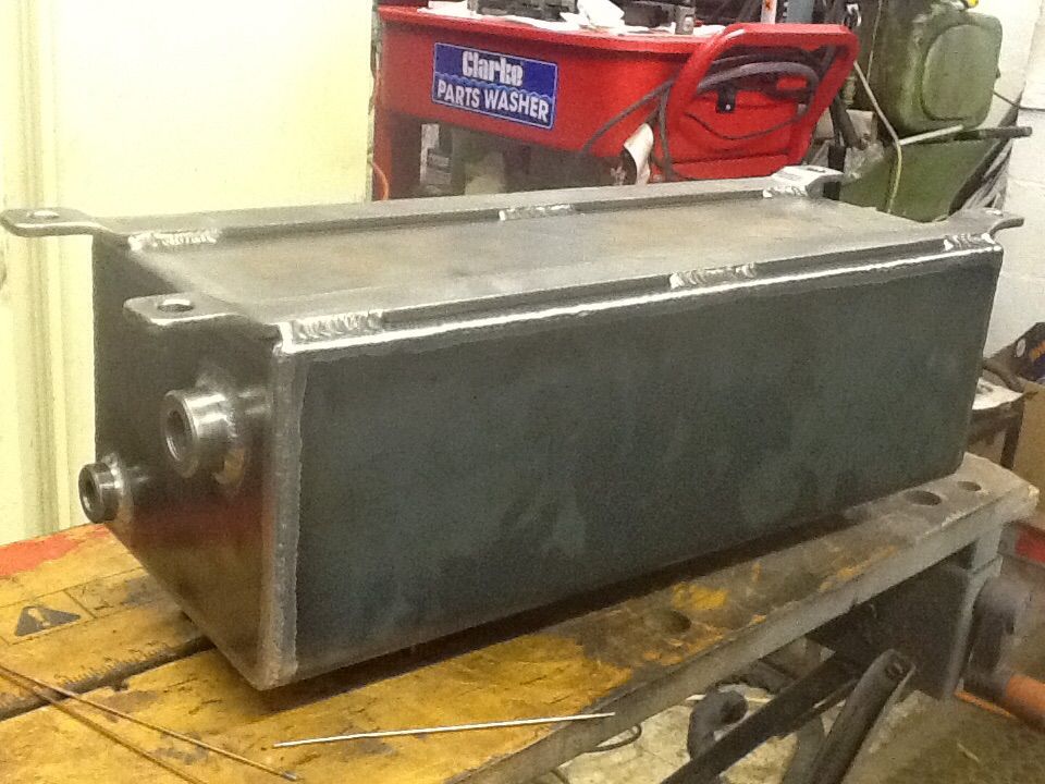

            Job done. All welds have just been wire brushed.I fabricated and Tig welded this fuel tank at home a few days ago. It is for a 1946 AEC bus, a vacuum is created in this tank which then draws fuel from the large main tank that I made at work a while ago. The welding set I used for this tank is a low priced Giant branded 200 amp single phase DC Tig Inverter.
            This welder with the old and badly scorched shroud has done prolonged cast iron welding repairs on a full size steam roller, using nickel iron electrodes as filler rods with the welder in Tig mode.Using a low priced Chinese DC Tig welder.

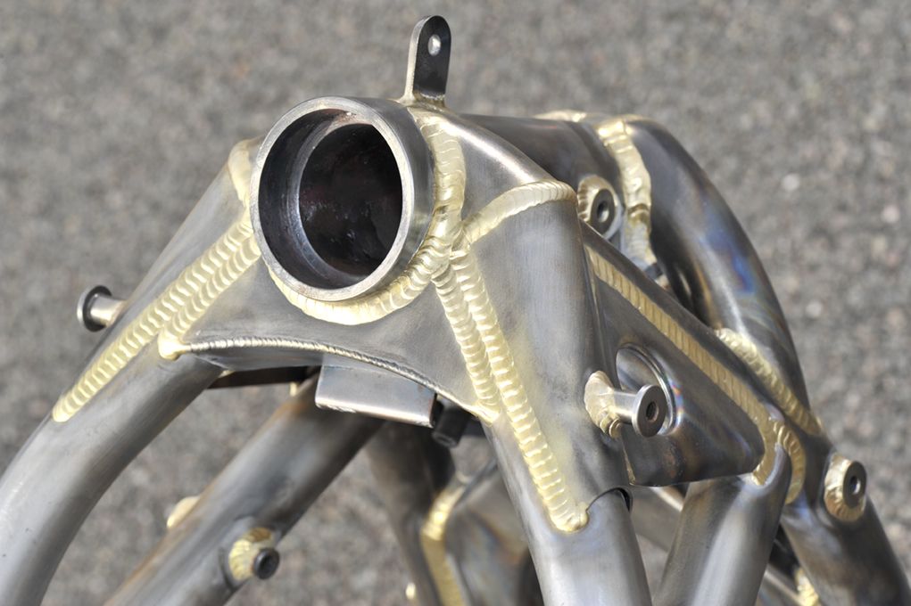

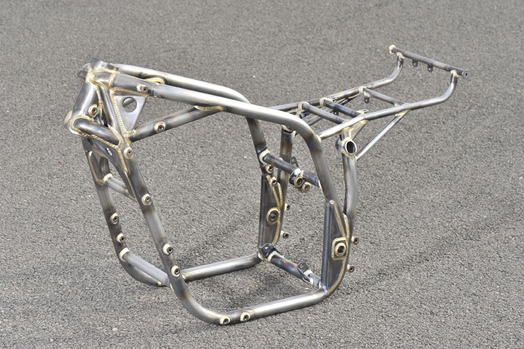

                                        This is an example of Tig brazing at its best, Sifbronze make a rod just for this…. I wish I could say it was my work but its not…

                                              I think its Sifbronze No 32 if I remember correctly, specifically for use with Tig brazing.
