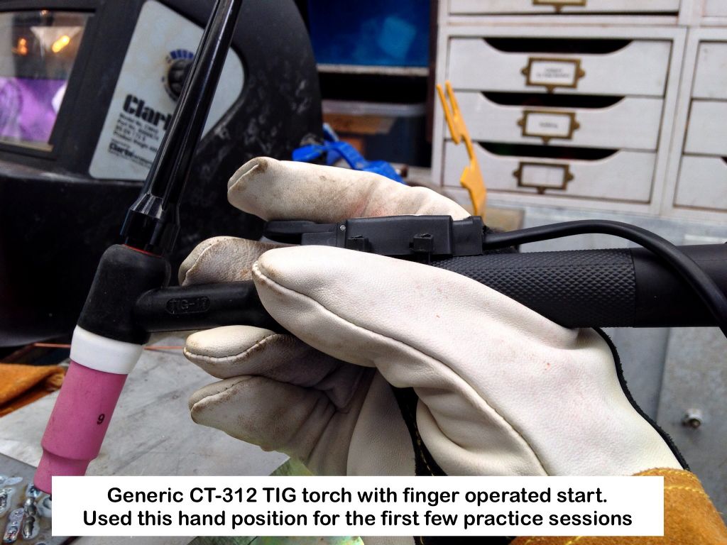

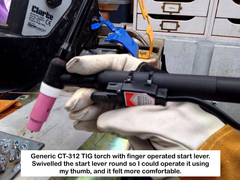

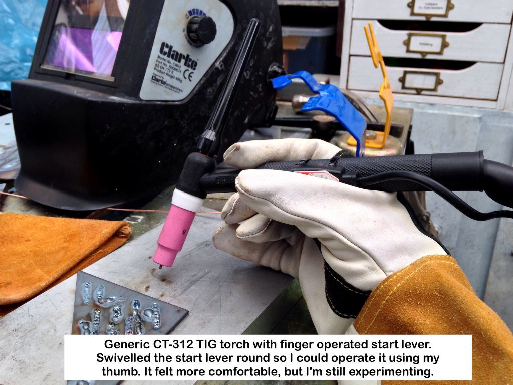

            Been experimenting holding the torch with start lever in different positions.
            Photo 1 showing how I started holding, with the lever operated by index finger and I was not totally comfortable with.
            Photos 2&3 show the start lever swivelled round for operation using my thumb, and this feels much better, but will carry on trying to see if I can get a better position for that lever.
            Seeing it's only a limit switch, may make a foot pedal for bench work.
            Photo 1:
            Holding the TIG torch
            Photo 2&3:

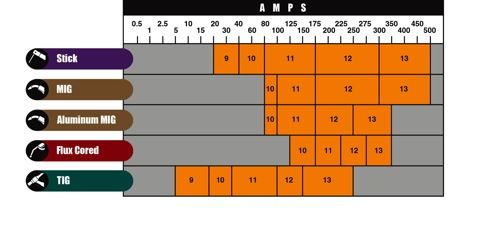

              May seem a silly question but what setting are you running the helmet on? In the pictures it looks like it is set on minimum which is probably not a good setting for TIG!

                  The chart was c/o Miller welders **LINK** , also do not forget to protect others when welding as arc eye is not something to inflict on anyone.

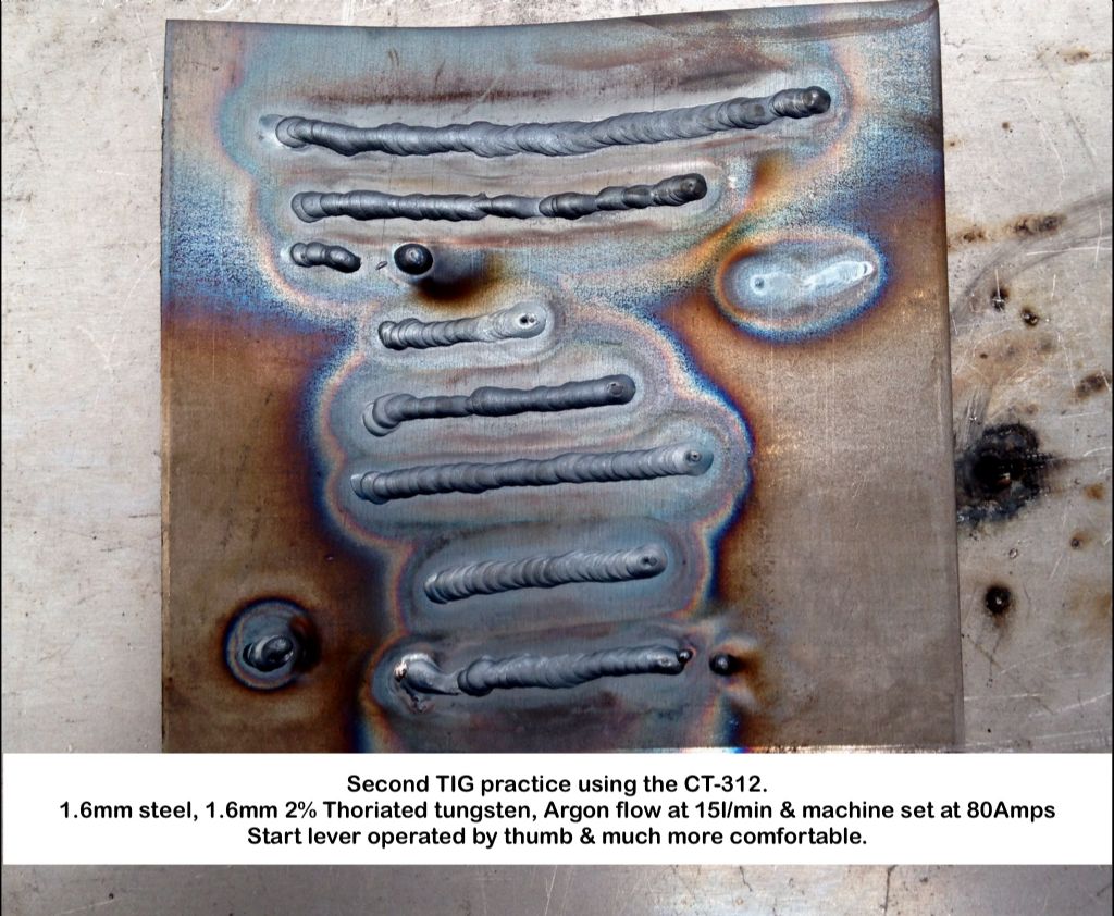

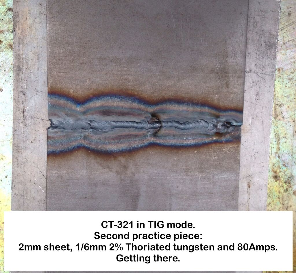

                    Helmet normally set at 10, but had just done second practice at 80amps. Still very much in the learning curve, unlike gas with one shade.
                    I am going to have to practice NOT sitting down as I will need to weld on the car, so that's going to be interesting to say the least
                    Second practice session just completed and although I don't normally brag, I'm more than happy with the results.
                    My gas welding experience is most definitely helping, but the last time I did any O/A welding was in the '80s, so it's taking time to get muscle co-ordination right. Still dipping electrodes
                    Using the 1/16" electrodes you really have to get close to see where that small puddle is. Another surprise.
                    One thing that has struck me is how slow and precise TIG is, with very little heat spread compared with O/A.
                    Tomorrow I will pop down to my friendly metal supplier and raid their skip/offcuts for suitable metal the same thickness as on the Austin.
                    Photo annotations give details:
                    TIG second practice
                    TIG second practice
                    This second photo is of a butt weld.
                    Photos of underside in Album.
                    Geoff – Feeling well chuffed.
                    Edited By OuBallie on 28/04/2015 17:06:14

                                      Hi Geoff, looking at your photographs I can see that the end of your tungsten is blunt. You must keep a sharp long taper on the point for accurate positioning of the arc. If it's blunt the arc wanders and you end up with a poor finish.
                                      Brian

                                            That photo was at the end of a run, and I did dip as previously mentioned, but do grind as soon as that happens.
                                            Have only used a tungsten like that once, just to see what happens.

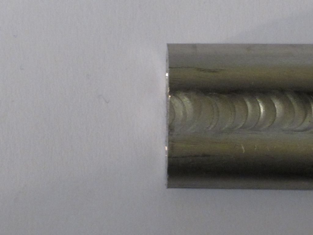

                                              OK so decided to dip me tungsten in, in a manner of speaking.
                                              Done loads of TiG but it's always been top end, high amps working to sploge a broken foot on an electric motor / pump / gearbox  [ delete as necessary ]
                                              So today and in all fairness had this bit kicking around for a week or so decided to try tigging this up.
                                              It's a simple belt guard for a machine made out of new 18G steel sheet, precut to size in 3 pieces and requires two bends to make the cover. Unfortunately had no spare material to play with after buying this in so had to dive in.
                                              Smallest tungsten I had 1.6mm White so Zirconiated, small cup and set to 25 amps. That was a bad mistake and had to drop to 14 amps as no way can I move that fast.
                                              Sorry camera phone and probably wants a clean.
                                              Close up.
                                              Job finished and a quick clean up with flap wheel then a file and nice radiused corners and over to the spray shop.
                                              Genuine first time I have welded this thin with TiG, in fact didn't even know how low it went on amps and this is one of those cheap crappy Chinese welders that everyone says are rubbish ?
                                              I do know the Murex won't go that low.
