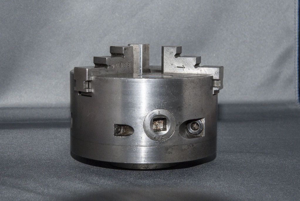

              He doesn't say that it is a 3-jaw independant just that it's a 3-jaw. If it is a self centering then, its use is as Jason states. The only variation of that I know of is the Grip Tru which is commonly ( although not exclusively) a 3- jaw chuck.. So Doug – is this a 3-jaw self centring chuck which which has an additional adjuster next to each jaw? If so what you have is a chuck to be cherished!
              Here is a pic.
              You will see that, alongside the normal hole for the chuck key is socket for a hexagon key. This allows the micro adjustment.. If this is like your chuck just reply here and I will post the adjustment instructions.

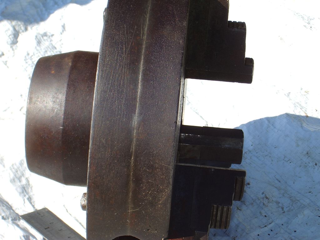

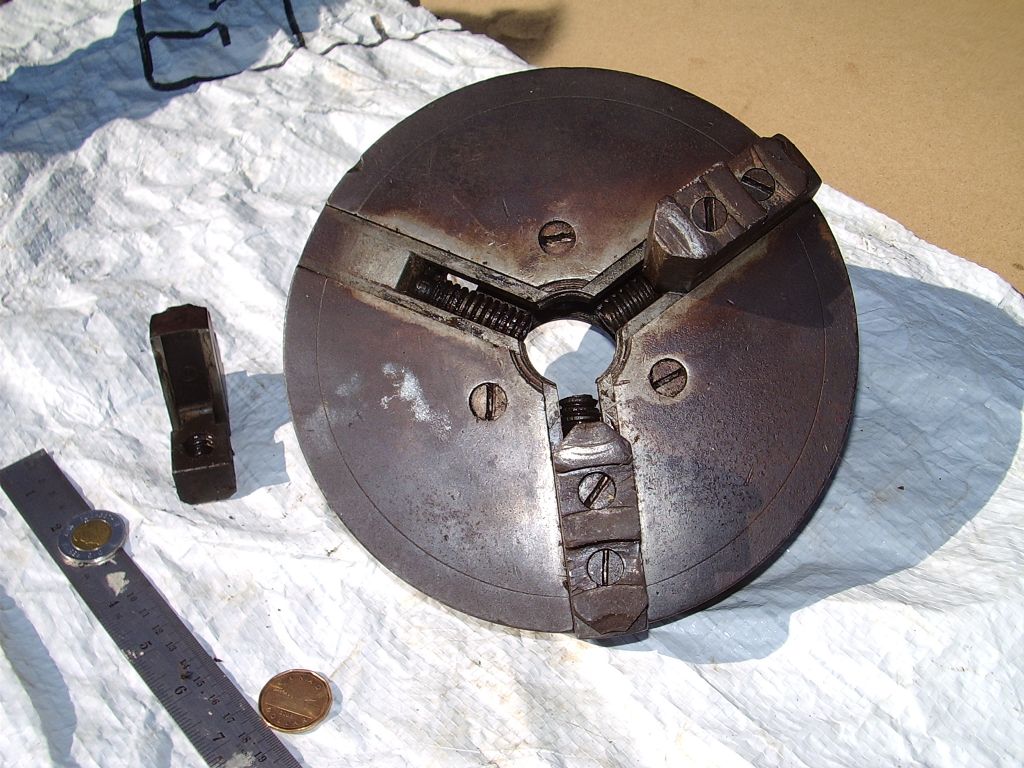

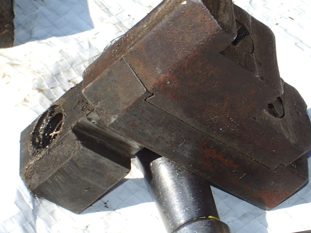

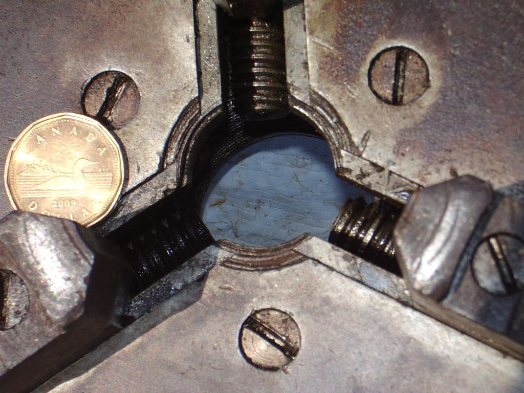

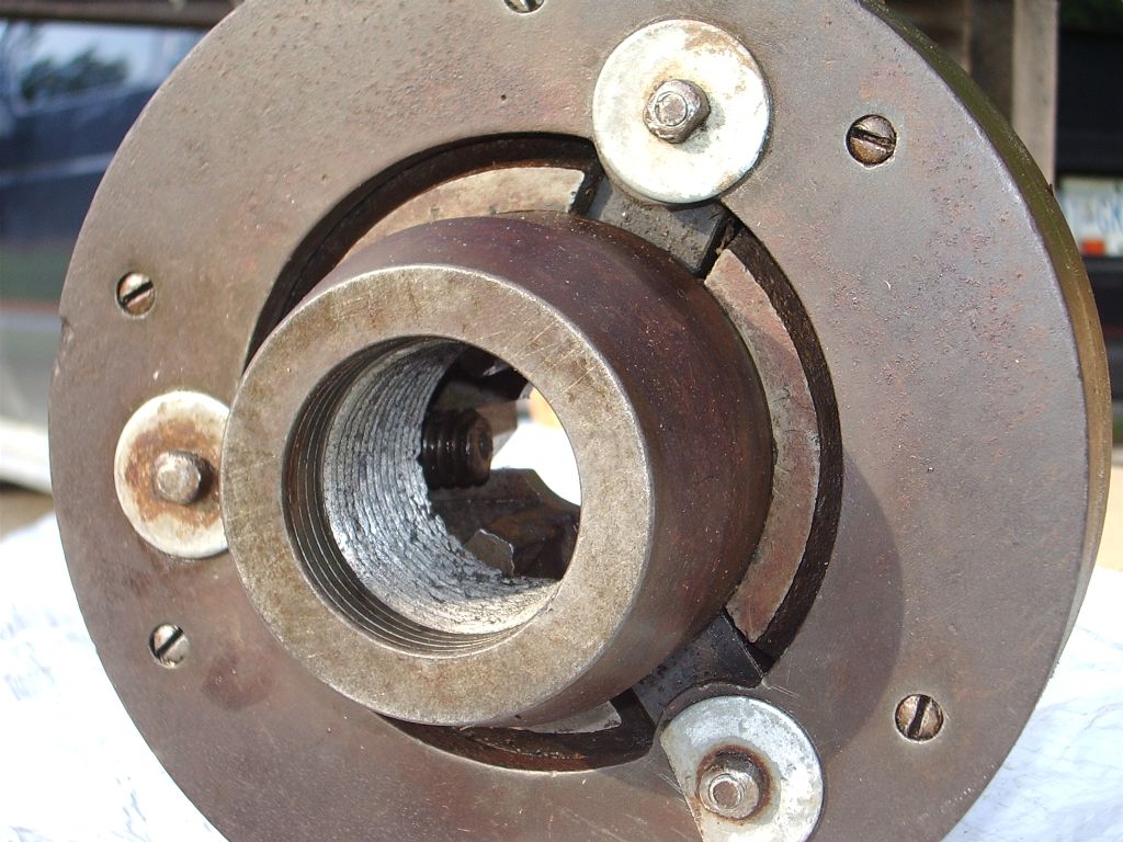

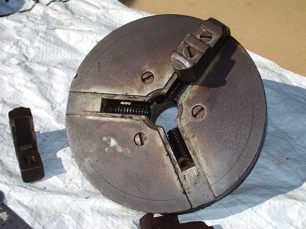

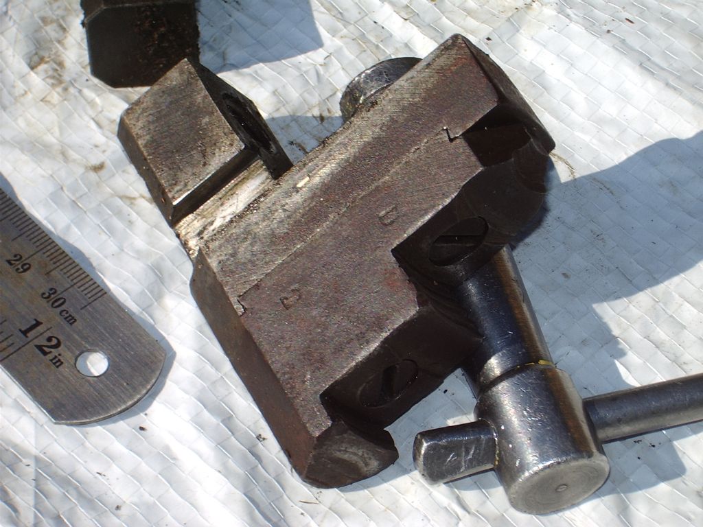

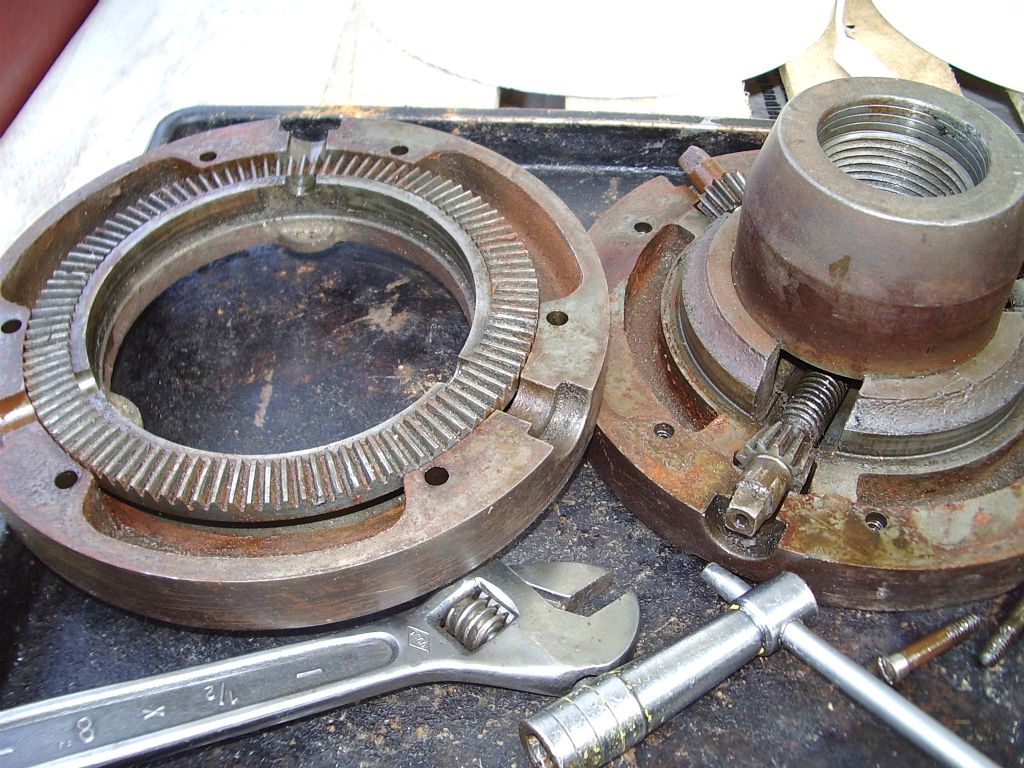

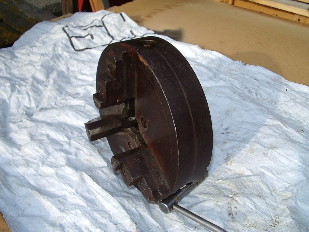

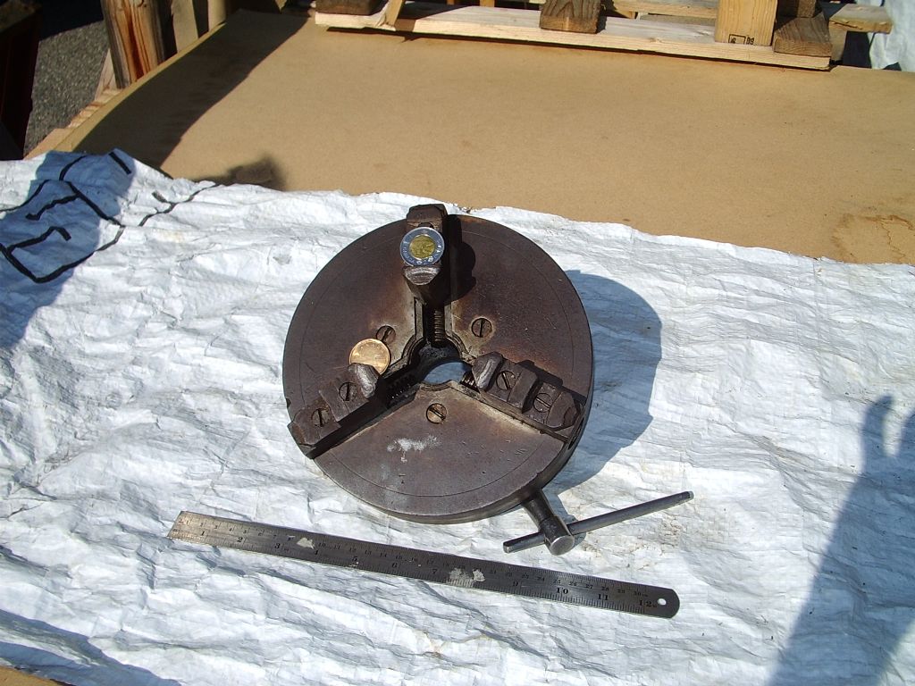

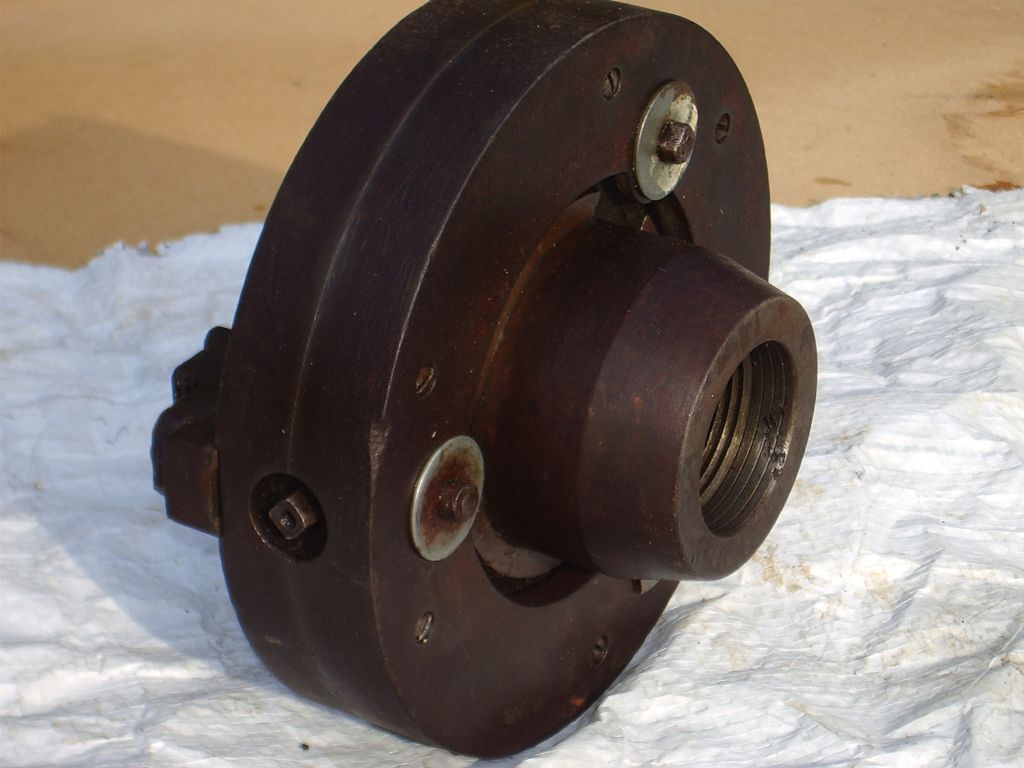

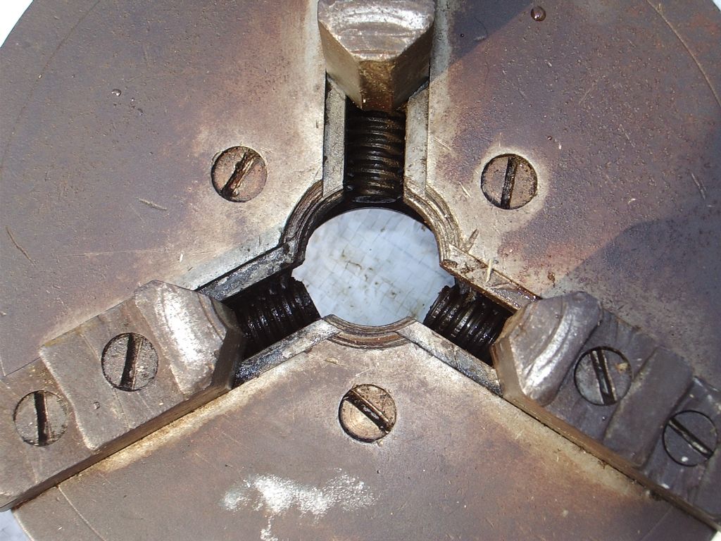

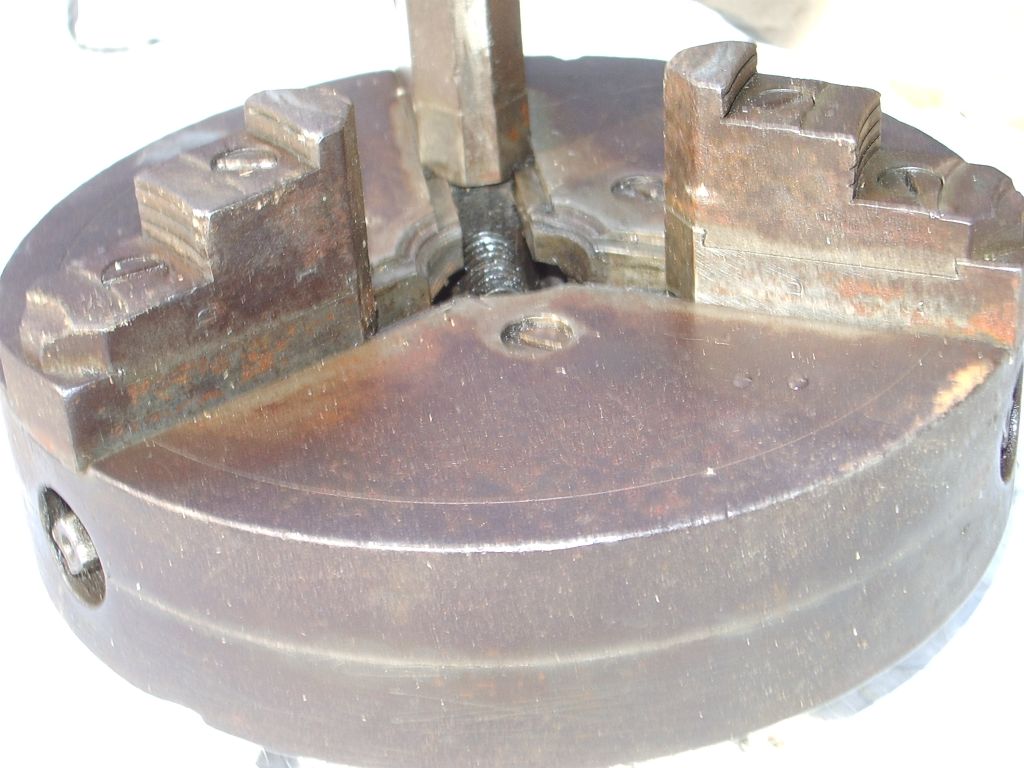

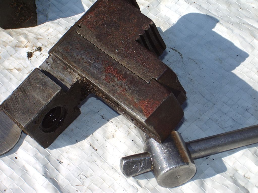

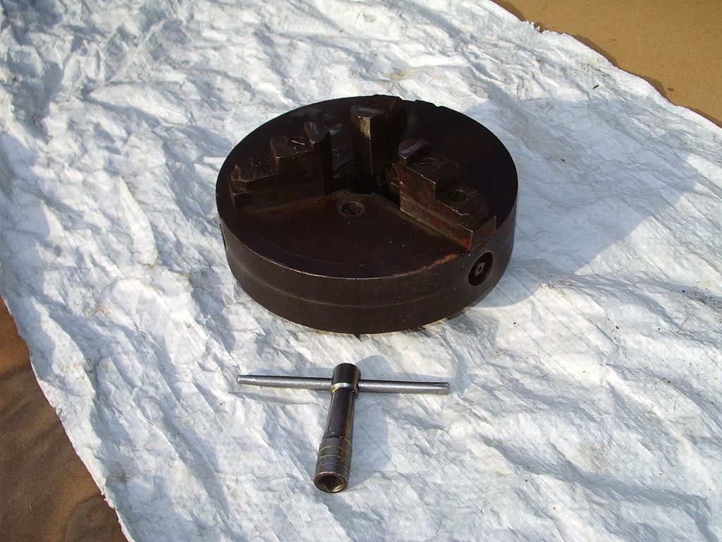

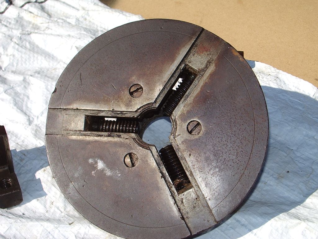

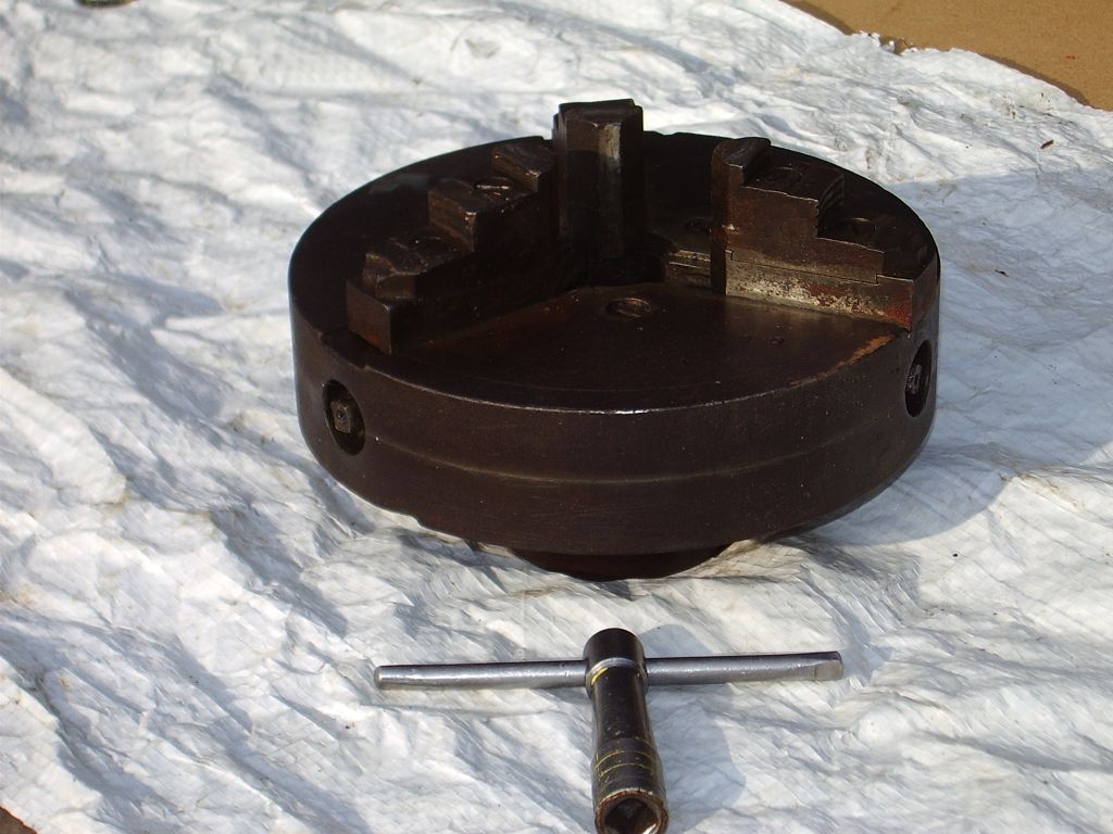

                          3 Jaw Ind Ckimgp0863.jpg3 Jaw Ind Ck3 Jaw Ind CkThank's Gentleman for your interest.
                          Some old very experianced Machinist have observed this Chuck with their Jew on the floor, one said that he feels that he had seen one while in the Navy but only vague about it.
                          This I beleave to be American and may possibly be associated with a Rotary Indexer for possibly Ecentric and Cam Grinding/Cutting??
                          Hear are the Photo,s as requested.

                                  My Mistery is Solved.
                                  Many Thanks to those gentleman that responded professionly and constructivly, I particuly apreciate the input of discussion from both Michael and JasonB eith a high 5 to Michael for the look at This, that forced me to disect the Chuck and solved the mistery.
                                  Thanks to all from Doug in Canada.

                                    A fabulous find, Doug … and thanks for the great photos.
                                    We've all learned something today … which is why we are here !

                                        You have to ask questions about its work holding accuracy, it is not only depended of the accuracy of the thread of each jaw, but also of the gearing, In a normal scroll chuck the accuracy of the gearing has no part ín the centering of the workpiece. Niko.

                                              Of course it would have been easier to turn the key to see how it worked rather than pull it all apartblush
