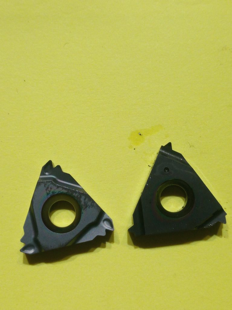

                Interestingly not all insets have the second tooth. The photo shows two 1.5 mm pitch inserts…
                As to the depth of cut. I suspect that I err on the side of caution. I seem to have stopped looking at manufacturers data for cutting speeds as this invariably spells disaster for me crying.
                Perhaps next time I'm doing some threading I should push one of these inserts and see what is possible.
                Another question. Has anyone tried resharpening one of these inserts? It looks like it should be possible to take some off the top of the insert and still leave the correct profile. I haven't tried this yet but I keep the dull ones in a drawer waiting for the time of desperation.

                  Posted by David Colwill on 27/02/2020 13:04:00:
                  I hope I am not telling you something you already know, but are you aware that threading inserts come as full profile, suitable for only one thread pitch and as partial profile, suitable for a range of pitches?
                  Full profile ones look like that on the left, where the second tooth finishes the crests.
                  While both the inserts you show may be able to cut a 1.5mm pitch thread, only one of them is strictly a 1.5mm pitch insert.
                  Partial profile metric are usually labelled A60, G60 or AG60. Full profile will have a number for the pitch as part of their label.

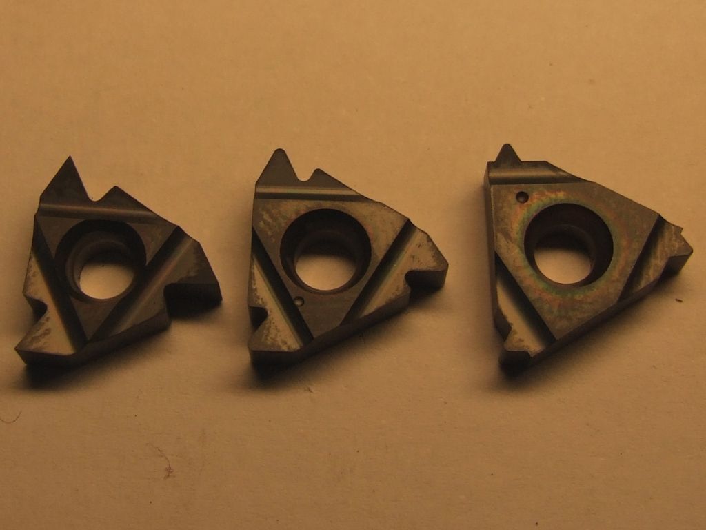

                    Insert profiles are rather more involved than DC31k propounds. Here are three inserts:
                    Which are full form and which partial?
                    The one on the left is marked 16ERAG60, so a partial profile for a 60 degree angle thread. The middle insert is marked 16ER-8W, a full profile insert for 8tpi Whitworth, where the partial tooth does indeed form the rounded crest, as specified in the Whitworth form. The righthand insert is marked ER16-2.0ISO, a full profile insert for 2mm pitch ISO threads. These threads have a flat crest, so the second tooth is not needed to fully form the crest, a flat is sufficient.

                        So you would think, however both of those inserts are labelled ER16 1.5 ISO and are listed as full profile.

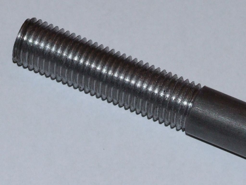

                              By coincidence the last thread I screwcut was M16x2 in EN16T, for a cutter drawbar. The finish is ok, but since I was cutting a metric thread on an imperial lathe I couldn't use my high speed threading attachment. I was running at slow speed, 85rpm I think. Here's the thread:
                              The thread is better than it looks, and works fine.
