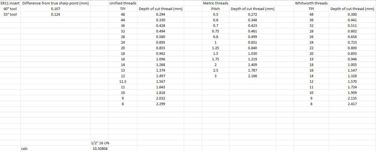

                          On Martin Kyte Said:
                          Does everyone cut deeper with partial form threading tips. I cut to depth and then increase the width of the thread.
                          Yes as you need to achieve the correct pitch diameter. By the way if you are using too small a radius tip for the thread pitch being machined how do you cut to depth, what figure do you use?

                          Martin Kyte
                            @martinkyte99762
                            Essentially with a partial form and small radius if you cut to theoretical depth you wind up with a groove which is too narrow to accept the mating part of the thread. Assuming the depth has been reached by the cross slide using a straight in cut the thread groove can be widened out incrementally using the top slide to shift the tool sideways a little and shave the flank. This is continued until the thread is symmetrical and a good fit is obtained. You wind up with a flat bottomed root of the correct diameter and tidy crests. The crests can be cleaned up ( for whitworth form using a chaser, a die or a file) I prefer a die.

                              I hunted the internet and found a radius for the size 11 inserts I have for general use and then calculated the distance from a true point to the actual tip based on that radius. This gives distances of 0.107mm for the 60° inserts and 0.124mm for the 55° insert. You can then look at the calculated figures from a true point to the outer surface of the thread that are a given proportion of the pitch and from these calculations I created a spreadsheet for the required depth to cut to give the correct thread. Tried it out and it worked in that I cut the “normal” depth and it was too shallow, went to the calculated depth and the nut I had made to check the thread then went on with what felt like the correct amount of clearance.
                              thread spread
