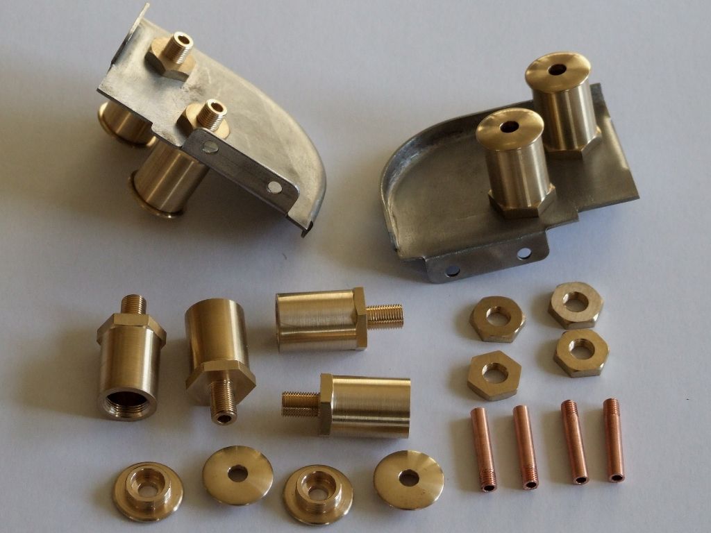

                  By nominal I mean the thread size. So in the case of your 3/16" x 40 thread I'd turn to 3/16", without worrying about the 5 tenths, say 0.187".
                  I don't think having the blank at nominal thread diameter is the problem. I've recently made a batch of wick feed oilers for my traction engines:
                  The threads on the spigot underneath the body are 1/4" x 40. They were screwcut using a full form insert; the OD measures 0.25" give or take the odd few tenths, some over some under. Likewise the lids bottom left have a 7/16" x 32 screwcut thread. They measure 0.4375" on the OD.
                  The interesting part is the 5/32" x 40 threads on the copper tubes. The tube OD measures 0.1575". A 2.5mm drill slips neatly inside. That gives a wall thickness of 0.0295". A 40 tpi Whitworth thread has a depth of about 0.016" so that leaves 0.0135" minimum wall thickness after threading. When I made the first batch of these oilers I screwcut the 5/32" x 40 threads. But it was a pain as slightly too much depth of cut and the remaining thin wall gave way. So this time I resorted to a die in a tailstock dieholder. It worked fine and the OD of the resultant thread is 0.1575", so slightly over nominal. But they fit nicely in the mating tapped holes. The threads are properly formed for the full length and without breaking the remaining thin wall. That's why I don't think making the stock undersize is the solution. It's perfectly possible to cut nice threads starting at nominal diameter with a die. Reducing the diameter may appear to help, but it's covering up the problem not solving it. The die I used was part of a present (Triangle brand) some 50 odd years ago and the tailstock dieholder came from Arc, so neither are top notch professional (*), but they did the job fine. A few questions:
                  Where did the die and tailstock holder come from?
                  Have the die and/or holder been used satisfactorily in the past?
                  Was the die opened out to its maximum to check the fit before adjusting?
                  Have you tried the same setup on something more forgiving like brass?
                  Andrew

                    The tailstock holder is a homemade one but it works very well normally. The die I'm not sure about but most of my tackle comes from Tracy Tools so should be good. I'm sure I did have it at its maximum opening I wound the centre screw in first then just nipped the other two to stop it falling out. I will try it on some brass and see.

                                          I did what Andrew suggested and cut a thread perfectly on a piece of 3/16th brass. So there is nothing too wrong with the die it would seem.
                                          I managed to cut a thread in steel but only by taking the bar down to about 0.18 but it didn't look very nice. It seems that despite me pushing the die towards the chuck it just wouldn't start pulling itself forward along the bar and it appears to just grind the steel away until it can get going and then it pulls itself along. So I did what I didn't really want to do and set the lathe up to screw cut. In the end I managed to get a very nice test piece cut on the other end of the brass rod so later I will try it on the steel.
                                          I tried to find out at what point I could engage the leadscrew by looking at the workshop practice series book but soon realised it was going to take ages to work it out. So I reversed the lathe after each cut and engaged on the same number each time.
                                          To speed this up does anyone know any easy way to work out when you can engage the leadscrew for a 40tpi thread with a 4tpi leadscrew?
