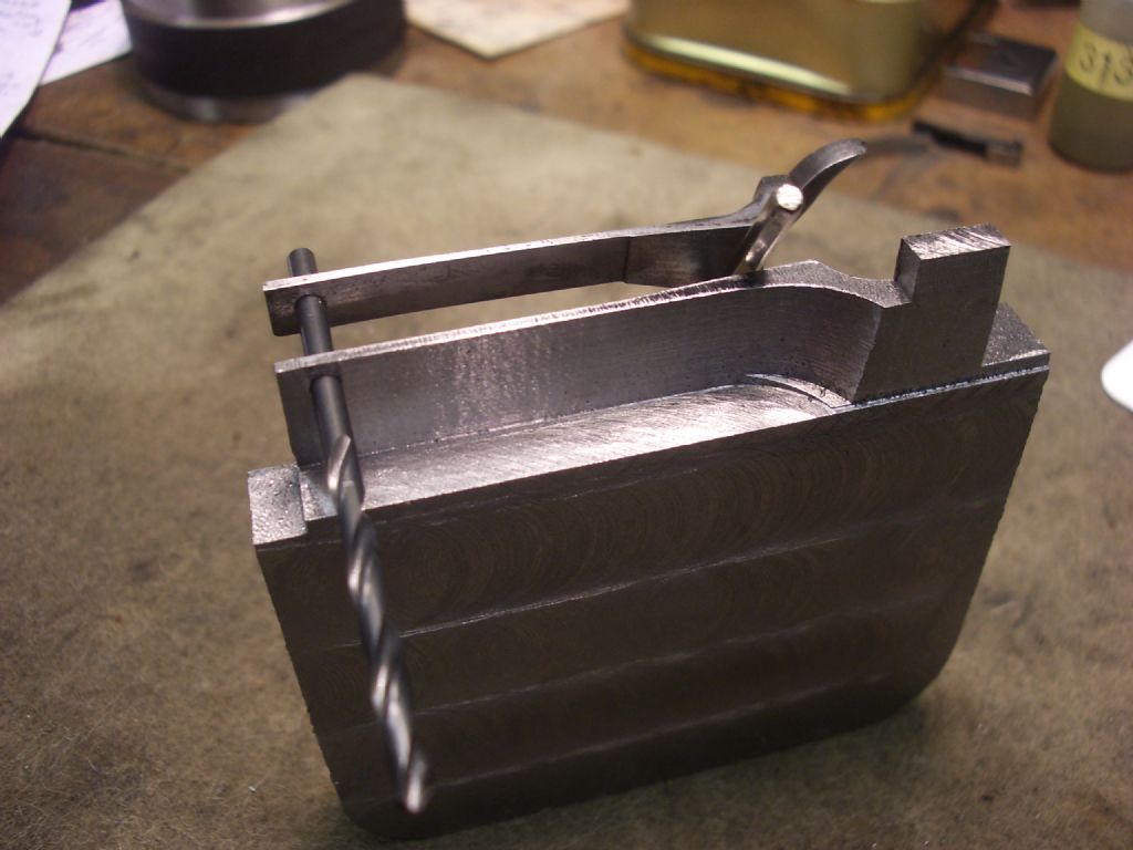

                    John, A method I have used to make very slender pieces is in this case use a piece of 10mm bar round or 10mm x 5mm say 4 or 5 inches long, machine your thread then machine away the surplus material while still attached to the original material then cut off the component.
                    The component shown is only .040" x 0.150" section on the thin leg you can see, it was made from EN45 then heat treated after cutting off with a slitting saw.
                    John.
