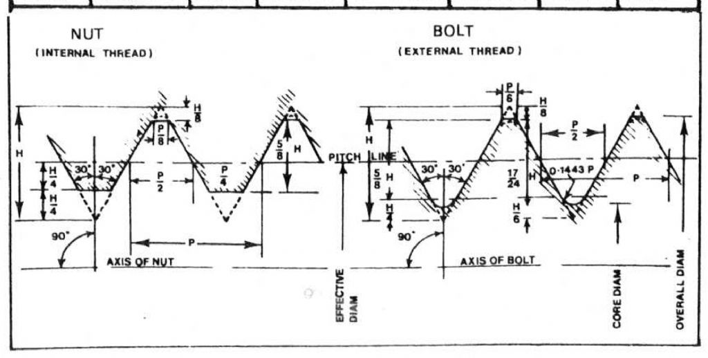

                  Howard, surely the outside diameter is with the flat taken into account. You should not be making the part undersize to start with.
                  Martin C
                  #572705
                    For clarity … Here is the diagram from the bottom of the Zeus tabulation
                    Edit: __ Dontcha just love all those fractions on a ‘Metric’ standard devil
                    Edited By Michael Gilligan on 24/11/2021 08:52:17

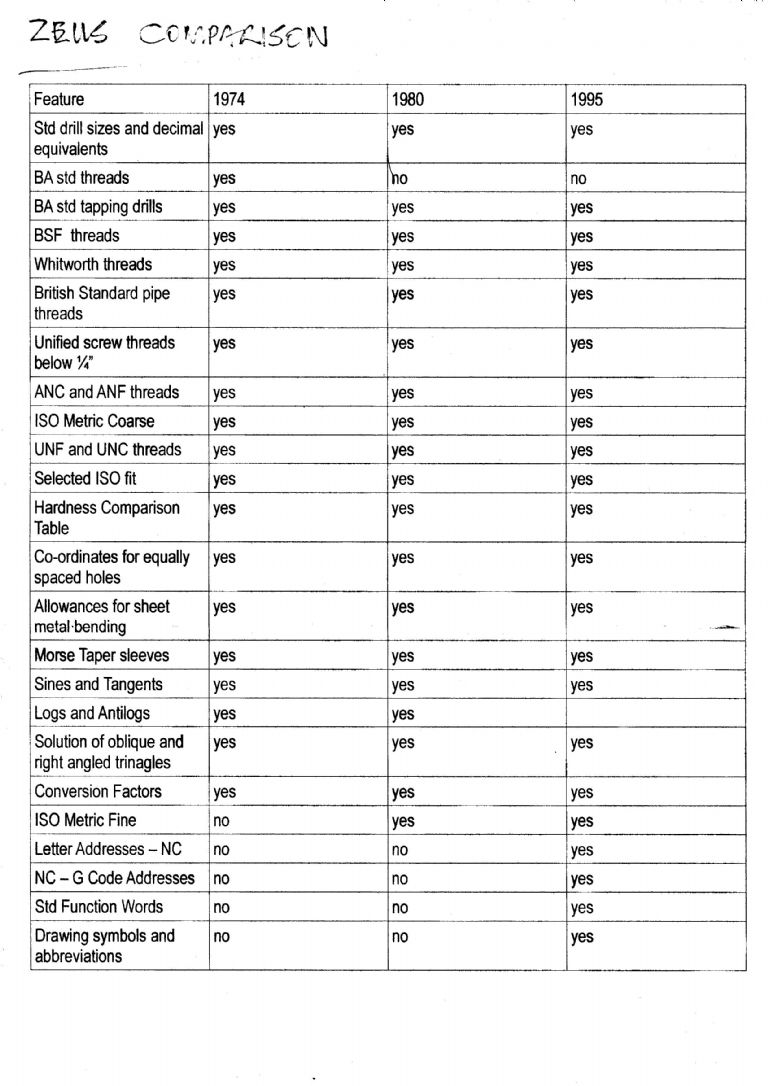

                        Quick question about Zeus
                        Does a modern version (metric revision) cover all the older information too, or is it worth getting an older, say 1965 edition as well?

                          ega
                            @ega
                            I gave away my 1974 edition but based on that and other editions offer this (corrections welcomed):bazalgette.jpg

                              There are, of course, alternatives to Zeus including the Babani Press Engineers and Machinists Reference Tables. The latter is probably out of print and is best used by those with keen eyesight (BP also do a series of computer guides for the "Older Generation" ).

                                  so based on that seeing as I use a lot of BA threads (old Triang/Hornby etc) I night just invest in an older version too. I know I could get the info from elsewhere

                                      Hi, for what it's worth, I have three editions of the ZUES charts, one dated 1972; copyright 1970, one from 1978; copyright 1974 and one that just has copyright 1980, which are just the same as ega has said in his 1974 and 1980 columns, but with exception of my 1972 edition having the primary and secondary selection of fits (British Standard data sheet 1 & 2 B.S. 1916C August 1954) instead of the ISO ones and there are no conversion factors and my 1978 edition has an error in the data known column of the solution of the right angled triangle. ZUES 1978 error also two in the middle formulae where Cos was printed instead of Cot.

                                            By the way my Zeus (95) has very limited metric fine data and doesn't have a 24 x 1.5mm in it even though it is a metric edition.

                                                Buffer, as with all thread forms the majority of data for a given pitch is true regardless of the diameter. The only thing that changes is the starting bore or the starting outside diameter. When cutting a 1.5mm pitch thread the depth is the same whatever the outside diameter. The same is true for internal threads. So if you have data for any 1.5mm pitch thread it is the same depth, so for an M10 x 1.5 thread the depth is also 0.9202mm
                                                Martin C
