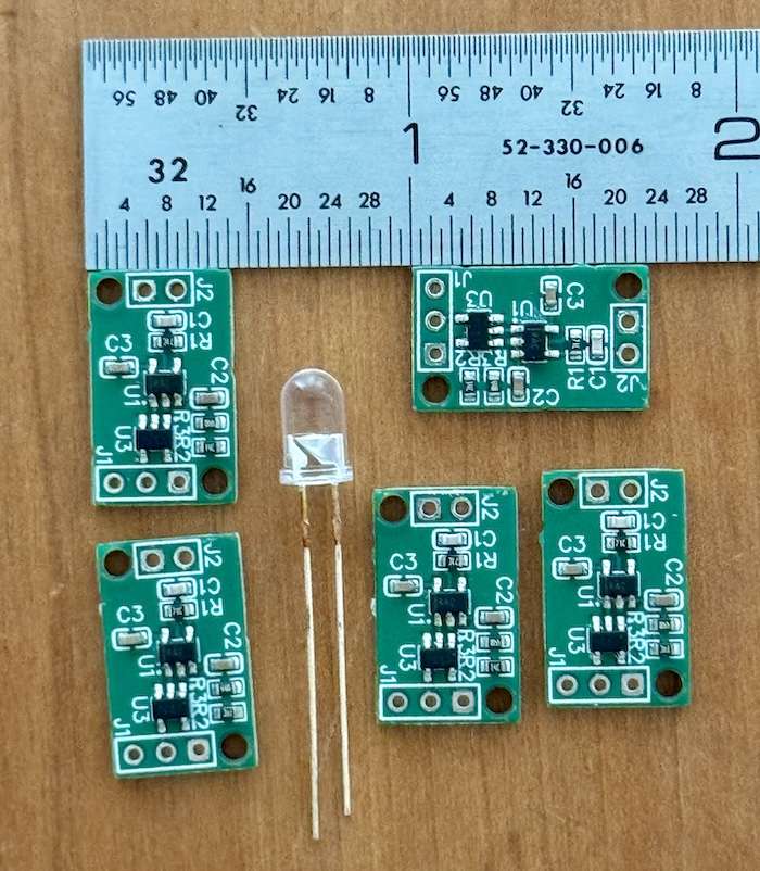

          I think one of the keys to low-noise and high resolution timing is using a fast sensor. The popular Sharp device, and the TT one, are in the microsecond-level delay times and can have fairly slow rise and fall times.
          Better should be possible. I just submitted a tiny PC board for fabrication using a fast (20MHz) op-amp plus Schmitt trigger. It should have a propagation delay as low as 50ns and rise/fall times of maybe 3 ns (depending on the load).
          It can be used with an inexpensive PIN photodiode (about $1) that looks like it has about the same performance characteristics as the expensive ($50) Thor Labs diode I tried earlier.
          It should arrive within a week, so obviously I haven’t proven that it works yet. But assuming it does, I’ll have a spare or two if anyone is interested in comparing it with other options.

              IMG_5365
              Here are the “fast” detector boards, along with a 5mm IR diode for comparison. It may take me a while to get around to testing them. If they work, I’ll start a new thread to discuss them and their performance.

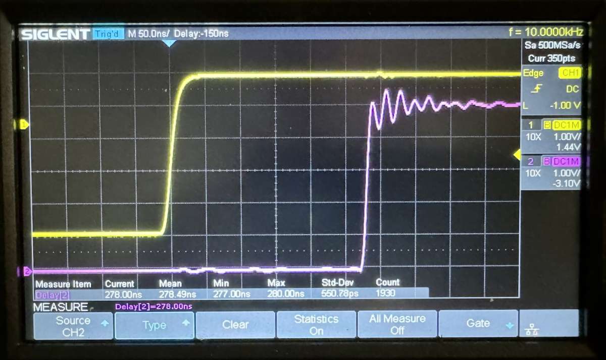

                            Here’s a scope photo. The top (yellow) trace is the power to the illuminating LED. The bottom (pink) trace is the circuit’s output. There’s some ringing due to the slap-dash setup, or it might benefit from an additional decoupling capacitor at the power connection.
                            Near the bottom, it shows a delay of 278 ns and a standard deviation of the delay time of 551 ps after processing 1930 waveforms. Not too bad.

                                I did a similar measurement of the Sharp device as a baseline. As above, this test stimulates it via pulsing the illumination, which of course is not the normal operating procedure.
                                With a 100 Ohm current-limiting resistor on the diode and no extra pull-up resistor on the output, the rising-edge delay is 1.8us with 3.7ns jitter (and a quite poor rise time), and the falling-edge delay is 9us with a 22ns jitter. The fall time of this device is far faster, as has been noted before, but because of the longer delay, the jitter is greater. You might choose the rising vs. falling edge depending on whether the latency or the jitter is more important.
                                It’s not surprising that the latency and jitter times scale with each other – that would be expected, as faster response times almost always leads to lower jitter.
                                So, looking at the faster rise time numbers only, my device works out to be 6.5 times faster input to output latency with 6.7 times lower jitter.

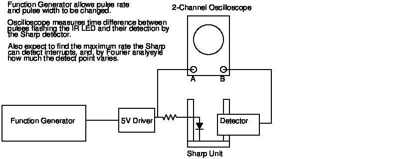

                                            The set-up shown below is intended to establish the maximum possible performance of a photo detector by pulsing the LED electronically, not by breaking the beam with a pendulum.   By electronic standards a pendulum bob moves at the speed of a tranquillised snail on holiday!  I previously assumed that meant mechanical effects would be irrelevant.   Now I’m not so sure: as the bob crawls into beam breaking space, it’s not clear to me exactly when the shadow on the sensor will trigger the comparator, or if the trigger point is constant.   There must be some error, size unknown.
                                            A shortcoming of the Arduino module is that it does nothing to manage the trigger point.   In contrast, the Sharp unit’s comparator trigger voltage is regulated.  I have high hopes fitting a Sharp detector to my clock will be a big improvement, even though the Sharp may not be the best of all possible beam break units!
                                            Researching LEDs,
                                            • Phosphor LEDs, almost all LEDs with colour, are about 10x slower than direct emission types.
                                            • Almost all IR LEDs are direct emission types
                                            • A direct emission LED should:
                                              • Turn ON in single digit nanosecond time, but
                                              • Turns OFF in tens of nanoseconds.
                                            • By the time electronics have been added, expect 100s of nanoseconds.
                                            The test rig will look something like this:
                                            sharpexperiment
                                            Nearly ready to go in that the driver and Sharp are wired up with a power supply, and the scope and generator are on the table next to it. My concentration failed at the point of reading my scope’s manual (Siglent 1102CML), to find out if it can log data points for external analysis.

                                            However, the latency observed by SK could be due to:
                                            1. The slow switch OFF time of LEDs and photo-transistors.  Mostly it seems better to detect ON rather than OFF.
                                            2. Comparators contain several active devices, each adding propagation delay, and making them relatively slow reporting OFF as well.   Working in the nano- and pico-second region really pushes the technology I have in my junk box!

                                              Duffer:
                                              The Sharp unit is inexpensive, quite easy to use, has a nice big gap (though that’s both a pro and a con), needs no adjustment (also a pro and a con) and it should be adequate for the job. It’s almost certainly better than your prior module, so if you have one I recommend just switching to it.
                                              The setup you described for testing it electronically is pretty much what I did to measure its latency and jitter a few posts earlier. If you use the rising edge, which has lower latency, then you should add a pull-up resistor to the output as shown somewhere in the spec sheet. The falling edge has longer latency but a much faster fall time, so if you only use that edge, then no pull-up resistor is needed or desirable.
                                              Previously, I recommended using only the falling edge, since it has a far faster fall time. The problem with a very slow edge is that whatever comes next in the electronics chain (let’s say a digital input pin on an Arduino) has some arbitrary and probably not particularly well controlled and certainly not noiseless threshold that, in combination with a very slow edge, can lead to noisy measurements.
                                              In my above test, I measured 9us latency and 22ns jitter in the falling direction. I can’t say if the latency would bother you, but the jitter is maybe 5-10% of the resolution of your Arduino. That doesn’t seem terrible, so I’d probably still recommend the falling edge just to eliminate concern about its truly awful rise time.
                                              Would my new detector module, with ~280 ns latency and ~0.55ns jitter, actually be better in practice? Probably not noticeably if it’s just followed by an Arduino or Picpet with say 200-400ns resolution. It’s nice that the latency would be down to about one least count, and that the jitter is low enough to be discounted, but to really take advantage of it, one would need to improve the resolution of whatever comes next too, e.g. with an FPGA operating with a 250-1000MHz OCXO or TCXO clock.
