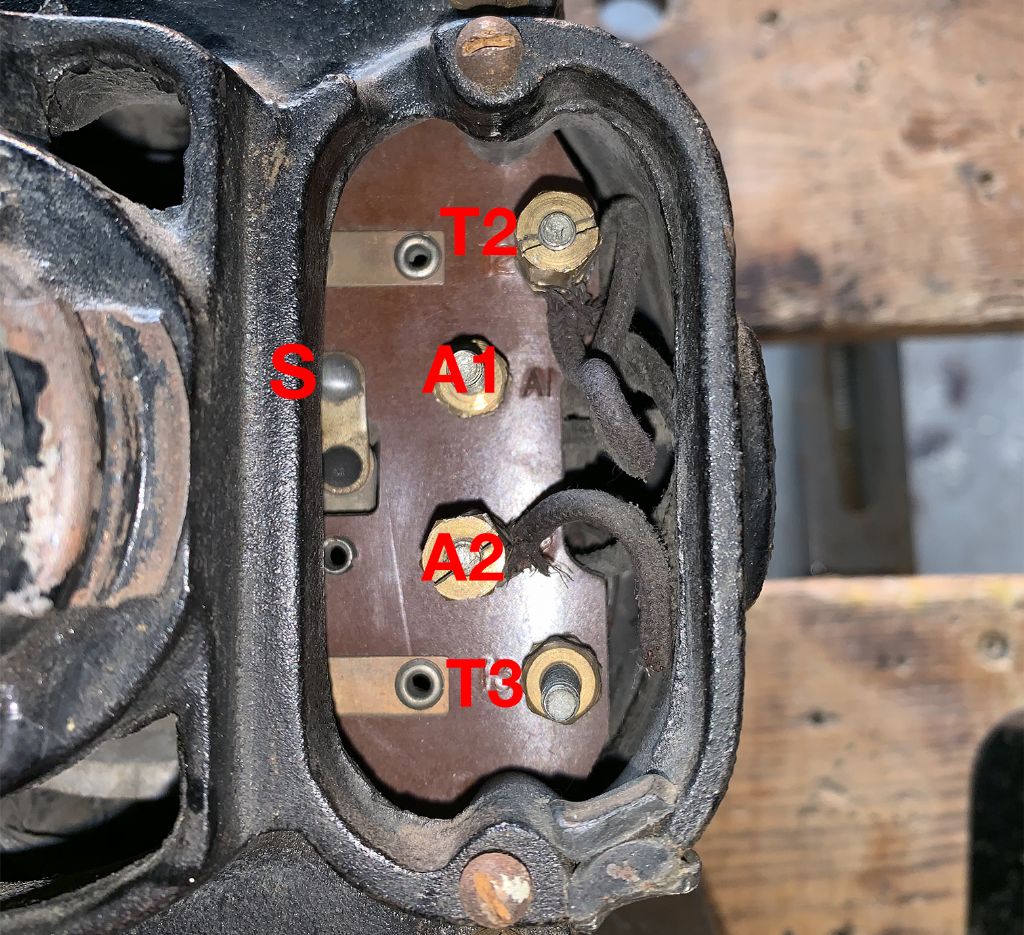

      So I recently picked up a 1/4hp Thomson Houston Motor in a job-lot of tools, I already have a 1/3hp one wired up in my drill press and I'd like to turn this one into a disc sander. Problem is this one is wired up differently to the running one I have already. The working one is wired to A1 and A2. Neither have capacitors so I assume they are induction motors. Neither had any instructions on the case for wiring. I wasn't sure whether this had been wired differently to work with some sort of reversing switch?
      There was another thread on here with an almost identical AEI motor that also came to the conclusion that A1 and A2 were the correct wiring for motors with no capacitors.
      This one has internal wires going to A2 and T2. When wired to these two I get a humming sound and no spinning so I tried moving wire T2 to A1. This got the motor running but there was a small spark at S. I stopped and tried measuring continutity/resistance to see if I could work out the different windings but the only thing I'm totally sure about is that T3 isn't connected to anything.
      A2 > T2 9 Ohms
      A2 > A1 22.2
      A1 > T2 31
      Has anyone else had one of these motors or similar and can point me in the right direction? Or does the spark mean it likely has a fault and there was a reason this wasn't wired to a plug already.

          Hmmm, single phase low power AC motor with no capacitors? Could well be a shaded pole motor. Been there, done that, and binned the motor. When I first got my surface grinder it had been modified to have separate motors for spindle and power feeds. The spindle motor disappeared in a shower of sparks in short order; that's rubber insulation for you. So I decided to revert to the original design of a single motor in the base driving both spindle and feeds. For that I needed to reverse the motor in the base. I tried all combinations, for one configuration it ran, but all the others it grunted or made buzzing noises with no action. Talking about it at work someone suggested it was a shaded pole motor, which generally can't be reversed unless you take them apart and physically reverse the shaded pole. Shaded pole motors aren't really suited to machine tools as they have almost no starting torque. In the end I binned the motor and fitted a 3-phase one.
          The T terminals may be some sort of temperature device, although shaded pole motors are noted for only a small increase in current drawn in the event of a stalled rotor.

            In your own interest and well being and before doing any thing at all, you ought to carry out an insulation test on the motor windings, using 500 volt DC Insulation tester, this test will tell if the motor is safe to use. The motor is obviously very old. Having got that off my chest and using your values of resistance A2 & T2 is your run winding and A2 & A1 the start winding. These two windings should be connected in parallel one to another. Supply to A2 & T2 and your motor should run in one direction or other and don't forget that good sound and clean earth connection.The sparking came from the internal centrifugal switch which is connected in series with A1 & A2. John

              The other working one I have I reversed successfully by swapping the wires to A1/A2 terminals. I was thinking from what I'd read that this was maybe a split phase motor?

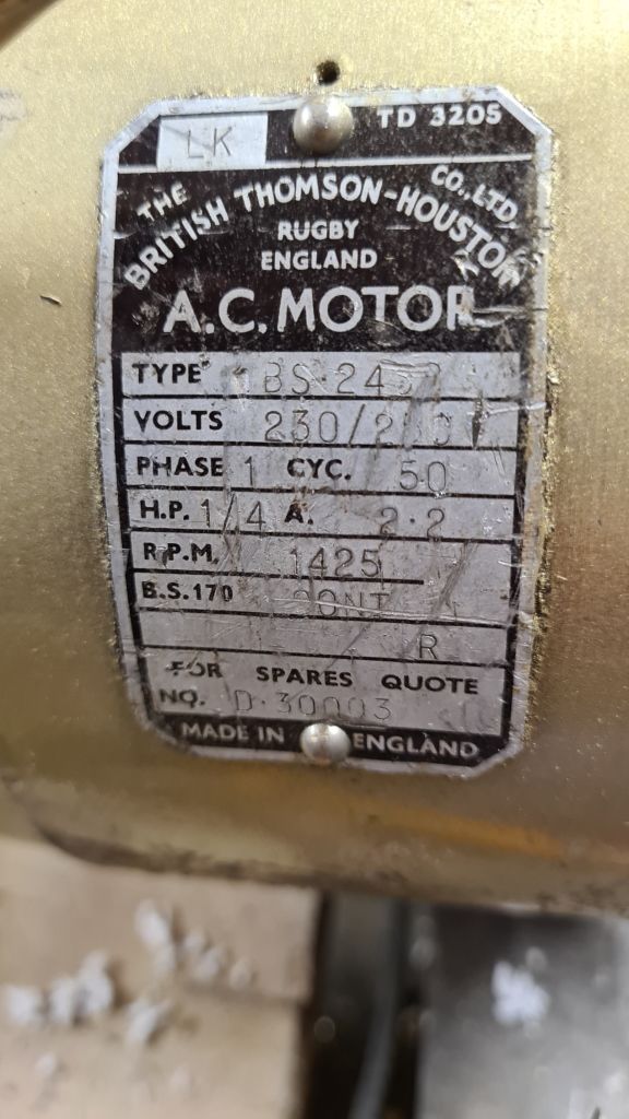

                I now have my own 0.5hp 240v 1ph BHT motor on a Kerry's Super 8 drill press and evaluating whether it is safe to continue to run it or better to replace it. The motor runs quietly so assume bearings are fine. Apart from blowing a great cloud of black dust out of it with an airline I have not investigated further at this stage.
                I found a slip of paper inside the terminal box and have scanned it and added to my photo album for reference. Terminals A1 and A2 are for live and neutral, presumably either way round. Says "To reverse rotation interchange leads from inside motor to terminals" which leaves me none the wiser.

                  As John mentioned in a message above, I would definitely recommend getting hold of a Megger or similar insulation tester to test your motor. The motor I started this thread about turned out to be pretty iffy when tested, suggesting the insulation was failing despite the motor still running ok. Hence I decided it was safer to use another motor that passed the test.

                        I am looking at the BTH fractional hp motor diagrams,
                        There are many variations for the BS24 motors, all have A1,A2,T2,T3 on the terminal plate !
                        IF yours has a built-in centrifugal switch then A1, A2 are all you need. T2,T3 are unconnected spares.
                        T2,T3 are used with a capacitor to get a reverse mode.

                            Many thanks for replies so far – much appreciated. I forgot to say it is a BS2410 model. I'll work out how to borrow a Megger tester, and attach an earth cable via an eyelet to the screw on the cover plate.
                            I've added some further photos in the album on this. Above the rear bearing there is a vacant screw thread – I assume this is for a wicked ball oiler. Could someone confirm please?
                            Now I understand this can be run in reverse, could anyone provide the exact wiring diagram (i.e. to connect to T2 and TA as J Hancock suggests) and the specs for the capacitor and the type of switch I would need, please?

                              My pocket book shows the BK2408 with foot, axial and radial mounting features.
                              It says BK24 are 3-phase .
                              BS are classed as split-phase, BC capacitor start.
                              Some are shown with hand reset, or auto-reset units mounted on the terminal cover.
                              No mention of S anywhere.
                              The standard connection shows Main winding across A1-A2.
                              Aux (start winding ) in series with centrifugal switch also across A1-A2.
                              Whether you need a capacitor ,or not, for reversing will depend on it being a split phase motor ?

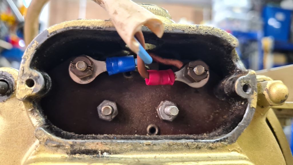

                                I came across this forum while seeking the answer to "How do i get my Thompson-Houston AC motor to reverse it's rotation, my motor type is BKS2410 1/3 hp, Ph !, Rpm 1425.
                                From all your replies I pieced together the answer for mine.
                                Remove the lines in from A1 & A2.
                                Swap around the two wires underneath that connect A1 & A2 to the motor insides.
                                Replace the lines in as before.
                                It worked for mine.
