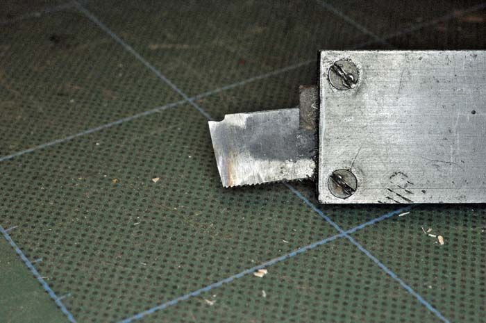

          I have done what you suggest without problems. Don't make the thinned bit longer than it needs to be.
          An alternative is to use a HSS hacksaw blade in a holder:

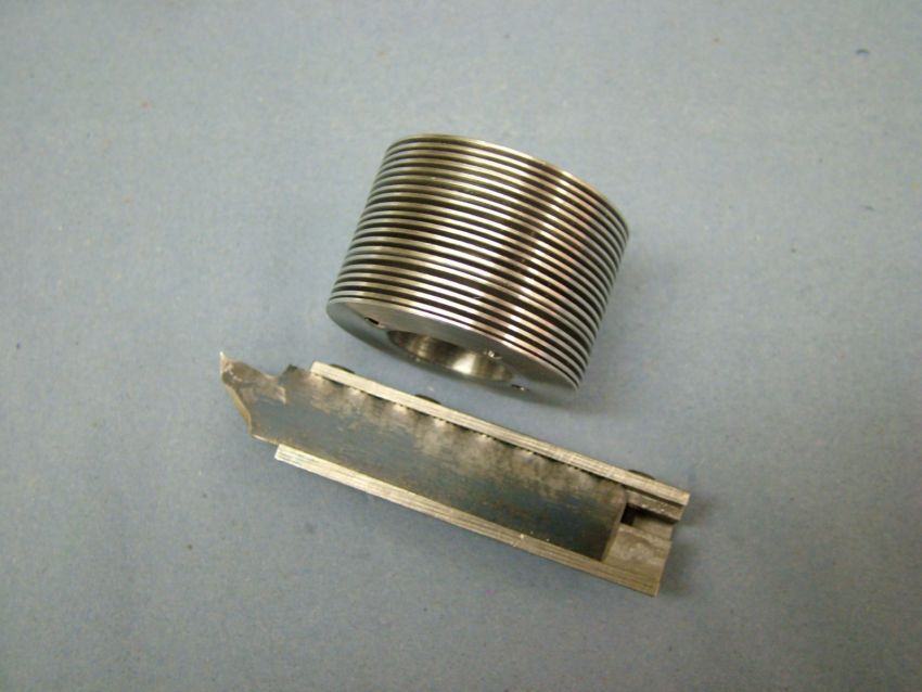

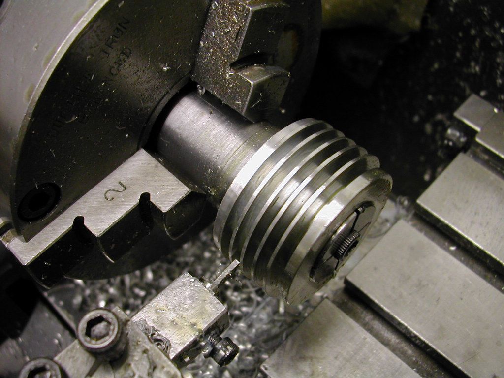

              Further to Rod's post about using a hacksaw blade I remembered I have these images doing a special head for an ETA 15d
              I also did a scaled up to 5cc version of the above and used another cutter ground from a 1/4" dia FC3 cutter shank to do these very deep fins.
              Best – Tug

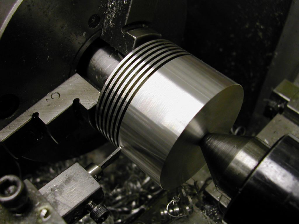

                    Cutting the 0.6mm gaps in EN16 to leave fins on a Whittle cylinder, tool is ground HSS and did 9 cylinders without regrinding. Youtube video link below.
                    **LINK**
