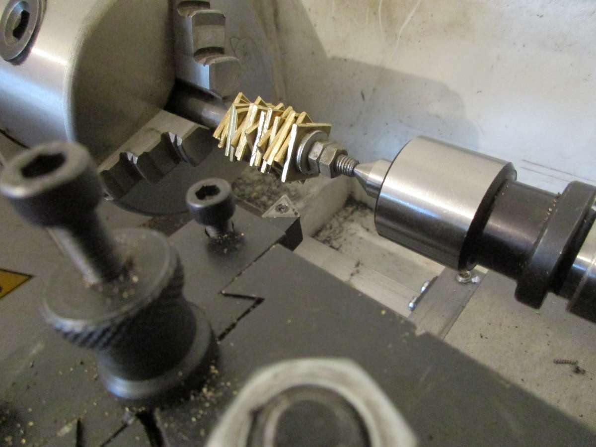

            I think I would start from scratch. Drill holes in some 1/64″ or 0.35mm sheet, cut out roughly, screw several to an arbour and turn the OD of the stack.

              Thanks Jason. Think I’ll make them out of some sheet and put them on a mandrel to finish as I can surface grind something to the right thickness before I start.

                0.35 shim stock cut inside dia hole with step/cone drill then rough cut (snips) the od. Turn a mandrel from material larger dia than required od plus a thick washer then sandwich blanks with bolt and proceed to turn shim od and your done. I have made shim washers down to 3 thou like this .

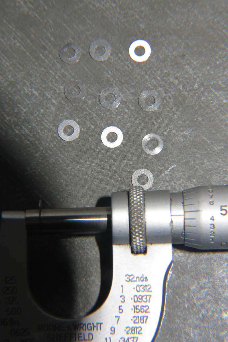

                                Just made 10 as suggested by Jason, drilling then grinding to thickness before very carefully cutting (dremel) to an oversize and finishing on a M4 arbour.

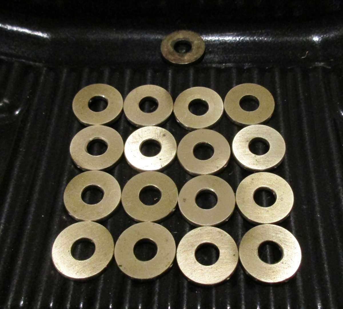

                                  Hi, I made some brass washers the same way JasonB has said, way back in 2019, although I needed a larger diameter and the thickness wasn’t critical.
                                  Washers
                                  Whasers2
                                  Regards Nick.

                                        Made from shimstock as per my postIMG_7103

                                          I not only made some the other day because I wanted 2mm thick (M6) washers, but because ordinary washers seem to have a huge clearance hole and often don’t look very neat on a project. The issue for me is often having the right thickness material in stock or I’d make them more often.
