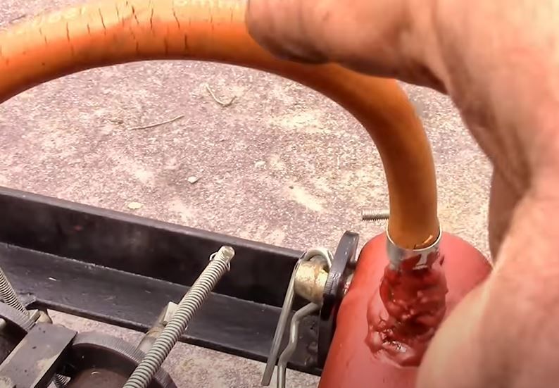

                  Nigel, 3000 psi sounds reasonable for an air bottle, 207 bar. Some diving air bottles are rated for 300 bar.
                  #602742
                    It's not the bottle, it's some of those welds on the inlets to the cylinders that may see the full 3000psi with no regulator. I know the limits of my welding. That's if the perished hoses don't let go first.
                    Edited By JasonB on 23/06/2022 08:14:13
                    #602748
                    David Jupp
                      @davidjupp51506
                      Yeah – or the lack of clips on some of the hose attachments. I think I spotted 2MPa on the hose (20bar) – which would have been its rating before it perished.

                            My comment about working pressure was not whether the cylinder would take 3000psi but whether the machinery would, especially with no pressure-regulator.

                                    Hi, apart from anything else, the one thing I would really have a concern about, is that hose that runs from one end to the other with the supply coming from the cylinder connected to it. This is just hanging in mid air and if by some misfortune, any of the connecting points blew apart or the hose snapped off, you would have a hose flying about like an uncontrollable whip, even at 30 psi, let alone 100 psi, which could cause severe injury or even be fatal if the end should hit anyone and more especially if it had part of a fitting on the end of it. One of the most important safety aspects that was stated in my pneumatic courses that I did, was that flexible hoses and pipelines should be adequately secured to framework or on properly designed trays, in the event of them coming apart and releasing compressed air. It's bad enough even when a short length is whipping about under pressure.
