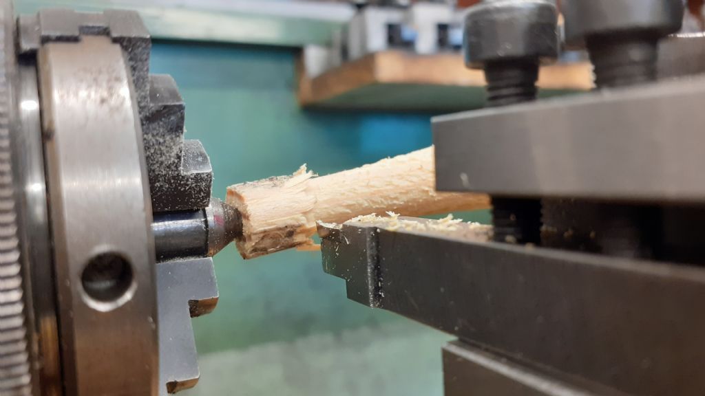

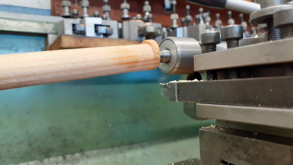

                      Dave did you miss my practical demonstration as well as the CAD simulation, here it is again, looks a lot like Duncan's link to me. It is that constantly changing relationship between tool an angled workpiece axis that produces the curve. adjusting where the two axis meet simply moves the deepest part of the waist.
                      I won't come out barrel shaped as the tool does not go anywhere near the tailstock end when set on headstock ctr height.

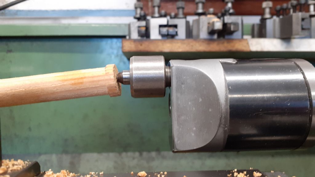

                          Interesting video, Jason. The definitive answer. How much higher than the headstock did you make the tailstock to get that pronounced result? Just curious as to the relationship between diameter and offset to achieve such a result.

                                Hopper, height difference is about 20mm, the holes on the boring head are 3/4" apart and I'm a little offset upwards. length approx 150mm
                                I mentioned this morning that with tool on ctr height at headstock end there is little chance of it cutting a barrel as the work is furthest from the cutting tool at the tailstock end, you can see how far in my exajerated example.
                                Though if one was turning a bit of bar with the intention to measure for taper the tool would be feed in at the tailstock end and the cut started from there and the resulting full length cut would be a concave surface along the bar being largest at the headstock end. Most people would just measure each end and assume a straight taper and for all intents and purposes that's what it practically measures. But certainly not going to be fat in the middle

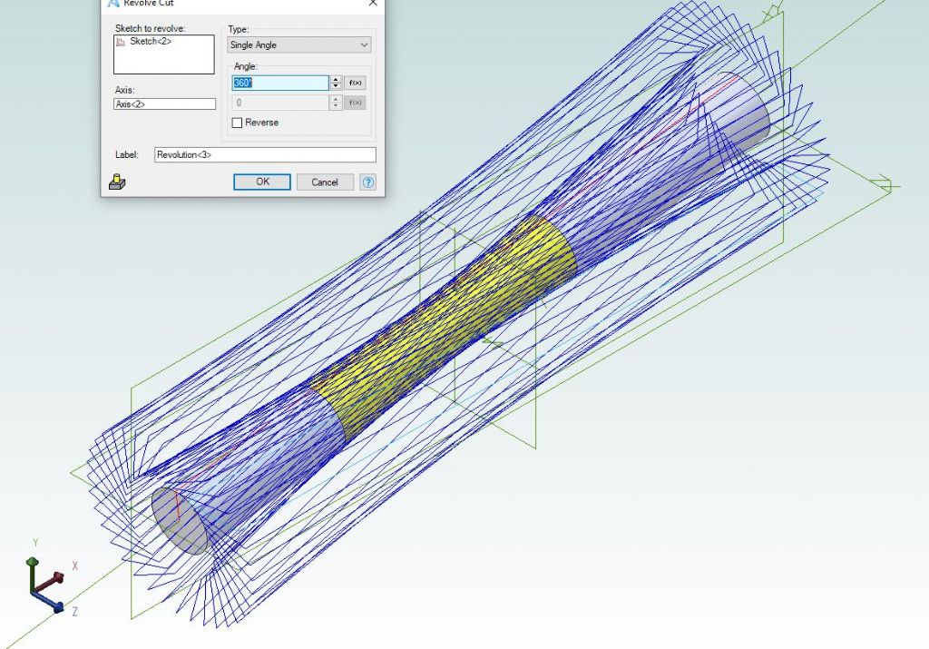

                                  You can see in this image how the CAD revolves the "cut" around the axis of rotation which is just like the series of straight lines in Duncan's link sowing how the shape is made up.
                                  The way the blue lines representing the cuts can be seen to flair out even more beyond the arear they can further confirms that you won't get a barrel shape.
                                  Edited By JasonB on 06/01/2023 10:11:44

                                    Great illustration, Jason yes
                                    Physically producing those lines, with a pen held in a sliding block, was exactly what I had in mind when I suggested using the Dividing Head set-up.
