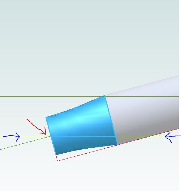

      Hopper I was commenting on DC31K's post and Martin's subsequent comments
      EDIT
      Effect of setting the tool height (blue arrows) to height of axis at headstock end  just moves the deepest part of the convex cut to the point where the two axis cross (red arrow) So if one was to only measure an actual workpiece at each end you could be forgiven for thinking you have a constant taper particularly as any taper is likely to be very shallow the concave will not be visible to the eye
      Edited By JasonB on 05/01/2023 10:18:50
      Edited By JasonB on 05/01/2023 10:21:18

                          Well for those that doubt the new fangled CAD I thought something more practical may be of interest. Not fancying cranking my rotary table round and round to use Michaels adjustable tailstock suggestion I came up with teh idea of offsetting the tailstock ctr, not horizontally but vertically using a boring head.
                          First cut shows the effect of having the tool height mid way between the headstock and tailstock heights which as the CAD showed produces a concave waist. Second is with tool on headstock ctr height which just shifts the position of the narrowest part of the waist. Did get so tool rubbing on teh first setup as the tool was way too high and I think diameter plays a part a sthe second option is not quite so curved but dia is smaller

                            This topic has generated more than its fair share of theorems. It's quite simple, if the tailstock is offset vertically you generate a circular hyperboloid
                            No need for physical tests, the maths is well proven. This is the shape of cooling towers amongst other things
