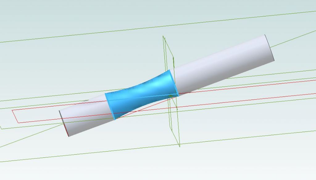

                              Dogma.
                              Assuming cutting between centres:
                              With a perfectly set up lathe the tool will be on centre line and the distance of the tool tip from the rotational axis of the bar being cut will not change from one end to the other. The result, if there is no deflection and no wear on the tool tip, is a perfectly cylindrical bar.
                              If the tailstock centre is higher or lower than centre then the correct cutting height will only occur at one point along the rotating bar. As the tool moves away from this point the effective distance from the rotational axis to the tool tip will increase slightly. So where is the tool set up to the correct height?
                              If at the headstock there will be a taper that increases in diameter as the tailstock is approached.
                              If at the tailstock then it will increase in diameter as the headstock is approached.
                              If in the middle then the diameter will increase either side away from the centre.
                              The last case is the nearest to a barrel but in an inverse way as it is narrower in the centre than at the ends.
                              This tapering effect is only noticeable at small diameters and long parts, it decreases as the material diameter increases and for most people making a long thin part will probably require a travelling steady that will negate a lot of these issues. This is making a mountain out of a molehill that will make virtually no difference to the majority of work done on a lathe. The horizontal error on a tailstock can cause far more error and that is what needs to be concentrated on. With a suitable dumbbell setup bar you are setting the tailstock over to the point where the readings at both test points on the dumbbell are the same. This will negate any small height error in the tailstock as you would be moving the actual tailstock horizontal position to the point where the axis of rotation distance to the tool tip is the same at both ends which is not necessarily on the exact horizontal centreline of the axis of rotation. The height error is thus accounted for and so irrelevant.

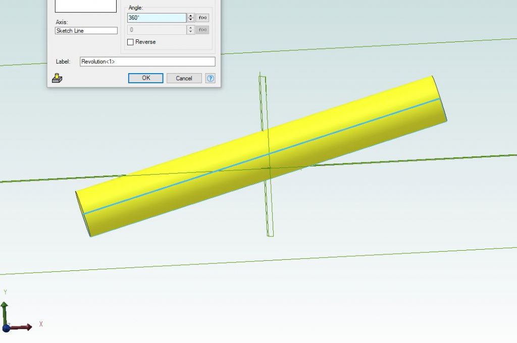

                                        I'd agree with martin, if head is high and tailstock low and tool at mid way then a concave part will be produced not a barrel
                                        No need for anything more than holding a straight edge horizontally against something cylindrical which is at an angle and you will see the straight edge(toolpath) only contacts the cylinder in the middle so that is where material will be cut away

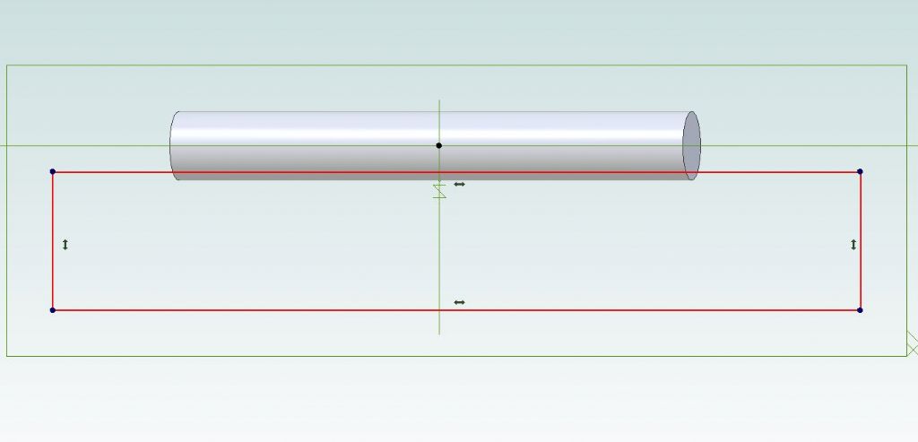

                                          Cad model for thos einterested
                                          First create your workpiece with head end low and tailstock end high
                                          Draw a rectangle to represent material removed by a cutting tool moving along the bed at mid height
                                          Simulate what happens when the part rotating on its angled axis meets the horizontal tool path

                                                  Hopper
                                                    @hopper
                                                    Jason, shouldn't the simulation be head end on centre, tailstock end high, not head end low and tail end high?
                                                    #627641
                                                      I suppose by the time the angle has been reduced to what it would actually be if there were only a thou or two height difference and an allowance made for the work flexing away from the tool which would go some way to counter act the concave cut it may simply be so small a difference that it is simply not worth getting excited aboutwink 2
                                                      Best not get into the effects of having one end in a chuck and the other supported with a ctr vs, turning between ctrs as that introduces bending into the partdevil
