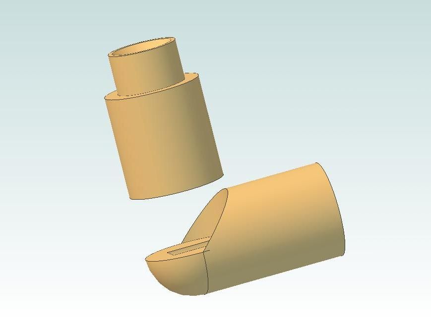

      Andrew, if you make it like this by plunging half way in with a slot drill the socket that is formed will hold the bertical part nice and firmly and also at right angles and is a lot easier than trying to line up a mitre cut. once soldered you can hold it upside down by the vertical part on teh rotary table to round off the end and then either file the remainder or use a rounding over bit.
      Works quite well

        I wasn't planning to make a mitre joint, but one like this:
        All that's needed after silver soldering is a quick clean up of the joint and drill out of the holes to depth. I'll probably use a short threaded spigot on the vertical part to hold the halves in alignment. The thread will disappear when the holes are drilled to depth.
        The only thing I'm not sure about is part of the silver solder joint being in tension rather than shear.
