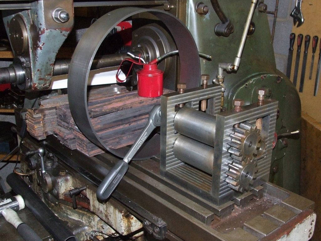

                                Anonymous
                                  Looking good Jason – where are you getting the designs from? Are they on the drawings or to your own design? I was wondering why nobody had picked up on my question. It was beginning to look like no-one was reading the 'Workshop Progress' thread, which would be rather ironic given the recent fisticuffs bemoaning the lack of engineering input on the forum. From a combination of sources it looks like silver soldering LG2 should be no problem. I don't understand what you mean by drilling round the corner?
                                  Apart from mucking about with the PathPilot installation on the CNC mill today I also machined to length and rolled a new front wheel rim to replace the duff one. Here are the home made rolls and said new rim:
                                  I've also cleaned up the large scrap aluminium plate ready to be used as a jig for building the wheels. The plate was cheap from my normal aluminium supplier as I asked for a minimum size, didn't care about thickness and most of all didn't care about gouges. It's win-win, they can get more than scrap price and I get it much cheaper than normal.
                                  Andrew

                                  John Stevenson 1
                                    @johnstevenson1
                                    Andrew,
                                    More details please of the rollers.
                                    How do you get the ring out after rolling and what thickness is the rim you rolled.

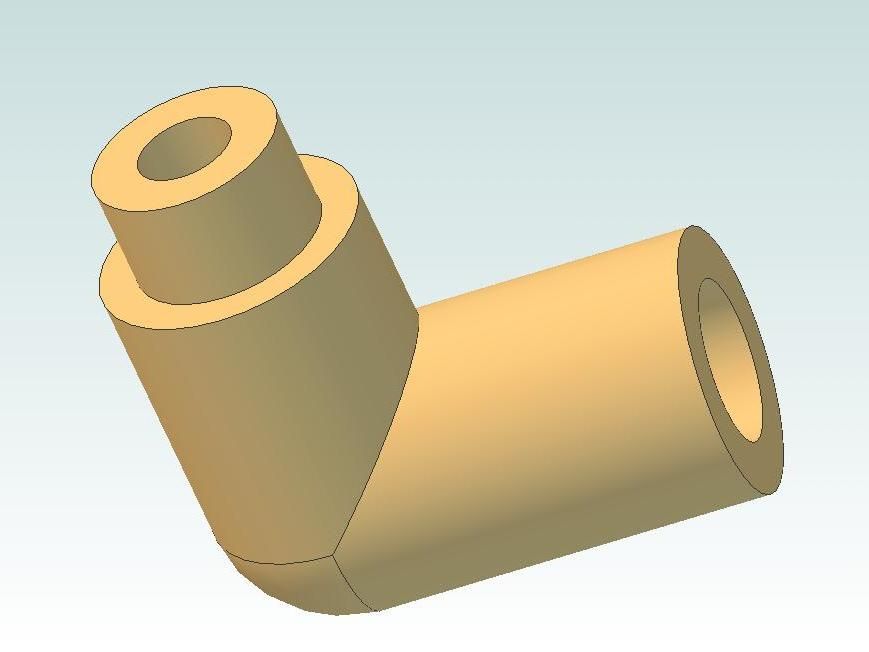

                                      Andrew, I'm working from some photos of an original engine taken by another forum memmber, (you may have seen his full size one at Fornsett or in ME recently) and also the odd photo found on the net. I have drawn it all up from these at 2/3rd scale and it will be featured in ME along with a full set of drawings.
                                      On your fittings would it not be easier to use bronze bar as its a bit harder than gunmetal and readily available in various round bars? By drilling around the corners I wa srefering to drilling in from each end of the elbow so the holes meet in the middle and hopefully don't come out the other side. That is how the drain cocks were done
                                      As were these elbows & tee
                                      Edited By JasonB on 27/12/2015 07:58:56

                                        Andrew, LG2 silver solders fine
                                        Jason, those fittings look great

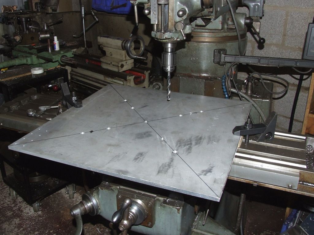

                                        #218056
                                        Anonymous
                                          After wasting a good portion of the day trying to get tool offsets working in PathPilot I managed to salvage something by marking out, drilling and tapping (1/2" UNC) the fixing holes on the jig plate for my traction engines wheels. Only the holes needed for the front wheels have been done so far, but they'll keep me busy for quite a while.
                                          Andrew

                                          Anonymous
                                            John: The rolls were specifically designed for rolling the rims of my traction engine wheels. The rolls are a bit over 2" diameter and the gears are 13 teeth, 5DP. The front rims, as seen in the picture, are 3" by 1/4" and the rears are 5-1/4" by 3/16". To simplify the design the rolled metal goes down under the mill table. A CAD model showed that there was enough clearance on the front wheels (14.5" OD) to do this. Again to simplify the design the rolled rims are simply opened up enough to clear the rolls to remove them and then allowed to spring back.
                                            In the event I didn't roll the rear rims on these rolls as somebody on another forum kindly offered me the use of his larger geared rollers. The rolls were originally intended to have deep grooves to roll the T-rings, but I got these laser cut in quadrants to be welded together, so the grooves were never machined.
                                            The rolls exist as a CAD model so drawings are available.

                                            Anonymous
                                              KWIL: Thanks, that three people saying it will be fine silver soldering LG2, so I'll stop worrying about it.
                                              Ok, I understand about the drilling now, that's what I was going to do, except that I'll probably use a ballnose slot drill to get a nice smooth transition at the bend. This is what I want the elbows to look like:
                                              I don't see how I can make them from solid without a lot of filing to get a nice smooth finish round the bend as it were! It should be simpler to silver solder two parts together? For scale the OD is 3/4".
                                              Andrew
                                              #218138
                                                Isn't that what you have a CNC machine forsmile p I've seen some very nice fittings CNC'd from solid.
                                                I'll sketch out how I did the Fowler elbows which are similar as I did not do a straight forwards mitre joint.
