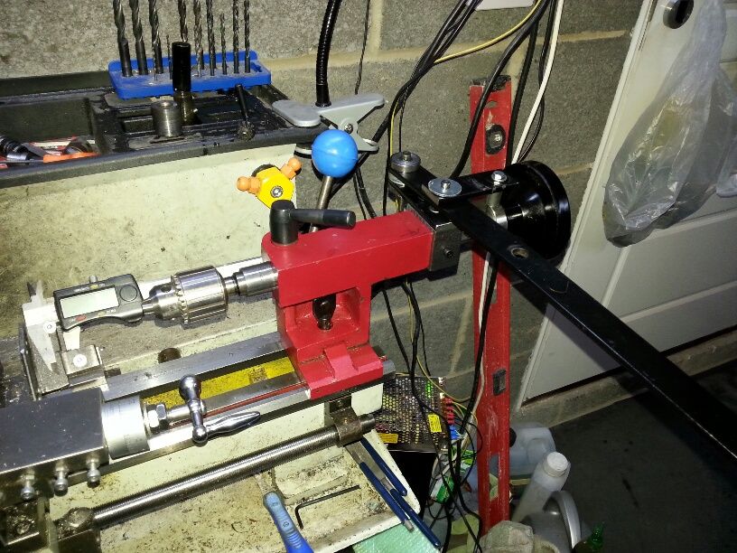

          Finished my lever tailstock today only to find that when applying pressure to the drill bit the thing twists. The clamp bolt is tight. Looks like I will have to redesign the linkage so that the force is along the bed.
          Had more luck with my lantern chuck!
          Cheers Michael.
          #207525
          John Stevenson 1
            @johnstevenson1
            Michael,
            Change your linkage over and put the link at the back.
            I originally had mine like yours and experienced jamming etc.
            John S.

                  I bought a secondhand tailstock to try and make a lever action ram but found it too hard work when drilling larger than 6 mm or so…too much force needed so back to the drawing board and a BL mini steering rack was put into service as a sort of capstan drive
                  Works well.. lots of feel on small bits and lots of power with larger ones

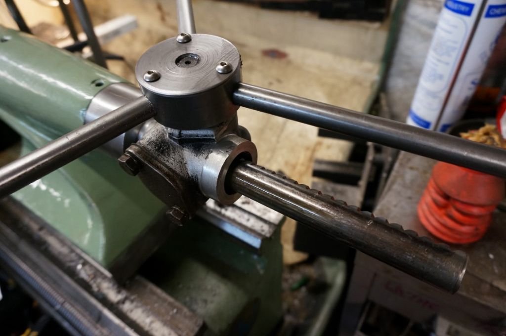

                    This was my lever action unit made the block that screws into the casting so it was just a modification to mount the steering rack

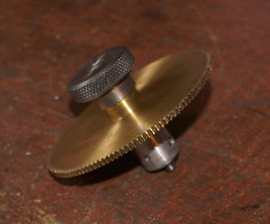

                                Made the indirect mandrel indexer from an old 120 toothed wheel I was given. I turned a 10 TPI worm to fit it and mounted it on a bit of ally angle.
                                The wheel grips inside the mandrel, just tighten the knurled knob.
                                One turn of the handle = 3 degrees.
                                I shall scribe 12 lines to give 15 arc min divisions.
                                I only want it to put the flutes in the Lady Stephanie columns.

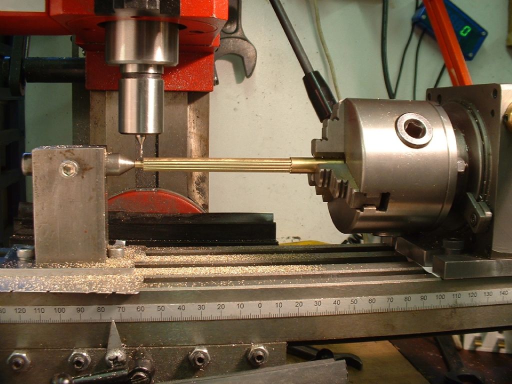

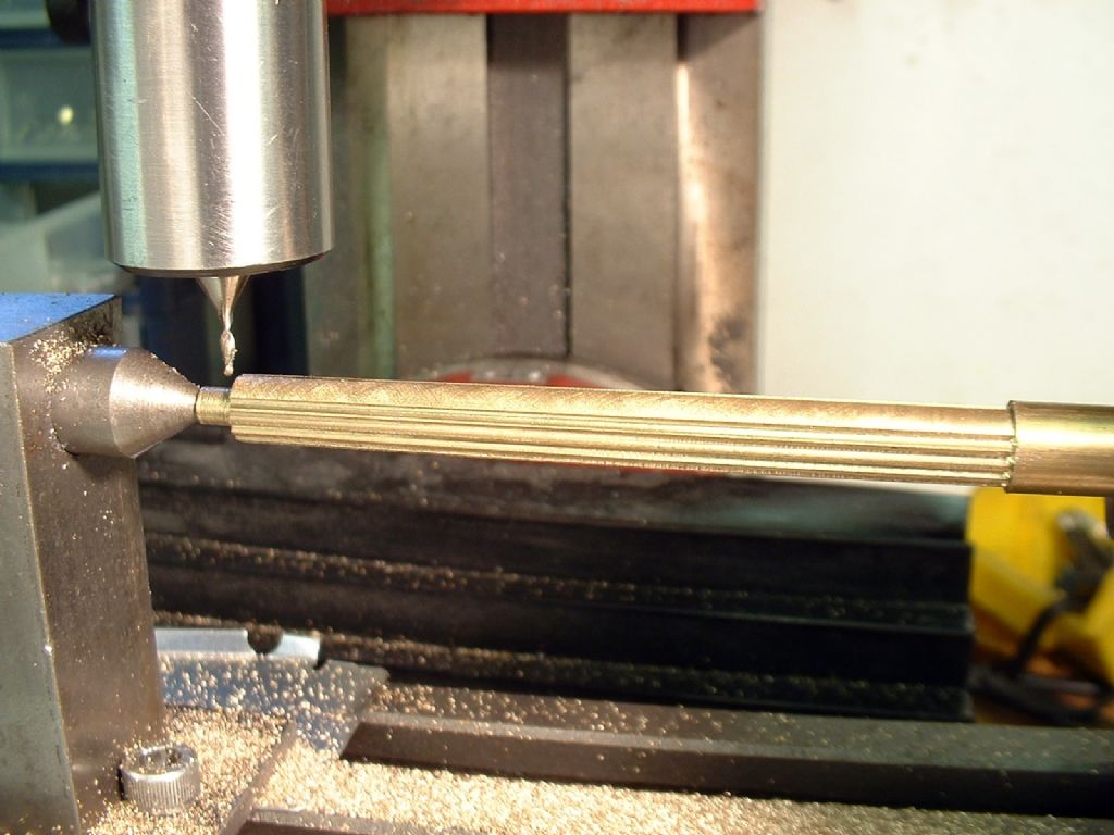

                                  LS.. column fluting – my setup, note packing under tailstock.
                                  As they are brass when you break the round nosed 1/16" end mill you can grind up a replacement from the stub

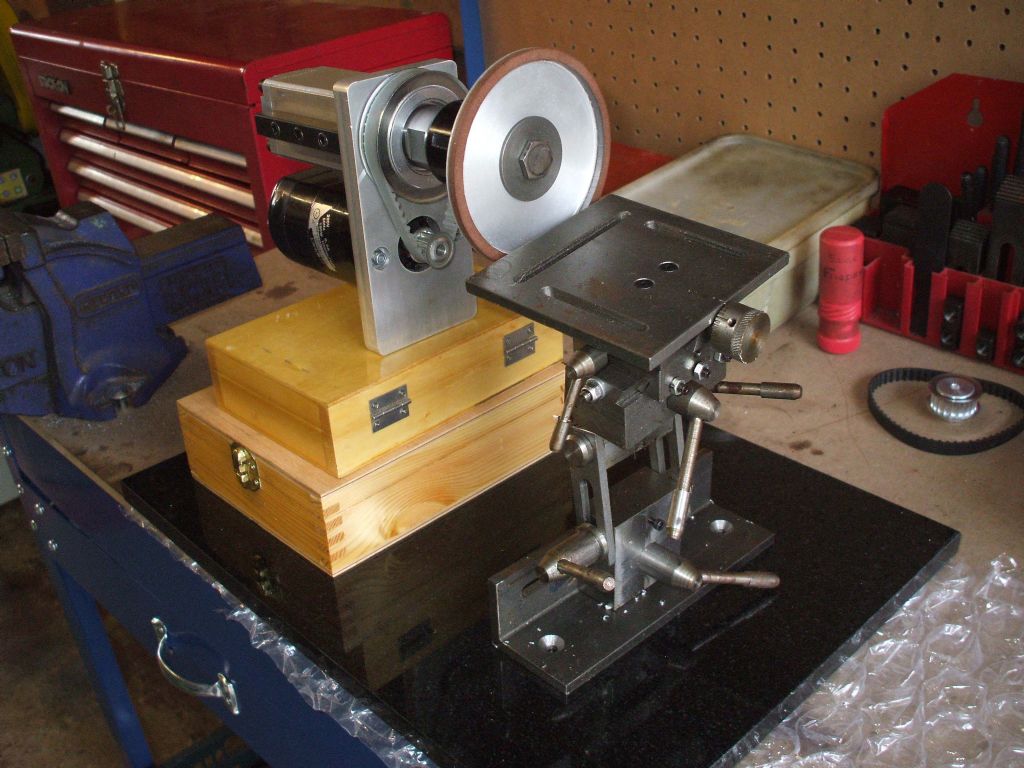

                                                Never one to pass up the opportunity to flog a dead horse, I've just finished version 3 of my tool post spindle. I hope I have combined the best bits of the previous two designs and come up with the final article. More by accident than design, however, is the fact that I ordered the wrong size toothed belt for the combination of pulleys that I selected. This, however worked to my advantage as I was able to juggle the collection of pulleys in my stock and, by re-ordering a belt 15mm longer, was able to mix and match belts and pulleys to give various ratios with the same centre distance. The results of my labours are shown below:
                                                Toolpost spindle v3 front view Toolpost spindle v3 rear view
                                                Front view with alternation pulley/belt combination. Rear view – ditto.
                                                With the exception of the largest/smallest pulley combo, swapping the pulleys from driven to driver, as well as combining with the crude electric speed control, an useful range of speeds can be obtained. The spindle mounts in the QCTP on the lathe either radially or axially.
                                                Following a brief period of navel-gazing, it occurred to me, that with suitable mountings, I could also use the unit as a basis for a tool grinder/sharpening device. A quick rummage for some boxes and the addition of a Harold Hall grinding rest resulted in this mock-up:
                                                Sharpening mock-up
                                                Just when I thought I'd finished – another project looms!

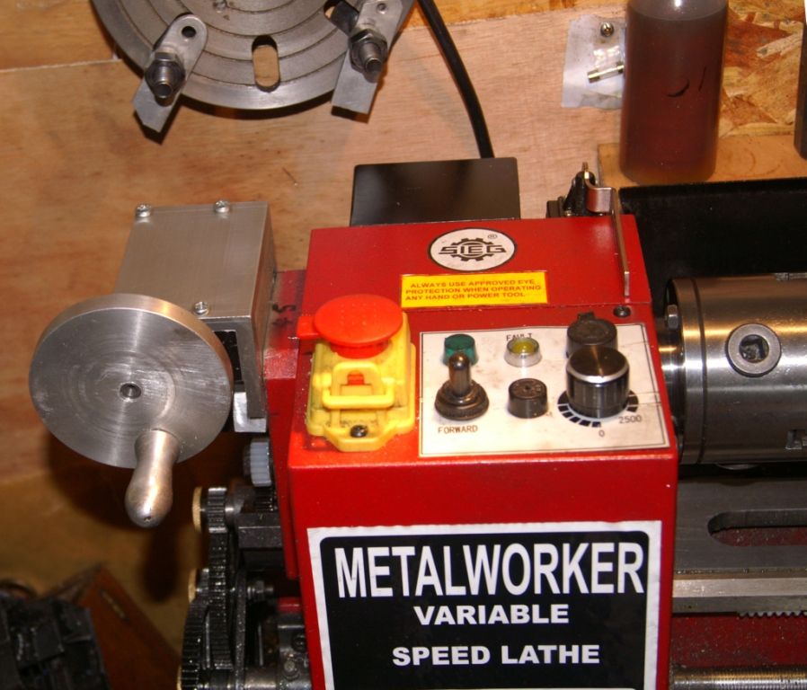

                                                      Plodding on with my small gyroscope build… have machined the flywheel & lightened the centre, having drilled the holes using DRO co-ords as the first attempt indicated an out of balance somewhere. For those interested I set up on the ally sub table I made last year, held in the vice…
                                                      Simple enough from drawing but lets see if it works this time…?
