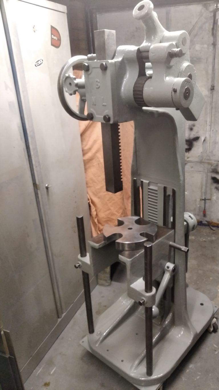

            Posted by Buffer on 19/05/2022 09:31:06:
            Pete that's a great job, what was the wire you used?
            Thanks

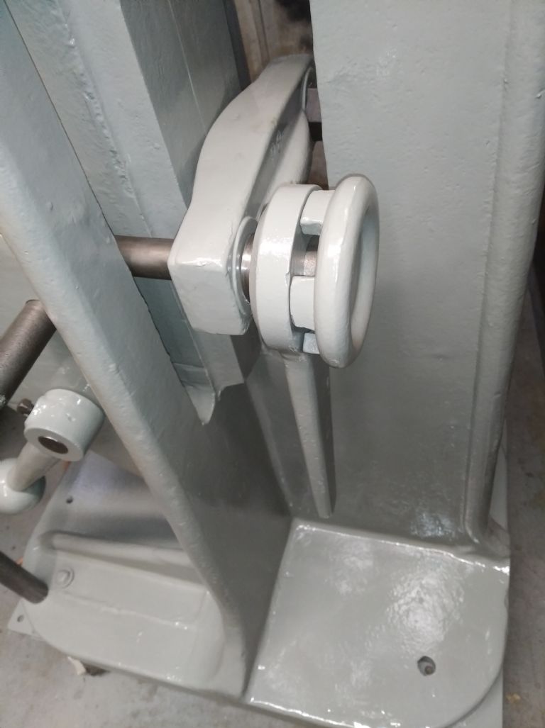

            Hi, the wire used is SIF no8 bronze mig wire, bought from R-tech welding, it is used with pure Argon gas, and aluminium torch tips with a Teflon liner in the torch.
            This is recommended as a bearing surface so could be useful for building up worn areas and then machining.
            The liner was about 11 quid on ebay, the wire was 30 something plus post for a 0.8kg reel, not cheap but should get a good few repairs out of it.
            I'm not familiar with inconel 82 brazing wire, all I know is it's an extremely expensive material, never seen it for sale anywhere.

              Finished for now, a few little bits to do when time allows, replace the hex head screws clamping the support legs with hand knobs for convenience, and need to make crank handle for the table lowering and raising, but it's usable now.

                Wow! That is an excellent piece of kit you’ve got there Pete.

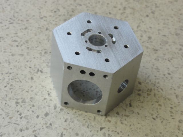

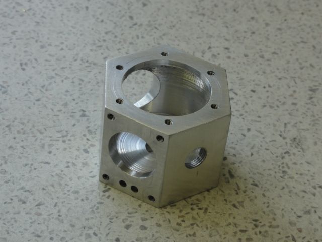

                  Having completed the Norden engine and cleaned the workshop I was at a bit of a loss looking for an interesting follow up. Scrolling through the Mad Modder site I came upon the very thing, a 3 cylinder radial single acting engine. Originally designed, I believe, by Edgar Westbury as the Cygnet Royal and subsequently simpified by Elmer Verburg. This version is an amalgam of both designers thoughts put together by Stew Hart.
                  This is Stew's engine and what I am aiming for.
                  To kick off I took a piece of aluminium bar:
                  And removed most of the metal from it until I was left with this:
                  For scale the flats on the hexagon are 25.4mm wide.
                  The next opportunity for me to make a mistake is the 3 cylinders and their cast iron liners. Wish me luck.
                  Jim

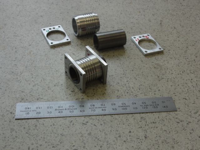

                    Well, it's only taken me a month or so but some progress has been made. The cylinders as drawn are made as a 1 piece aluminium tube with squared ends and a cast iron liner.
                    Looking at materials I had to hand I made mine as the ali tube, separate end flanges and the cast iron liner:
                    Since my engine will only ever run on air the parts were assembled using Loctite 638 which I have very confidence will hold.
                    Next will be the cylinder heads, which are straight forward, and the crankcase breather then I can look at the crankshaft and its housing.

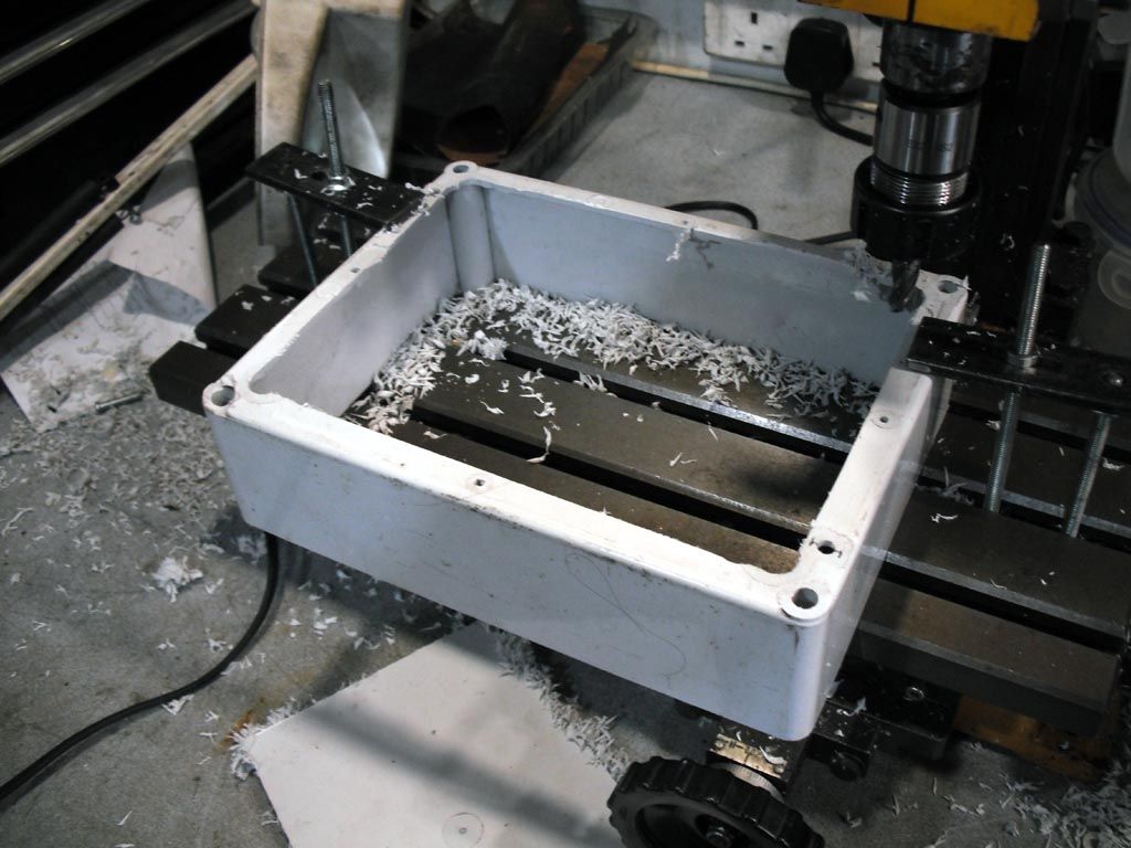

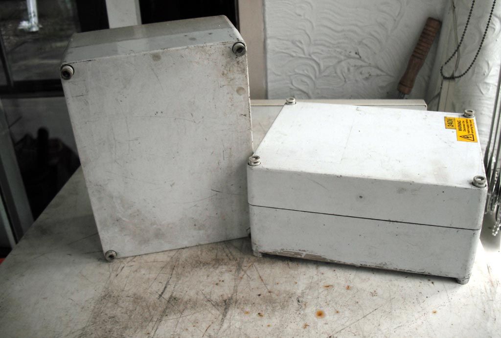

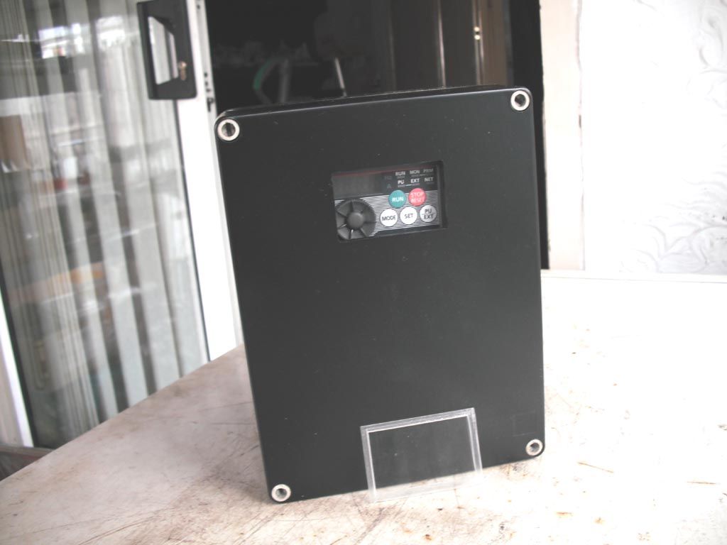

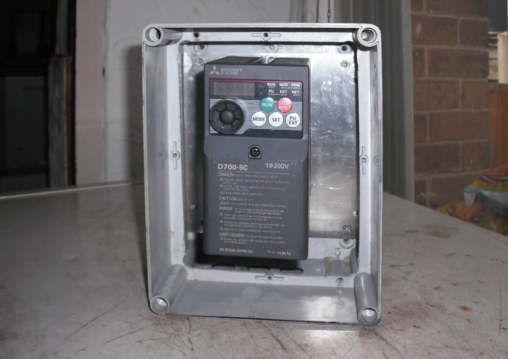

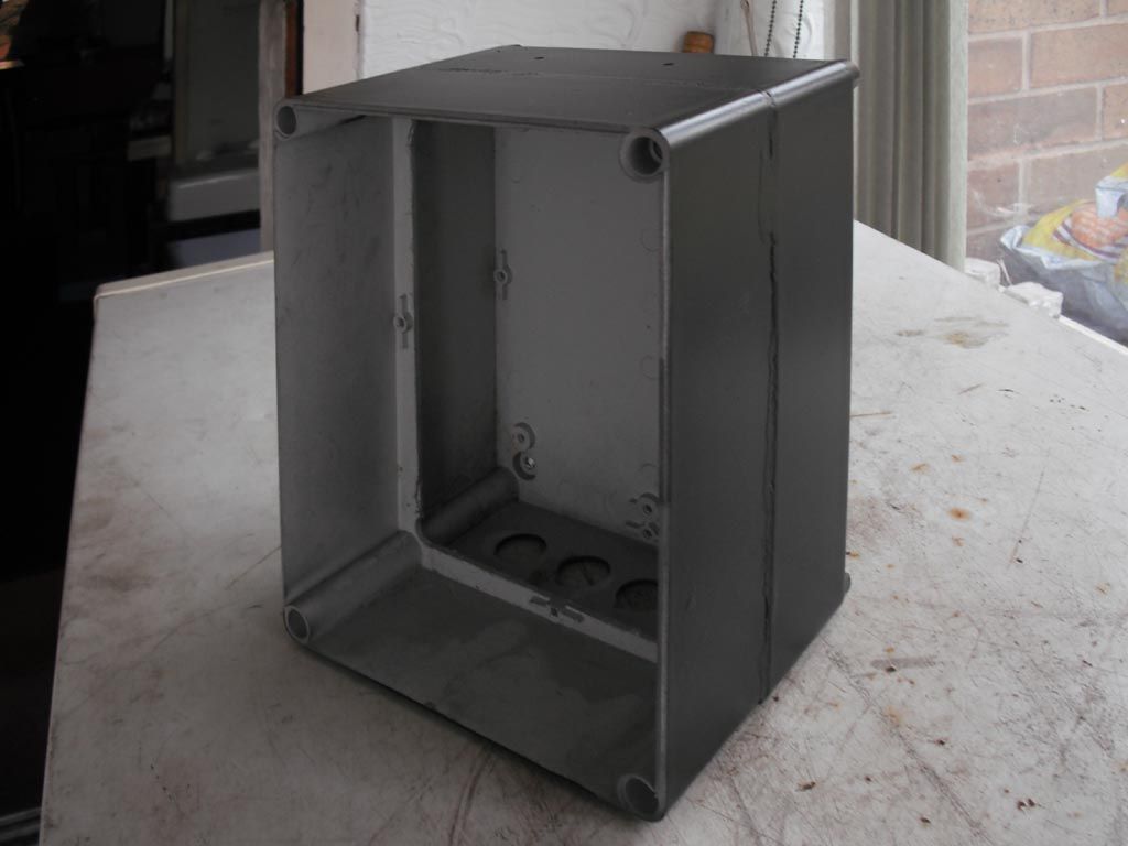

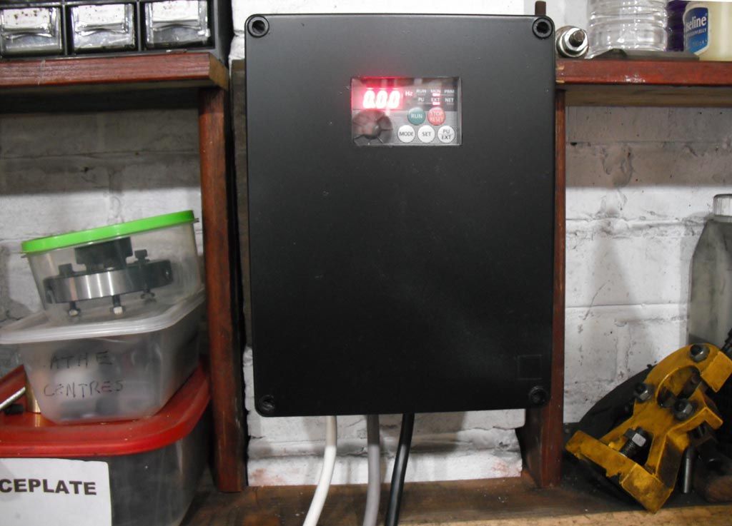

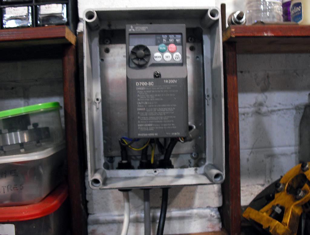

                      I recently finished converting my lathe to a 3 phase inverter/ motor drive. I've had had no luck finding a suitable enclosure for the inverter. Those that are deep enough are far too big in height and width. I had a dig round in my old installation gear and found a pair of boxes about right for height and width, but not deep enough.
                      Measurement showed that stacking the boxes on top of each other would give sufficient depth. So, onto the mini mill and remove the back from one box. I did it this way because I'm hopeless at cutting straight lines with a handsaw. I also machined off any sticky-up bits to give a flat surface.
                      Using plastic rods in the corner holes for location and strength, the boxes were glued together and when set, undercoated and then sprayed black
                      Fitted the inverter on the box's metal back plate and fitted it in the box. It looks off-centre in the photo but that's down to the camera angle.
                      I then tried the lid which was already prepared with a window cut for the inverter display and then sprayed. The piece of Perspex for the window is at the bottom of the picture and just needs gluing in.
                      I now have to fit the cable glands, wire it up (again) and fit it on the wall. That's the easy bit. I then have to decipher the programming instructions which came on a CD with a 301 page PDF document. It did come pre-programmed, but I need to increase the maximum frequency (currently set at 50Hz), so I can get the full range of speeds on the lathe. Hopefully that will be relatively easy to do.

                        Now all connected up and fixed on the wall. Working, but still got to tackle the programming bit.

                          I like that idea, very intuitive. I know I wouldn't have thought of using two boxes, instead probably wasting hours of time trawling the net looking for something that doesn't exist!

                                    @Anthony Knights. I have used inverters for many years at home & in industry and not one has been in an enclosure. They generate quite a lot of heat when working and this needs to be dissipated. I see no vents in your enclosure. I have 2 in my workshop mounted on the wall above & to the side of the machines they feed. Both have remote pendants on the machines. They are mounted 25mm off of the surface with at least 50mm of clearance around the sides as reommended in the installation instructions. Been on the wall and in regular use for several years without any problems. Hopefully you will have no ventilation problems. Your use of 2 boxes to make one is a great solution.

                                      It seems I can't win. I posted a picture of the bare inverter mounted on the workshop wall (what did you do today 7/9/22) and was informed that it was an IP20 device and needed to be in an enclosure. Unable to find a suitable sized enclosure from the usual suppliers is what prompted me to devise the 2 box solution. I am well aware of potential temperature issues and will be initially monitoring the temperature in the enclosure. Making ventilation holes in it somewhat defeats the object of enclosing it in the first place. I don't think a half horse power motor driving a CL300 mini-lathe will generate that much heat. We shall see. I will report back if there are problems.

                                        Posted by Anthony Knights on 27/11/2022 09:04:57:
                                        Spot on old chap, it doesn’t matter what you do there will always be someone on here with a reason why you shouldn’t or can’t do what you have done. Best plan is to risk assess and satisfy yourself the hazard is acceptable for you and carry on regardless

                                          Anthony it's your choice to mount in a box or on the wall open. I have both senarios The Myford has a Omron on the wall. The mill has a Toshiba in an enclosure. Never had a problem with any kind of heat.
                                          Unless you are going to run at full load for many hours , i doubt you will even find a temperature change.
                                          Yesterday I was turning metal for over 3 hours on the Myford & the inverter stayed pretty much at room temp.
                                          Steve.
