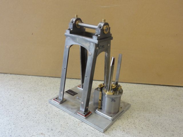

      Onwards and upward with the Norden. This is the end product as built by Neil Wyatt, our esteemed editor, who designed it:

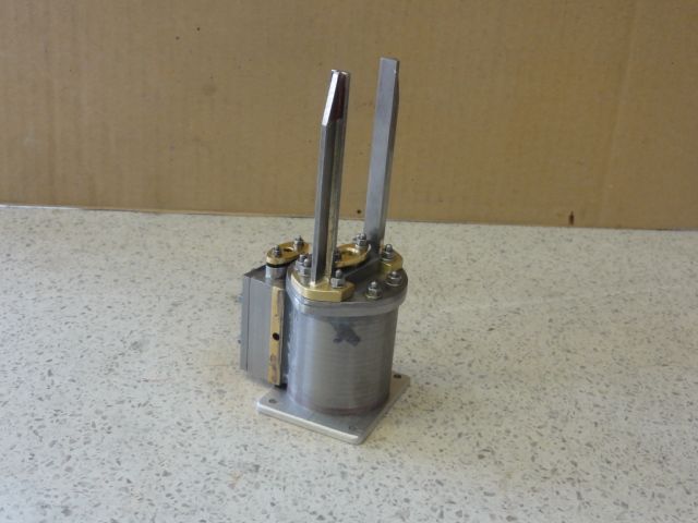

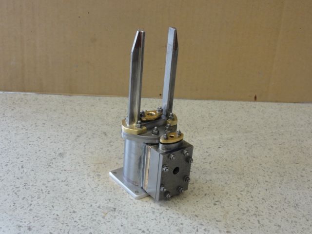

      This update shows my almost completed cylinder with the crocodile type crosshead guides:
      and a family shot of progress to date:
      The next item on the agenda is the slide valve. The steam chest is quite shallow at 10mm so a bit tight for my preferred slide valve mechanism of a valve rod operating on a bar a in slot machined across the valve. Neil has shown an alternative on his drawings so I may accept that he knows best and make that.

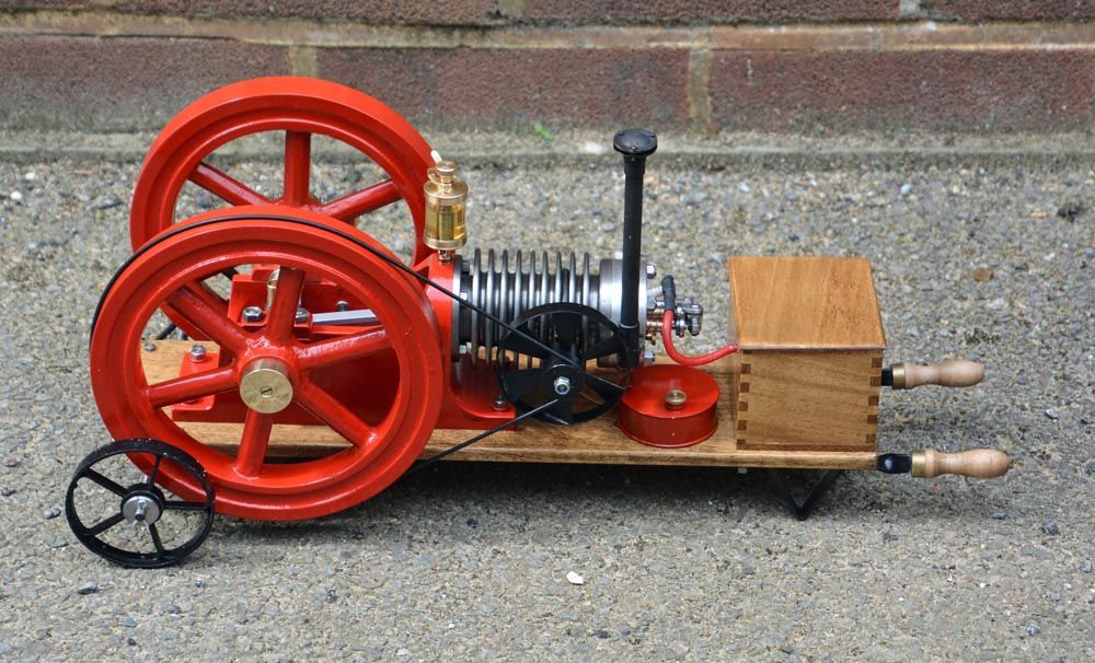

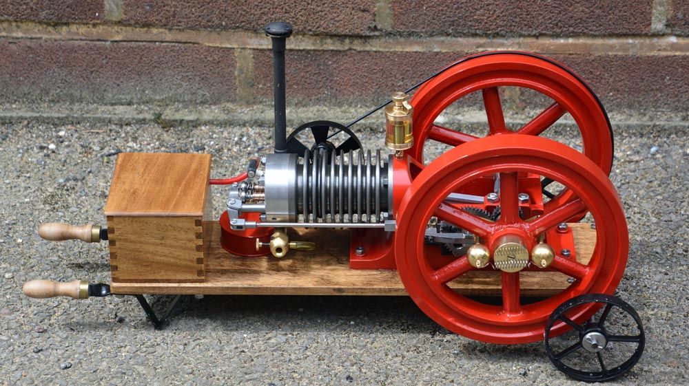

                        Finished my air cooled version of the Farm Boy hit and miss engine

                          Nice, love the trolley detail yes
                          #556311
                            Looks good Rod and running well with the governor controlling the speed, just watch your hands on those two files that are missing their handlessmile p
                            #556313
                            Jim Nic
                              @jimnic
                              Very nice Rod, a real good looker and fine running too.

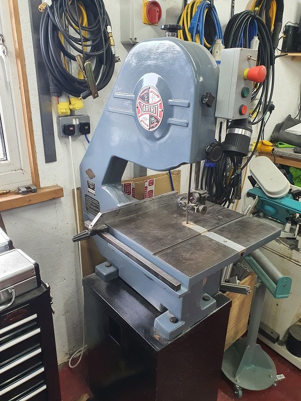

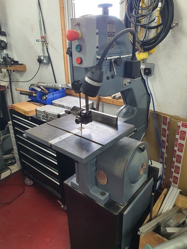

                                  I havent gotten a huge amount done this year but have managed to get a new to me Startrite bandsaw, which I think is an SP147, 10 speed. Its had a strip down, check over, rebuild and paint. Converted to single phase and some new electrics.

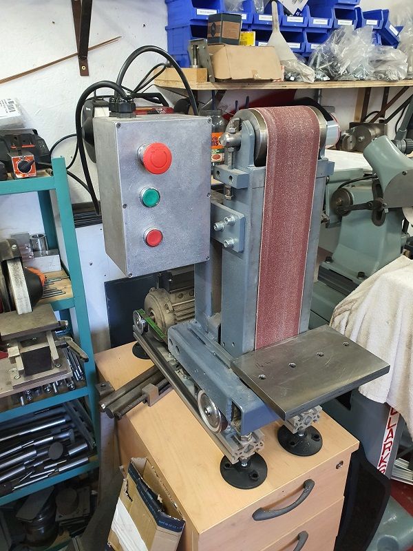

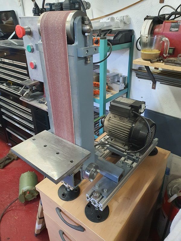

                                  Next on the list was a new linisher build from scratch. I did think about one of the 2x 72 belt linishers but i think mine will be of more use to me.
                                  I need to finish this off with some drive belt guards and linisher belt covers with extraction connection point.

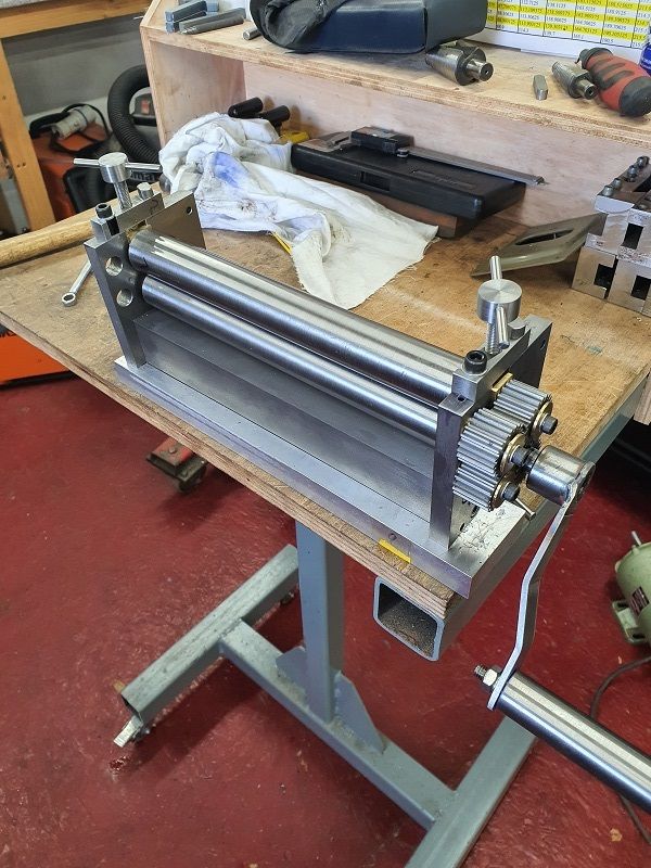

                                  So I started to build a small set of rolls about 2 months ago and just got them finished. I damaged the tendon on the middle finger of my left hand so its been in a splint for 8 weeks now so this has been very slow going.
                                  I can start on the covers now and see if I can improve my TIG welding in the process.

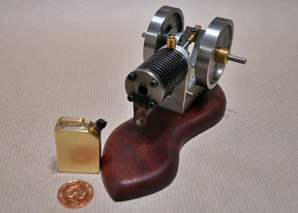

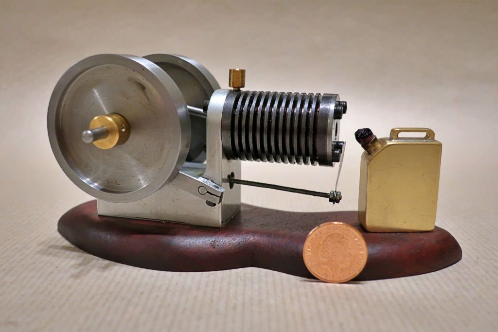

                                    Finally got so offended by the lumpish and ill-proportioned base that I'd made to mount my Senft vacuum engine on, that I resolved to make a nicer one – and a new burner as well – some kind of catharsis for me, up until now the main interest has been the engines themselves.. ..the beginning of a slippery slope I guess..
                                    I couldn't quite bring myself to dismantle and paint the engine.. ..though maybe my hand will be forced, the 'patina' is a little gummier than I'd hoped for..

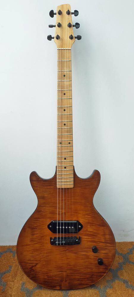

                                      I signed up for "Getting to grips with the Blues" at my local music school. At 10lb weight I'm struggling with my Epiphone Les Paul. So I put this together with bits and pieces from my wood store. The body outline is a Gibson melody maker/LP junior double cut and the neck is a Fender style bolt on.
                                      The neck is from a piece of rock maple I was given years ago, the body is from poplar that was used as packing from a timber purchase and the top is a book matched bit of figured maple that was a failed bass viol back. Weighs in at slightly over 5lbs smiley

                                        Very nice Rod, you must have plentiful bits and pieces box. Who's your man Rod, John Lee Hooker, Muddy Waters?
                                        I made a guitar some years ago, les paul copy with Schaller golden 50 humbuckers. Not much of a player but sure enjoyed making it.
                                        I seem to remember inserting a curved steel rod in the neck. It had an anchor point in body and a thread and nut in the head. By tightening the nut you could straighten the rod a little which would counteract any flexing of the neck when the the strings were tuned.
                                        You don't seem to have rod in your neck Rod, excuse the pun, why is that?

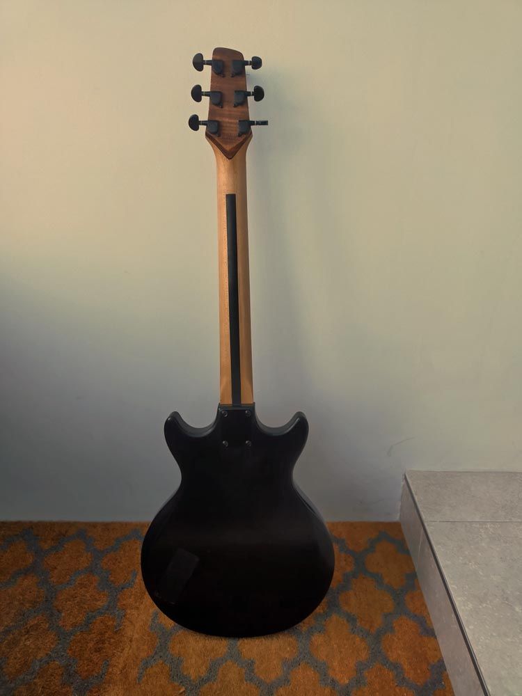

                                          Roderick Jenkins
                                            @roderickjenkins93242
                                            Hi Geoff,
                                            The guitar does have a truss rod. It's inserted in a slot in the back of the neck

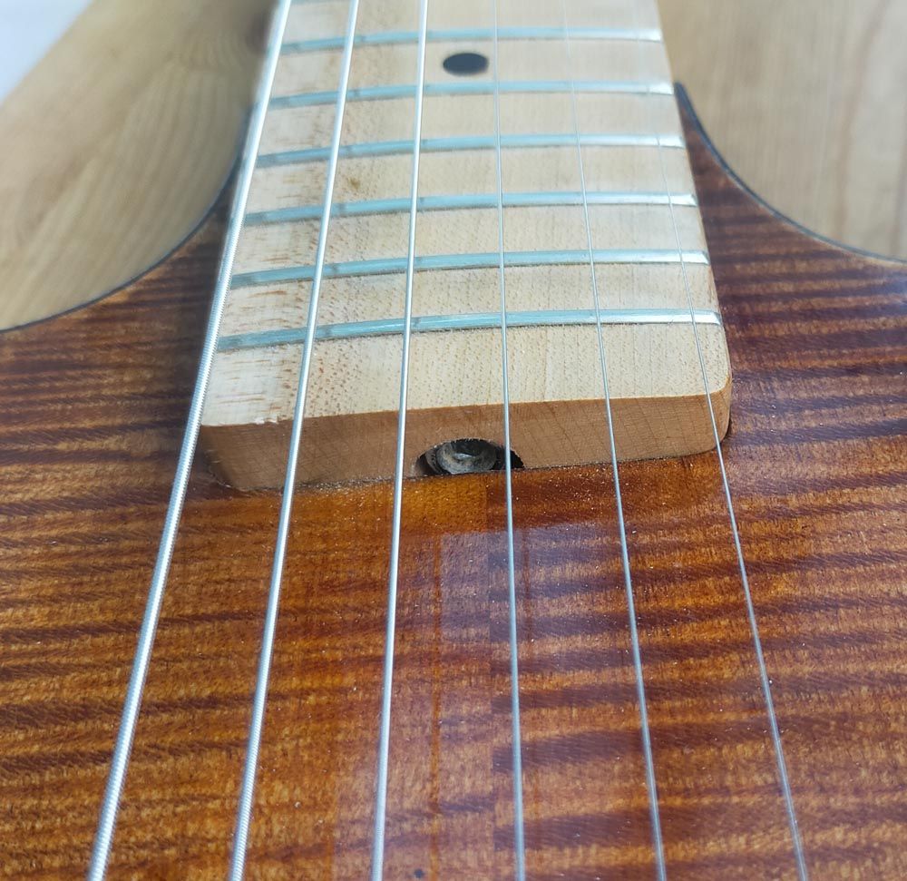

                                            and adjusted at the body end
                                            The cover strip for the rod is much wider than it should be because the bit slipped out of my Aldi router and chewed up the edges angry

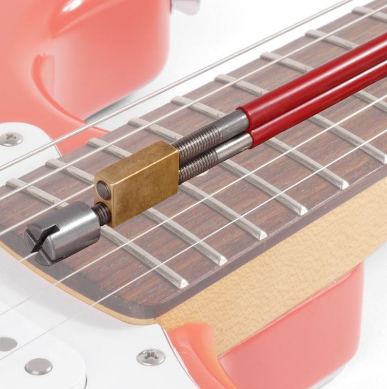

                                            I used a double action truss rod like this
                                            (image from StewMac)
                                            Saves having to make a curved depth slot and, depending on which way you turn the screw, can adjust the neck curve in both direction.

                                              Thanks Rod,
                                              Not seen the double rod before, but certainly a good idea.
