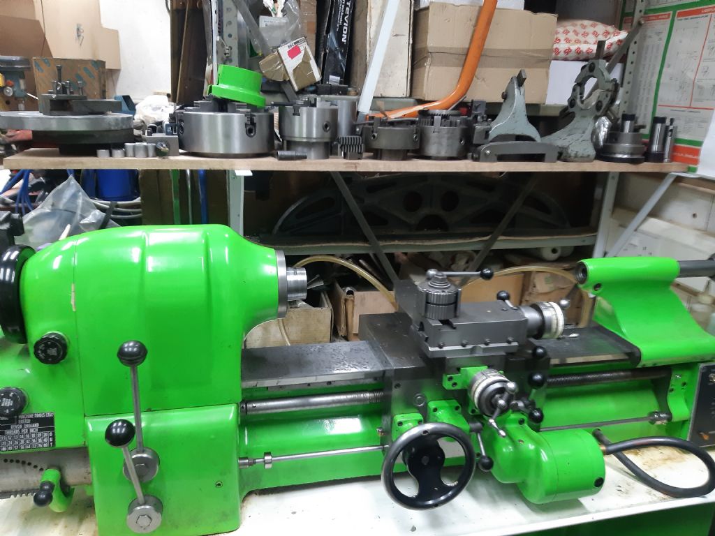

                    Having tidied up the mess in the Hardinge's chip tray, I went out and payed money for a couple of brackets at Screwfix and used a bit of spare wood to make a shelf to hold the stuff that had been living in the chip tray. I'm a bit ashamed that I spent money on the brackets rather than welding a set up, but the shed is so full at the moment that getting the welder set up would be a pain.

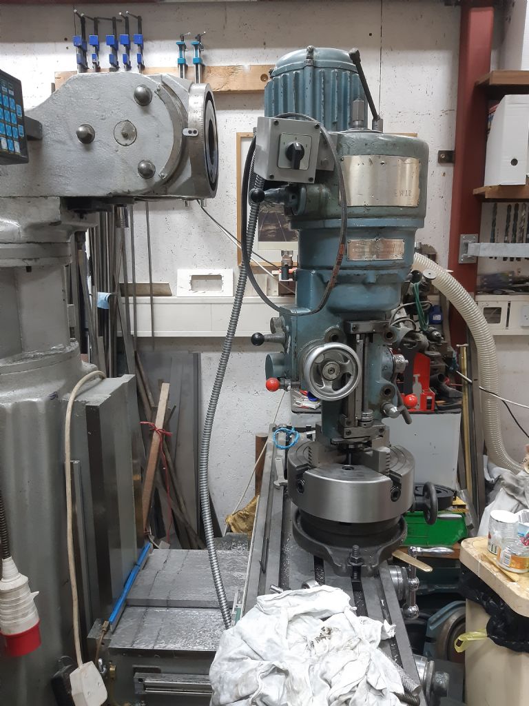

                      I need to do some work on the milling machine, when not doing bedroom decorating. There are a few things I want to improve on the mill's head before doing the work, so I took the head off this afternoon:-
                      There are two things to note from this:-
                      1. With an NMTB or R8 taper machine, it's a relatively simple job to either make an adapter or clamp a slitting saw arbor in a vice or chuck. Then the head can be safely lifted off the ram without doing oneself a mischief.
                      2. The other point is that Most Bridgeport/Beaver etc. style mills really need a riser block to get the most use out of the knee's travel. I was 2" away from the top of the travel even with the homemade 7.5" riser block.

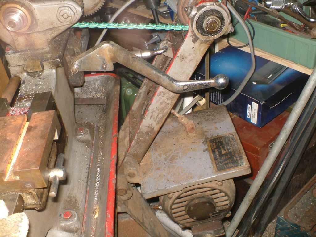

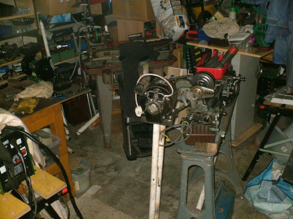

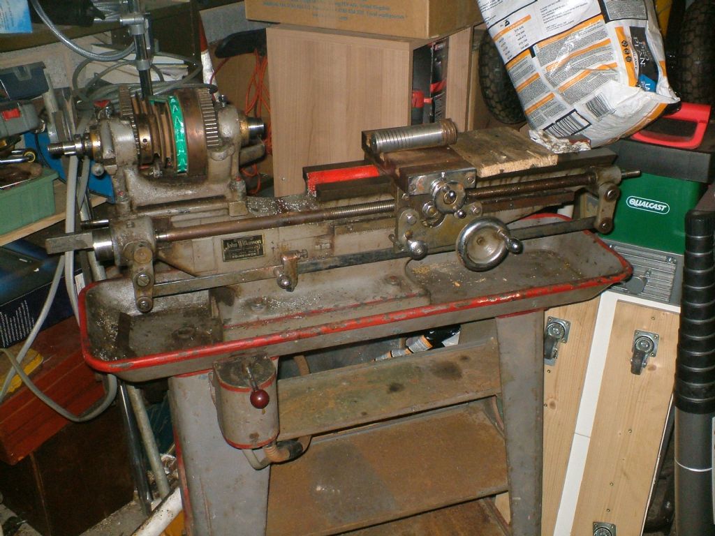

                              Got my 'new' Drummond M back a couple of weeks ago and it incentivised me to integrate the motor of the original M I got 10 years ago. I even found the original bolts for the treadle table in a dog tin still waiting for me
                              Used a couple of bits of white painted gas pipe I liberated from a pavement outside a house refurbishment years ago and fabricated a mounting plate from liberated water pipe and some bits of B+Q angle iron which slots straight into the two pipes
                              This original one is going to be my horizontal milling machine while the new addition at the back is going to do proper lathe work, it's not been used much at all. I'm going to have to get the spindle out of it, some woodworking may have blocked the oilways and it needs that roller bearing upgrade
                              Plenty to do but the really tuff bits are done. Getting the motor onto the back of the new Lathe took a car trolley jack, it's a Higgs motor, a make I am unfamiliar with and must weigh 60+kilos
                              Edited By Ady1 on 19/05/2021 09:13:33

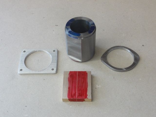

                                The frame and crankshaft bearings are done, latest fumblings involved making the cylinder. Here's the main components which replace the casting of the original model, the top and bottom flanges will be fixed with Loctite and the port face with JB Weld.

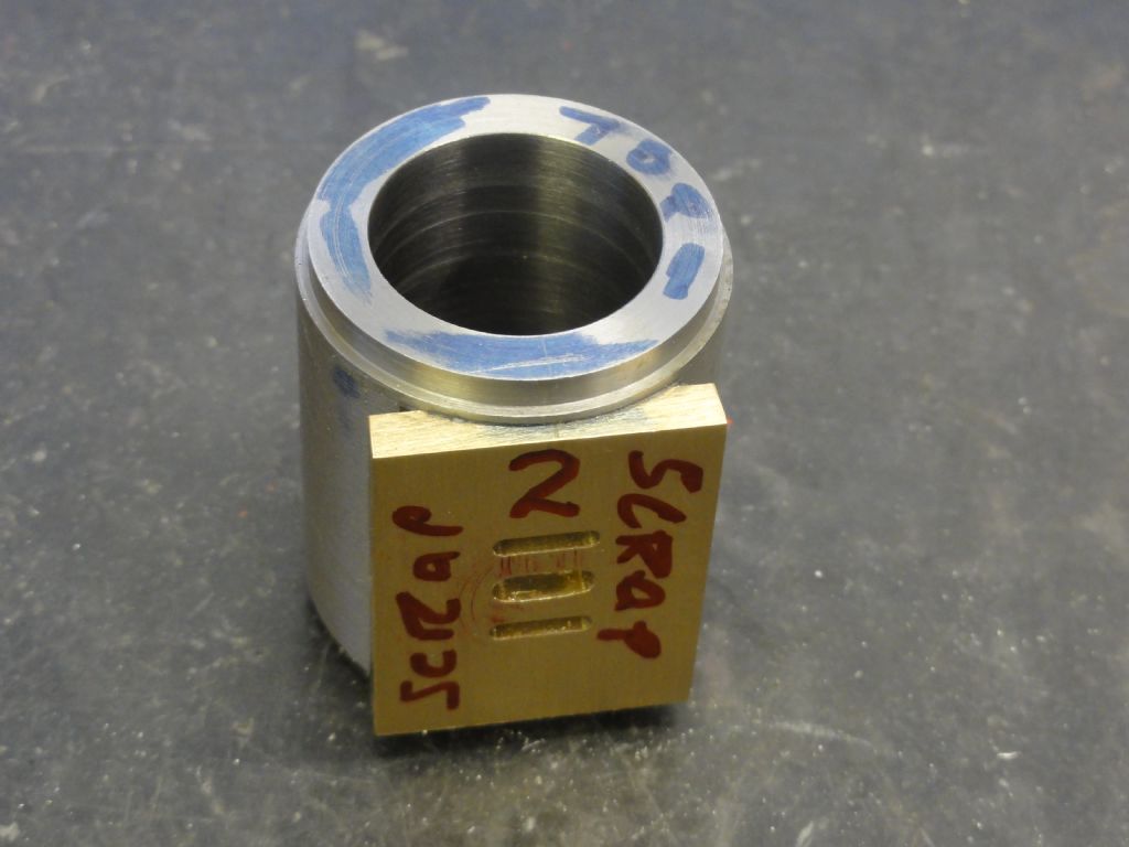

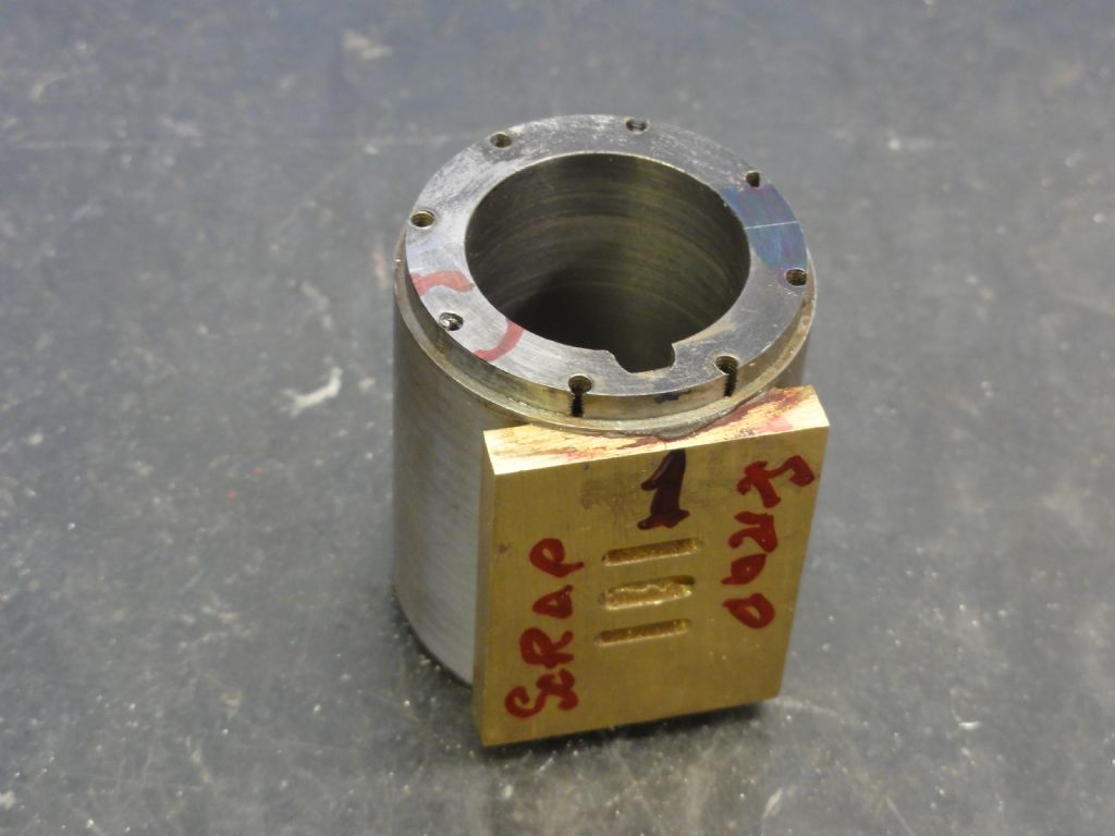

                                Here's the first scrapped attempt:
                                You may be able to make out the top of the broken off 8BA tap. I haven't broken a tap for ages but my mind wandered while I was doing the eighth one and that was that.
                                So I recovered the top flange, the rest went in he bin and I started again:
                                It's not easy to see why this also bounced off the wall but it moved in the vice when I was milling the brass port face and it ended up too thin and not square. So I started again again.

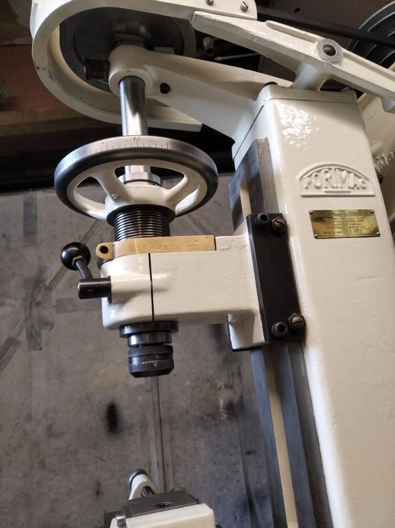

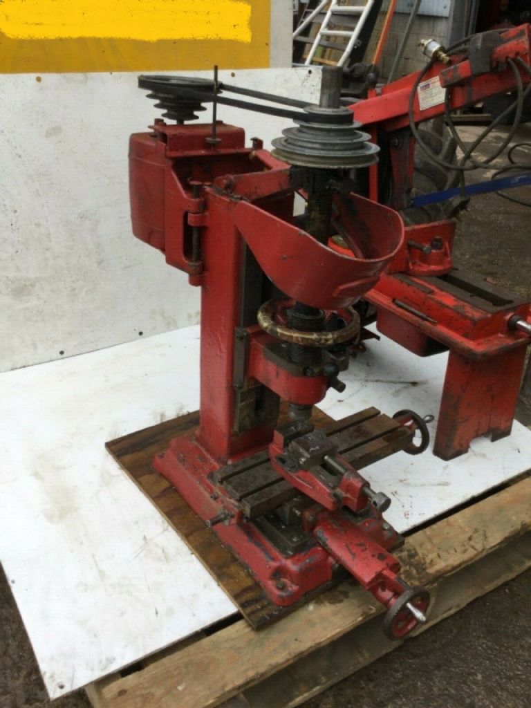

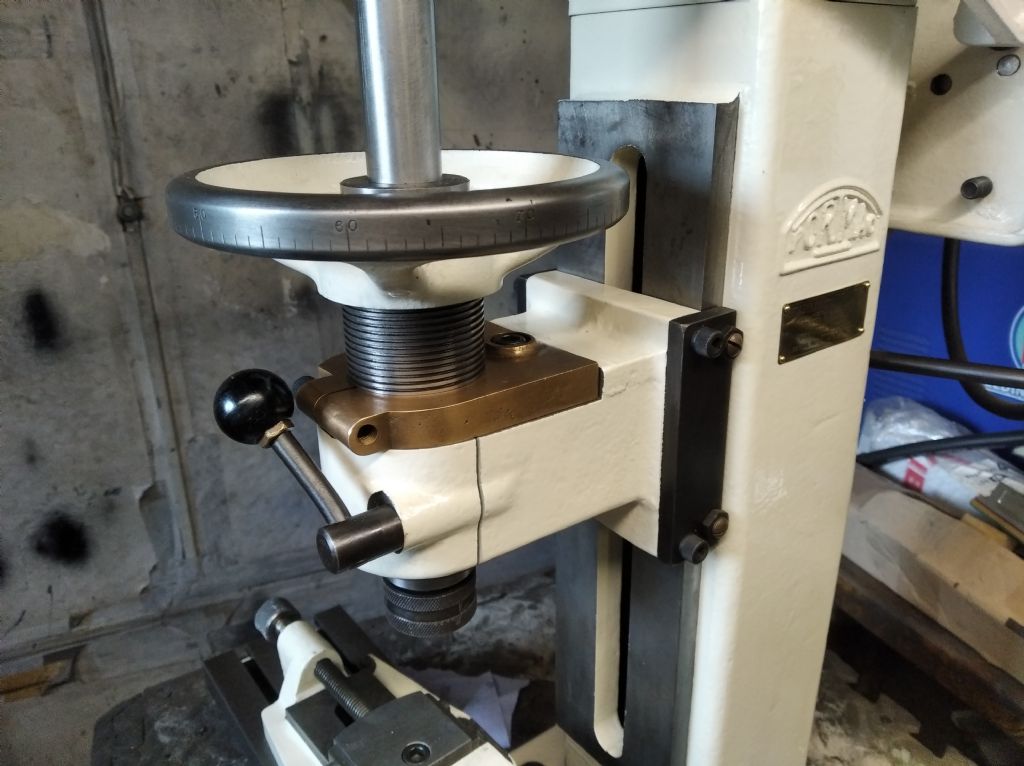

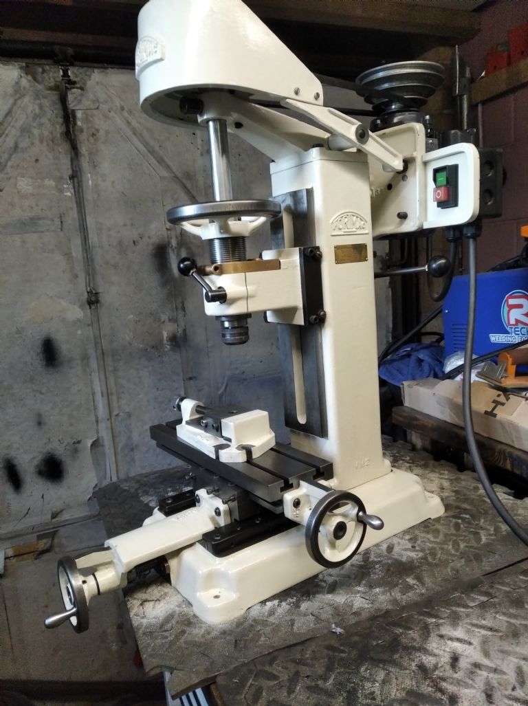

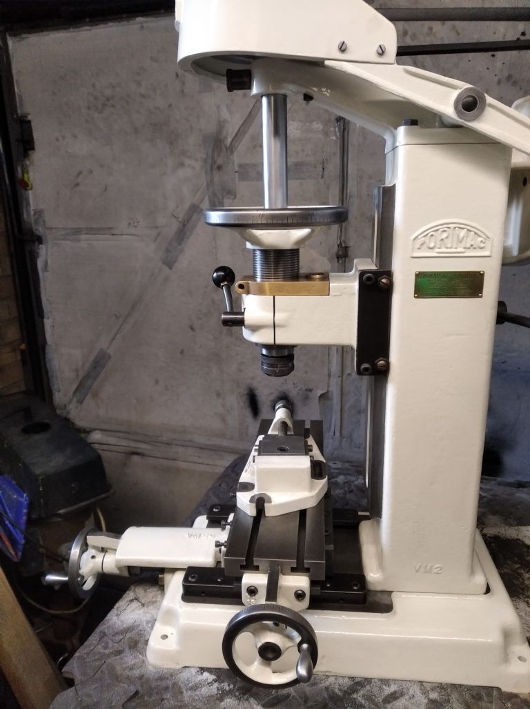

                                  Quite some time ago I made a post about a mini 1940's milling machine I purchased , in red as received, quite sorry looking condition.
                                  It’s been a do a bit here and there project when spare time allows, it deserved saving I think.
                                  #547312
                                  Dave Wootton
                                    @davewootton
                                    Lovely job Pete, I remember the initial post and it is good to see the final result, a worthwhile project that has finished up as a useful machine. Very nicely finished and painted.
                                    #547337
                                    Jim Nic
                                      @jimnic
                                      Nicely done Pete.
                                      Jim
                                      #547344
                                      Ady1
                                        @ady1
                                        Thats a nice save
                                        #547346
                                        Nicholas Farr
                                          @nicholasfarr14254
                                          Hi Pete, yes very nice job you have done.
                                          Regards Nick.
                                          #547449
                                          Pete.
                                            @pete-2
                                            Thank you all for the kind words, given me a bit of motivation to finish the rest of the machines so I can concentrate on making things.
