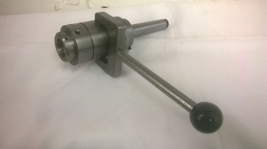

          Suffering a bit from SIBS (Self-Isolating Boredom Syndrome – everything has to have name these days), I bought a tail stock die holder kit from Hemingway. Spread the build over a couple of weeks so as prolong the excitement and altered a number of the original drawings to suit the metric environment of my workshop. Got a hole in the wrong place on one holder (misread the rotary table scale) and broke a 5mm tap in another due to incompetence. Otherwise it turned out OK. Work was delayed by a few days because I had to order a tin of grinding paste to lap the clutch cones. It seems the tin I bought 56 years ago to lap in the valves of my Austin Seven has disappeared in the last house move. Still the same make, though!

            Hi John
            Good to see an honest report, don't be too hard on yourself for the errors, I think we have all been there on some projects, well I have more than once.
            Emgee
            #487682
            Baz
              @baz89810
              Don’t beat yourself up over a few mistakes, the bloke who never made a mistake never made anything. Some days everything goes perfectly in the workshop, other days I wonder why I bother, I just cannot get anything right.
              #487684
              mechman48
                @mechman48
                Nice job John;
                'Some days everything goes perfectly in the workshop, other days I wonder why I bother, I just cannot get anything right.'
                Had a couple of those days this week.. frown
                George.
                #487732
                Andrew Moyes 1
                  @andrewmoyes1
                  I’ve had my fair share of bad days in the workshop recently. In fact I told my wife last week I must be losing it.
                  Then yesterday was one of those perfect days. I was turning a 4MT taper adapter to mount a couple of small chucks for clockmaking in the Myford big bore lathe. Unable to use my normal trial and error method of testing it in the bore of the headstock spindle, I followed Joe Pieczynski’s method on YouTube for setting the compound to precise angles. Using a parallel in the chuck, a DTI to establish zero and the DRO to set the offset, I set it up as one would a sine bar. The EN1A took an excellent finish and when it was done, I took a deep breath, removed it from the chuck and tried it in the headstock spindle. It went in with a reassuring clunk and no shake. Out of curiosity, I put a light smear of engineer’s blue in the socket and tried the adapter. To my astonishment it was an absolutely perfect fit over the entire area of the taper. Something I have never achieved using the trial and error method. I’m converted Joe and think your videos are excellent.
                  #487740
                  John Hinkley
                    @johnhinkley26699
                    Thanks for the encouraging words, chaps. I still think I'll remake the piece that I made the mistakes on, though. Maybe not tomorrow, but when I get another bit of steel big enough . It had to be the largest component, of course and the one requiring the most machining, but at least it was the piece with the external thread. 'Twas the first time I'd cut an internal thread, 22mm x 1mm x 10mm deep. The slowest speed on my lathe is 170 rpm, so it got pretty exciting at times, I can tell you.
                    Live and learn, live and learn ………

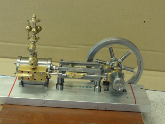

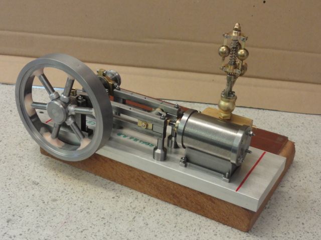

                      Having got most bits of Stew Hart's Mill engine made I cobbled it all loosely together:
                      At that point it looked as if it may run so I connected some wind and gave it a go:
                      Now have to tart it up with some decent piping, some paint, some wood cladding for the cylinder and a nice plinth.
                      Happy days.

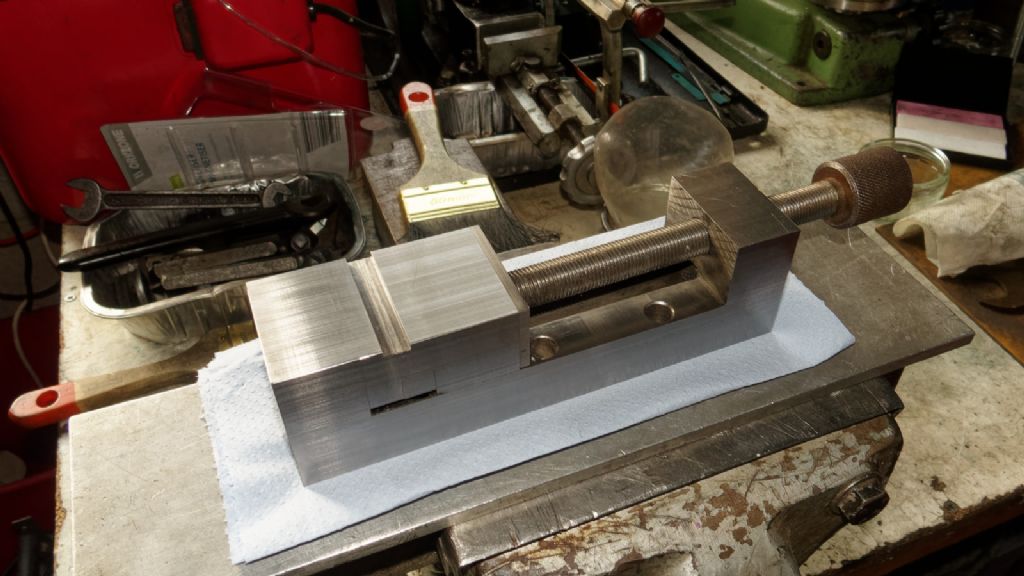

                        A job I've been wanting to complete for 30+ years
                        One of the chaps in the BT stores kindly gave me a machine vice he'd made when he was at college.
                        Unfortunately, whilst top and bottom were parallel, as were the sides, they weren't actually perpendicular to each other.
                        Having now more or less completed the Herbert Junior, I though I'd have a go at rectifying it as the first proper job on the machine.
                        Seems to have worked OK.
                        Not a perfect finish, I'll have to get more practice.

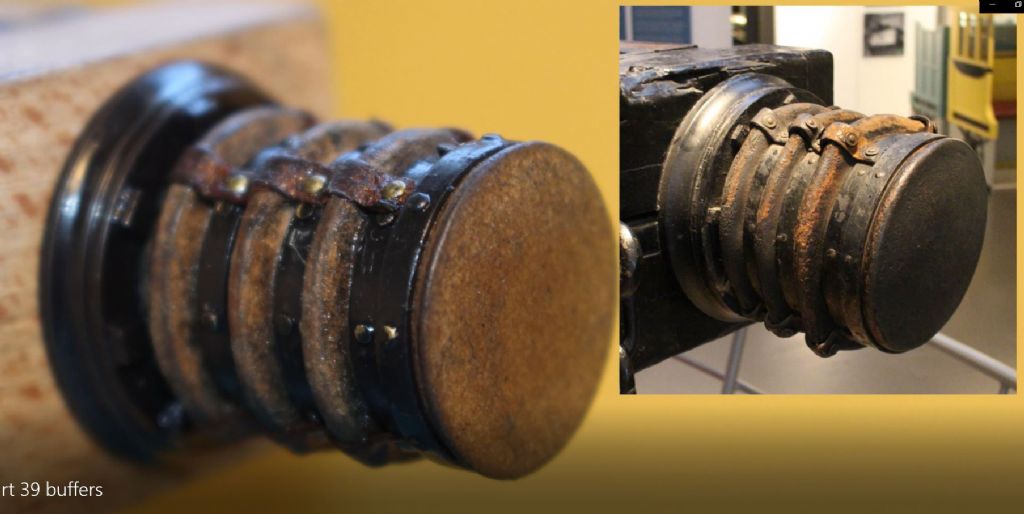

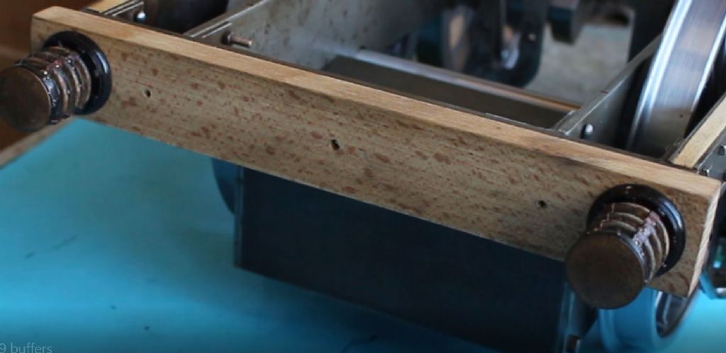

                          Finished the Buffers for my 5" g Lion build. Tried to get a close resemblance to the originals, I think they look quite acceptable. They are around 20mm diameter.
                          The original appears to be made of leather held together with metal straps, I used MDF to represent the leather and added some texture using a lead pencil and a final varnish using a matt polyurethane .

                              Another superb build; what psi is it running at ?

                                Thanks George.
                                I started it at 10 pounds per squinch but after a short while it was happy at 5 or so. Even then a lot of it was leaking away due to lack of fasteners and sealing. When I get it properly assembled it will run without the sound of escaping air (I hope) at even less. I believe that engines of this type did not need to run very fast so as it's not doing any work, at low speed a flatulent sparrow should be enough.

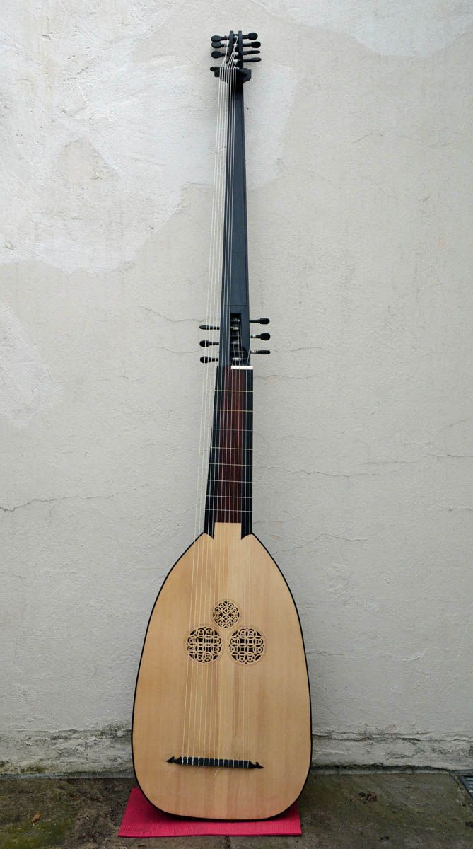

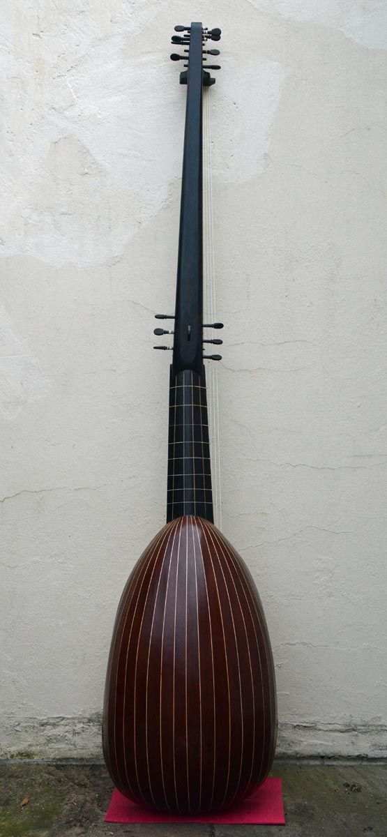

                                    Sorry, more wood. I've turned 65 and I reckon I ought to complete some unfinished projects before I run out of time.
                                    A Chitarrone (aka Theorbo or Archlute). This was constructed from from drawings made by the late, great Stephen Gottlieb for the Lute Society. It's bonkers, I know. Chap called Brandon Acker on you tube explains all **LINK**
                                    Just a steel strung guitar that I started 10 years ago to finish off and it's back to the tyranny of the micrometer.

                                      Fabulous work. Followed your link. Very interesting. It gradually took me down a rabbit hole and I ended up watching very interesting Youtube videos on the history of Hurdy Gurdy's.

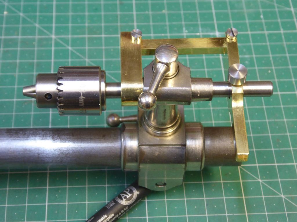

                                                Just for a change, I acquired a 6mm Wolf Jahn watchmaker's lathe, one has to find somethinig different to do in lockdown! A bit smaller than my other lathes, at 40mm centre height. Anyway, a 'sensitive' tailstock drill attachment finished yesterday:
                                                Nothing much to locate the attachment to, so I used the taper on the front of the tailstock. The drill spindle screw on the back end is undone to remove the assembly, the screw will get knurled when my fine knurling wheels come in!

                                                  That's a good looking addition Martin. Well done.

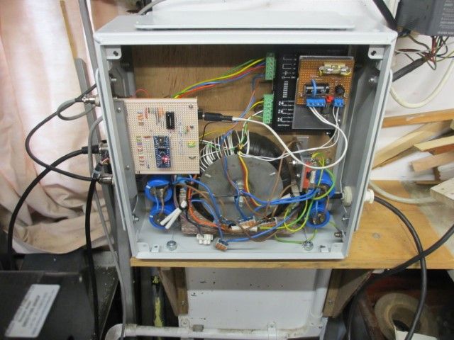

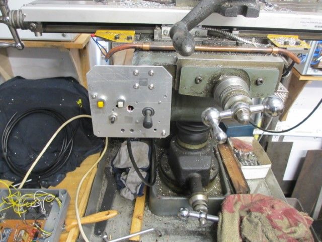

                                                    Finally plucked up courage to plug in the latest version of my milling machine table drive. The previous edition worked OK, but over the years had grown to have far too many separate boxes. Yes I know it looks like an explosion in a tripe works, but after sorting out some software issues where it didn't quite do what I expected it's a runner. I'll put the lid on tomorrow, then wait for the engraved front panel for the joystick box

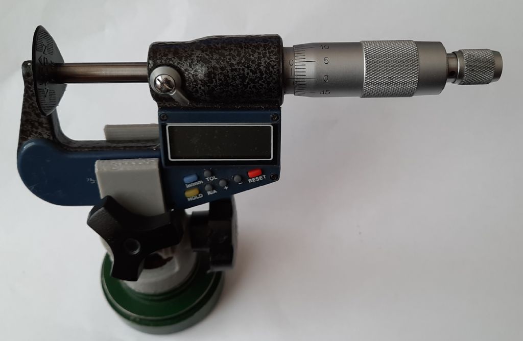

                                                      Back near the dawn of history I turned a few random registers on an offcut, put an M6 thread in it and painted it green.
                                                      I always meant to turn it into a micrometer stand. 3D printing is ideal for making a non-marking clamp and I found a couple of suitable clamp screws.
                                                      The perspective makes the base look smaller than it is, it does balance with the mike screwed right out!
                                                      My 1mm plectrum measured up at 0.996mm.
