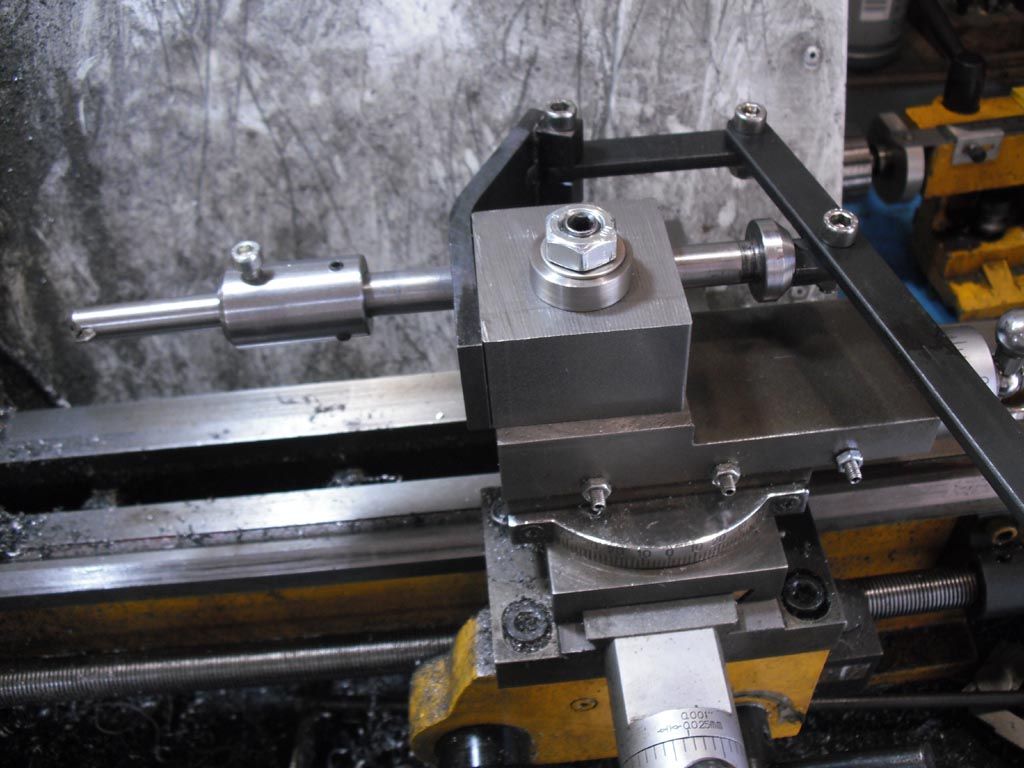

          Slotting tool is now finished . It's to my own design which I sort of made up as I went along, so I don't know how it performs.slotting=tool.jpg

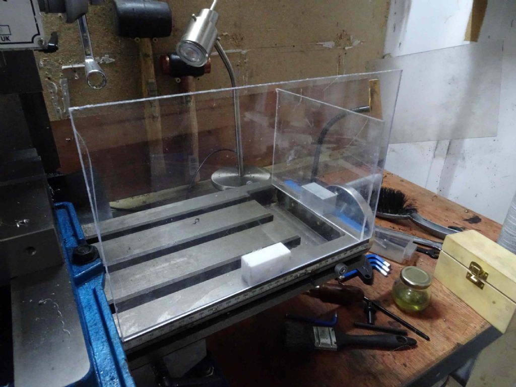

                  This is more about progress in the workshop rather than workshop progress.
                  I've stolen this idea from Blondihacks (I think), but when I saw it I knew it was for me. One challenge with a bigger mill is that you get blue hot chips coming of and pelting you and the surroundings. Not nice.
                  So the idea is to drop some magnets (the small pill shaped super ones you can get pretty much anywhere – 10mm dia x 5mm height) into a block and glue some plastic to it. The clear plastic may be a bit of a challenge these days, but I have a bunch 'in stock'.
                  My first attempt was a 3D printed block and I tried to locate the magnets with green loctite. It didn't stick. Don't know why. Next was an aluminium block. Also didn't stick.
                  Cleaned out the ally block and superglued. It worked! I've also put a bit of masking tape on surface of the magnets which I hope will let me clean swarf off without seriously affecting the grab.
                  Not actually tried milling with them yet, but I'm confident. I've a few more to make (including one to go on the vice) which will be 3D Printed.

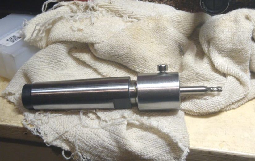

                              Only another small step – having made a crank handle a couple of days ago and tried to cut a 25mm x 1.5mm thread – the first time I have tried screwcutting on this lathe. I now have a very tired left arm and an appalling failure of a thread.
                              Bit down at the failure I reset the change wheels for fine feed and noticed that when I had removed them the key on the mandrel gear had stayed in the gear so the one I had set up for threading was only held by the pressure of the retaining screw.
                              While it looked ok running light, under threading pressure the gear slipped from time to time – hence the intermittent movement of the saddle and the threads that blurred into one another!
                              I couldn't have happened on my Drummond with pins in the gears I suspect.
                              Anyway, having a look through Neil's mini-lathe book I realised out of the four projects he describes I had made or bought 3 but not the end mill holder.
                              So todays' positive progress is 10 minutes drilling, reaming, drilling and tapping a blank end arbour in the drawer. But it all counts and it cheered me up anyway. Just waiting for the steel for the drawbar.

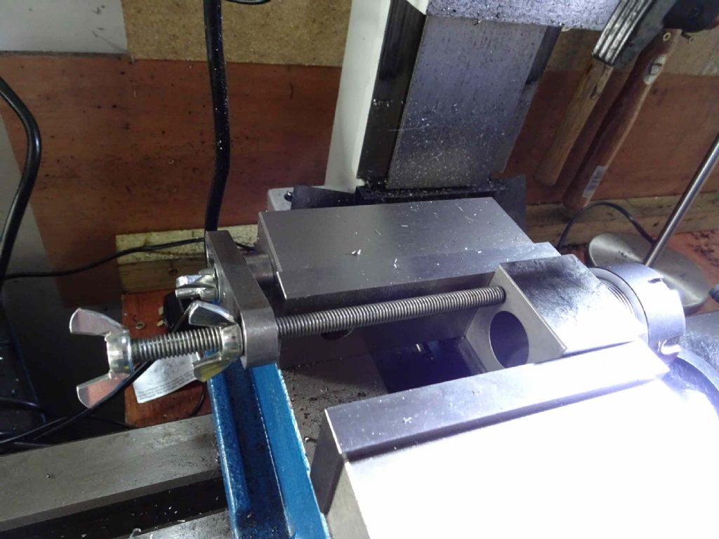

                                    Nothing as interesting/pretty as most of you, but today was a tools day.
                                    And end stop for the vice
                                    wingnuts secured with that most ancient of fixings – superglue …

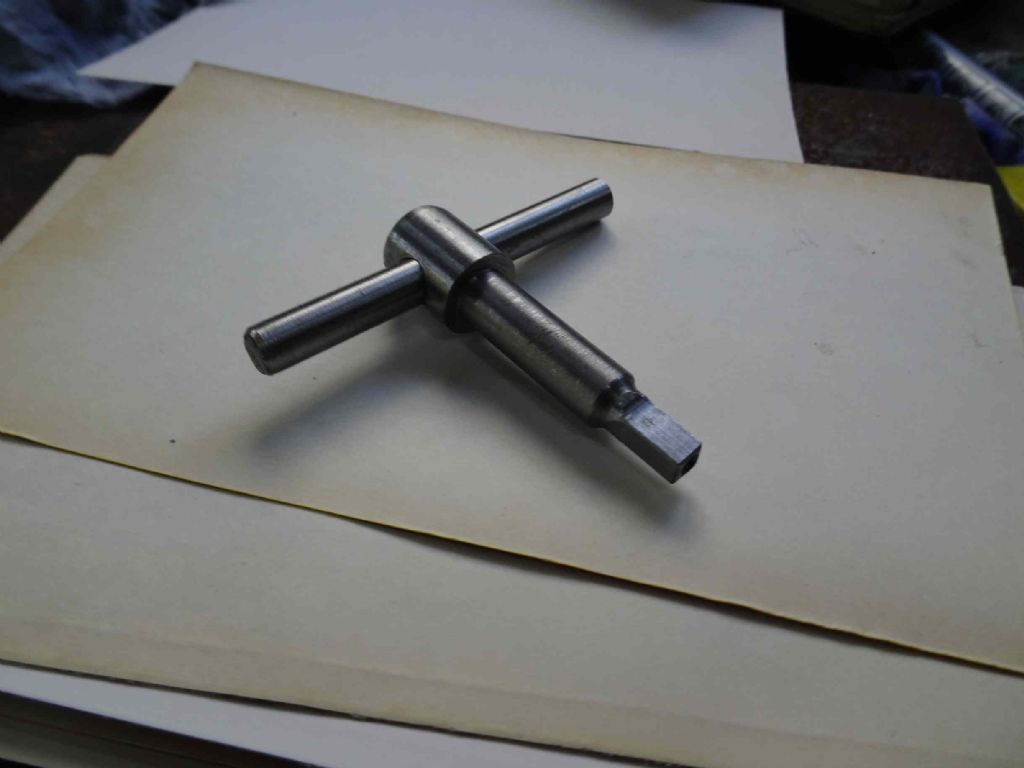

                                    This in turn used to make another chuck key for my 4 jaw
                                    Which I will use when making my eccentrics, having seen people use two chuck keys to great effect when centring a 4 jaw.
