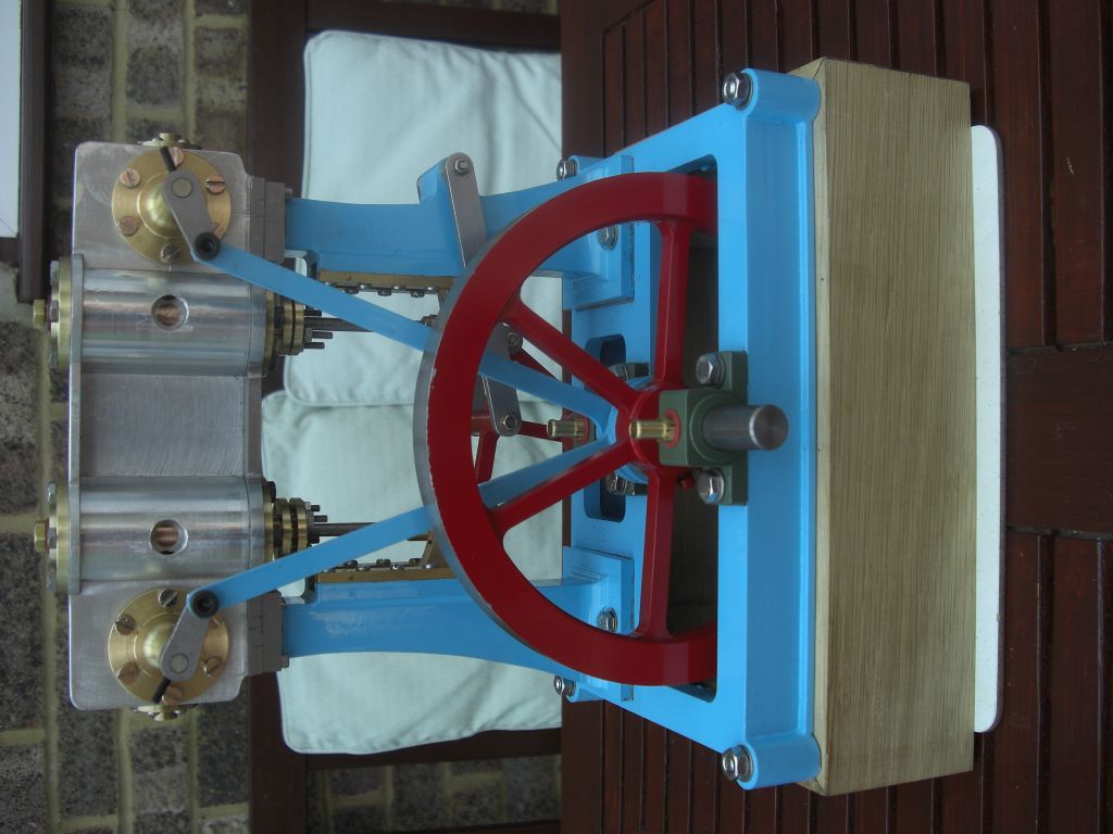

          Lockdown has allowed me to get on with this engine to the stage where I could give it a tickle of air. Only got a few screws tacking it together, no gland packing or piston rings and the valve links only have screws as pivots not fitted pins but it run straight away as soon as the air was turned on. :cartwheel:
          Learned a lot doing this one not just with the CNC but working out the rocking valve construction as the source of drawing that were on the web has been removed so I just had to make up the details myself, did not even have to break out the collet chuck as all done in the 3-jaw except the trunk guide which was done in the 4-jaw and the micrometer did not get a look in either. Fairly happy with how it's turned out just needs some finishing touches now.
          Hope this lockdown does not go on two long as i'll be running out of subjects as this one took just under a month doing a bit most days.

              Brilliant work.
              Of course it would only have taken me about 5 years to make.nerd

                    Isn't that a very sweet runner, excellent. Some interesting shapes in the parts Jason certainly different. The crosshead guide/housing looks interesting was it machined similar to the entablature cylinder with faceted cuts but leaving the central rib along the top.
                    What are you thinking for the base plate certainly deserves something good.
                    Very nice.

                      That's it Ron, mad a simple rod with two stepped "nuts" to hold it by and used the same method, back side looks better as I moved the tool over a bit more from ctr line once far enough from the top rib.
                      Not quite decided on the base, a planked floor was quite common in the US where these engines originate but all the other 24mm engines have had quite a plain base. Whatever I go for it will need to have some depth for the flywheel pit.

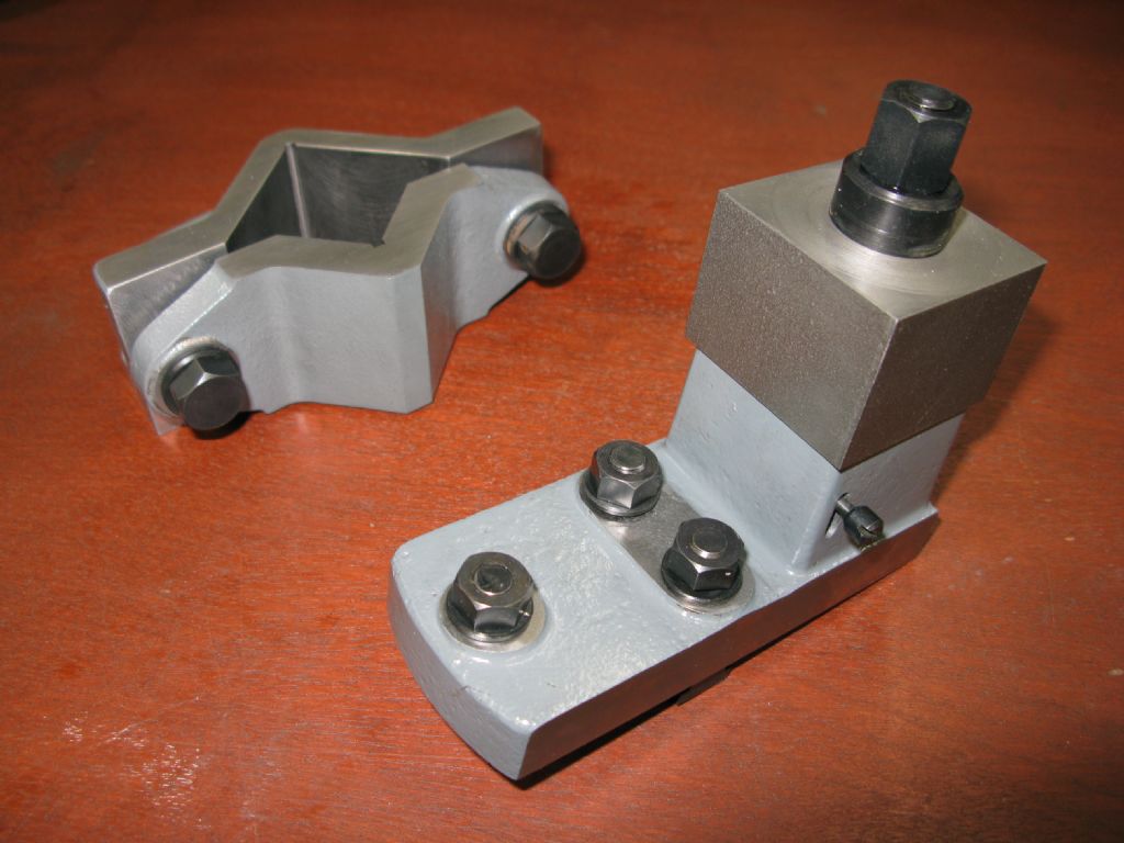

                        004.jpg002.jpg                     Since I finished work at the end of March, and as we are in lockdown I thought it was time to get some of the un- started projects on the go. I've had the castings for these for some time but house moves, work and old motorcycles got in the way.
                        The Kennet is almost finished I'm waiting on a couple of deliveries to complete, some welding gas so the wheel guard can be fabricated, and a new motor capacitor as the old one is very badly dented, now I've left work there's no more access to the lovely Clarkson, so thought I'd better get my finger out.
                        The Myford saddle stop is something that's been on the list for ages been very useful in making the smaller parts for the others it's fabricated from odd bits that were to hand, the rear toolpost is GHT's design for the short Myford crosslide (ML7- R) and the Keats angle plate from College Engineering supplies. The rear toolpost still needs slotting for the parting tool, but nearly there.
                        Thought I'd put these on as I'm always interested in what everyone else is making, there are some great projects underway on this site.001.jpg
                        Edited By Dave Wootton on 01/05/2020 18:08:32

                          Like the saddle stop. Unfortunately that is right where my quick change gearbox lives. Dam.

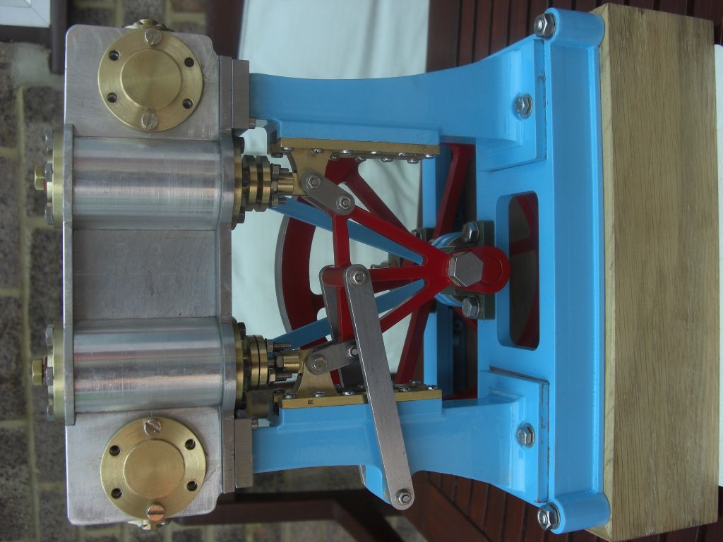

                            p5013952.jpgJason, thanks for the info on the Musgrave, I will have a look later, I have done a couple of his engines as a fill in, they are fast to do, and cheap too, as mainly built from bar stock. I started with the aluminium, and after 85 hours got the almost finished engine. p2073379.jpg

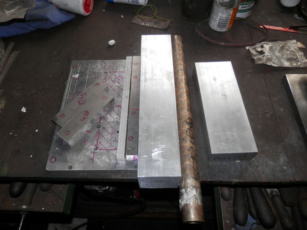

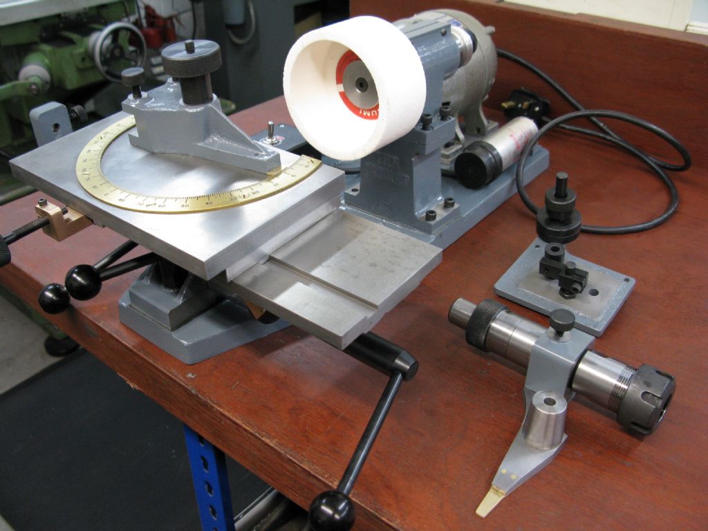

                              cimg4521.jpgI have one of these but not set up running due to another project cimg4523.jpg

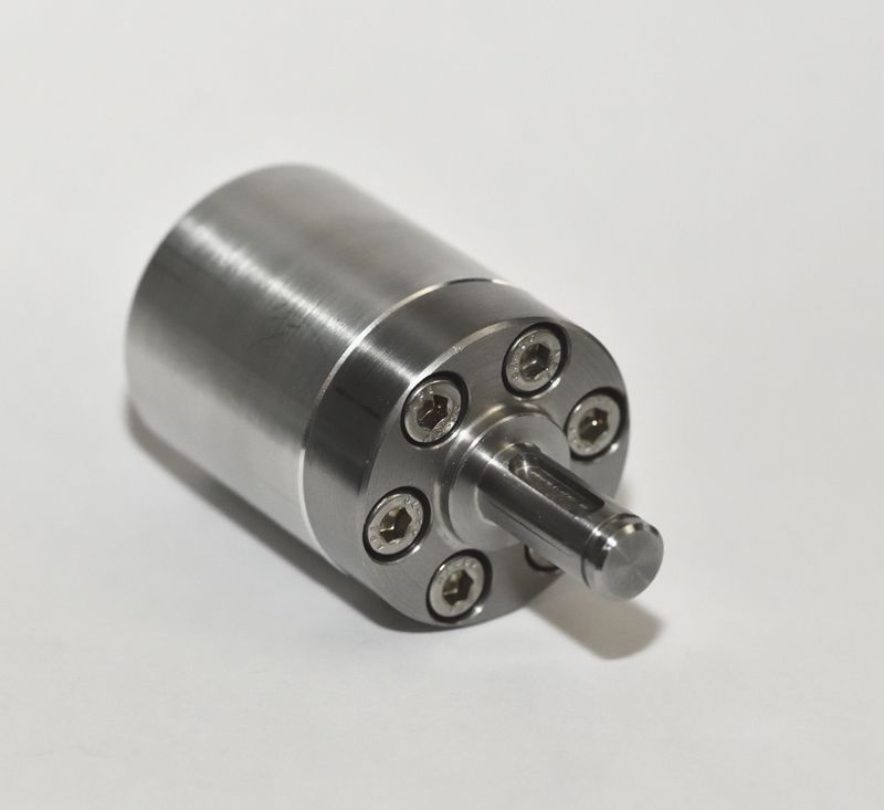

                                – Swapped out my fluorescent lights for the LED sort in the shed. It's very bright but not too harsh on the eyes.
                                – 3D printed some resin parts for my brother. He's scratch building a V&W Class Destroyer in 1/96 scale, HMS Vega. Have spent hours in fusion 360 on this.
                                – Completed the installation of a DRO to the mill, finally!.
                                – Machined a custom oldham coupling to enable fitting a 3phase motor to the mill, but the idea was canned because I wouldn't have been able to remove the draw-bar blush . Then machined a stub shaft (photo below) so the motor can sit in its original place and use the machine's helical drive gear. The motor mount plate willl be next.
                                – I'm also part way through motorising my rotary table.
                                Ed.

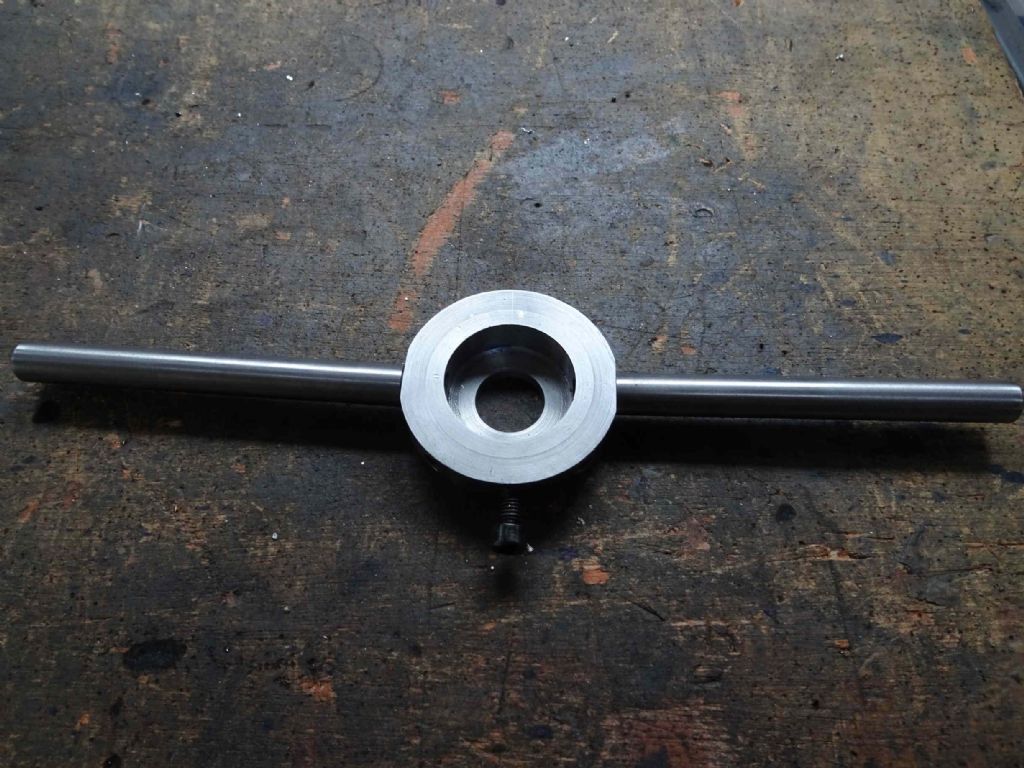

                                  I'm working on a table for my FEMI saw and needed to cut a 10mm thread in the end of a ally support bar. I have 3 (carbon steel) 10mm dies and not one of them would cut the aluminium! So pretty much useless. eBay to the rescue and a new HSS die was ordered.
                                  When it got here, I found I'd ordered a die with a 30mm diameter (I mean who knew that existed!). I pondered for a while and asked what a real engineer would do. He'd make a die holder! So I pretended to be a real engineer for a few hours and came up with this.
                                  In the spirit of full disclosure my eyeballing of the angle for the holding screws was a bit naff – next time I will need to be a bit more accurate, but I now have two aluminium pillars with threaded ends!

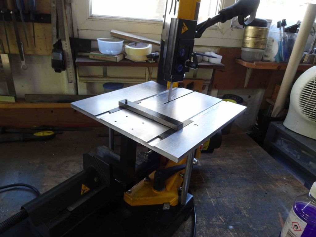

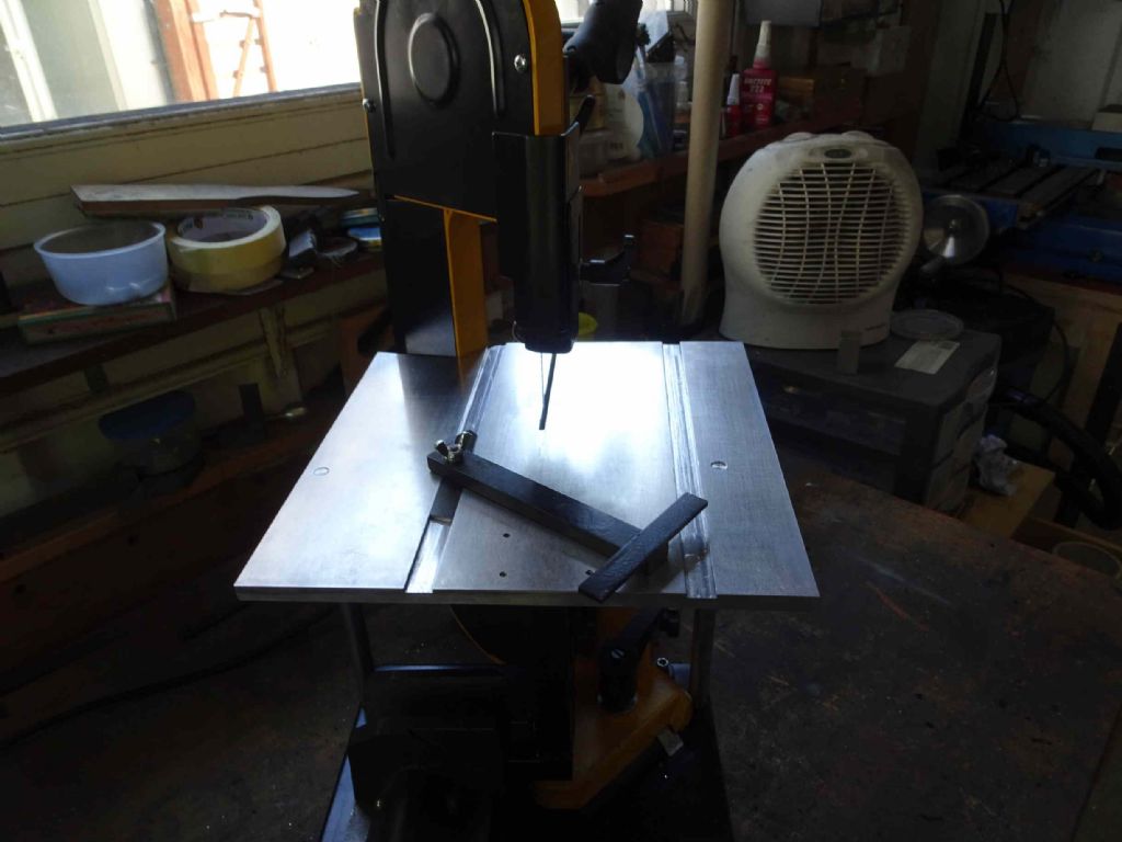

                                    One of my distraction projects has been building a saw table for my Femi Bandsaw.
                                    Finally, it's all done!

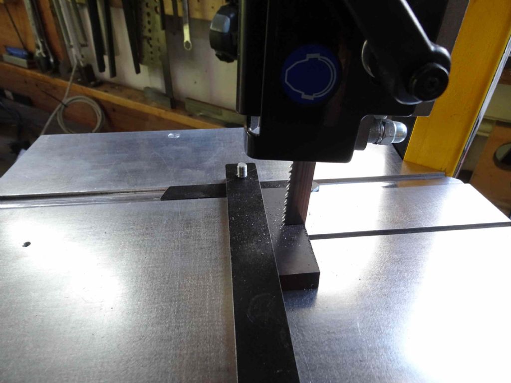

                                    The guide works satisfyingly well and the idea is that I can run it for right angle cuts or
                                    I can arrange for an angle cut. Most likely using a new piece of 20x10mm steel, but that shows the idea.
                                    Here's a close up
                                    In my usual spirit of full disclosure, this was one of my first real attempts at welding (the support gripped in the vice) and the job is embarassingly poor. After a few goes, though, I got enough metal there to hold it together. But I wanted to spray the support before photographing it to save my blushes…

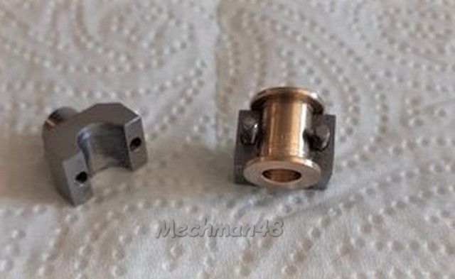

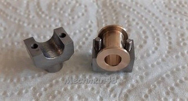

                                      A little more progress on my beam engine, machined up crankcase bearing housing & bearing..
                                      slowlee, slowlee catchee monkee. face 18

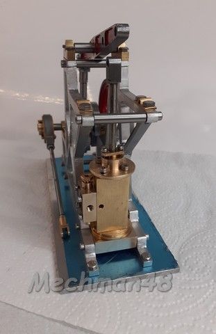

                                        More of my beam engine, components completed being assembled for fit..
                                        It's getting there..

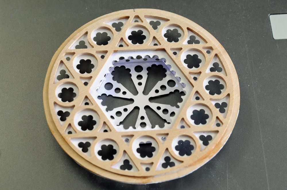

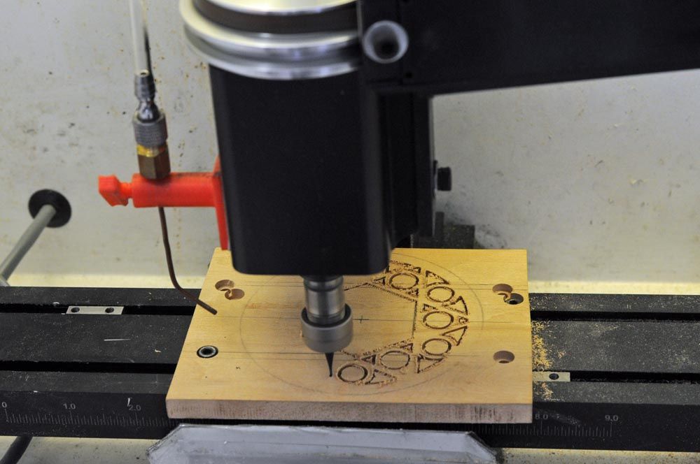

                                                Baroque guitars have very ornate sound holes, usually made from layers of parchment. This is my simpler attempt using the engineering tools to hand. I drew the design up in CAD and used the Denford/Sherline mill (now converted to Mach 3) to profile the wood frame – a piece of hard maple.
                                                I cut to 2mm deep using a 1mm diameter carbide 2 flute mill in four passes. The spindle only goes to 2400 rpm but it seems to cut cleanly at 300mm/min. I used my drum sander to thin the job until the pattern was clear.

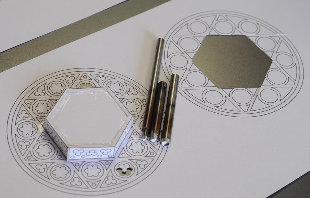

                                                I printed the "parchment" pattern on to card and made some punches out of silver steel with 2, 3 and 4mm diameter holes. This was a practice go to see if the edifice could be assembled using superglue. Hats off to those guys who make wonderful engineering models from card.
                                                This is the result which will be glued into the sound hole from underneath.
                                                I'm reasonably happy with it, I don't seem to have much flair for a more artistic design. I'm going to get the 10,000 rpm pulleys for the mill since I think I will be using small tools most of the time
                                                I hope this is of minor interest,
                                                Stay well,
                                                Rod

                                                  Fantastic work, Rod!
                                                  Both in programming the machinery and the execution.
                                                  Not for the heavy handed like me!
                                                  Howard
                                                  #470966
                                                  mechman48
                                                    @mechman48
                                                    Super intricate work Rod. Like Howard's comment; I have hands that compare well with shovels & fingers that resemble stub drills..face 20

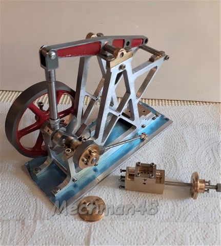

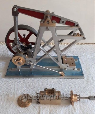

                                                      A bit more on my beam engine, cylinder components assembled & tried for fit…
                                                      The blue colour is just the plastic covering on the aluminium plate which will peel off once I get to cleaning & painting stage.
