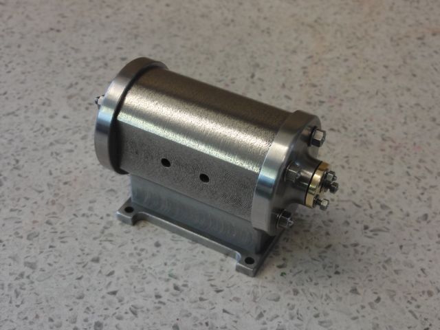

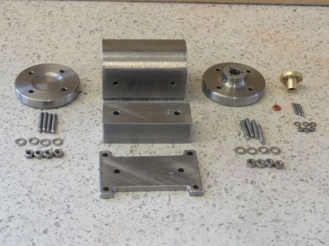

                    Having completed the Muncaster Double Acting Oscillator I had no next project lined up. Looking at my collection of engines I saw that I did not have a horizontal mill engine other than trunk guide crosshead type. Soooo I thought that Stew Hart's Dad's and Lad's Mill engine would be a fairly straightforward job for me and I could add some of my own "enhancements" to it along the way.
                    I gathered together some materials from the come-in-handy bin:
                    and set to. First stop is the cylinder:
                    and already there a couple of enhancements, the cylinder base having visible mounting feet and the piston rod gland, and a upcock which is trickier to see. I have made the cylinder with the inlet ports on the wrong side. Putting the cylinder head on the other end would correct it but I'm not too sure about the concentricity of the piston rod to bore if I did that so it is staying as is.

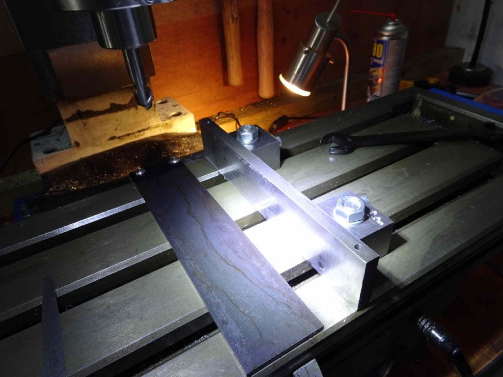

                            I've just finished what I'm calling a 'half vice' for my mill.
                            The immediate use is to square up a piece of 10 inch aluminium plate which will for the bases of a saw table for my femi band saw (slightly cheaper in parts than the real table and much much more expensive in labour!).
                            The Big square blocks sit in the t slots and are a rattle fit owning to the 3 slots all being different widths.The grey thing in front is an accurate T square made by milling across the bed with the backplate (hard to see in this photo) hard against the back of the table.

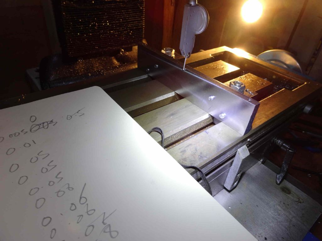

                            I wanted to see how accurate it was at an earlier stage of the build so squared it up with a big Angle and took seem readings with an indicator
                            On my second set of measures (after tapping it to properly square it), I found it to be within 0.05mm across the height and depth (which I was rather pleased with). Since then I've skimmed it (and got rid of the bolts sticking out), so I'm hoping it's even more accurate – especially with the new 'precision' T.
                            Tomorrow, I will measure it in the final version – I don't like to do so at the end of a job so I can retain my confidence in quality overnight!

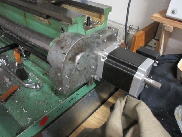

                                  I put up some photos of my ELS some time ago saying I would get round to fitting a belt guard. Here it is. Once I can get it to a fellow club member to get the curved bit tack welded with his TIG it will get a coat of paint. Anyone know what rattle can car paint matches Myford green?belt guard 2 (small).jpg

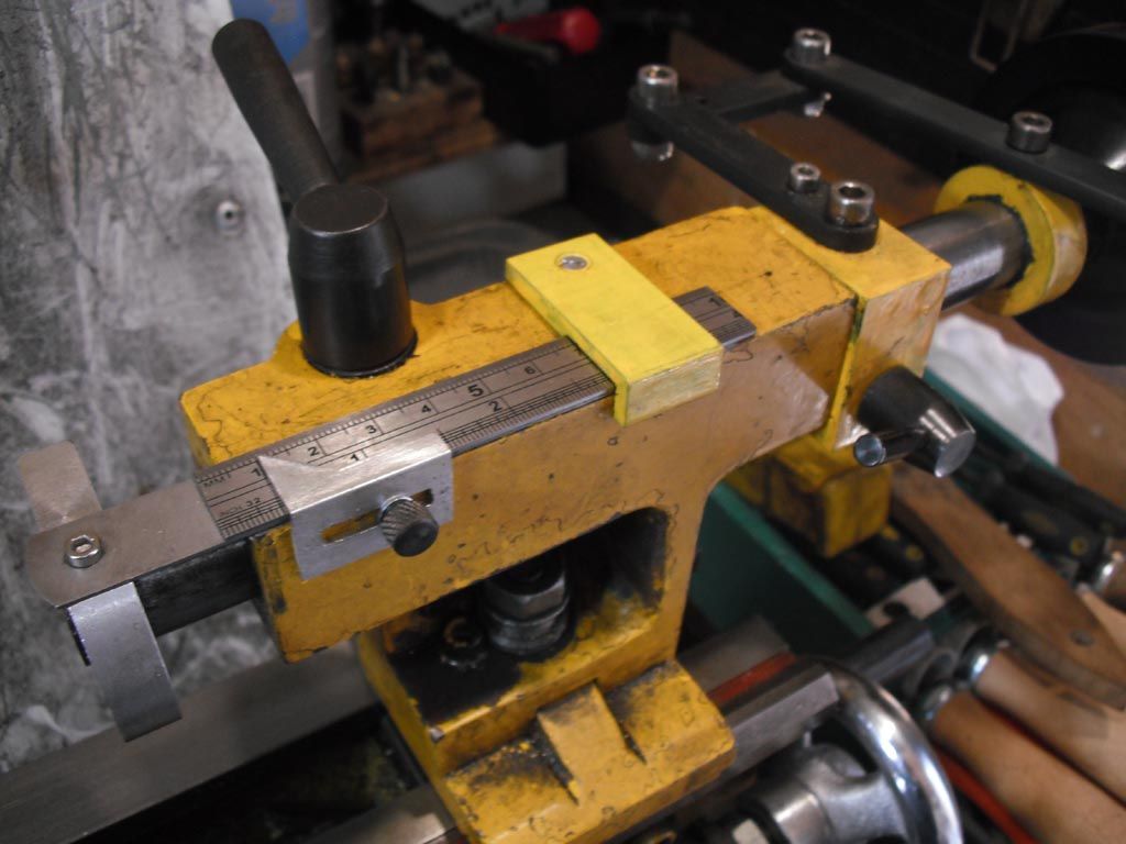

                                    I finally got round to fitting a scale I can read on the tail stock of my CL300 lathe.tsscale.jpg

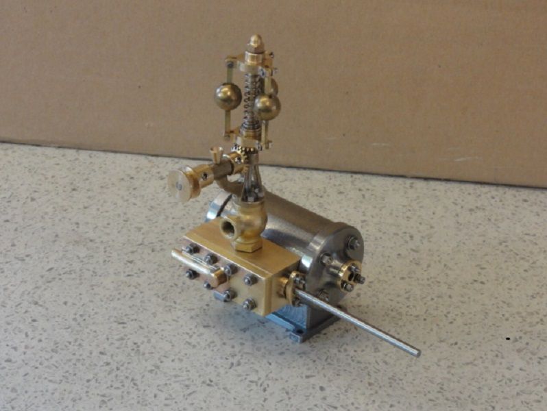

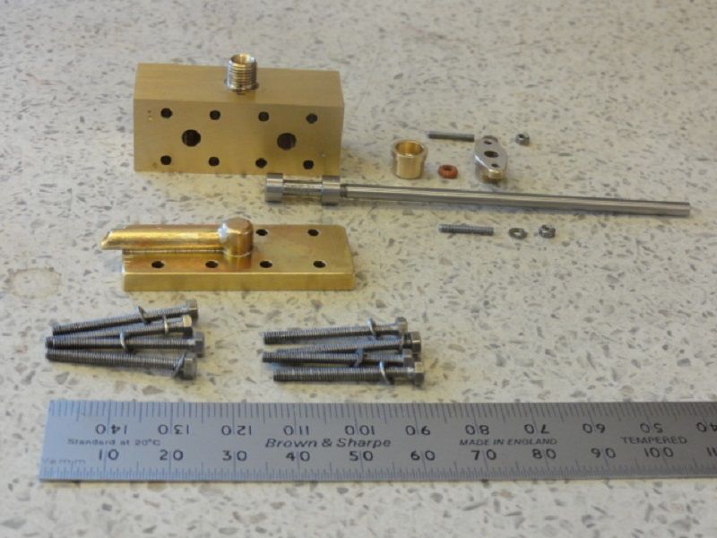

                                                  More of the Dads & Lads mill engine to show – the valve chest assembly.
                                                  Here's all the bits including the "enhancement" of an exhaust manifold to fit over the as designed plain outlet ports.
                                                  And here's the assembly complete with the Banggood governor on top.

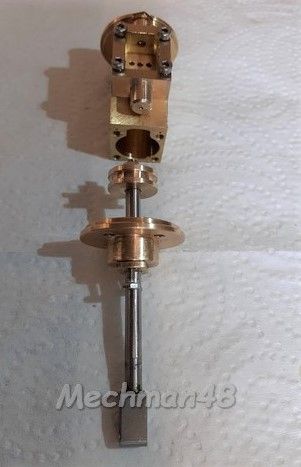

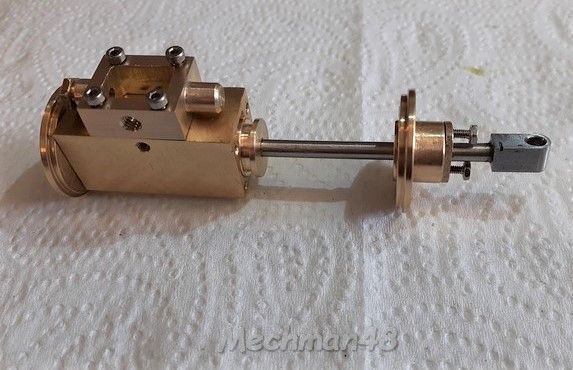

                                                    A couple more bits for my beam engine.. cylinder, piston, con' rod assembly..
                                                    Still needs PTFE / Nylon piston ring… PTFE rod ordered
                                                    Getting there.
                                                    George.
