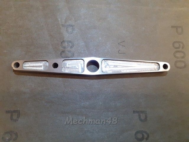

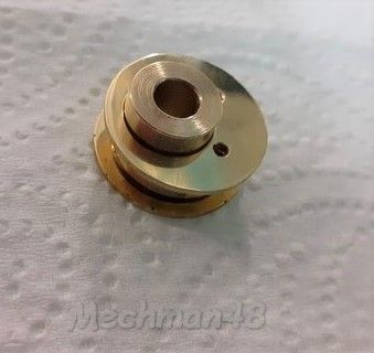

                  Some further work on the beam engine…
                  Main beam, CNC cut, thanks to Geoff Adams…

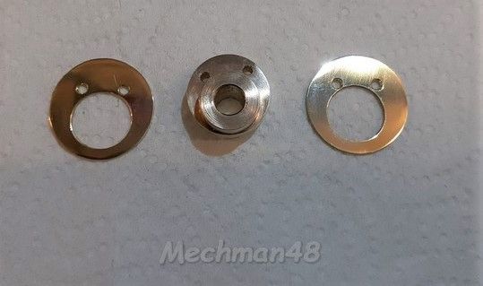

                  eccentric & side plates…
                  eccentric assembly…
                  George.

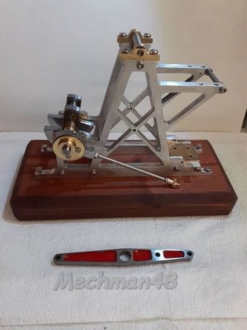

                        Started assembling parts on beam engine; still a lot to do but it's starting to look like a model. The beam has been given a etch primer coat & a 1st top coat but as usual will end up rubbing it down & giving it another coat, the bain of my model making, getting a decent top coat finish. A lot of polishing & clean up as I go along… thinking
                        George.

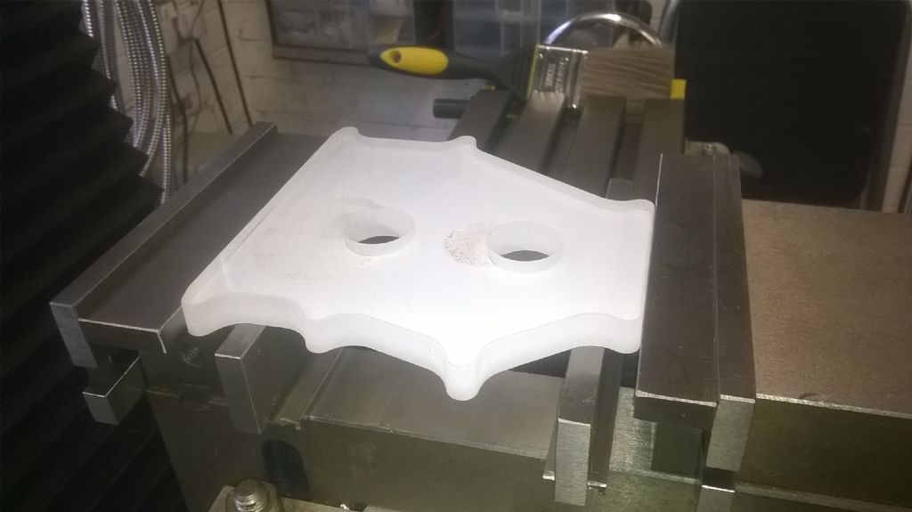

                                John Hinkley
                                  @johnhinkley26699
                                  Got the Perspex back from the waterjet cutters today and made a start on drilling and boring the holes. Due to the odd shape I had to do some lateral thinking and creative positioning of a number of parallels and the jaws of the ARC vesatile vice to get the workpiece within the working envelope of both the mill and DRO. Final result is shown below with the wooden pattern held to check out the positioning.
                                  Pattern setup for DRO
                                  Once that checked out OK, I placed the cut perspex in its stead and centred up on the top (left) bearing recess. Using that position as the reference point I changed the DRO readings to coincide with the coordinates on the drawing. I'm happy to say everything is working out well.
                                  Perspex front wall setup
                                  I'll have a go at the other "walls" tomorrow.

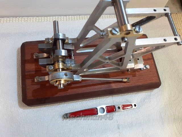

                                  mechman48
                                    @mechman48

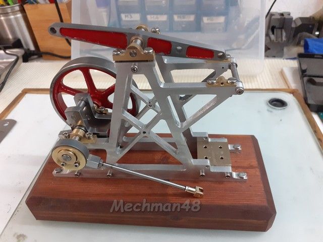

                                    A little bit more progress on my beam engine; just a loose assembly to see how pieces fit,there are a couple of tight spots I found already so need to sort them first…

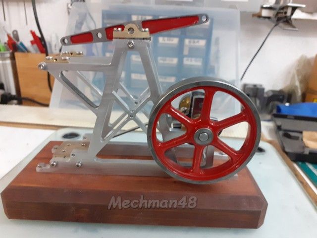

                                        mechman48
                                          @mechman48
                                          Thanks guys; Geoff, pic showing flywheel set up, set to run as true as possible with DTI, then machined the centre boss, front face, inner rim, drilled & ream bore, reverse & hold on machined boss after checking bore with DTI for concentricity,machine other side boss, rear face, inner rim & OD. Others may have a different set up.
                                          George.

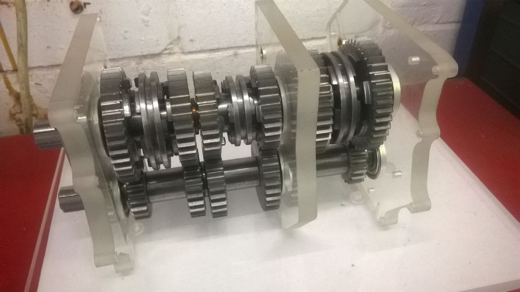

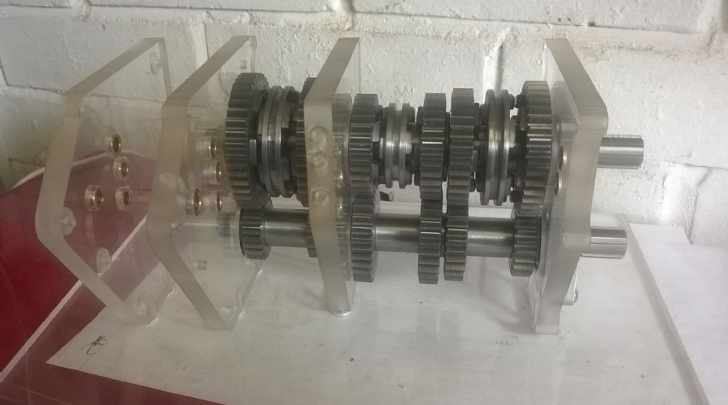

                                            Having had the mounting plates for my gearbox project waterjet cut, I've been busy drilling and boring all the holes in them, ready for a trial assembly. Here's the result :
                                            VERY annoyingly, an error has crept into one of my drawings and the reverse gear idler mounting hole is in the wrong place. I can't for the life of me understand how. It all fits perfectly in CAD 2D and 3D! I'm off to put my lateral thinking hat on so that I can hopefully retrieve the situation.
                                            I tried to add a desription to the album, but I get an error message in a previous picture telling me to use the correct format! Very strange. Tried deleting the picture and reloading, but it won't let me do that, either.

                                                Whoops! I seem to be monopolising this thread, so I'll be brief. Second trial assembly successfully completed. Details, if interested, in the album.
                                                Next job to tackle is the gear selector mechanism, Now that should be fun!

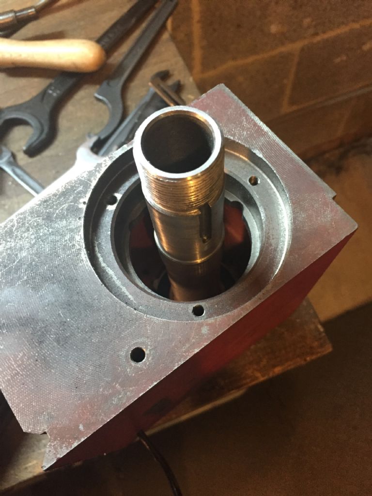

                                                    Also finally replaced the spindle bearings on my SC3. Four years of use and cutting vibration getting decidedly worse. Decided on angular contacts for now so I can measure up what I need to make for rollers in the future. Milled some slots into the abutment face of each bearing bore to make for easier removal next time, though it probably won't be me doing it.

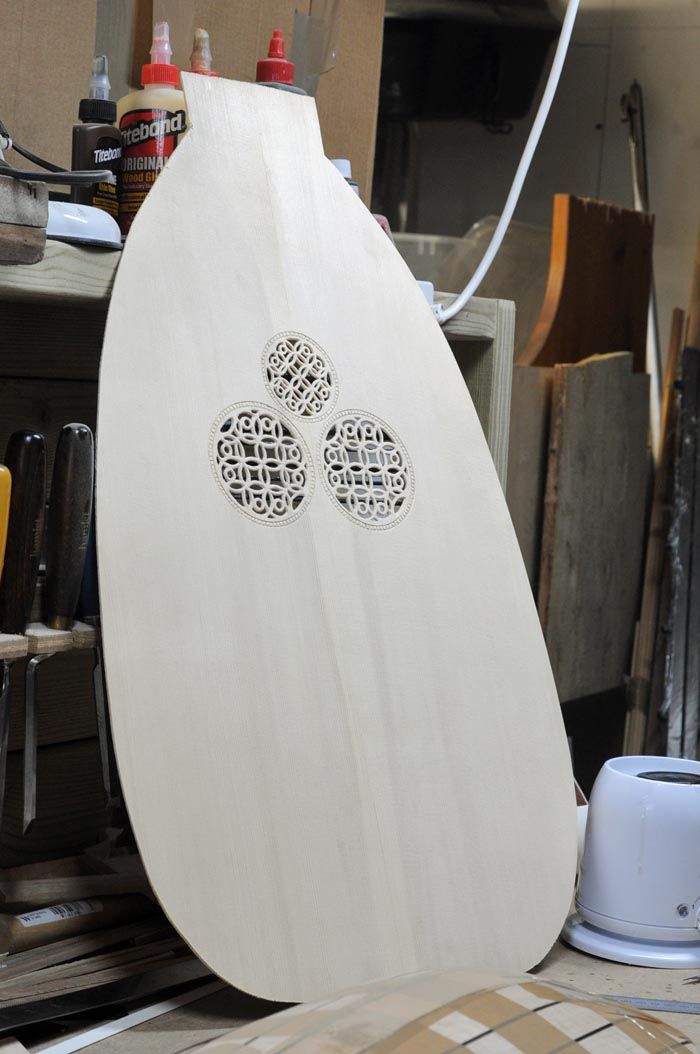

                                                      Jason mentioned my Farm Boy. It's been put to one side for the moment as I have been playing with the brown stuff. I've been getting on with my Chitarrone – carving the roses has been a bit of a stumbling block but it's done now. I ended up printing 3D patterns and using them as a cutting guide.

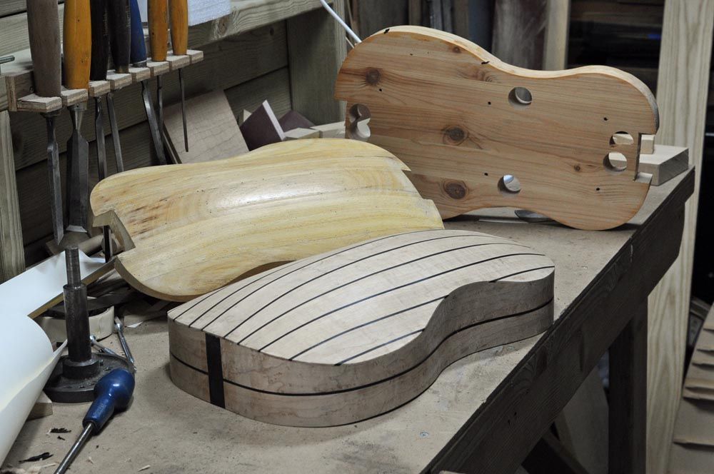

                                                      Also making a Baroque Guitar, I've just finished the body, shown with the mould I constructed.
