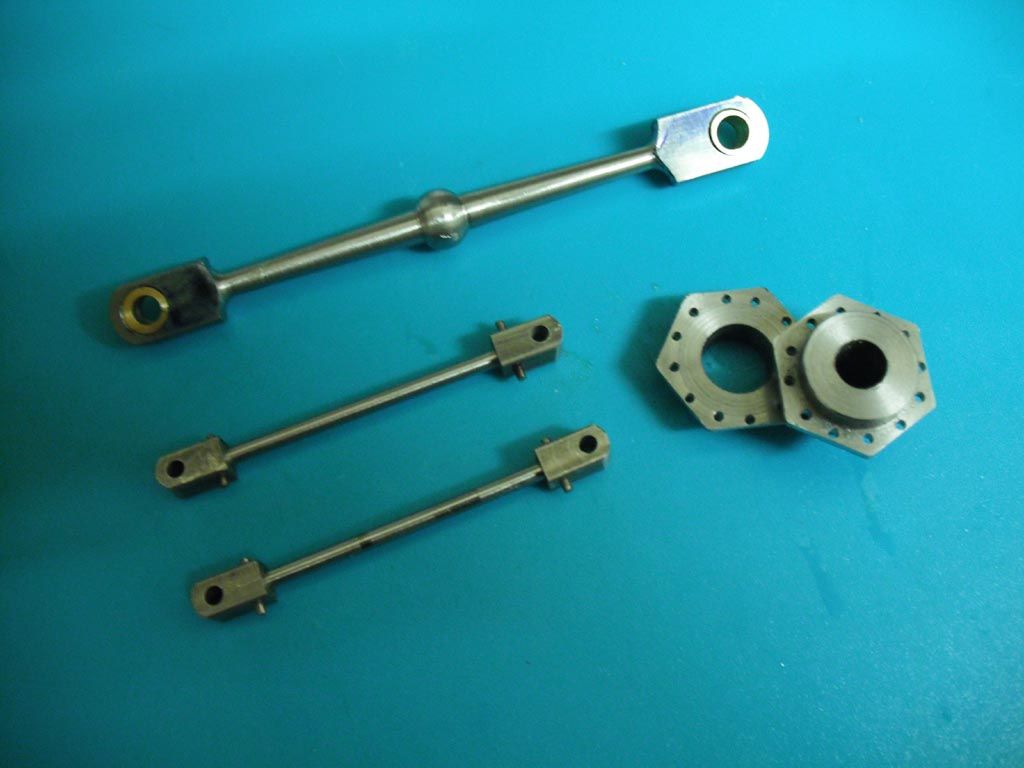

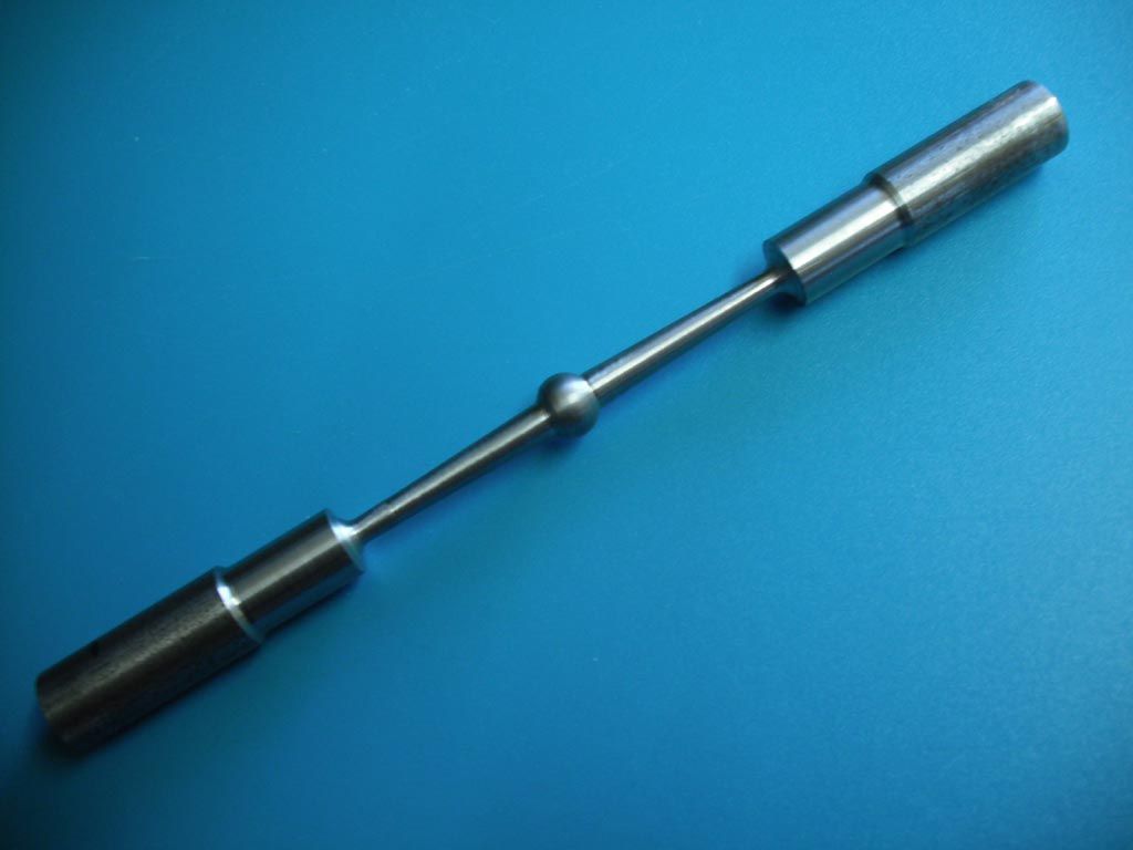

        Well it's plan "B". The lathe already had the collet chuck fitted, so I decided to make a start on the con rod for the beam engine. The picture shows the progress so far. The bit in the middle was done with the ball turning gadget I made during the last lock-down. I still have to saw off the excess bits on the ends and machine and drill the cross heads. That is tomorrow's project. Once done that is sheet 5 of the drawings completed. I have already completed sheets 3, 7 and 8.con-rod1.jpg

          Completed a few more bits for the beam engine. It's slow work as with it being flipping cold, I have to keep breaking off to get warm. The parts are- main con rod, two cross arm assemblies (not 4 as per drawing) and the flywheel hubs.

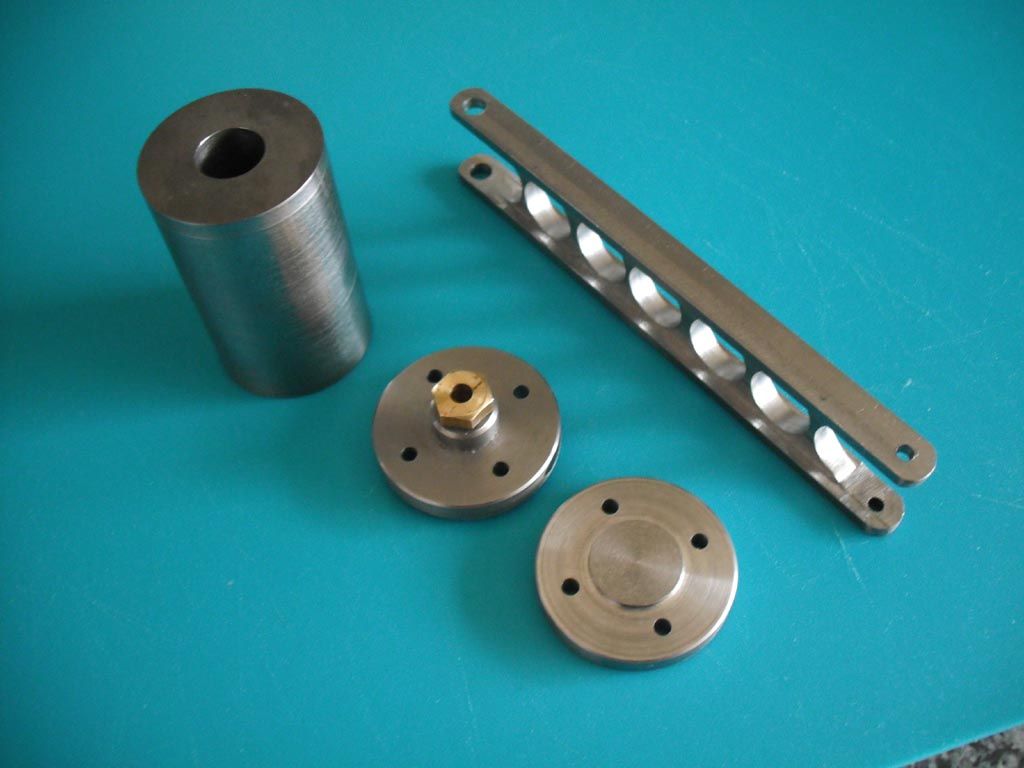

            More parts for the beam engine. The cylinder has been machined to length and diameter. Now requires boring. Finished the cylinder end caps, and also the vertical beam. I didn't have any suitable brass to fabricate the beam with, so I machined something similar from a solid piece of 10 x 25 mm black bar.more.jpg

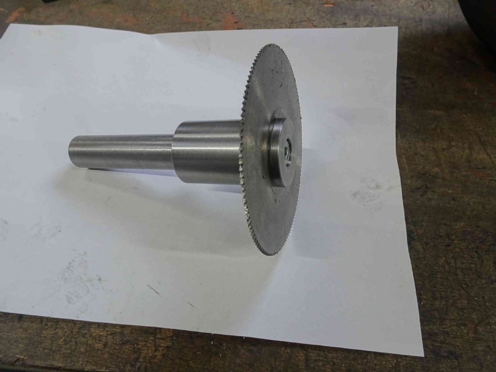

              A low profile slitting saw arbour, inspired by one Joe Pie did on you tube.
              This is to make a part for my surface gauge, which I may get to a bit later on (though the shed is a bit nithering, even after the heater's been on for a while.

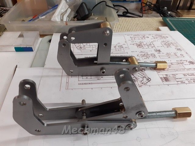

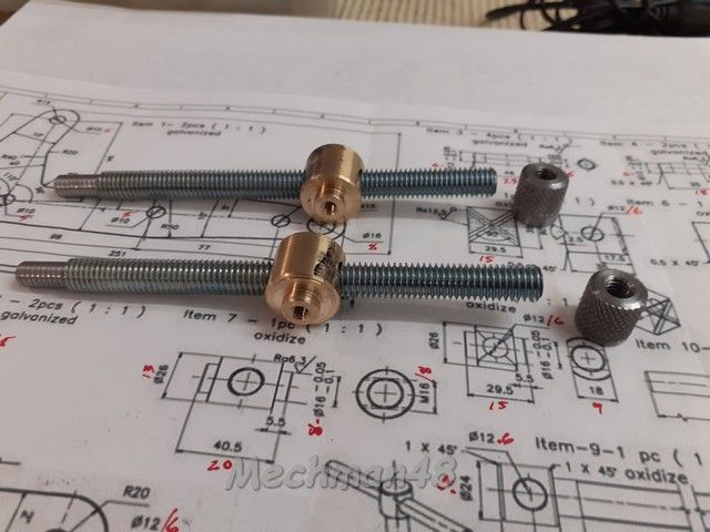

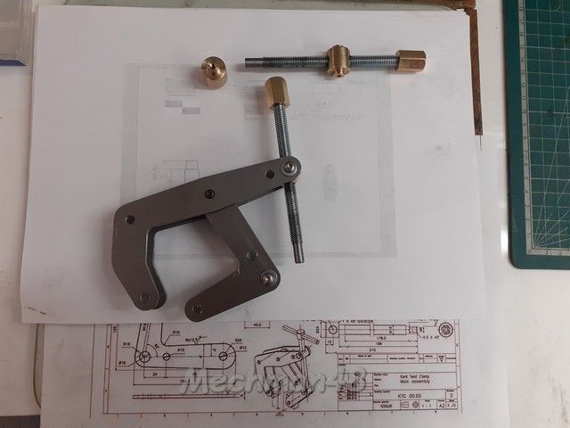

                  Have put the beam engine on the back burner 'till the new year, just can't seem to get it right. have started on making up some Kant clamps to supplement my clamping tools…most of the bits are from the scrapbinium box apart from the side frames which were cnc cut, many thanks to member Geoff Adams down in Hampshire…
                  Decided to use brass hex instead of knurled MS… bit of blingy look..
                  Frame spacers to make, brass grippers to make..
                  George.
                  #516361
                  Ian McVickers
                    @ianmcvickers56553
                    Nice clamps. 1m looking at making a few of them myself soon for some welding aids instead of G clamps. I have the frames drawn on cad so far. Are those the papacad drawings?
                    #516468
                    mechman48
                      @mechman48
                      Posted by Ian McVickers on 30/12/2020 18:48:54:
                      Yes they are Papacad drawings.
                      George.
