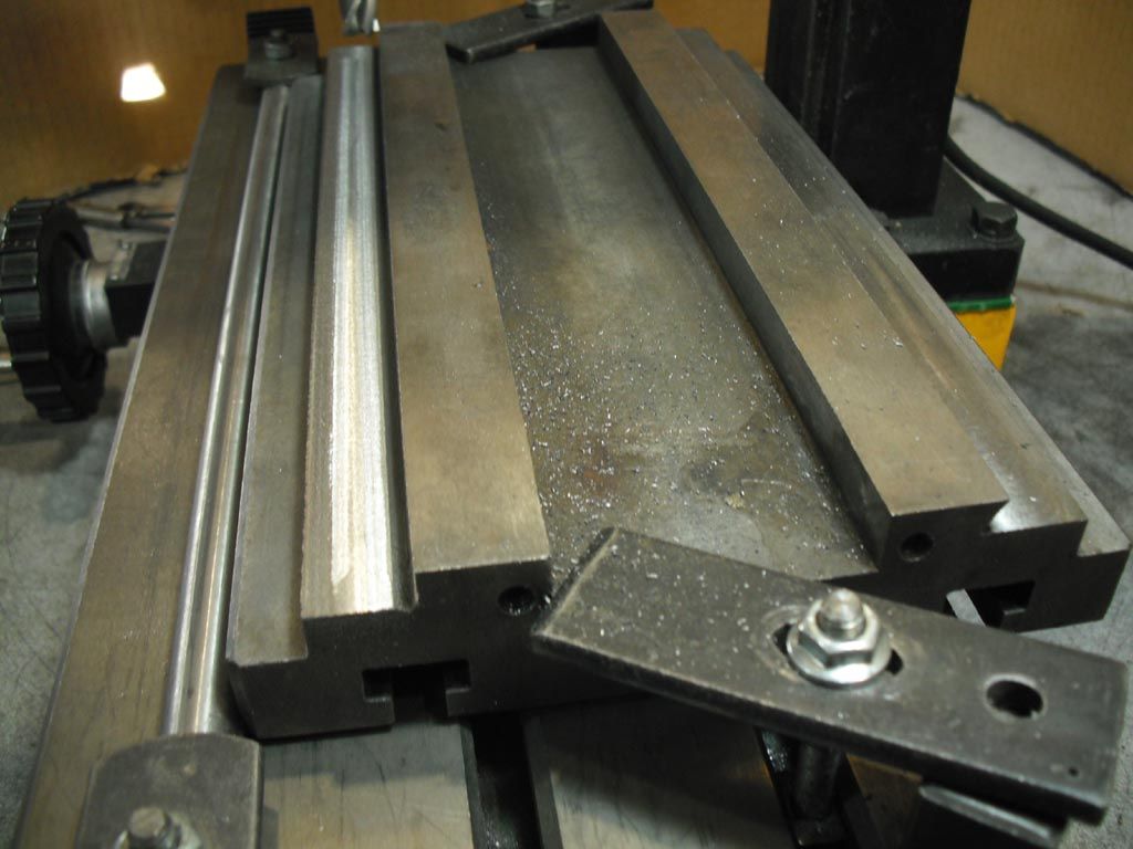

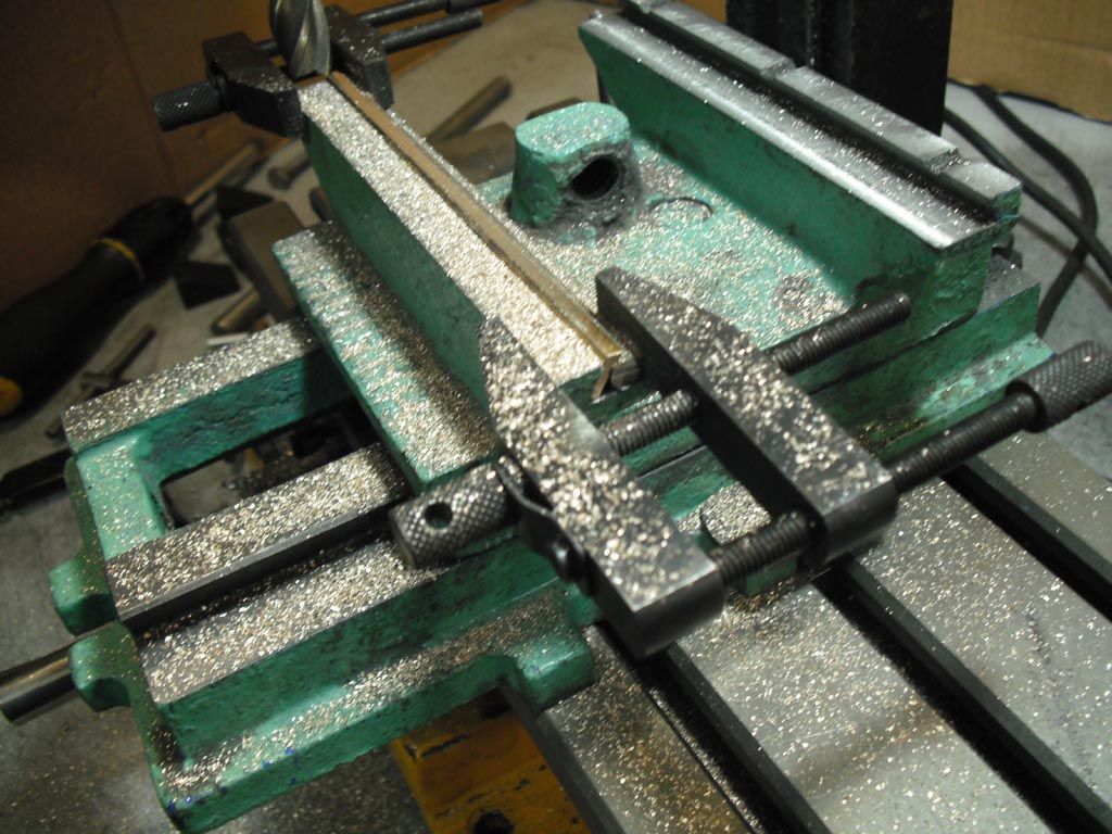

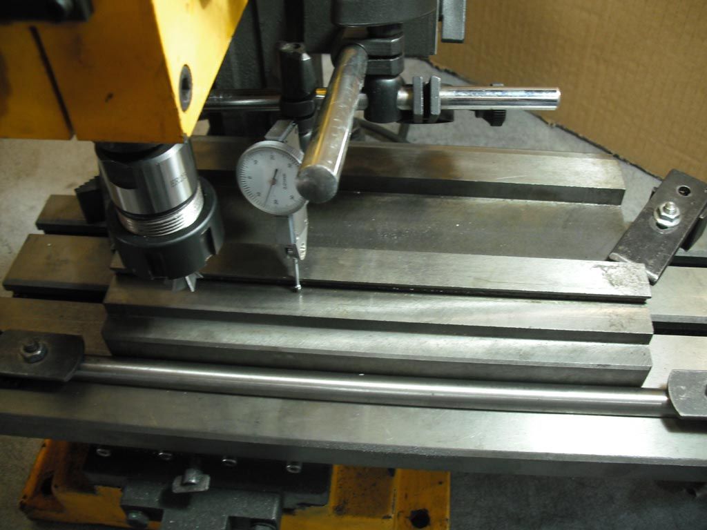

      I clamped a 12mm silver steel bar in the front T slot of the milling machine to act as a guide to clamp the old table up against, ready for machining. Checked alignment with a dial gauge and as expected, it was spot on.
      Milled the original dovetail off.
      then cut the new dovetail to the width required. Next job is to make the gib strip

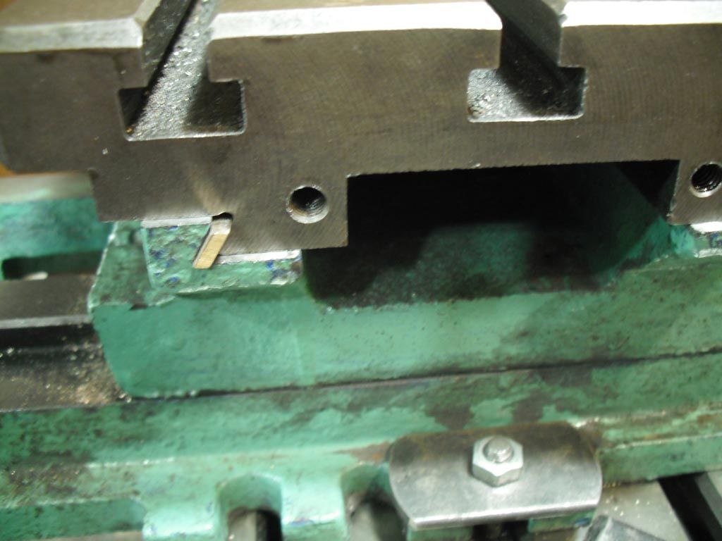

                  Got some brass strip to use for the gib. Clamped it to the dovetail to machine the top edge. Turned it over and packed it up with a hacksaw blade and cut the other edge. De-burred it and tried it for fit.

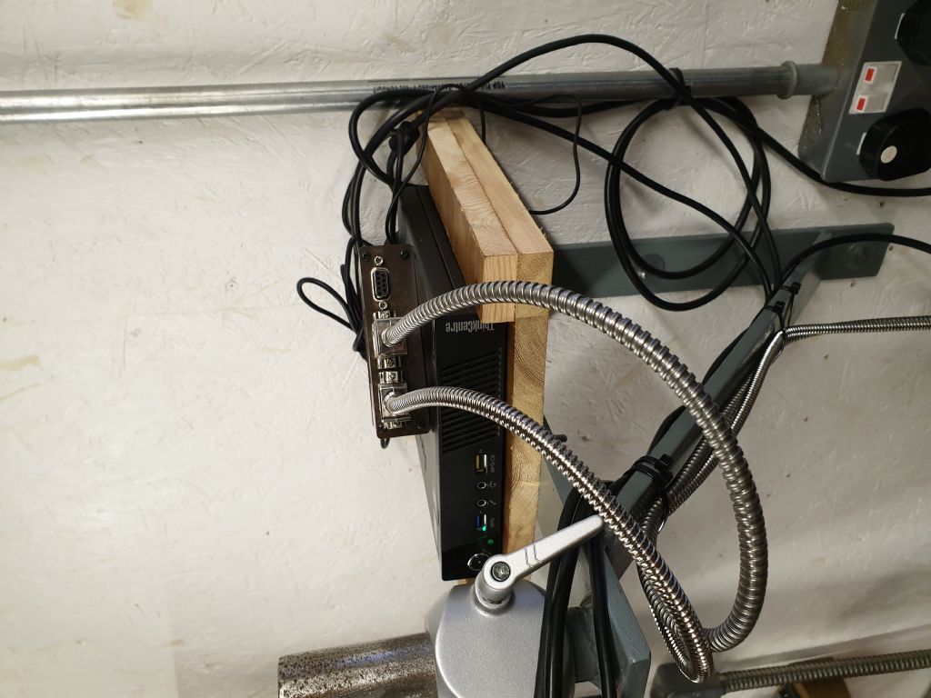

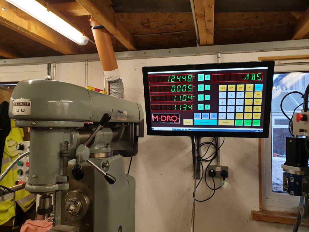

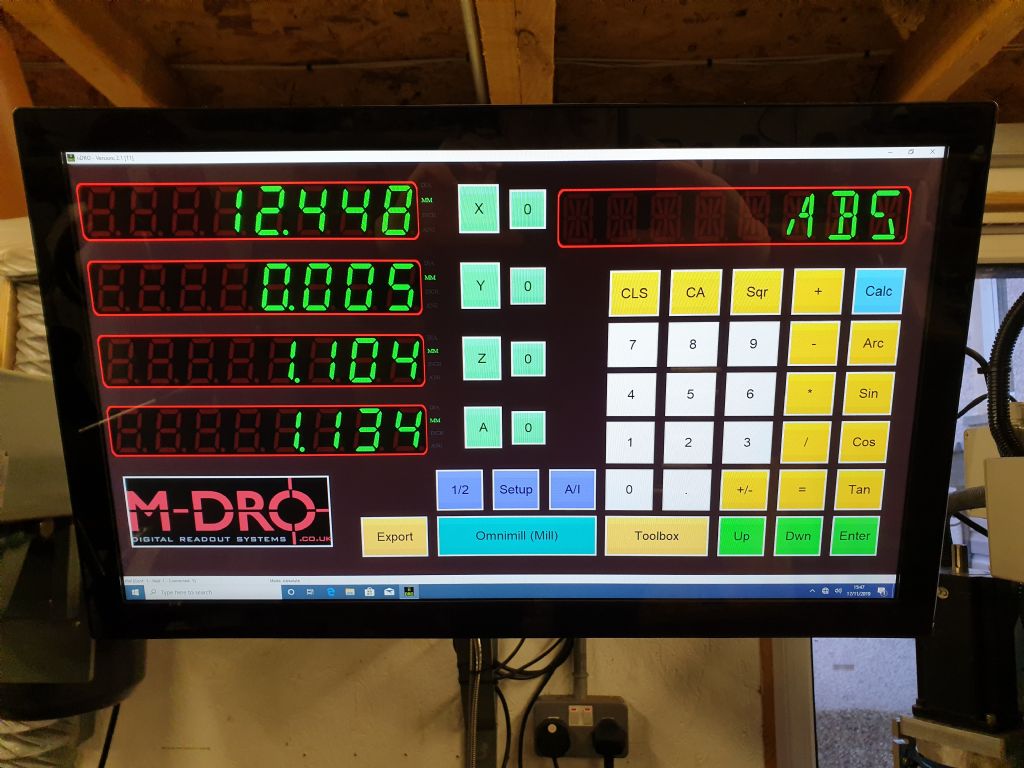

                      Finally managed to get back into the shop and get the dro install finished on the Omnimill. I went down the pc based dro route seeing as I had a small pc and spare touch screen lying around. I had planned on using rotary encoders and rack I have as well but that idea didn't work out so I went for scales.
                      The monitor is 21" wide screen so I don't have an excuse for miss-reading the dro now. So far it works well and I plan on fitting further scales on the vertical axis and quill.

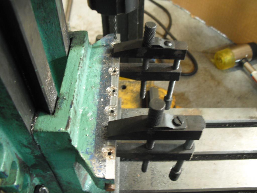

                        Used the set up below to drill the holes for the gib strip adjusters. It was a bit tight and looks a bit precarious, but it's solid enough for drilling.drill gib adjusters.jpg
                        I then clamped the gib strip in place and drilled through to put the dimples in the gib.spot jib.jpg
                        I then removed the work piece from the milling machine and tapped the holes by hand. I haven't got any 3mm hex socket head screws so I've had to use pozi head screws as a temporary measure.

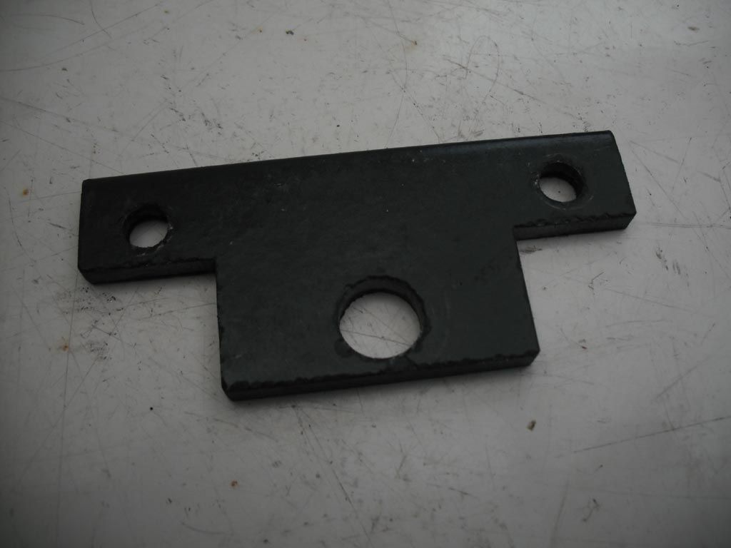

                          It's me again. I must be the only one braving the cold workshop. Made a plate to carry the lead screw.endplate.jpg

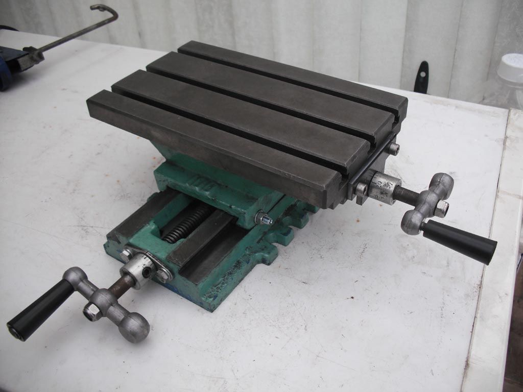

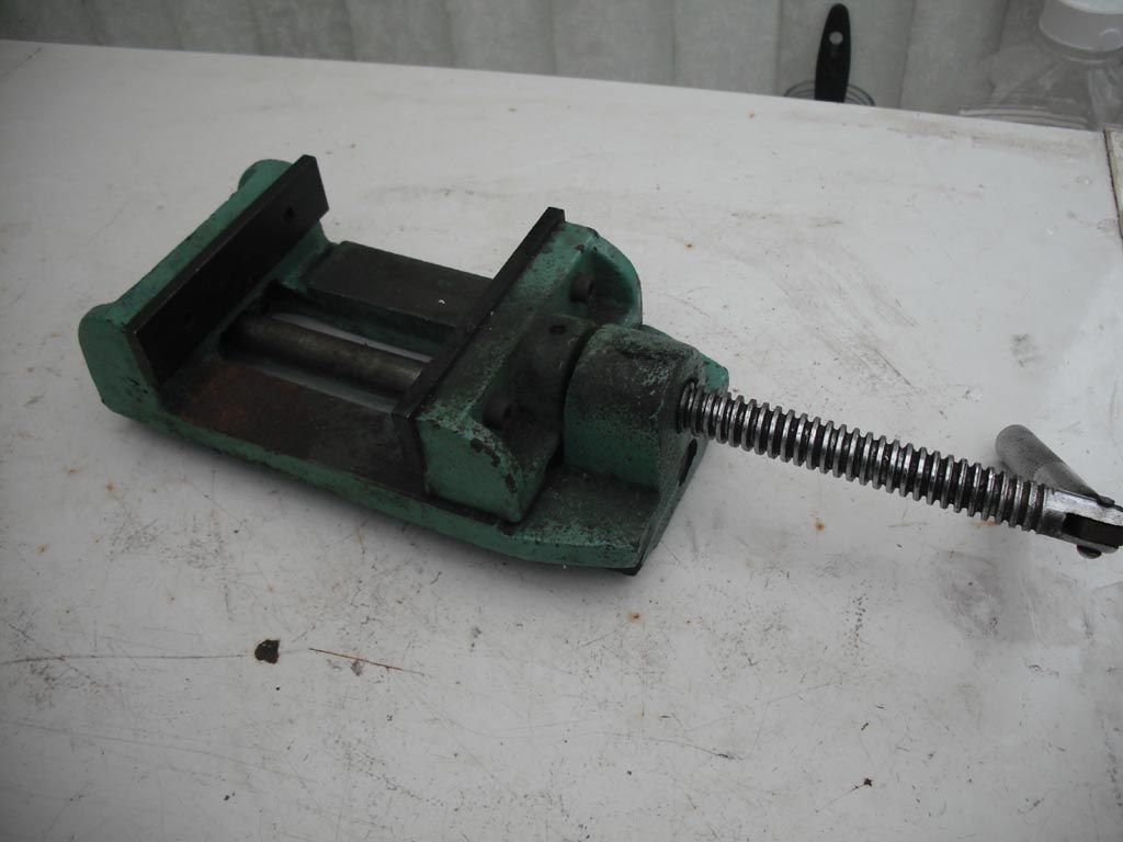

                              I assume there is a PC with box of tricks driving the monitor, I have looked on the Machine DRO website and cannot see anything that resembles the equipment in the picture. Please could you post a link.

                                First picture in Ian's post shows the PC interface sat on top of a small PC.
                                The Main Machine-DRO site has none listed but M-DRO does?
                                EDIT, found it on the main site now

                                  Looks a good idea … but:
                                  This product is now discontinued, please contact us for possible alternatives.

                                    The DRO interface is indeed on top of the small pc. The older model is still on the website but I have one of the first new ones. Looks like they havent got everything finished off yet. Last time I spoke to Tony at M-DRO he said they were waiting on label plates I think. Worth giving him a call if your interested.
                                    #438220
                                    Ian McVickers
                                      @ianmcvickers56553
                                      Forgot to add that mine has 4 input channels, the other one is on the back. Im sure Tony said that you can choose either 3 or 4 inputs.

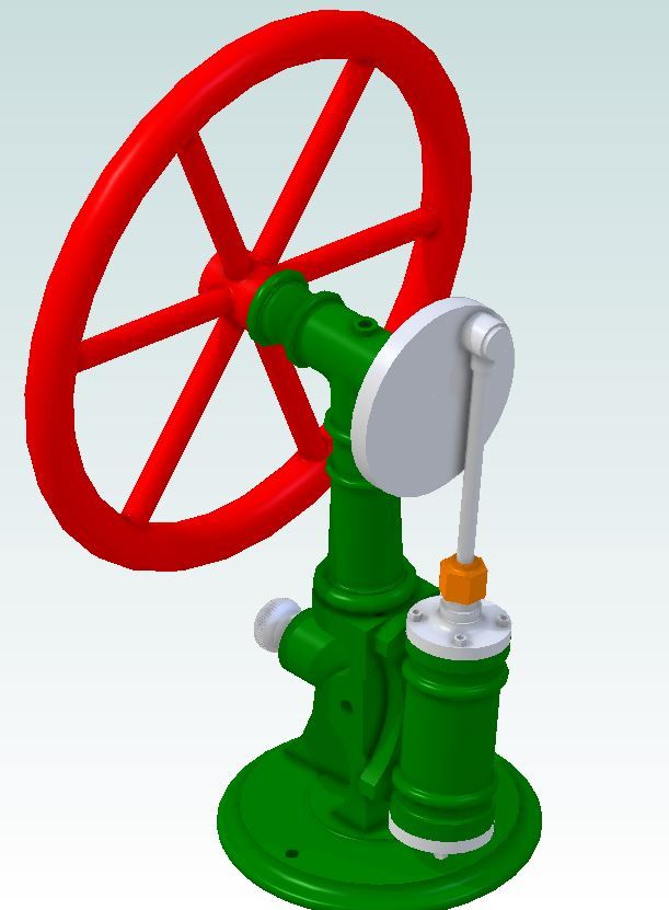

                                            A bit of progress in the "virtual" workshop over the last couple of evenings and I have my next project. I had seen this engine on Preston's site several years ago and liked the look of it so copied the images to my "future projects" file. Size dictated by the offcut of 7" dia thickwall steel tube that I was given which will be used for the flywheel rim.
                                            Still a bit of tweaking needed to the design before I start cutting metal – cylinder may be a bit large in dia and circular base a bit small.

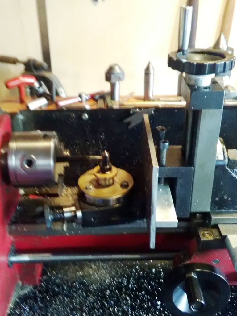

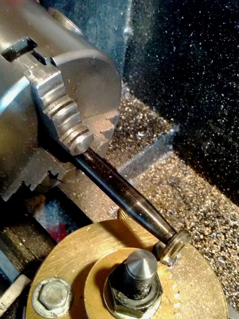

                                                After a year or so of renovating the new house I have finally found time to play in my shed.
                                                This arrangement allows me to cut spur gears.
                                                I used an old bolt for the single point cutter but will be ordering a cheap set of mod 1 cutters from China.

                                                  I decided to have a go at the flywheel for the Oscillator I posted the other day. First thing was to clean up the slice of thick wall tube to 14mm wide x 14mm thick, hope Andrew approves of te swarf colour.

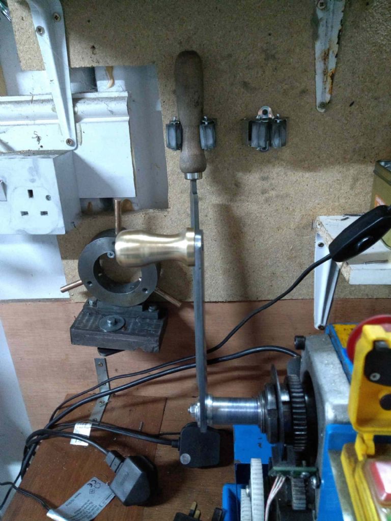

                                                      Over the last couple of weekends I've made a spindle handle, much like the one in MEW (though not the same).
                                                      It's somewhat based on Neil's design from his book, but i decided to have a go at a nice brass handle.

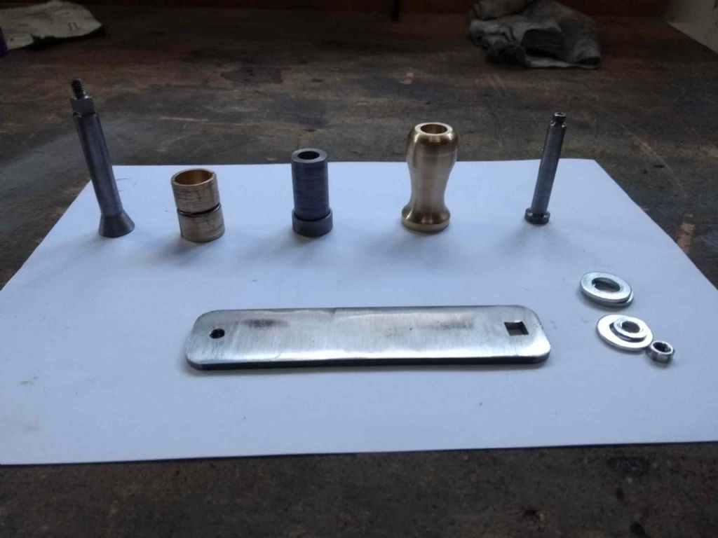

                                                      below being the individual parts
                                                      The main problem I had with this is that the conical bit on the shaft was attached by super glue. However, this shifted when trying to tighten it up. I had a couple of a goes which failed. So my next attempt was with some Locktite green retainer which has worked ok.
                                                      The other thing I've not quite got is finish. Part is knowledge, most is patience. However one thing that lets it down is that I can't get all the layout blue out where there are fine grooves. I accept that the correct way to sort this out is to lathe a better finish and perhaps one day I'll get there! In the meantime, I've tried meths and Isopropyl alcohol neither have got the blue out of the cracks.
                                                      Any ideas?
                                                      Iain
