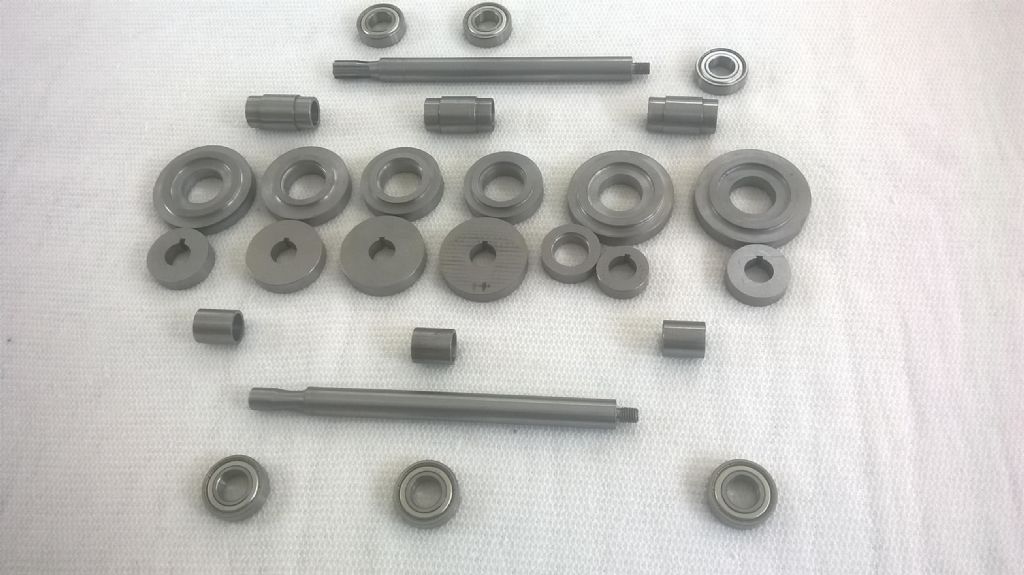

          It's been a while and slow progress, but progress it is …..
          All the gear blanks for my 5-speed transaxle gearbox had been made, as have the input and ouput shafts, gear hubs and spacers. The output gears need the dogs machining and of course there is going to be a monumental gear cutting session coming up. I've been waiting until all the gear blanks were finished until setting up the rotary table. I had to alter the ratio of 3rd gear slightly as I can't obtain a 28 tooth pattern with my rotary table set up but it made little difference overall. Below are a couple of pictures from the album:
          The gear internals so far, with some finishing still to do:
          Gear blanks
          The same parts, loosely assembled. To give some idea of scale, the shafts are 201mm in length.
          Gears sets on shafts
          I am awaiting delivery of some 10mm thick perspex sheet to use as the casing faces for display of the finished workings. I'll post further pictures of progress later. Much later.

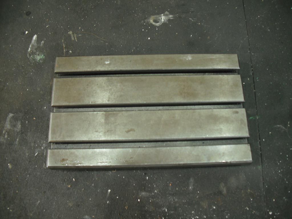

                                At the beginning of July I fitted the longer table and leadscrew to my CDM10. The original table shown above has been sat on the bench annoying me, because I'm not sure what to do with it.

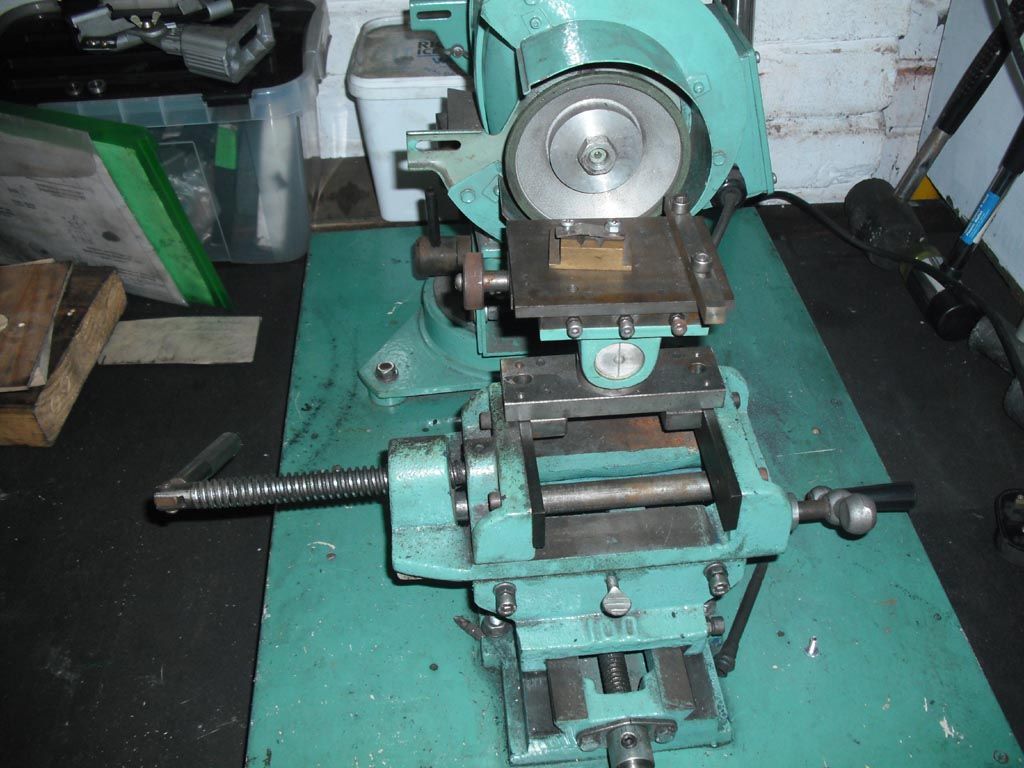

                                This is my home made (some might say bodged) tool grinder, made from a cheap bench grinder mounted on a lockable turntable (made from a car brake disc) together with a cheap cross vice. Any attachments to assist with grinding specific tools are held in the vice. This is not ideal, but has worked for years. My cunning plan is to remove the actual vice and mount the table in its place. I have taken measurements and this will involve removing about 4mm from the top of the cross vice dovetail where the vice was fitted. I also need to remove a total of 13mm from width the table and vice dovetails. This could be a long job involving a lot of winding because my mini mill can only take small DOC.

                                      That table looks familiar! I have just done the same improvement to my mill, and the old table is now sat on the bench annoying me too! Very good idea to use it like this. I think I'll hack off the dovetails on mine and make it into a mini pallet for my CNC mill. The table is big enough to drill lots of holes into it for various attachments.
