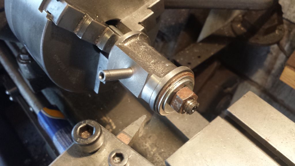

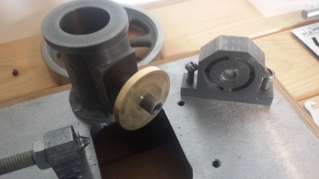

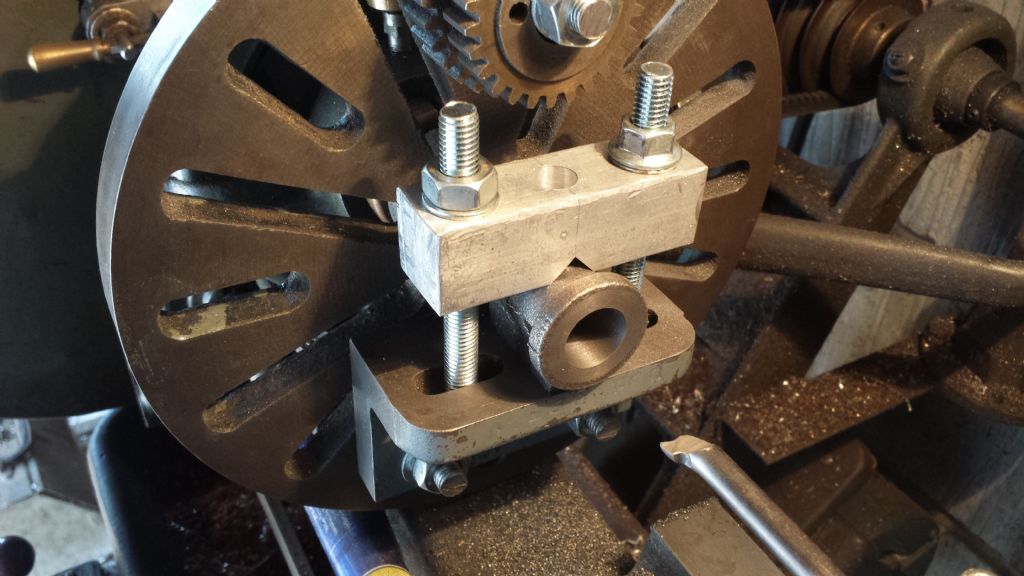

        Hi Jim, (Nic)
        I just noticed your earlier post 1/10 and see you have started the Muncaster oscillator. Good idea to have the frames laser cut, I know what you mean they were somewhat tedious to make, sawing filing etc.

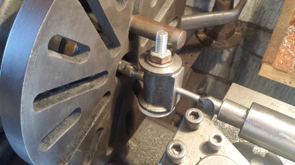

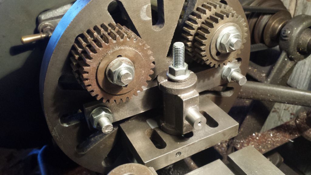

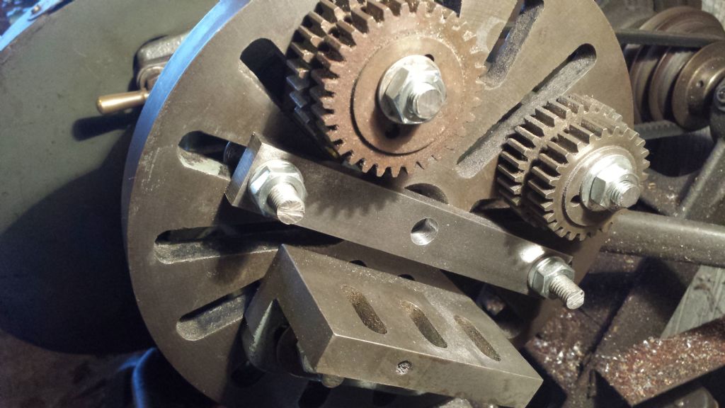

        This is how I started machining the cylinder casting.
        1. I skimmed one end of the casting so it was reasonably square to the core hole. Then set the face plate up as shown in the next photo. The hole in the strap was drilled and bored in situ and is the same size as the spigot on the front of the casting, the pivot spigot.
        The spigot fits snugly in the hole and the casting is clamped to the angle plate as shown in the next photo. With the other spigot running as true as possible, the trunnion spigot, just take a light skim of the diameter, the end and also centre drill the end. don't skim the inner port face at this setting.
        Now hold the trunnion spigot in a collet or a grip true chuck and centre drill the pivot spigot. Using a half tailstock centre support the casting and skim the end of the spigot and also true up the diameter. Now hold the work between centres similar to the set up in the last photo, skim the trunnion spigot again and lightly face square the inner port face. Next set the casting up on an angle plate, port face down, and bore to size, 20mm diameter. also at this setting machine the casting to its final length 46mm ensuring that each end is an equal distance from the centre line of the trunnion.
        Mount the work between centres again and turn the trunnion to the correct diameter and face the inner port face so it is 19mm from the centre of the bore.
        20190419_125328.jpg.The cylinder flanges can be turned to size with casting mounted on a 20mm mandrel as shown in the next photo.
        20190424_100446.jpg.The brass or gun metal disc is jb welded to the inner port face.
        Hope this is of some help Jim Geoff

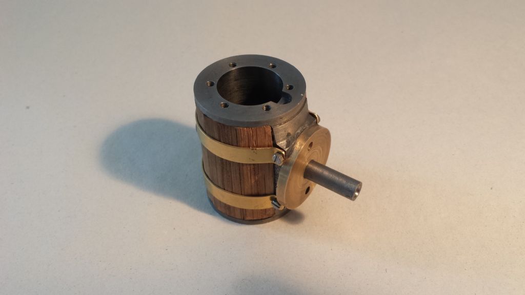

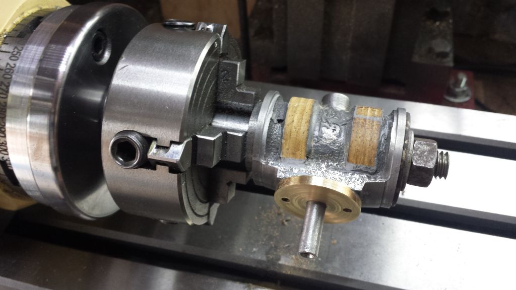

            Here is another rotary table photo which shows how I machined a shoulder on the inside of the flanges.
            The shoulder is for the hardwood cleading to sit on. The packing pieces are also hardwood.
            I turned up some hardwood rings which I then split into segments and then jb welded to the cylinder. These were leveled at the same setting to the same height as the shoulders.
            Geoff

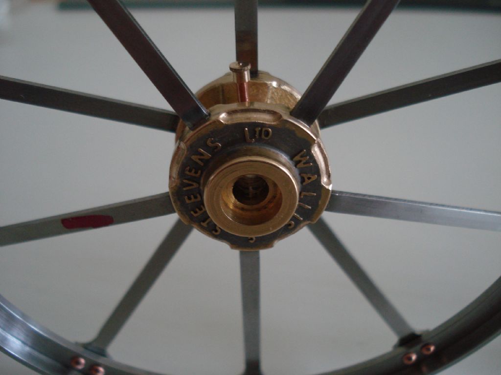

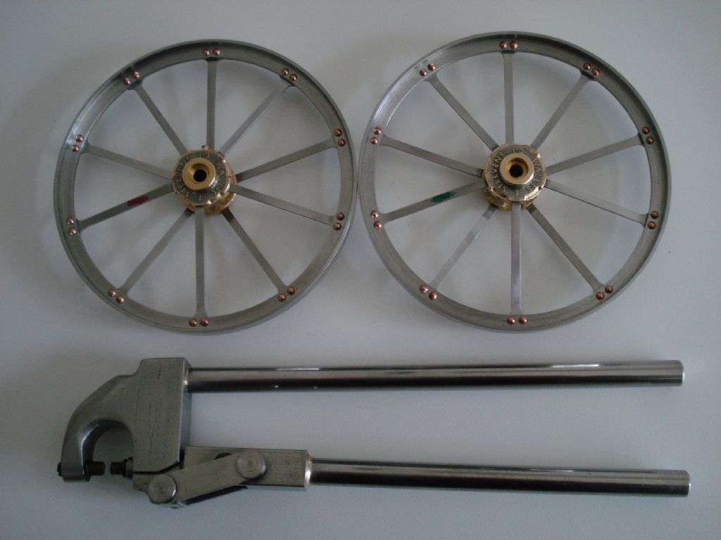

                                            Richard S2
                                              @richards2
                                              Finished the wheels for my 1" scale water cart. The old riveting tool I made 30 years ago came in handy. Added detail to hubs to reflect the casting pattern-
                                              Oil tube and cap-

                                                #435229
                                                mal webber
                                                  @malwebber91786
                                                  Superb job on them wheels Richard and that lettering must of taken some time but what a result and finishyes.
                                                  Mal.
                                                  #435232
                                                  Phil P
                                                    @philp
                                                    Richard
                                                    Those wheels are superb, well done.
                                                    Can I ask you to enlighten us on how you produced the raised lettering please.
                                                    Phil
                                                    #435259
                                                    Richard S2
                                                      @richards2
                                                      Thank you Jeff, Mal & Phil. Lettering took about 2 hours for each wheel start to finish. Happy with the result.
                                                      Phil, have a look at the bottom post on page one of this (hopeful) link below to give a description. I have more lettering challenges on the plates at each end of the tank, so I'll try and sequence some pics on here at a later stage that may help (he says without checking he has enough lettering left).
                                                      Brass Lettering
                                                      Regards
