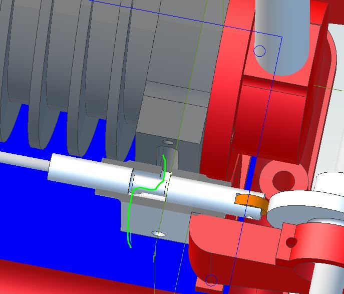

        #413825
          Morning Ron
          A spool valve works in much the same way as the common slide valve except it is a round valve in a round hole and shaped like a spool or bobbin.
          Here you can see that the cam has pushed the spool so that the gap in the middle exposes the air inlet from below and the passage into the cylinder so cylinder fills with air or steam.
          In this view the crankshaft and therefore cam have rotated 180degrees so the spool now exposes the passage and the exhaust port which is in the part cut away in the section but is where the arrow shows the flow of exhaust gasses.
          #413827
          Ron Laden
            @ronladen17547
            Morning Jason,
            Thanks for the explanation, it looks to be a really neat idea for a valve, I guess it comes from full size engines and possibly dates back quite a few years..?
            Ron

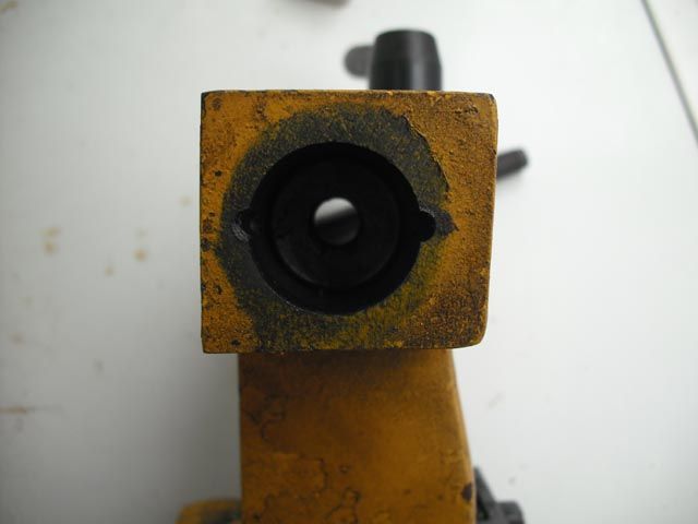

                Finished making the bits for Mike Cox's lever feed tailstock.
                I've had a few problems on the way. Tried making the feedscrew in one piece with the intention of soldering the 16mm washer on afterwards. Cut the thread with a 10mm 1.5 LH die using a tailstock die carrier and manually turning the lathe over. Some how it didn't quite come out at 1.5mm pitch, don't know why.
                So, sawed off the faulty thread and machined the original feedscrew to join it to the other half as per Mr Cox's build instructions.
                When I set up the block to drill and bore the 22mm hole, I took special care to ensure the punch mark was properly centered. I was shocked when I offered the completed block up to the tailstock casting to find it was miles out. However, not my fault. It's the 22mm bore in the tailstock which isn't central. Aaargh.

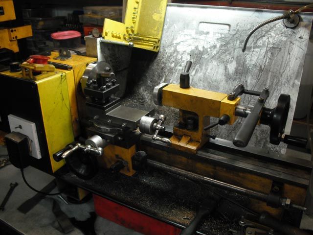

                    Paint is dry so I've fitted the Mike Cox lever tailstock. First proper project since my illness last year. so I'm pleased it works well in spite of the odd shaped tailstock casting.lever taistock.jpg

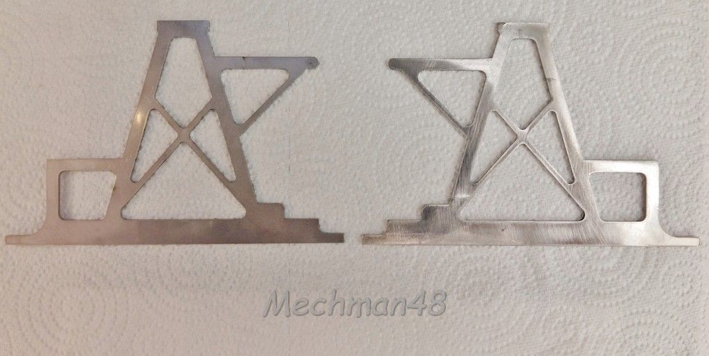

                        Picked up the side frames for my beam engine project. Superbly cut on laser cutter in stainless Steel…

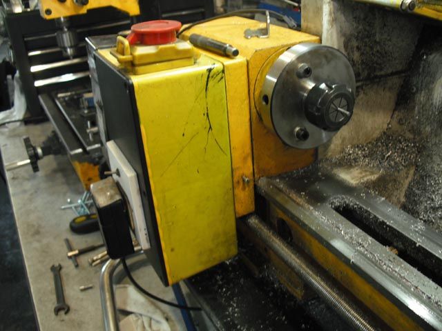

                              Posted by Anthony Knights on 19/06/2019 10:55:09:
                              Hi Antony,
                              I am glad it all worked out well in the end.

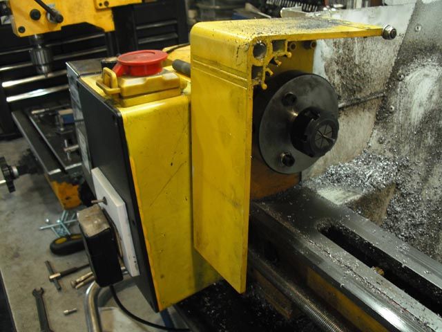

                              I am intrigued by some of the other things on your lathe:
                              1. What is it on top of the head stock?
                              2. What is the yellow object at the top that appears to be resting on the sloping splash guard
                              3. There appears to be something on the left hand side of the leadscrew before it disappears into the electrical control box.
                              Sorry if you think I am being nosey!
                              Mike

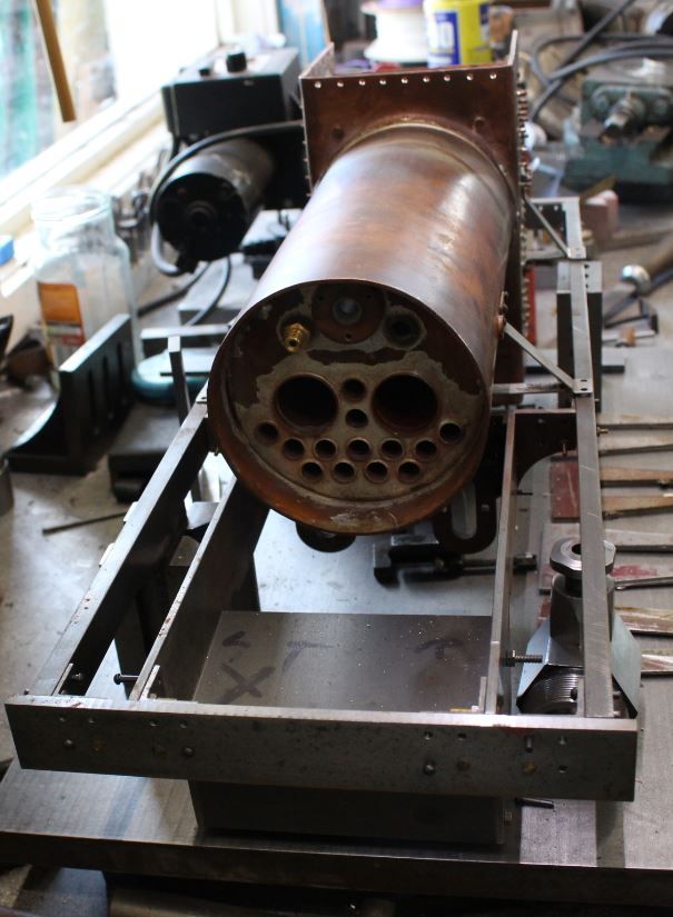

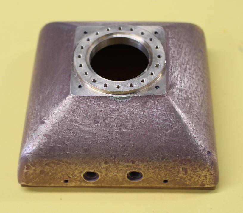

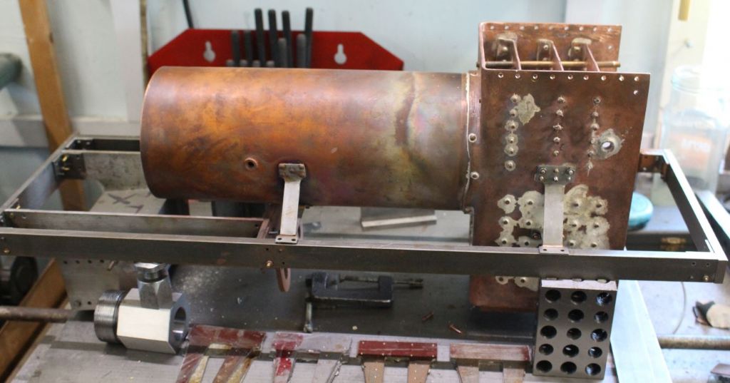

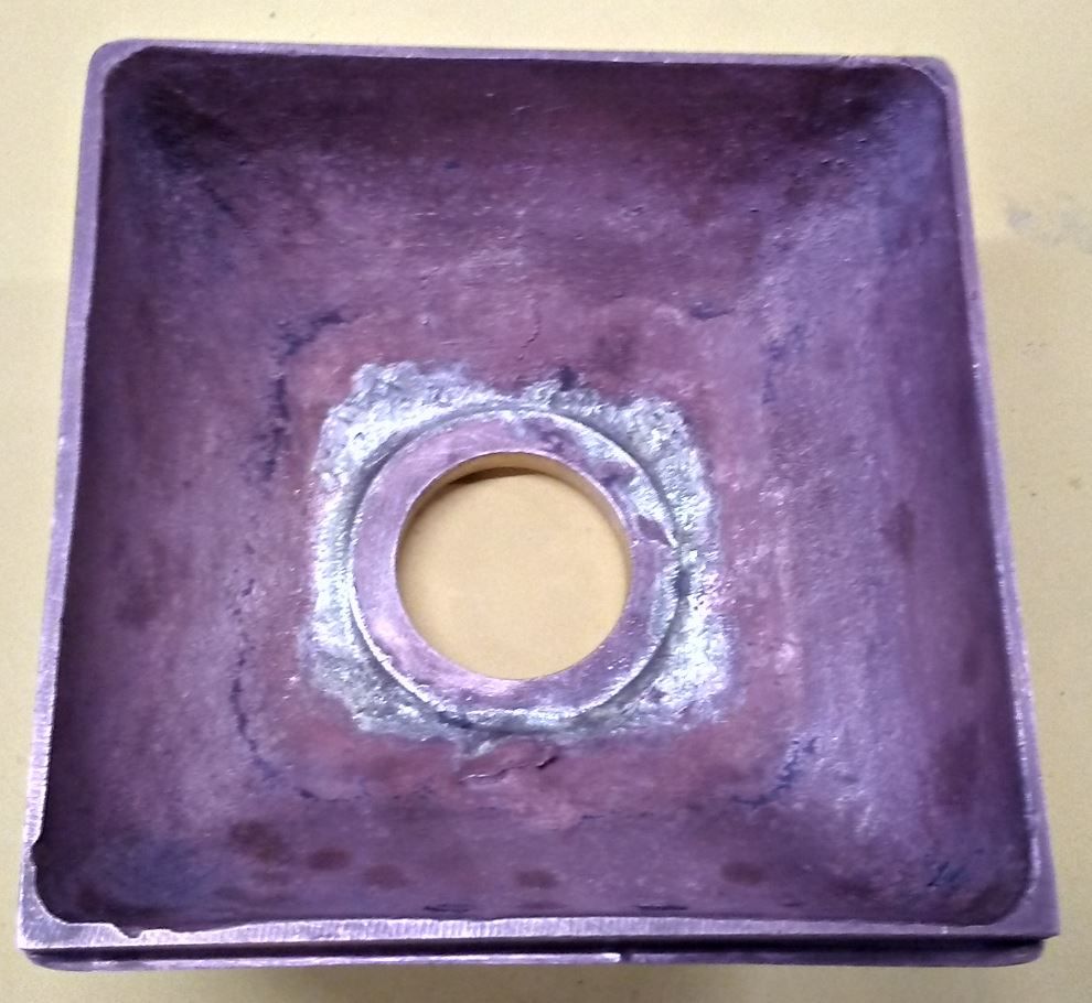

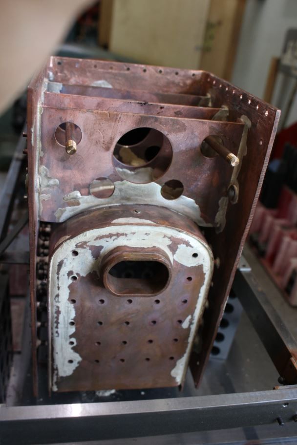

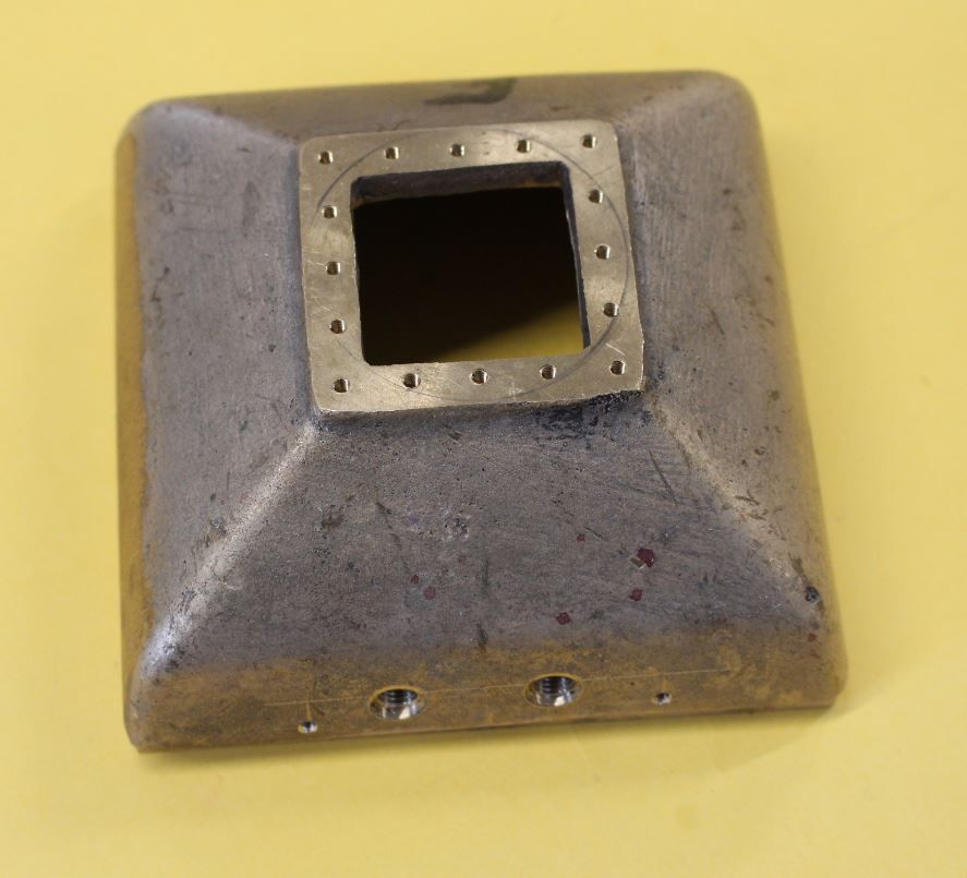

                                My 5"g Lion Boiler is progressing, I'm finding silver soldering this mass of copper very challenging but I think I've done an OK job even though some looks a bit messy, soon find out on the hydrostatic test, fingers crossed. Hope to be finished this boiler in a couple of weeks.

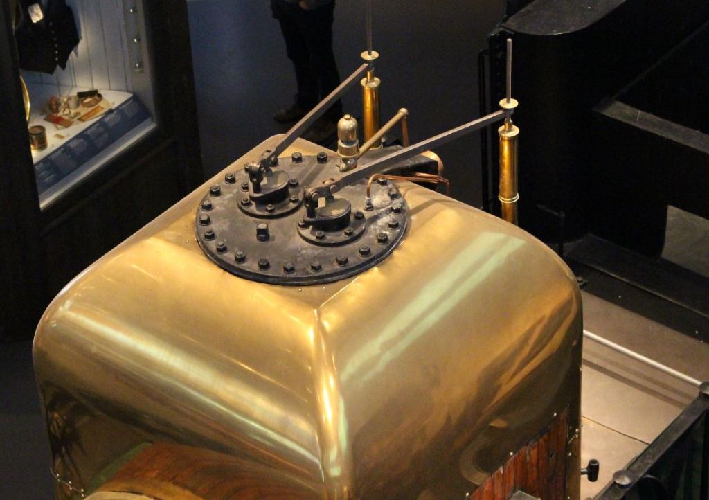

                                The drawings show a square manhole on the boiler dome and I initially machined, drilled and tapped the dome casting accordingly.
                                However, the loco in the Museum of Liverpool has a round manhole on the boiler dome.
                                I decided to modify my dome casting to resemble the full size loco. I bored out the dome casting, machined up a ring and silver soldered it in place. One benefit is that I can use a silicon 'O'ring as a seal.
                                I'll be allot happier when I can get back to machining parts rather than very nerve racking silver soldering.

                                #422588
                                Jim Nic
                                  @jimnic
                                  A good looking modification Nigel , well done.
                                  Jim

                                    Anthony Knights
                                      @anthonyknights16741
                                      Hi there Mike. You are not being nosy at all. In fact, I have been a frequent visitor to your web site and done several of the mods and improvements on there.
                                      The red thing which appears to be on top of the headstock is the lid of a plastic storage box in the background. The metal thing actually on the headstock is an angle bracket (I think from some flat pack furniture) which I use as an aid to threading the nuts when changing chucks.
                                      I'm not sure what you mean about the "yellow thing" unless you are refering to the chuck guard which was made from a cut down electrical box.
                                      chuck guard.jpg There is nothing on the lead screw, but I did hear about a problem with swarf entering the electronics box via the hole at the bottom of the box I have therefore built the control circuitry into a fully sealed box which is mounted as shown below. The black plug at the bottom of the box is the supply unit for the washer motor powered coolant system.gen view.jpg
