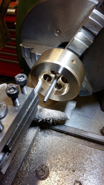

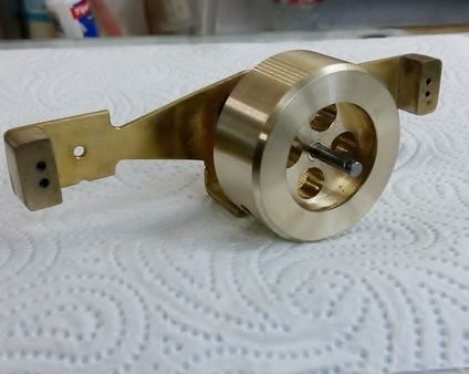

          mechman48
            @mechman48
            A bit more progress on my Boxer twin oscillator, been on the back burner for a while…. discarded the first flywheel as it was too big in OD & ID ( from another project ), made a new one…
            so far…
            George.

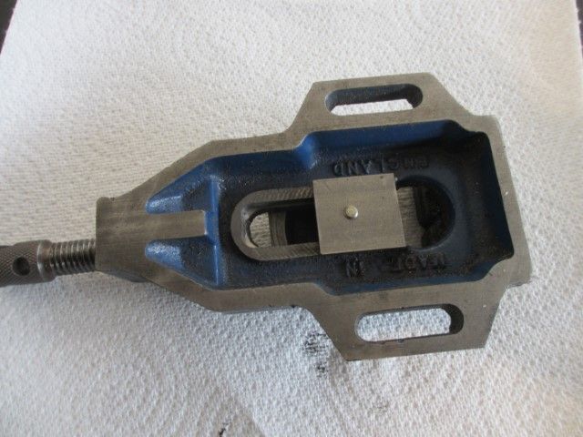

                                  Not my idea, Mr Tredenick from Australia, as featured in MEW Feb 19. How to stop the jaw lifting on your Record drilling vice. Only took an hour or so

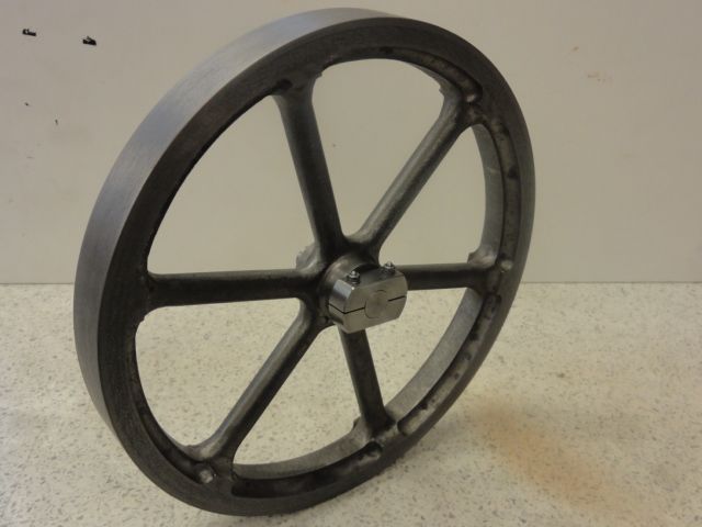

                                    In my last post on the progress of Stew Hart's Overcrank design I had made the valve eccentrics (and the eccentric straps) which had to be fitted to the crankshaft centre section before assembling the shaft. I then thought that making up the shaft would naturally be the next operation. When I came to cut the 12mm dia bar to length for the main part I found that the exact length depended on the width of the flywheel and the output pulley hubs. Sooo the next task was to obtain a flywheel casting from Stuart Models and machine it and make a pulley and, while I was at it, a pulley for the governer belt.

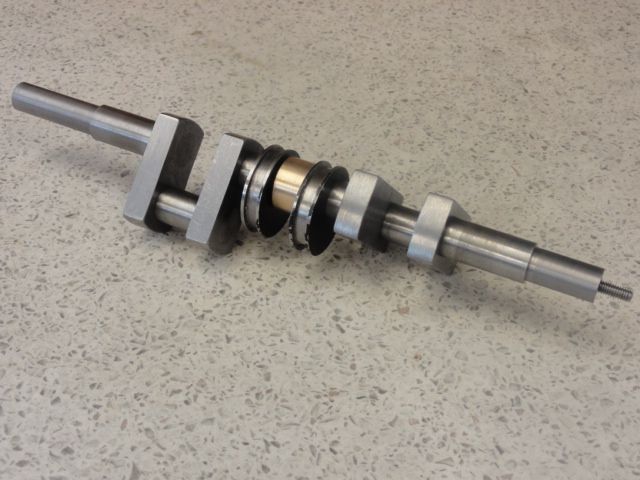

                                    Then I assembled the crankshaft using my usual Loctite method but since this was a twin cylinder engine I also pinned the webs. The pins are fitted through the webs from one end, go through both the "big end" and the shaft section but stop short of protruding from the other end of the web.

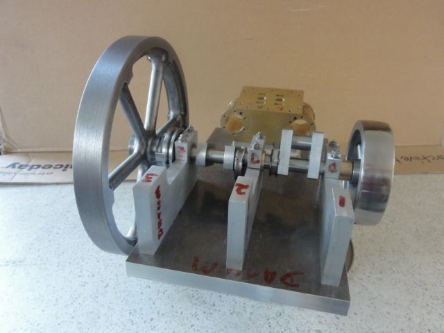

                                    And here is an assembly shot of the crankshaft in position before I had cut out the redundant pieces between the webs.

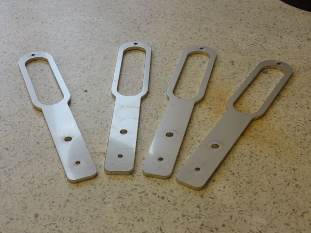

                                    Next up I get to fit the laser cut crank return rods

                                        Duncan Thanks for the tip, will give that a go.

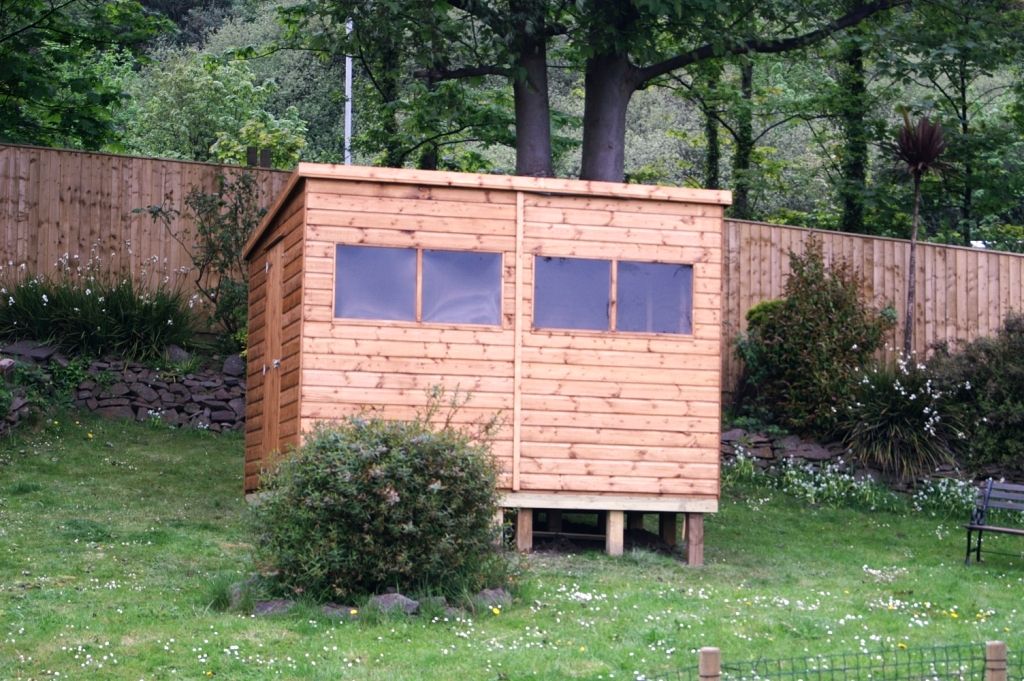

                                                The new shed/workshop is finally erected, I've been aiming for a better set up since we got here last October.
                                                8' x 10' from ShedsAhead of Port Talbot who did the installation.
                                                Because of the slope and underlying limestone it sits on 18 4"x4" piles.
                                                Next the power and light, then the benches. I've been saving the old kitchen units and worktops for this job.

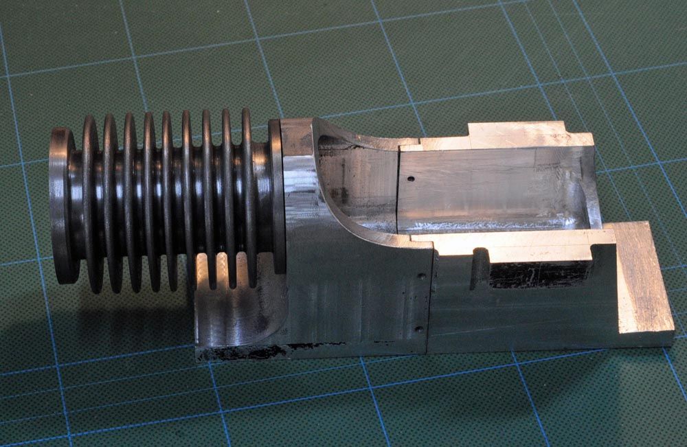

                                                  Roderick Jenkins
                                                    @roderickjenkins93242
                                                    Machined the cylinder for my (air-cooled) Farm Boy hit n miss
                                                    Rod
