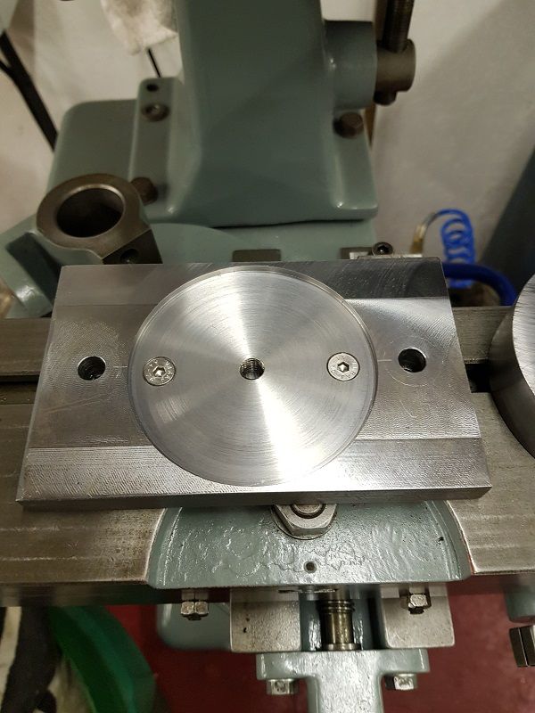

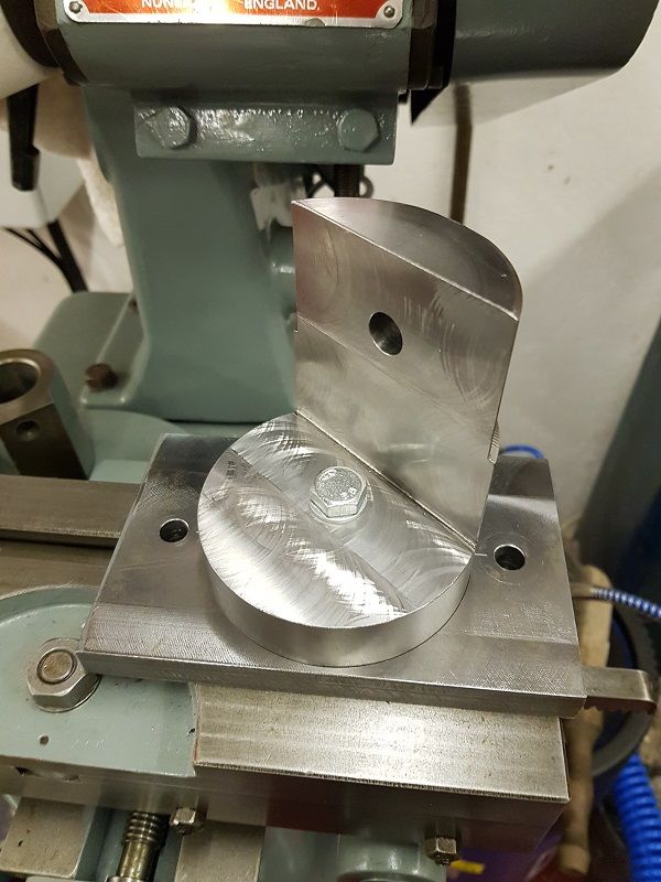

                    Managed to get some more done to the universal head upgrade.
                    Added locating bar to the base plate so that it slots snugly in the t slot on the table.
                    Upper part nearly done apart from engraving the degrees scale. The 40mm indexable head I have didn't leave a great finish so I will give it a rub down when everything else is complete.
                    All parts fitted together to see how it looks on the tool grinder and so far so good.

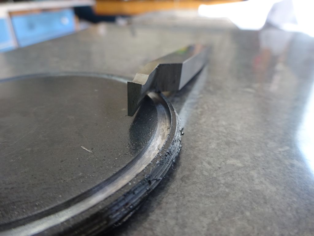

                            Jason, out of interest a couple of questions from the cart build and the wheels. When you cut the centres from the steel discs was the tool a parting tool, cant quite see the tip in the photo. Also when turning the radius on the hubs, is the ball cutter you used your own design and build.
                            Ron
                            #391923
                              It's what is commonly known as a trepanning tool, much like a parting tool but one edge needs extra clearance so it won't rub on the outside edge of the groove being cut.
                              I made the ball turner but it is more or less to the Steve Bedair design, if you google "bedair ball turner" you should find drawings.

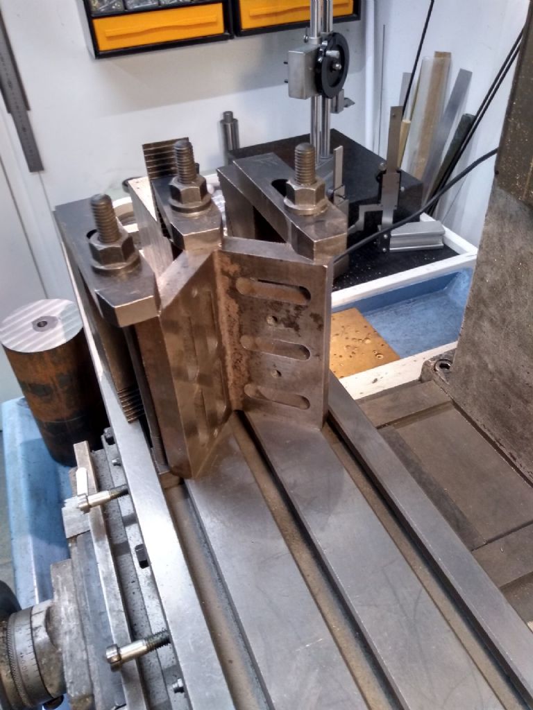

                                Having lugged 7 bags of sugar (or its equivalent in cast iron bar) home from Ally Pally for my Synchronome bob I needed to at least square off the ends and drill for the rod. I did't fancy trying to mount it in the lathe – 7 inches long and over 3 diameter and weighing that much, and not able to use a fixed steady on the as-cast circumference. Only option was the mill, I decided what I really needed was a very large Keats angle plate but no idea where to get such a thing. So dtarted to look at my collection of angle plates and found this one:
                                Bought for a pittance from a market stall years ago, it's ground square on the inside edges as well as the outside and ends. Work of a few moments to clamp to the mill table.
                                That's the bob sitting on the swarf tray btw.
                                Couple of G clamps to pull the cylindrical surface against the faces of the angle plate and "Bob's your uncle" you might say.

                                          Posted by John Haine on 20/01/2019 10:11:37:
                                          I thought you were supposed to use a WW1 surplus 16 pounder artillery shell!

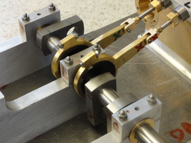

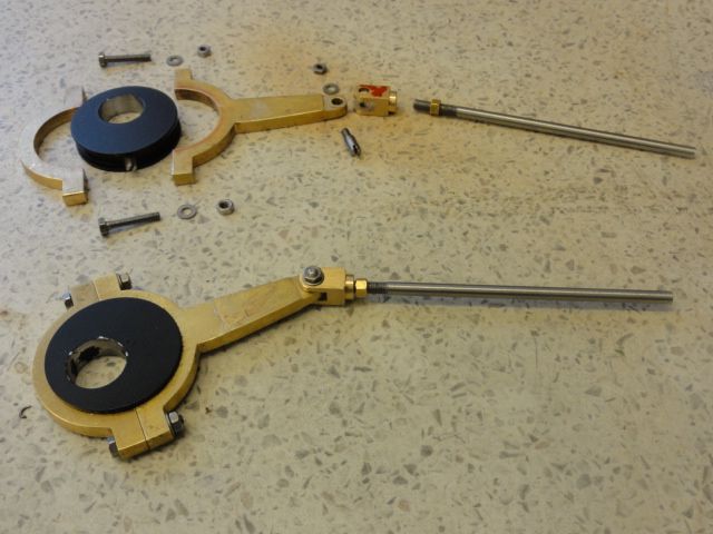

                                                      I’ve not been well for a couple of months so there has been less progress on the Overcrank engine than normal.
                                                      This is the first engine I have built without the benefit of a build log or construction notes for guidance. My plan was to make the crankshaft next but luckily I had a close look at the drawings before I did and found that the valve eccentrics and crank centre bearing were on the shaft between the 2 throws.
                                                      The bearing could have been made as a split shell but I couldn’t see how to make the eccentric sheaves work with a join in them. So the only way seemed to me to make them as normal
                                                      and assemble them on the crankshaft before assembling and pinning the journals.
                                                      Happy days, the valves seem to move as they should so now it's back to the plan and build the crankshaft.
                                                      Jim
