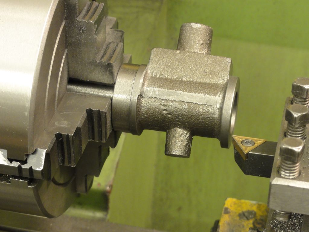

      Hi Jim,
      Just browsing through some old posts and spotted this one.
      Looking good Jim, nice machining job on the casting.
      Main bearings are a big improvement. I see you have made them like the ones on Jason's entablature engine, much better especially with the studs in the main frames. Will make assembly much easier.
      I know you had the frames laser cut. Could I ask are they cut to the exact same sizes as on the drawings I sent you.
      I have had another person interested in the engine and he may wish to have the frames laser cut. I assume the company who did them will have the drawings on file
      Look forward to seeing the engine complete
      Geoff

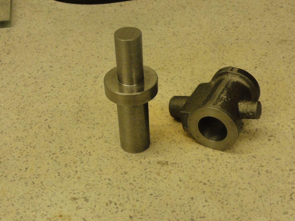

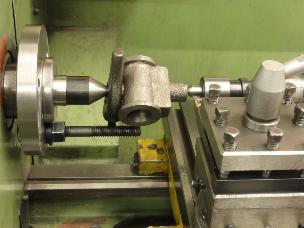

        Hi Geoff
        You may recall you posted a method for machining the casting for me but when I came to follow it I found my lathe face plate wasn't flexible enough (too few slots) to use and also my angle plate was too big and inflexible. So I had to adapt your method a bit and ended up doing one end and the bore in the 4 jaw chuck first and then superglueing the casting on a mandrel to do some of the rest.
        It was a lovely casting, no hard spots at all and plenty of material to play with when setting up so thanks for that.
        For the main bearings I used a method familiar to me that I've used a few times before with little reference to Muncaster's design.
        The frames were cut by Model Engineers Laser exactly to your drawing. I don't do CAD myself so I sent him a copy of your paper drawing which he then drew in a programme his cutter could use. Hopefully he still has the file. His service was excellent and his price for the frames in steel was very reasonable, highly recommended.

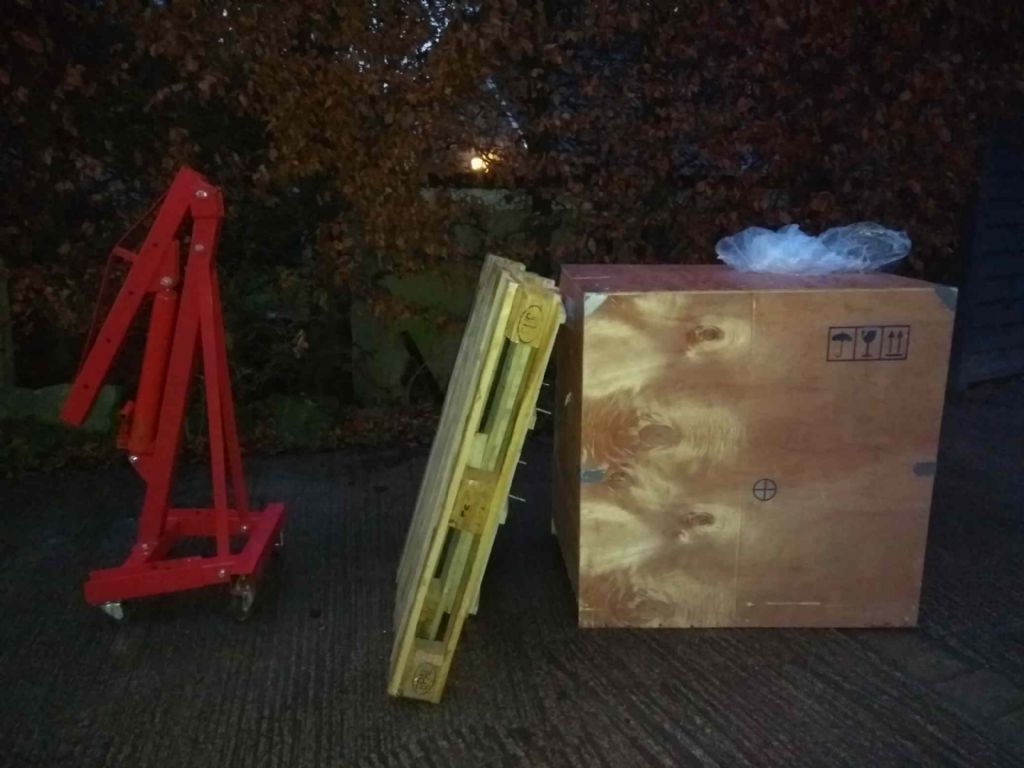

                    It's here!
                    At last the new Mill has arrived. I'd planned to have a little travelogue of pictures, but the idea got lost in the excitement.
                    The most peculiar thing is that the arrival and installation went remarkably to plan. I don't expect that to happen to me!
                    It started a bit off key – on the way out to the Post Office, I saw a van at the end of the road and thought. 'hmmm'. And waited to see. It was my van – the chap had forgotten to call!
                    The fears I had of getting the crate down the slope to the back of the house were unfounded. Mr Van Man had a powered pallet truck with brakes and it went smooth as silk. I did, however have to wait for my husky young assistant to arrive to help (1/3rd my age and probably 3 times my strength! – also doing Aeronautical Engineering at Manchester, so skills as well as muscles!).
                    The first photo I took was this – the box and partly assembled hoist.
                    It was, of course dark by the time the delivery arrived.

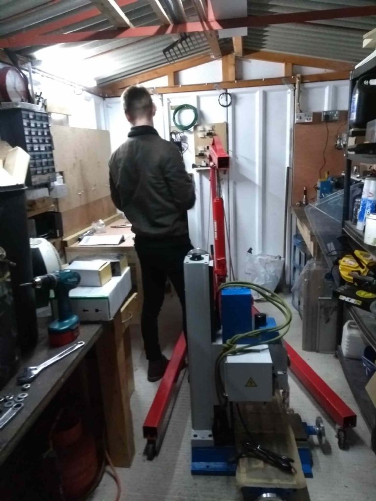

                    The first step was to hoist it out of the pallet and put it on my custom built slideway into the shed.
                    Then what I knew would be the nasty part. Getting the engine hoist over the mill and into the shed. A bit of grunting and it was there (in 4 pieces, mind you – let's not get too ambitious).
                    The hoist it to bring it further into the shed (with my beautiful assistant in rear view)
                    As you can probably see, non of these canvas slings for me – instead 3 turns of some climbing rope. If it can handle a 100 kilo block dropping 30 metres I reckon three turns would do! And it did, though the stretchiness was not ideal.

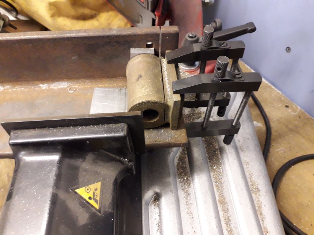

                      The RMC Type-B is starting to get closer to where I want it to be, a few E-mails from Nick Rowland the designer gave me some pointers of what to look for and it is getting there. First part of the video shows it running with the governor free to move so it runs in hit & miss mode, second video has the governor locked so throttle controlled by a mix of advance/retard and carb setting. I also got the spark plugs I made working for the second video which have improved the speed as the spark is now within the cylinder rather than down the plug hole as I had been using a standard length Rimfire plug previously which was a bit on the short side.
                      Also decided that the best thing to do with loco cylinder castings is to chop them up and make something useful from the metal.

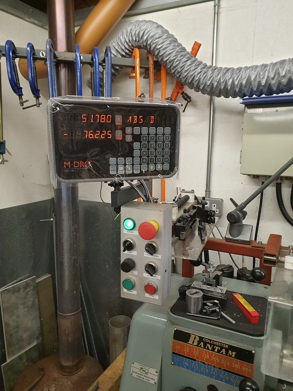

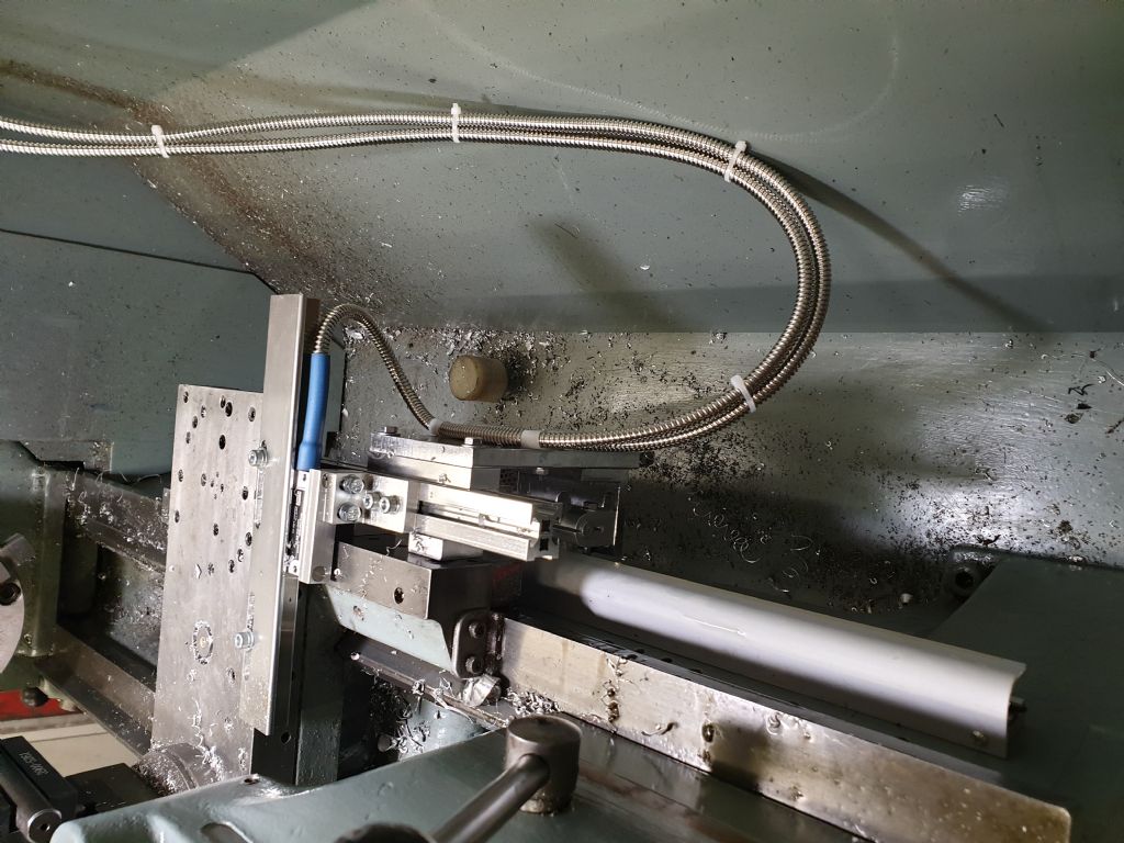

                          Last job for me this year was to fit the dro to my lathe. Bought the M-DRO kit for the Bantam. This should have been done earlier but I`ve had the flu since just before xmas so it got put back a bit but its all fitted now.
                          DRO slides

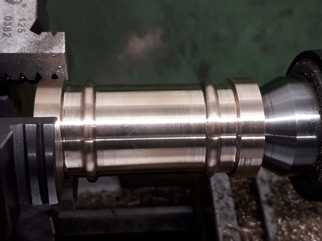

                          Decided to get the first one of the wheels for my belt linisher build done before calling it a night.
