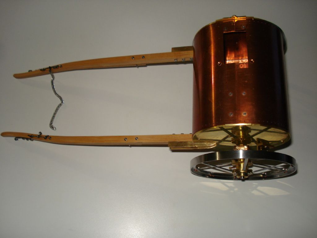

                                      Although I'm making a steel framed drawbar for the 1" scale Water Cart, I deviated to make wooden shafts as well.
                                      Happy with the first attempt at steam bending hardwood, so have been producing the ironwork for them. Even managed to obtain scale double link curb chain.-
                                      #441650
                                      martin perman 1
                                        @martinperman1
                                        Posted by JasonB on 14/12/2019 17:06:27:
                                        Jim, you engine is coming along nicely. Good things come to those who wait take their time
                                        between making swarf I have had a bit more of a play with the RMC and it is starting to run for longer and stop when I want it too. Sorry for holding the camera in portrait mode though it does suit the upright shape of the engine.
                                        Also did some of the column for the vertical oscillator.
                                        Jason,
                                        A lovely looking and running engine, it has the sound of an engine that could improve with a light load, I hear them often on the rally field, particularly Petter two strokes.
                                        Martin P
                                        #441654
                                          Posted by Richard S2 on 14/12/2019 18:59:46:
                                          That's nice!
