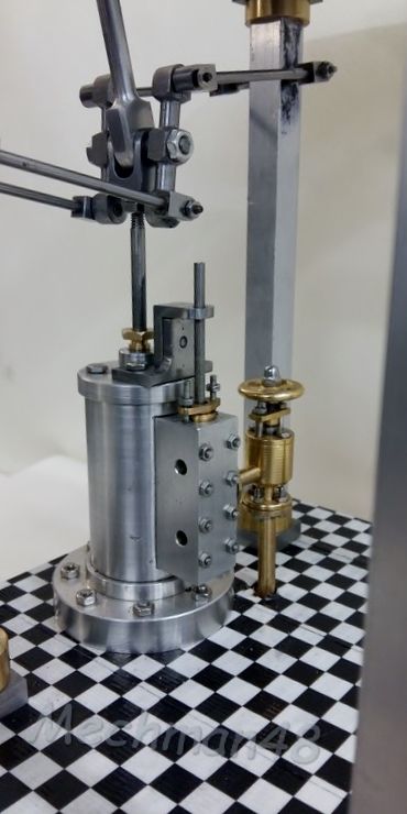

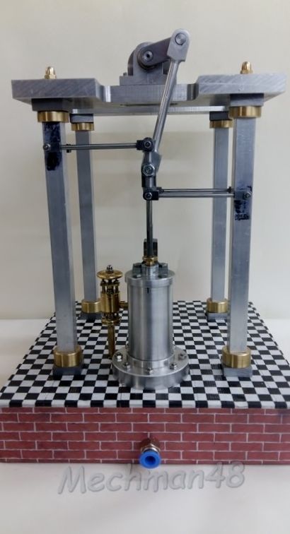

                      Did a bit more on my vertical cross engine today, fitted the spool valve rod guide, refitted the swing arms & parallel arms, checked for 'tight spots' all looks good…
                      ​Next step is to machine up fly wheel… CI is shitty stuff to machine & the casting doesn't look to brilliant either… having another look at the guide set up I think I'll take the corners off & blend it to match the curve of the cylinder, more aesthetically pleasing methinks…?
                      ​George.

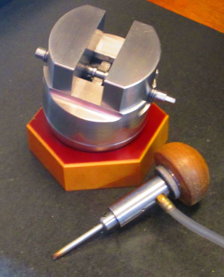

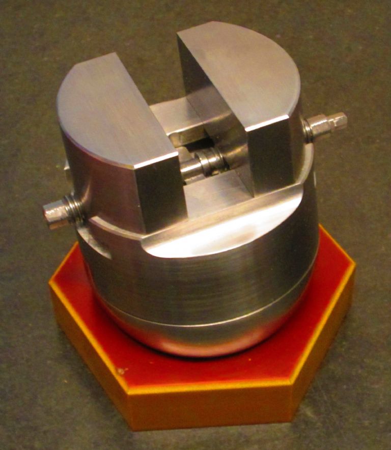

                        Thought I would put a piece of tooling up I have almost finished. Just have to decide how to finish the jaws. There is more pictures in my album.
                        Tom

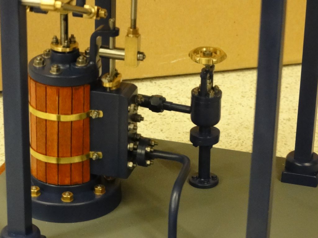

                            Like this George?
                            Vertical cross valve guide 2
                            I thought it looked better matched to the cylinder
                            Jim

                              Posted by Jim Nic on 08/04/2018 19:38:46:
                              Like this George?
                              Jim
                              Precisely Jim.
                              Geo.

                                  Posted by TomK on 08/04/2018 16:21:20:
                                  Tom
                                  That looks very classy, Tom
                                  … is the hemisphere weighted, or is there plenty of friction with the cup ?

                                  Tomk
                                    @tomk39956
                                    Posted by Michael Gilligan on 10/04/2018 07:41:08:
                                    Tom
                                    Michael
                                    The hemisphere contains 2 ball races and has no weights added the friction on the tufnel base has enough friction to grip the hemisphere.
                                    tom

                                    Ian P
                                      @ianp
                                      Tom
                                      I'm curious what the tool is for?
                                      It looks like a self centering two jaw chuck which can be manually rotated (on two ballraces) and its sits in a hemispherical recess at whatever angle suite the purpose. Its just the purpose I cannot work out.

                                      Jeff Dayman
                                        @jeffdayman43397
                                        For old fashioned die sinking, or engraving maybe. A handy thing for hand work. Beautifully made too.

                                          Follow Tom's link to his album and the title will tell all.

                                            Tomk
                                              @tomk39956
                                              Posted by Ian P on 10/04/2018 23:44:08:
                                              Tom
                                              Ian P
                                              Ian
                                              This picture shows another tool that can be used with the vice. Also this link to an engraving web page may help you understand more about this type of vice. Link to web page

                                              Ian P
                                                @ianp
                                                I followed Jason's advice and looked at your album, then Googled 'jewellers vice' and looked at images. Only a couple out of hundreds shown looked anything like yours so I added 'ball' to the search and found scores of them.
                                                Yours looks beautifully made, presumably mostly aluminium and I can see its not easy to decide what features to add to the jaws if your work needs any.
                                                I found an online video of a vice and engraver in use. Previously I knew nothing of the art of engraving but I'm impressed and tempted to have a go.
                                                Ian P

                                                Tomk
                                                  @tomk39956
                                                  Posted by Ian P on 11/04/2018 11:20:27:
                                                  Ian P
                                                  Ian
                                                  The material for the vice is
                                                  Ball and body is stainless steel
                                                  jaws are mild steel
                                                  Tom

                                                  Bill Phinn
                                                    @billphinn90025
                                                    TomK, as a jewellery maker used to using GRS workholding equipment, I've nothing but admiration for your work. Perhaps you've thought of this already, but some leather-faced jaw inserts would make the steel jaws kinder on precious metals and provide good grip.

                                                      @tomk39956
                                                      Posted by Bill Phinn on 11/04/2018 12:33:01:
                                                      Bill
                                                      I have not decided what to do with jaws but leather faced insert had not occurred to me thanks for the suggestion.
                                                      Tom
