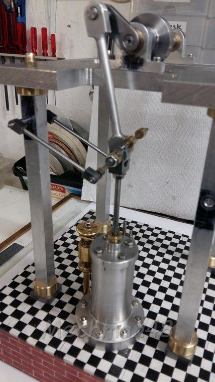

                  Did a bit more on the Vertical Cross engine, assembled the swing arm assemblies. got a tight spot somewhere as when the crank is at BDC there is a definite binding, suspect some other measurements are out, possibly the swing arm assemblies…
                  George.

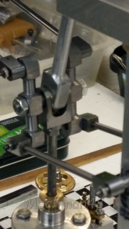

                      ​Yup the tight spot is on the swing arm assembly! … looks like pin misalignment & difference in length face 19​ … when added rotational pressure is applied ( finger pressure on the shaft, the soft soldered joints break ) … so much for 5 piece soldered swing arms… so it's a rehash with a new pair of swing arms… face 14​ this time I'll utilise Jim Nic's method, or similar, ah well! you get a run of those days every so often…
                      George.

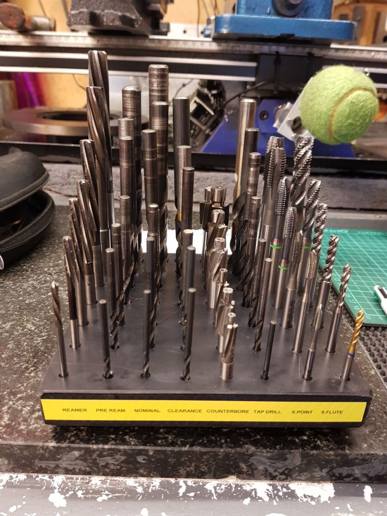

                        Made a new "drill stand" today.
                        It has spiral flute tap, spiral point tap, tapping drill, counter bore, clearance drill, sized drill, pre-ream and reamer.
                        Covers M3 to M12. Saves wasting time hunting through tins and makes it more likely that I will actually use the right tool!
                        Once again, I take a picture "portrait" on my phone and it ends up on its side. I don't know……..
                        Jim

                          Nice one Jim, just don't knock it off the bench smile o
                          George.
                          #347419
                          mechman48
                            @mechman48
                            … Once again, I take a picture "portrait" on my phone and it ends up on its side. I don't know……..
                            ​Use your pc's / laptop photo editing app W10 has free one built in, or use paint… copy image, load into Paint, rotate, 'save as' in preferred folder…

                                mechman48
                                  @mechman48
                                  Where did that UFO come from… Have you informed SETI ? … oh drat, I guess it's a tennis ball on the cross feed handle of your mill… devil
                                  George.
                                  #347532
                                  jimmy b
                                    @jimmyb
                                    Posted by mechman48 on 25/03/2018 10:39:29:
                                    George.
                                    Its something I do on my machines that are not being used. I've only got a small shed and two lathes, a mill, bench top drill, bandsaw, bench, grinders etc so space is tight. I split my head open on a machine handle, bending over and standing up a bit quick!!
                                    The difference between banging a tennis ball and a machine handle, is quite something!!

                                        Made a start on rehashing the swing arms for my vertical cross … face 18
                                        George.

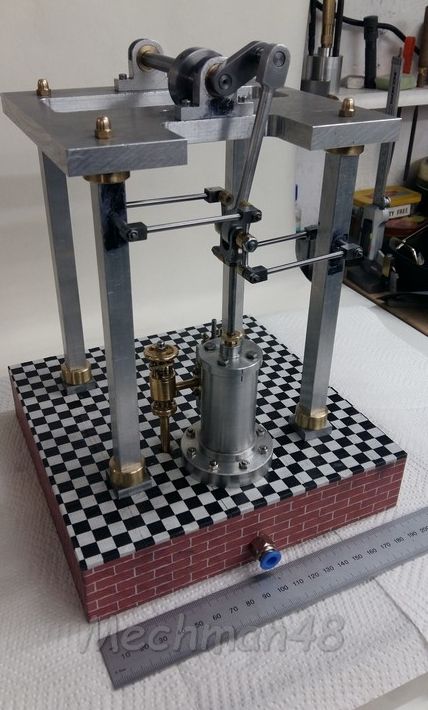

                                          Finished up the 'new' swing arms today, made from one piece MS, still have to finalise bits on it & polish up but it's getting there…
                                          ​George.

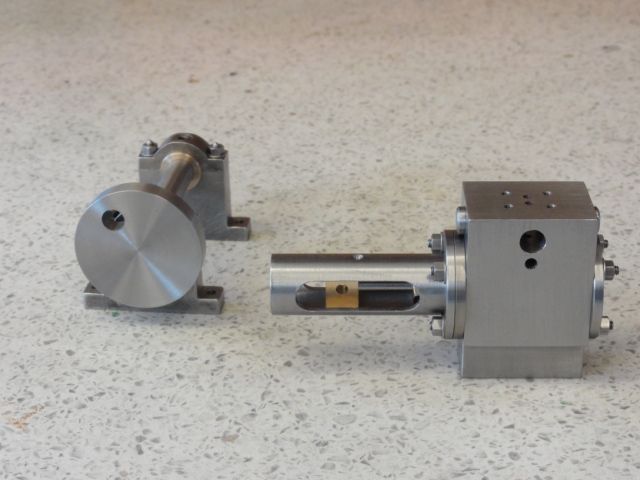

                                            I haven't made a lot of progress on the Hasbrouk Rocking Valve Engine of late. For one thing other priorities have got in the way and for another I haven't really taken to this project like I have with all my previous engines. However I like to finish what I've started so on we go. Here are a couple of "family shots" of the cylinder and crosshead and the crankshaft in its bearing pedestals.
                                            I am making the engine smaller than the original drawing so the next step is the connecting rod and then I can confirm my dimensions and get the cylinder and crankshaft mounted on the baseplate.
                                            Jim

                                                Looks like you are making good progress to me. I have not done a rocking valve engine but do have one 85% drawn up to make at some time.

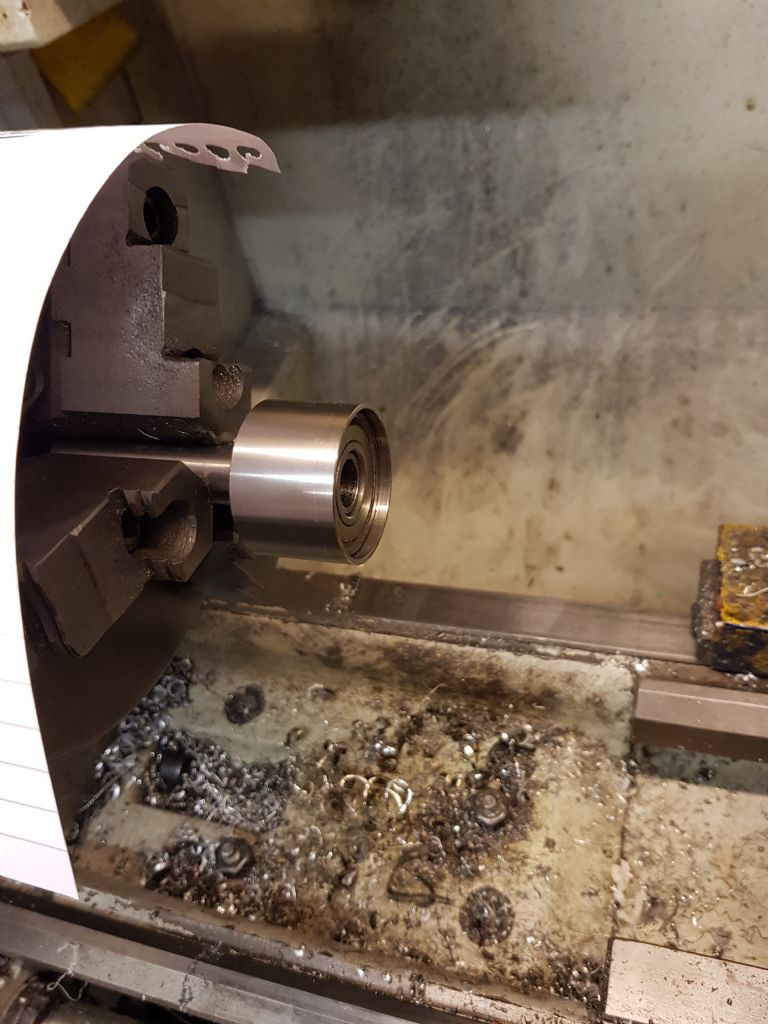

                                                  Made up the Eccentric and valve parts for the Vertical engine I'm working on as and when the fancy takes me.
