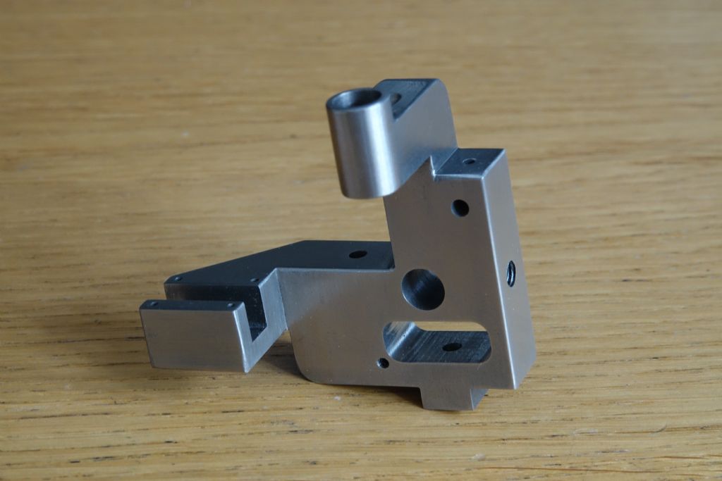

        Just finished the Cam Gear Bracket for my Star hit&miss engine. It started out as a 3in x 3in x 1.5in block of cast iron. It now weighs less than 10% of its original weight. Bucket of swarf, anyone?
        I've only just seen this, Brian
        You have my great admiration.
          B
          Superb Brian, I can imagine how nerve racking that must have been, completing a number of stages and realising that the slightest mistake on the next stage would undo all that went before.
          Excellent.

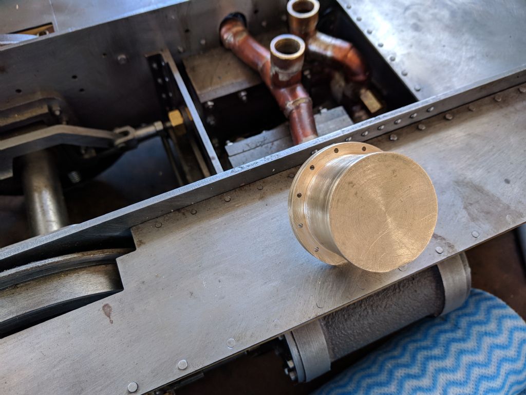

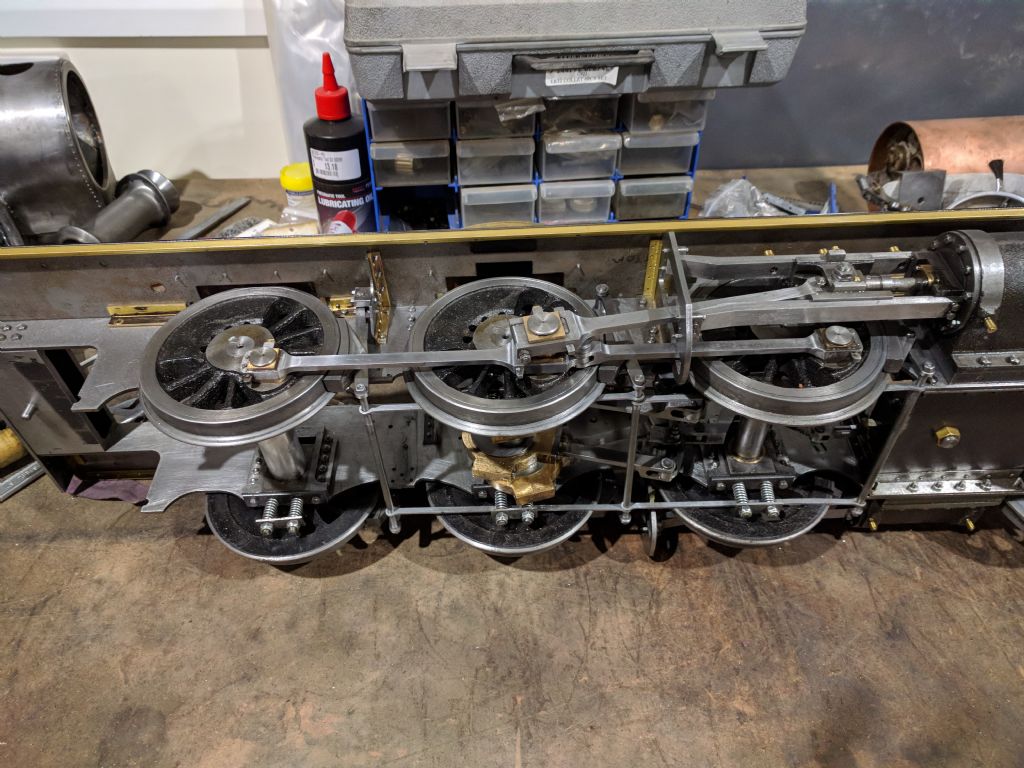

                                  Got the rear brakes on. The pullrods were done on the CNC mill and I also used it to do one particular cut on the brakeshoes.
                                  Now onto make the handbrake parts and dummy airbrake components.
                                  Regards, David.

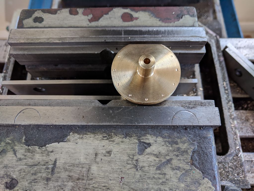

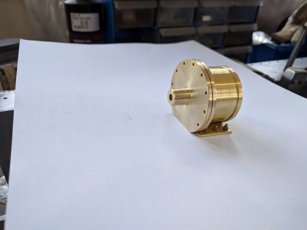

                                    Made a dummy brake cylinder. Nothing here you all haven't done a 1000 times before but an enjoyable, non-precise, non-working, decorative shiny thing.
                                    David.

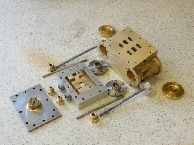

                                      Not a lot to show on the Overcrank since my last post on 12 Sep but here is a "family shot" of the components of the largely completed cylinder block.
                                      And the assembled bits.
                                      I'm not quite sure how best to proceed so to give me some thinking time I will make the aluminium sheet base and then probably the 3 main bearing supports.
