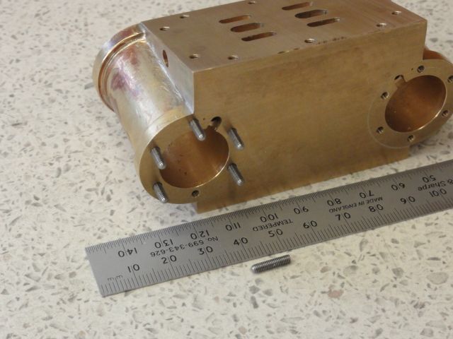

      Nice work Jim, looking good.
      Are those just very short studs in the cylinder end or are they extended into the cylinder wall thickness?
      Keep the pics coming and can you put 6" rule in the pics so I get an idea of the scale.
      ATB Geoff

        Jim Nic
          @jimnic
          Thanks Geoff
          The 7BA studs are 10.5mm long and the holes, which are 5mm deep, would probably just break through the outside cylinder wall if they went much deeper.
          Jim

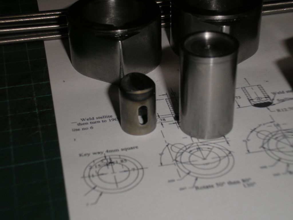

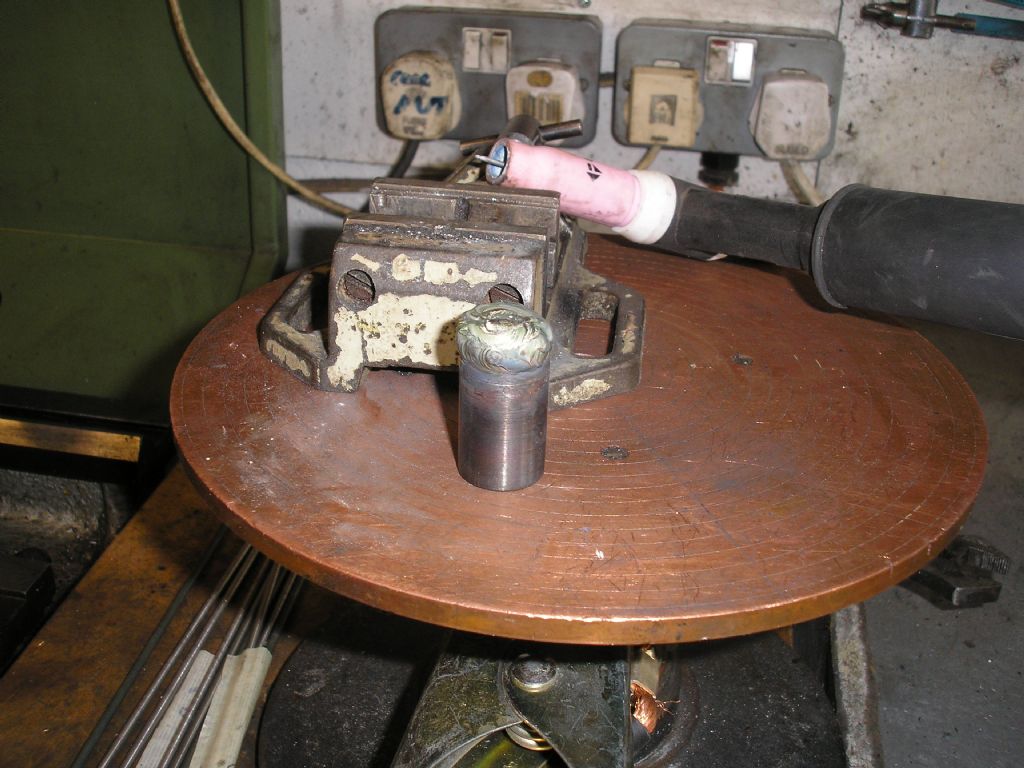

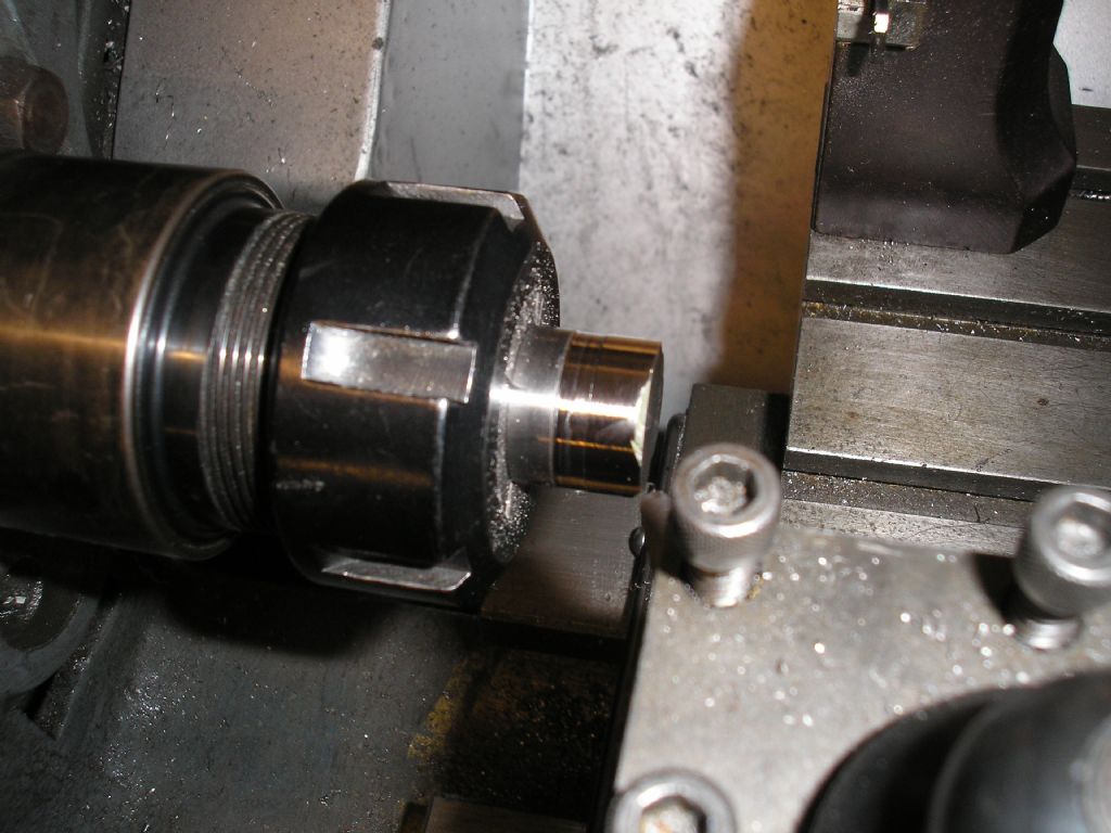

              Filled the garden refuse bin to the top thought better clean up the garden.
              I did dig up some spuds that's grown from the odd ones left in the ground from last year.
              Managed to get into workshop this morning and did my first attempt at Tig coating stellite on a full size test piece cam follower.
              Seems a lot easier than using oxy- acet have rough machined the test follower then a jig to make so can radius the foot.
              Will play with the Alexander grinder and hope to do the follower foot radius with it otherwise could do it on the lathe or mill but don’t like grinding on them
              The problem I have Tig welding have to do it without my specs even magnifier helmet lenses are not any good.
              Very close up without specs things look large with no distortion bloody age related eye problem.
              For speed nuts it's Elvington FIM and ACU record attempts this weekend.
              _spuds.
              Tigged stellite tip blank follower
              Alexander tool grinderRoughing machining stellite

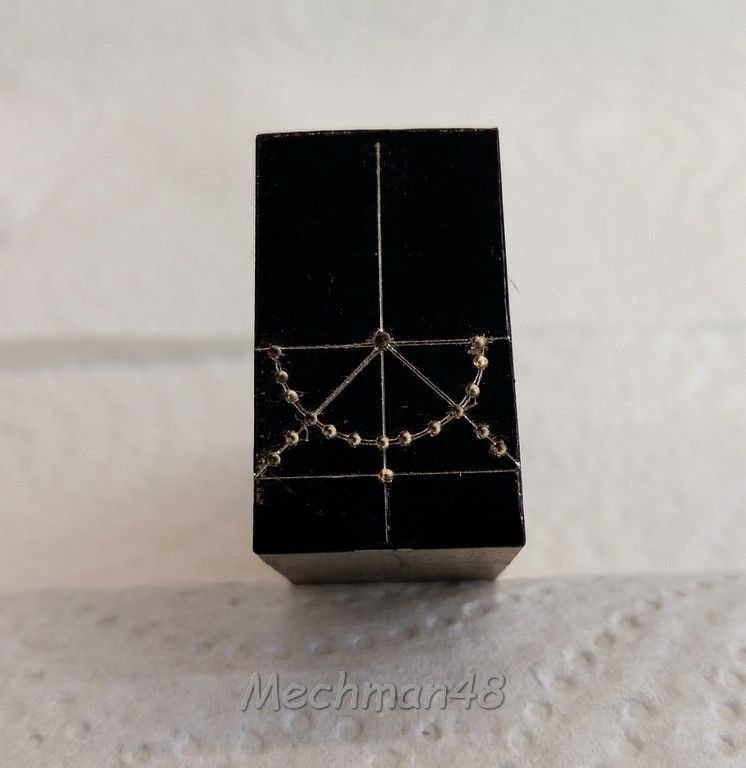

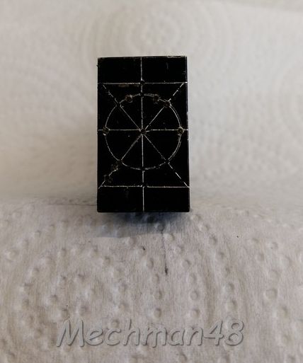

                                Another little contribution of my Boxer twin, marked out for the cylinder blocks. Pic 1 is marked out for one then the light went on, turned it round & marked for both blocks, obviously it will be split down the middle & the dimensions are such that there is enough room for machining. I plan on setting it up in 4 jaw then drill to 9mm then bore out to reaming size for 11mm, split down middle & finish machining to leave 5.5 radius to fit cylinders & solder…
                                A small contribution but mine own… nerd
                                George.

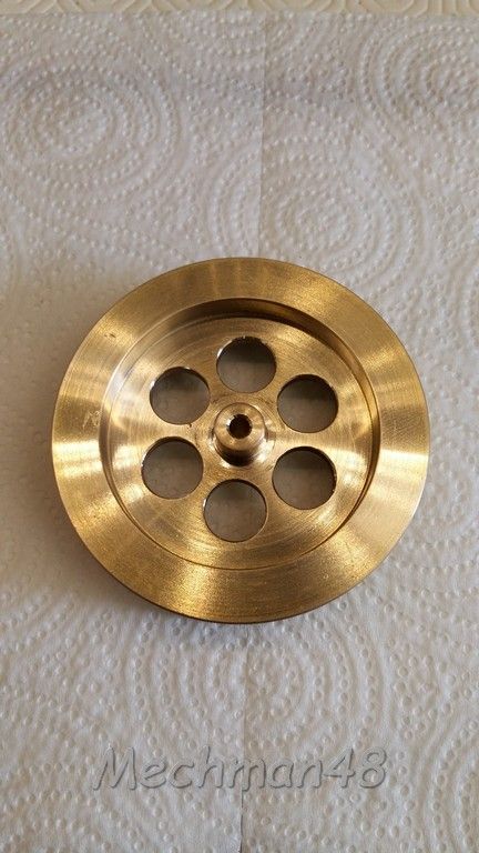

                                              Modified spare fly wheel for my Boxer. It was originally for a gyroscope toy that still is on the back burner for some reason, had to make a new boss & solder it in to allow for drilling & tapping for locking grub screw as the web is too thin to drill through from the rim ( according to drawing dims' )…
                                              George.

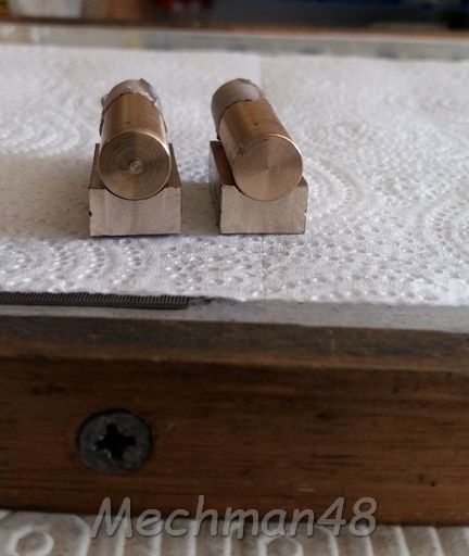

                                                #372610
                                                mechman48
                                                  @mechman48

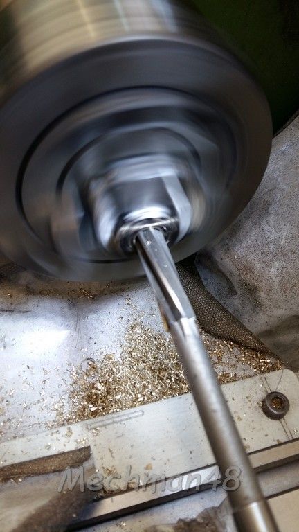

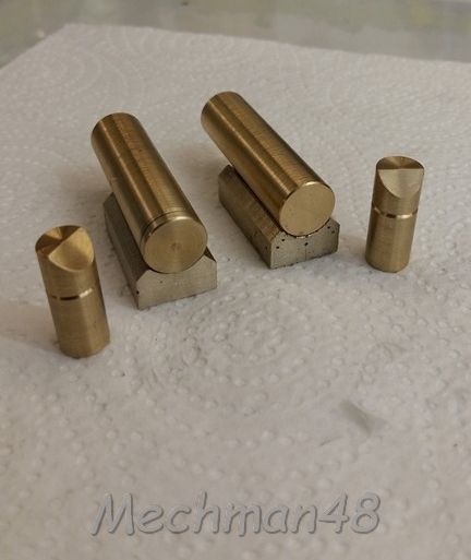

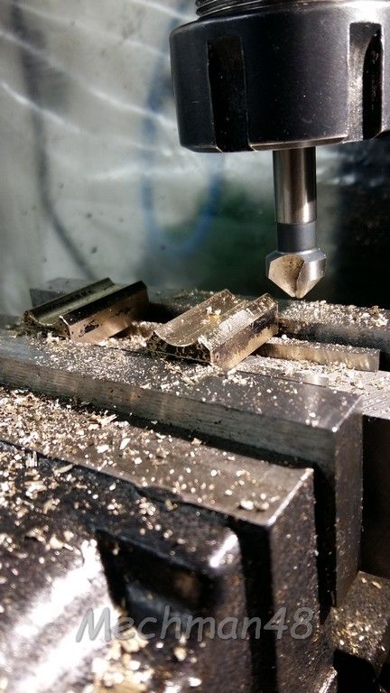

                                                  Machined up & reamed the cylinder blocks before splitting into separate items & machined chamfers in prep for soldering. Inlet ports have been marked off & drilled through blocks so after soldering to cylinders the ports will be drilled through cylinder wall to ensure alignment… methinks… thinking
                                                  Reaming through cyl. block before splitting in two to get correct diameter.
                                                  … cylinders & blocks prior to chamfering, radii fit…
                                                  … machining chamfers…
                                                  … cylinders, blocks & pistons …
                                                  Looks ok so far… nerd .
                                                  George.

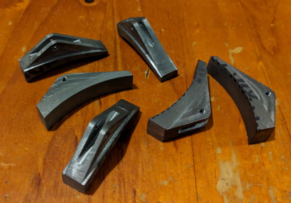

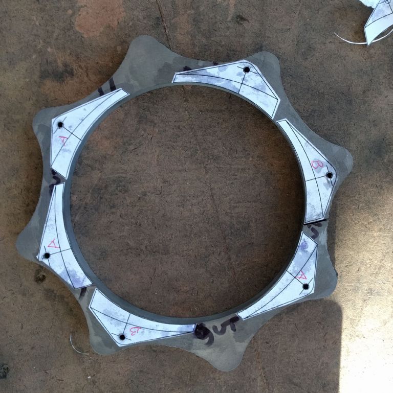

                                                    I spent a lot of the non-work week planning and making these brake shoes. They still need their inside edges rounding off the clear the flange root and the hanger slots probably need to be deeper but I might just do that with a file as I don't have a suitable endmill or slitting saw.
                                                    Regards, David.
