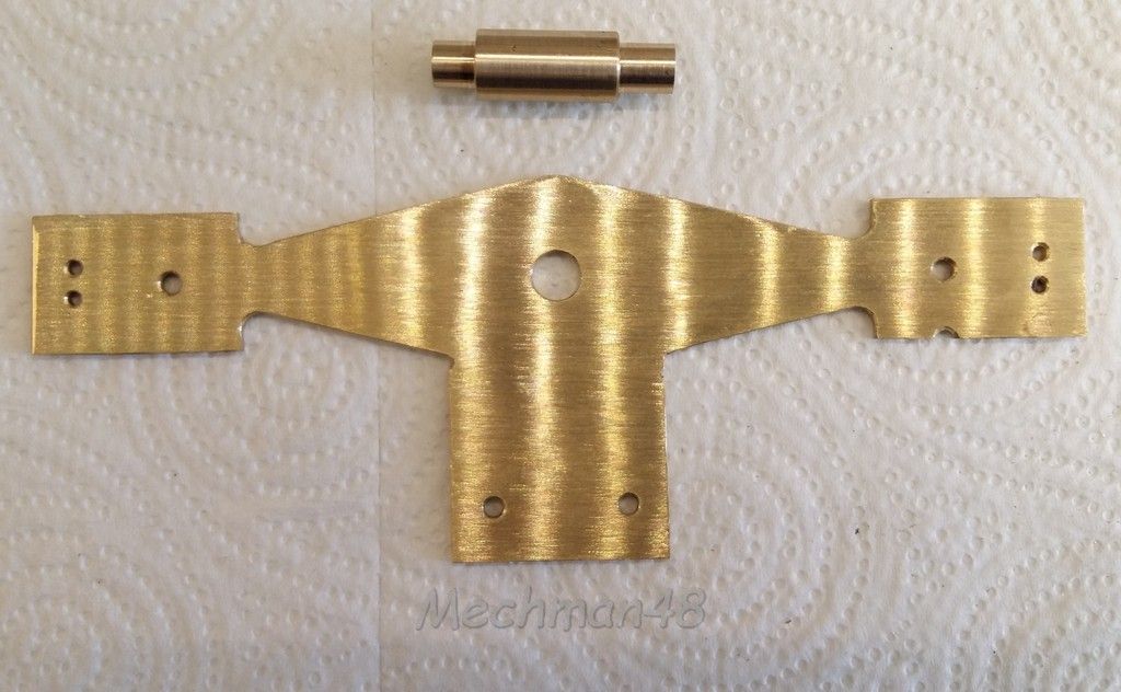

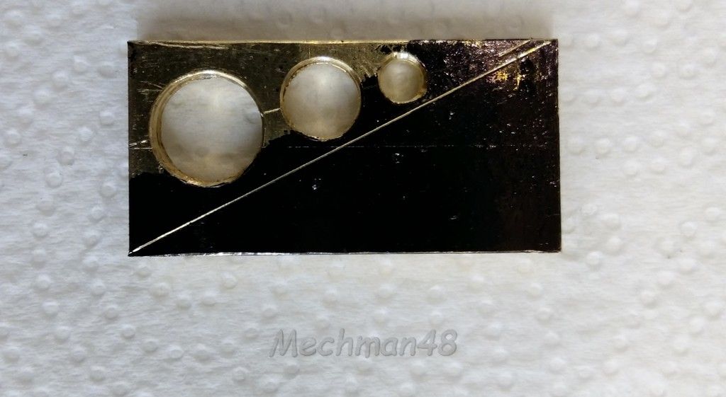

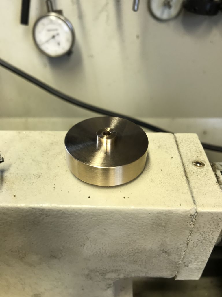

        Continued on with the Boxer oscillator…
        ​The cleaned up finish has been done on my linisher but I don't seem to be able to get finer grade belts so it will have to be flatted out on glass plate & wet & dry emery, elbow grease, with final polishing done with buffing wheels.
        George.
        ​Edited to reduce pic.size.
        Edited By mechman48 on 15/08/2018 09:32:11

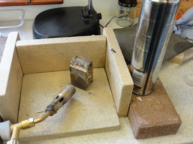

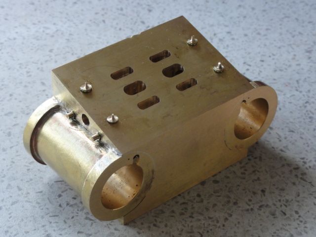

          Some progress on the Overcrank engine.
          The cylinder assembly looked the most challenging so that's where I started.
          The cylinder block centre section:
          The centre section with the cylinders. The bores have been left undersize until after silver soldering:
          Set up for silver soldering. For some reason although I know the theory and have some good gear (a Seivert torch), I do not have the knack of making good quick clean joints.
          And here is the soldered cylinder block after pickling:
          It still needs fettling and cleaning up but I reckon it'll do.
          Next is to finish the bores to correct size and drill the steam passages.
          Jim

            Is it worth looking for some insulating fire bricks instead of the solid ones? They tend to heat up far more rapidly.
            #367480
              Those look like skamolex blocks and sheet to me, very good insulator and tends to throw the heat back at the work.
              #367488
              Jim Nic
                @jimnic
                My little hearth is purpose made and bought from CuP Alloys so I don't think that is the problem. Although for the large chunks of brass shown here something a bit bigger to hold more heat in the job may have helped. The bricks are just used to hold the insulators in place.
                Jim
                #367528
                Mark Rand
                  @markrand96270
                  Sorry, I had thought they were the high density fire bricks used in the back of fireplaces. Didn't notice the shiny spots on the surface until I expanded the picture.blush
                  Edited By Mark Rand on 15/08/2018 18:38:56
                  #367538
                  Brian H
                    @brianh50089
                    Silver soldering looks good to me.
                    Brian

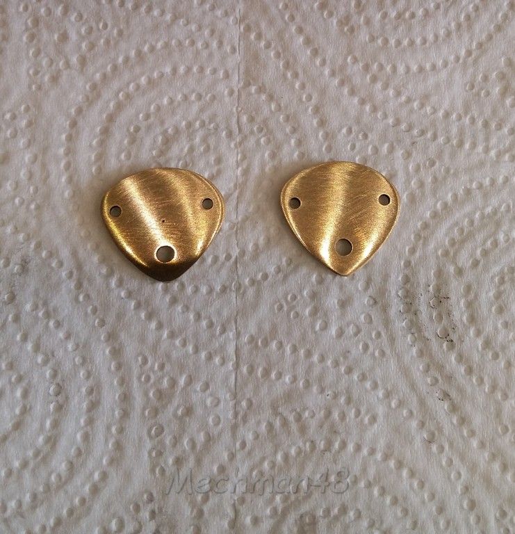

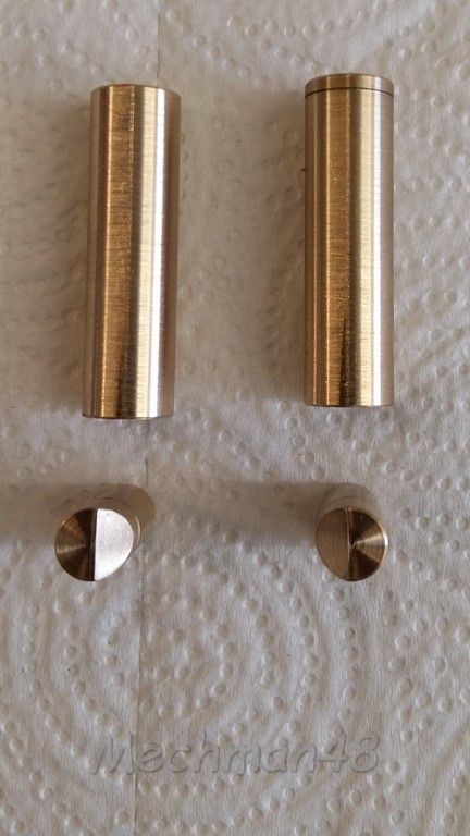

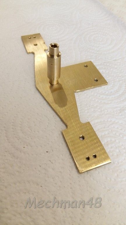

                                    Did a little bit more work on my boxer twin oscillator, cylinders & pistons, support brackets, the right hand cylinder proves the cliché… measure twice, cut once, had to make a top hat to bring it to length & Loctited in, probably make another one when I've made all the other pieces…
                                    Support brackets…
                                    The drawing shows the bottom hole as 12mm dia, I've made it 10mm as it looks more in proportion. I've actually Loctited two pieces together to make sure all sides & holes are symmetrical, it just needs the hypotenuse cutting & milling to size.
                                    George.

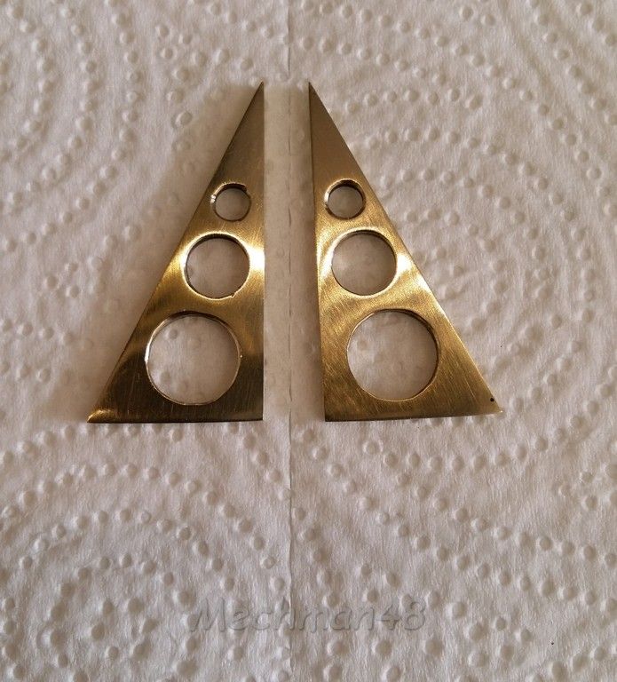

                                              Did a bit of clean up prior to final polish on support brackets & crank eccentrics…
                                              Eccentrics, according to dwg… hmmm… thinking

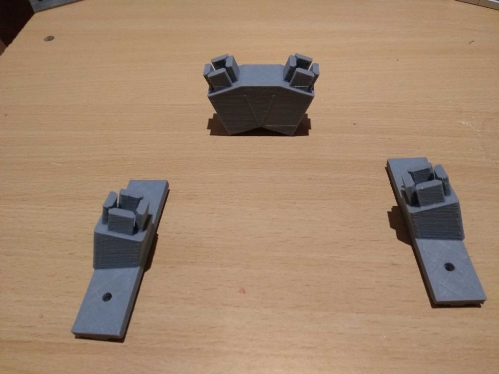

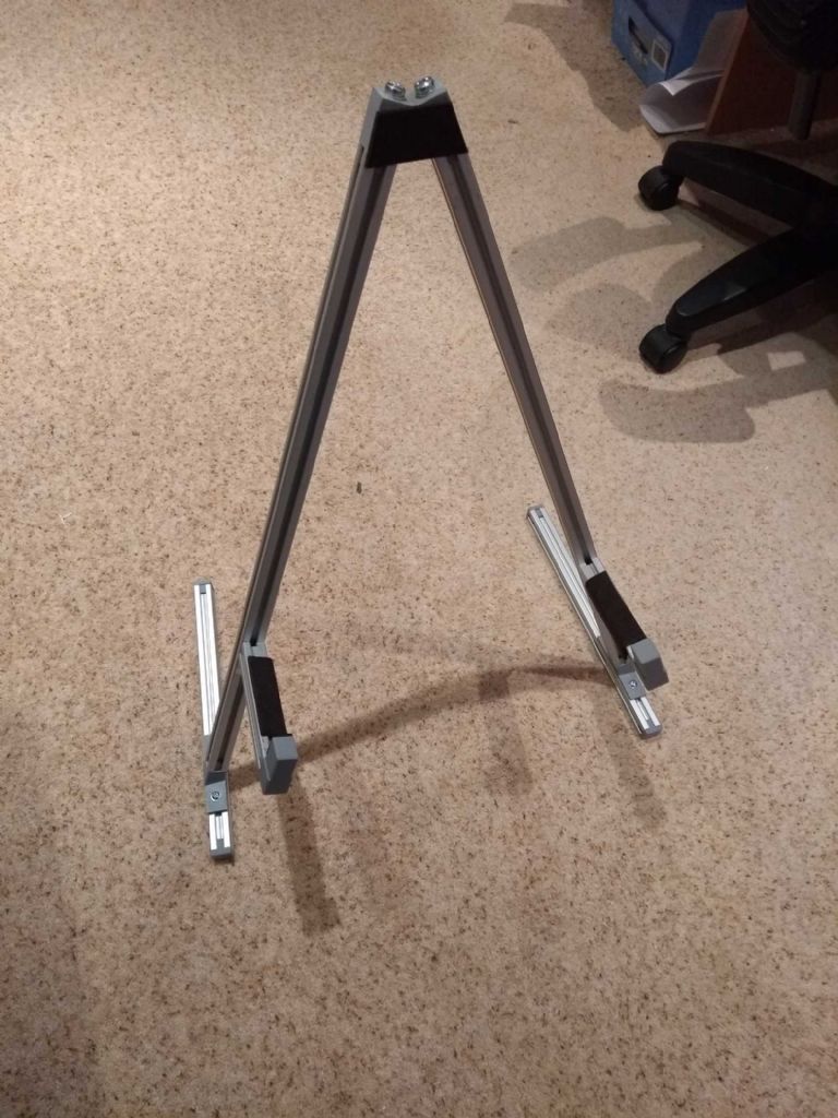

                                                I'm pleased to post in Workshop progress today because, after 9 months of no progress, I've had a bit.
                                                It's been a work year so far with far too much time away from the shed (oh, and the family). But at last I've done something! Not much, but something.
                                                We've been 'de-cluttering' and I decided to make a stand for one of my guitars.
                                                here it is
                                                And more attractively with guitar
                                                What is (slightly) clever is the use of my 3D printer to make the connectors.
                                                What's not terribly clear from the photo is that the the connectors for the A-Frame are angled in at 20 degrees each and back at 15. For those who poo-poo 3d Printers, I challenge you to make these brackets out of metal!
                                                Iain

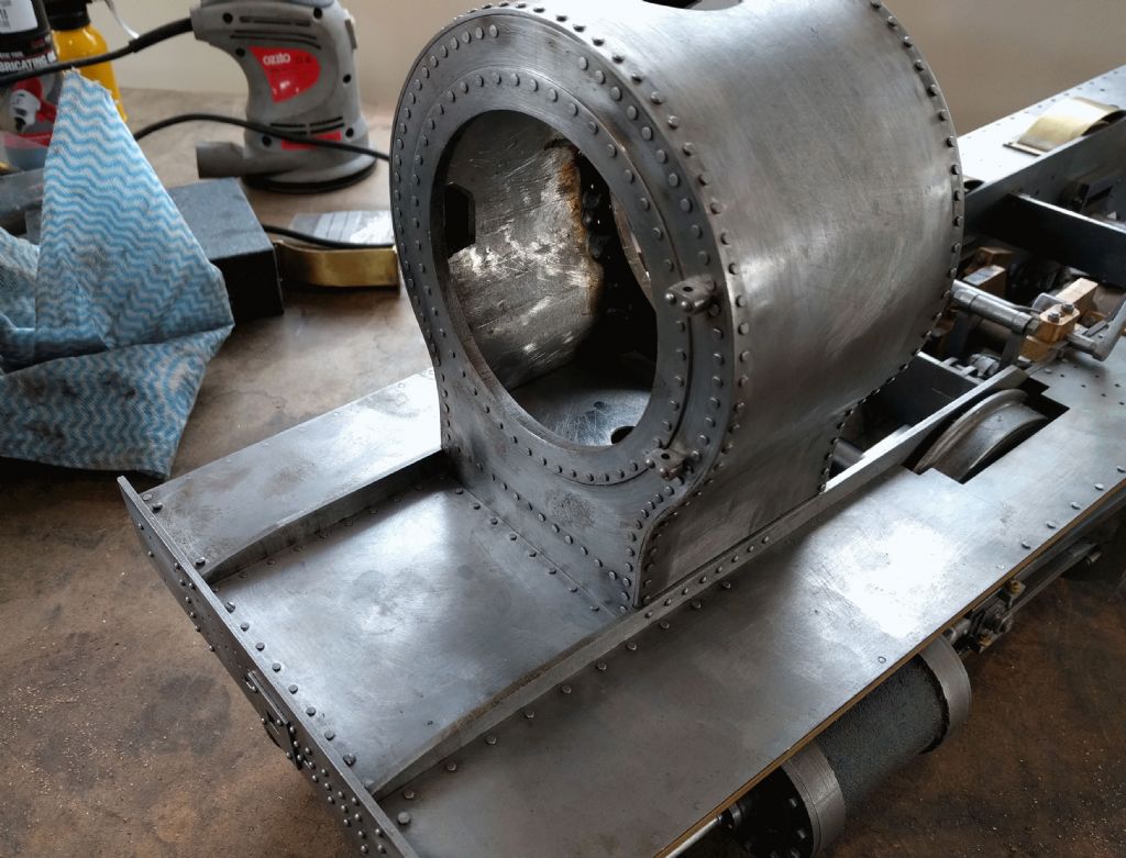

                                                    Put the rivets in the plate in front of the smokebox and spotted, drilled, and tapped holes in the smokebox sides (below the footplates) so the smokebox is now attached properly.
                                                    It's about 2mm too far back because the exhaust manifold turned out that way. I'll live with it!

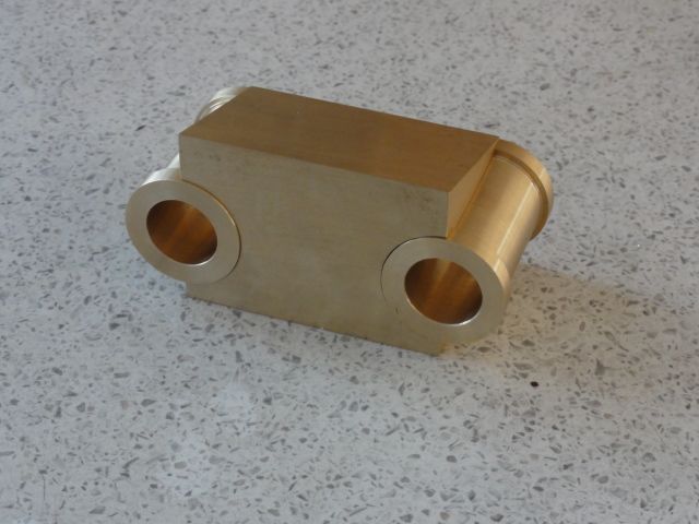

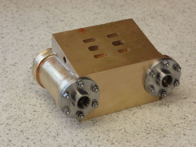

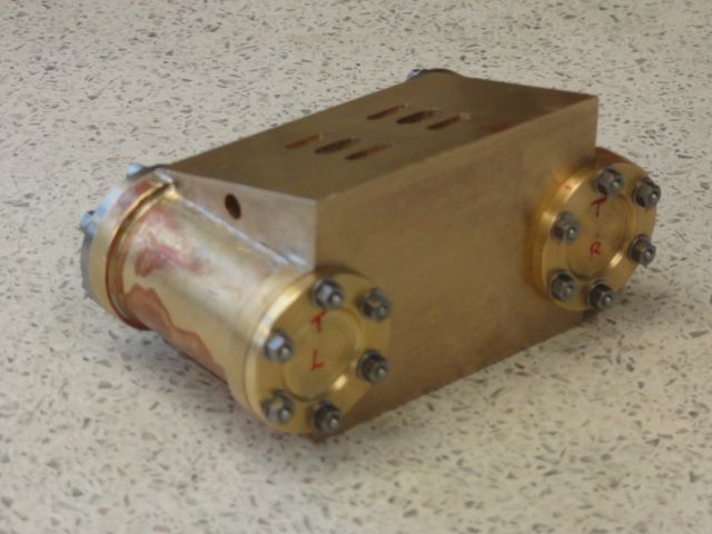

                                                    Jim Nic
                                                      @jimnic

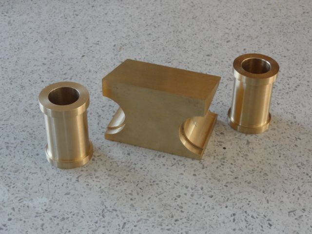

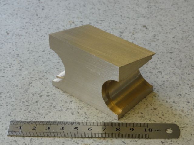

                                                      My current project of Stew Hart’s Overcrank engine is proving to be a little more of a challenge than I thought. However, if everything was easy life would be awfully boring so on we go.
                                                      Having opened out the cylinder bores, I got confused over the steam passages and made a bit of an upcock which required a couple more blanking plugs. I also decided on the spur of the moment to alter the design for the exhaust outlet to allow me to fit a pipe in place of the open port in the block. Here is the block with the blanks Loctited in place ready to be smoothed off.
                                                      The enlarged exhaust port is also clear but what is not apparent is that it lies in the way of one of the valve chest fixing studs so my “improvement” has caused much wailing and gnashing of teeth.
                                                      To give me time to recover and work out a solution I made the cylinder end caps.
                                                      Now for the steam chest and valves.
                                                      Jim
