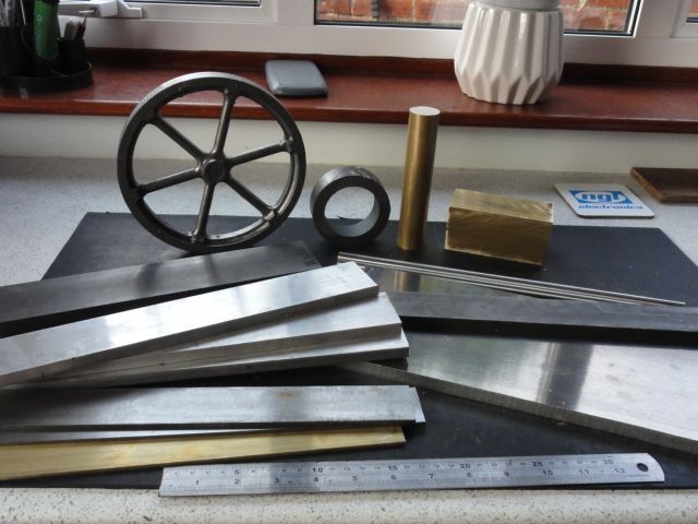

              Jim Nic
                @jimnic
                After completing my version of Ray Hasbrouck’s No 3 Rocking Valve engine I was at a bit of a loose end because that engine seemed to finish all of a sudden and I hadn’t seriously considered “What next.” I gave a lot of thought to Julius de Waal's drawings of the Monitor engine from Model Engine Maker site. I have never been keen on his drawing layouts, I find them difficult to follow (probably due to my advancing years and retreating brain power), but downloaded them and gave them a good looking at while I spent some time cleaning my workshop and attending to machine maimtenance. I had got to the point of deciding to give it a go when I happened upon a ME forum query regarding Stew Hart’s Over Crank engine. I remembered following Stew’s build 7 or so years ago and thinking it was well beyond me, but that was then and this is now so I messaged Stew to ask for a copy of the drawings and he very kindly sent them to me.
                The result:
                Somewhere amongst this pile is an Overcrank Engine (I hope). It’s a fairly complicated twin cylinder beast so should keep me occupied for a while. I’ll do my best to do the design justice and may post random thoughts on my progress when anything significant occurs.
                Jim

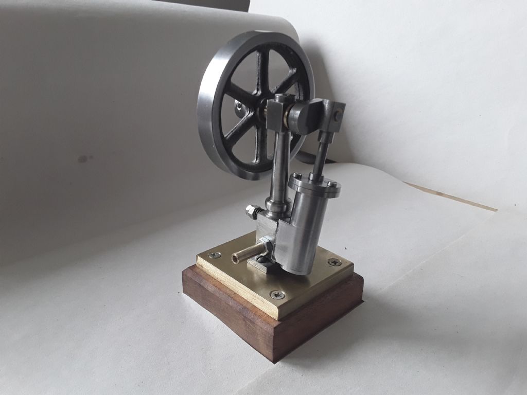

                  Here is my recently completed mini muncaster oscillator. Really enjoyed this build.
                  Here is a picture. The sizes are much the same as the principle Muncaster/ Westbury sizes
                  Video on you tube if you want to see it working. Sorry I'm thick when it comes to loading you tube videos,
                  perhaps Jason will oblige. Geoff

                    Looks good and runs well Geoff.
                    Edited By JasonB on 21/07/2018 19:17:57
                    #363263
                    Jim Nic
                      @jimnic
                      That's a good looking "wobbler" Geoff, good work and a good runner too. I like the upside down look like which is a long way from the run of the mill oscillator design that I did for my first engine. Well done.
                      Jim

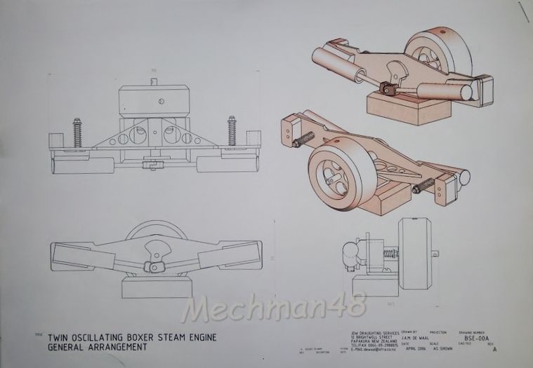

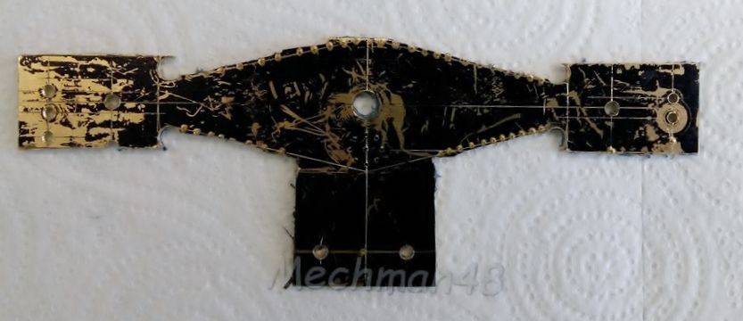

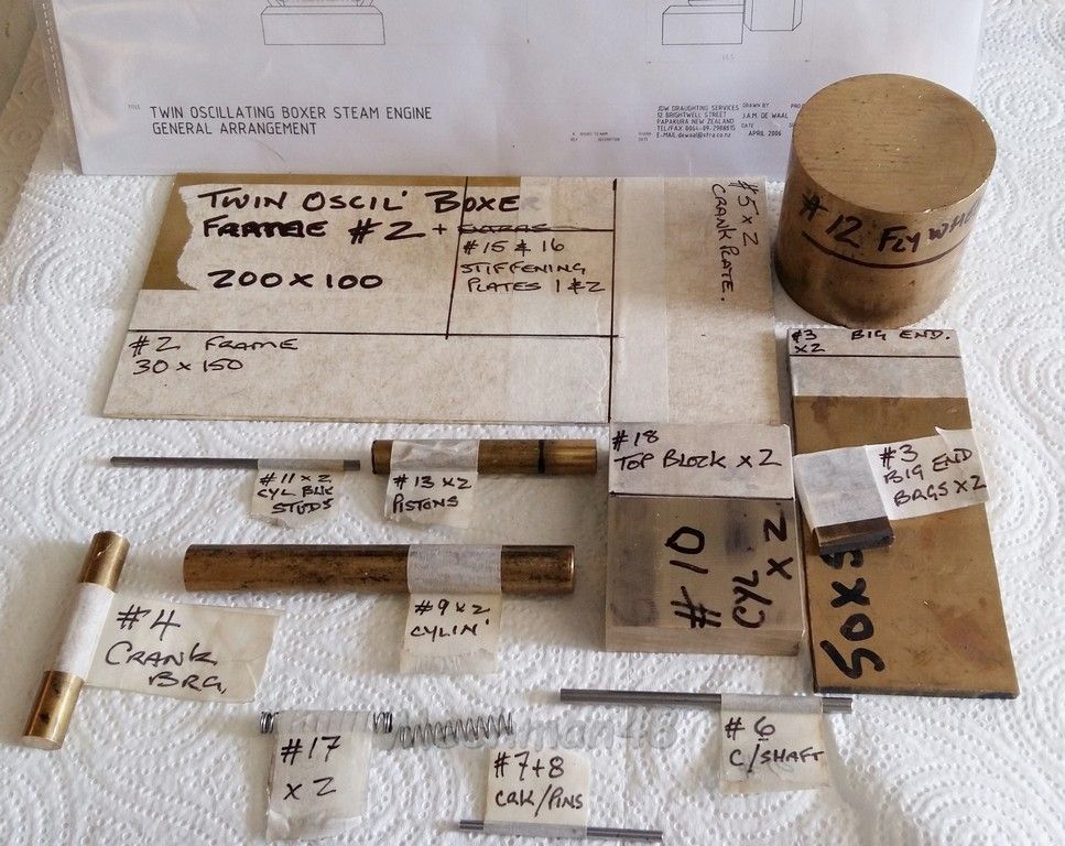

                                                    Have started on my 'Boxer Oscillator, marked off the frame, roughly cut out & drilled for crank & ports…
                                                    ​Looks rough I know but we all start at this point don't we…
                                                    George.
                                                    #367103
                                                    Jim Nic
                                                      @jimnic
                                                      Looks great George, particularly like the paint job. wink (You have at least made a start)
                                                      Jim
