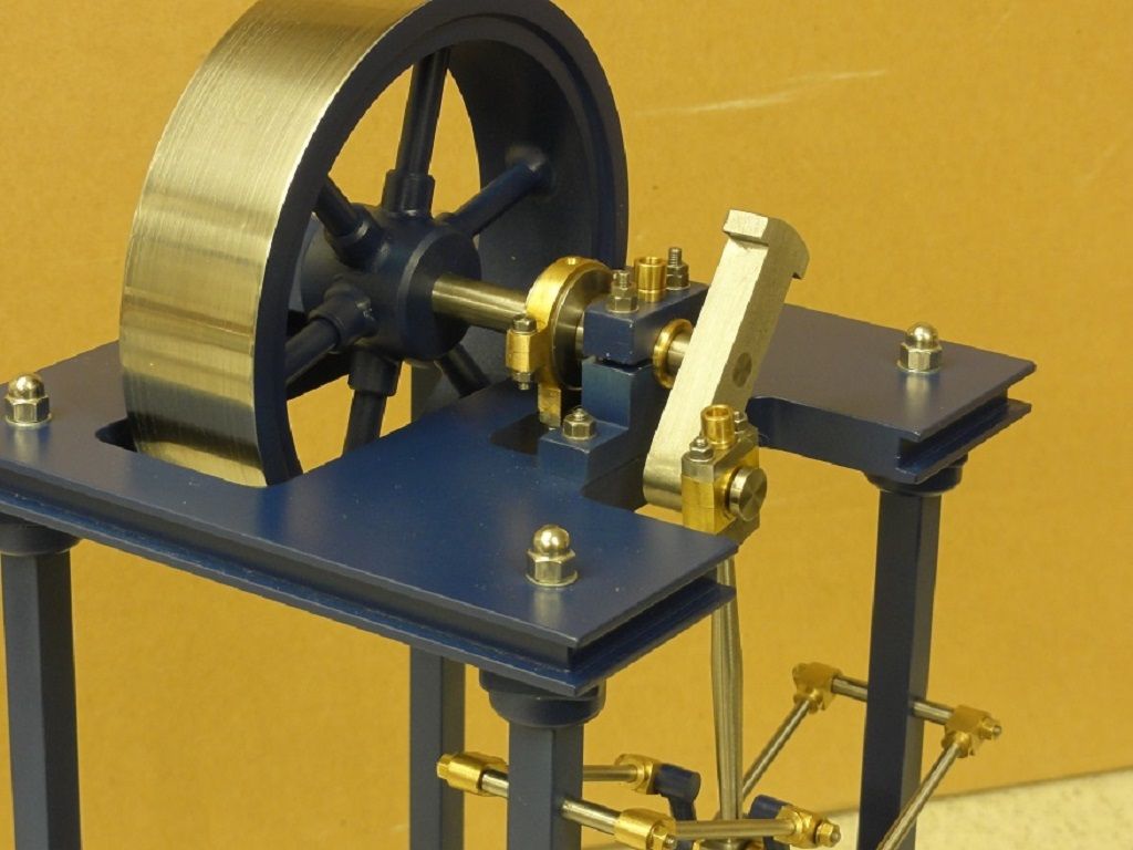

      It runs very well Jim, a lovely model, excellent detail.
      Just looking at the flywheel which I assume is cast iron, super outer rim finish, what's the secret?
      What does a stroke of 15mm by 20mm mean?
      Geoff
      It means the cylinder is 15mm inside diameter (bore), and the piston has a travel of 20mm (stroke).

          Geoff
          To achieve the distinctly non prototypical polished rim on cast iron flywheels, after machining them to size and painting them, I mount them on a mandrel the same diameter as the crankshaft and chuck them up in a 3 jaw chuck on the lathe. Then it's a matter of turning it at a slowish speed (250 – 300 RPM ) and using a file and then progressively finer grades of abrasive paper until a smooth finish is obtained and finally finishing off on a buffing wheel.
          Before I made my buffing wheel I left them on the lathe and used Solvol Autosol automotive metal polish. This is not recommended, being a bit risky in the event the polishing cloth catches in the chuck.
          Jim

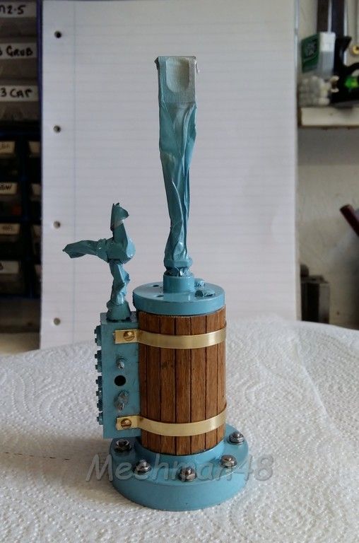

                        A little more done on my Vertical Cross, cladding & banding… may have to trim banding a little more, it clears the inlet flange ok, possibly trim the length a touch more, I leave the masking tape on to ensure paintwork has hardened up plus allowing for any touch ups… looks ok with the light blue…
                        George.

                          Hi Jim,
                          Yes this method was great Jim. I've just done a stuart flywheel finishing with 1200 grade wet or dry using light oil as a lubricant.
                          A final buff and it's come up a treat.
                          cheers Geoff

                          mechman48
                            @mechman48
                            … 'Yes this method was great Jim. I've just done a Stuart flywheel finishing with 1200 grade wet or dry using light oil as a lubricant.' …
                            ​I've just polished up the flywheel for my Vertical Cross today using the above method ( inc.1500 grade ) & it has turned out very nicely, not a mirror finish, but far better than machined cast iron.

                                  Did a pre-run reassembly, looks ok if I say so mesel', just need to reset timing & bit clean up…
                                  Bit of polishing up on Flywheel…
                                  Re-assembled …
                                  George.

                                        ​She do… albeit a tad noisily, had a pee about getting the timing right… again! but it's sorted, am sorting the video out onto you tube my channel so will link onto here… hopefully dont know
                                        ​George.
