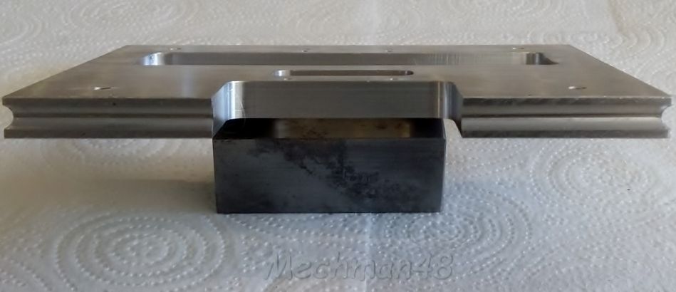

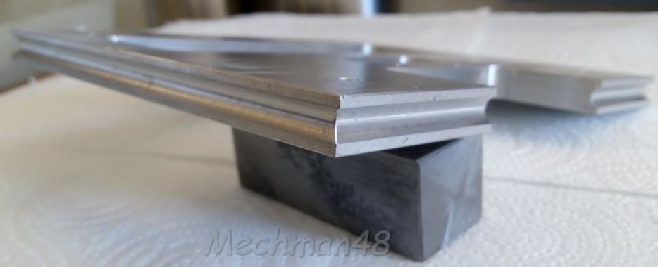

      Decided to do a bit of decorative machining on the entablature of my VS Cross, thanks to an idea from Jim Nic…59.vscross machinng decorative groove (4).jpg

            That looks good George (but then, I would say that wouldn't I?)
            How is it running now?

              Thanks Jim; it was running not too bad on trials ( see video ) have a couple of air leaks top & bottom cylinder covers, can be sorted with paper joints. Have started stripping it down for titivating here & there, cylinder cladding to do, looking at combining exhausts into single manifold ( similar to yours ) plus other bits 'n' pieces, as one does so…

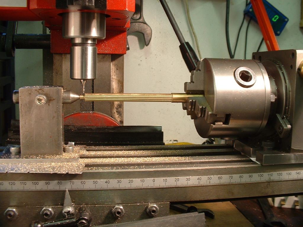

                    NBice work Jason, a bit more ambitious than my fluted pillars…

                      What, preparing early for this year's candlestick challenge?

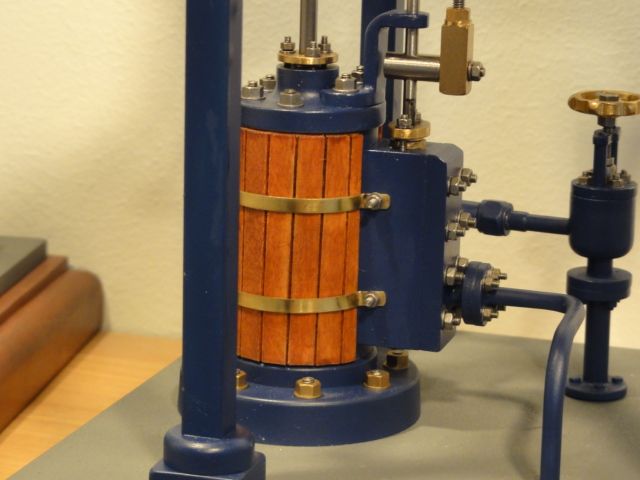

                        You may have to do a bit of head scratching to combine the exhaust ports on your Vertical Cross because looking back I see you have done them to plan and put them on the side of the valve chest. I had planned to combine them from the off and so put mine in the face of the chest so that a simple cover plate and some longer studs made it easy.
                        The additional cover plate has a shallow groove in the back covering the 2 ports and then a hole through from the groove to the front with a connector flange silver soldered in.

                          Noted already Jim thanks, churning the grey matter over as to which way to go also considering that it would be awkward to fit cladding banding on as well… ho hum, never mind, there's always an answer somewhere, just arriving at it takes a fair bit longer these days… thinking … thanks again for your help along the way.

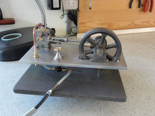

                              Plumbing done on the Rocking Valve engine:
                              And, hopefully, a bit of video of the first run:
                              https://youtu.be/wc0bhx2L9lo

                                Looks good, I've not done an engine with a rocking valve but do have one drawn up ready to make.

                                  The engine was straightforward to make and the valve operation was simple to work out as I could see it through the air inlet. The only puzzle for me was when I came to the first run, it didn't. The air just leaked right through the engine and out of the exhaust. After a bit of head scratching I fixed it by fitting the piston O ring which I had left off for the trial run.

                                    Nice work Jim, an interesting design.

                                      Yes, agree with Neil. Really nice work, caught my eye this engine, unusual. Well done Jim.
