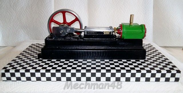

          Final tidy up of S50, still haven't decided about cladding the cylinder… dont know
          ​Ho hum… what to do next…thinking
          ​George.

              Thanks Neil.
              ​Hmmm; where have I seen this before, somewhere on YouTube methinks…. eezy peezy now I have the hang of it … soon knock off a scale model in a month or two… yeah, I know, in my dreams…face 22
              ​George.
              #299837
                I think a Mr Carney may have already done that one so you will just have to find something else to modelwink

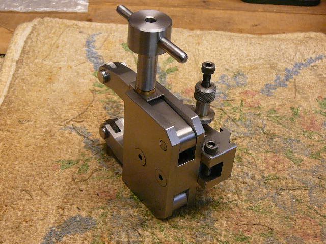

                    A Finished Project
                    I started a Hemmingway kit for a knurling tool a couple of months after my daughter was born and now I've finished it (just about). I'm really pleased because I'm able to show it to her before she goes to university in a few months.
                    I know some jobs can take a while but………
                    Looking at it now I can see errors left right and centre but I've left it as each part was done, the supports made 18 yrs ago, arms 15 etc.
                    I thought about tidying it up a bit but I quite like it as is because it gives me physical proof that after all these years my skill level has hardly improved one iota.
                    Never mind, I can start another project now, just hope I can see it out!
                    Knurling Tool
                    Knurling Tool

                      Hello Paul, you need to find a project with some knurling. I must say, it looks a nice job and, if it works ok then no one can fault you.
                      Brian
                      #300182
                        Looks OK to me, Paul.
                        What will your second project be?

                            What worries me Neil is that have I got time to complete a second project given past history? wink
                            Paul

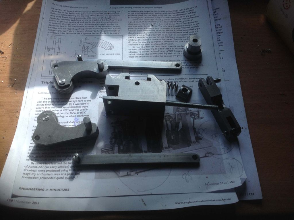

                                Had a change from teh big lumps of the Otto Langen and spent my workshop time this weekend doing the small parts for teh Root & Van Dervoort's ignitor. Just need to remember where I put the 2.5mm dia tungsten rod so I can complete the ignition contactsembarrassed
                                Edited By JasonB on 04/06/2017 17:45:03

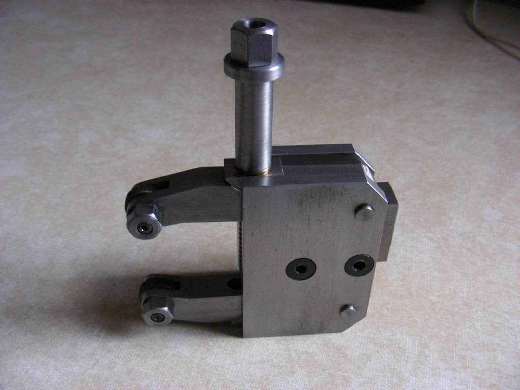

                                  I made the Hemingway knurling tool some time ago. In use I have found the tommy bar on the adjusting nut tends to foul the chuck and have finally got round to making an alternative nut with hex head which is tightened with a suitable socket spanner.
                                  In my version,the pins on which the knurls rotate are made from broken HSS screwed shank endmills.
                                  #301208
                                    Useful design improvements, ega yes
                                    #301213
                                    Joseph Noci 1
                                      @josephnoci1
                                      Trying to make one of these Knurling tools myself – not a HW kit though – to costly to ship to Namibia!
                                      ega, how do the knurl pins work in your implementation? I see a great big nut on the left side – what is on the other side to keep the pin in place? Also, do the big nuts not foul the chuck or prevent knurling close to the chuck or a shoulder? Seems the nuts would prevent getting to close to the chuck by a degree that makes removing the tommy bar superfluous or have I missed the point..
                                      Joe

                                          Joseph Noci 1:
                                          Knurl pins: these are screwed into the near side of the arms and prevented by the nuts from unscrewing in use. I made the nuts of a thickness to match the projection of the end mill shanks – the centres in the ends of these can just be seen in my photo – and I agree they could usefully be reduced so as to allow the knurls to work closer to the chuck. I did think of trying Andrew Johnston's idea of turning off the surplus hardened HSS with a carbide tool but wasn't quite brave enough!
                                          The Hemingway design (quite possibly now updated) specified a simple knurled knob to the nut but indicated that a tommy bar might be needed for heavier work. Might it be worth your asking Kirk Burwell if you can buy the drawings alone?
                                          The photo is in my Miscellaneous album; I may upload some of the tool in use. Meanwhile, I look forward to more photos from your laboratory by the sea.

                                            Posted by ega on 05/06/2017 09:24:17:
                                            Is it possible to put the nuts on the other side, ie thread the right side of the arm for the pin  or as it is already made swap the arms (assuming the arms are identical) then there is no extra width on the headstock side.

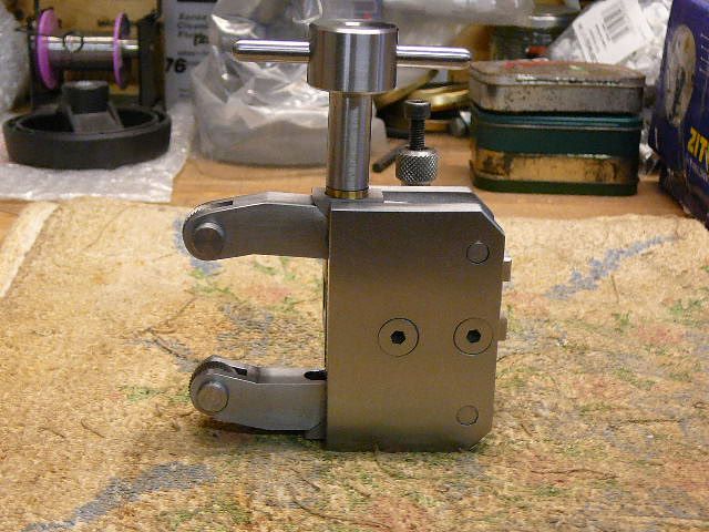

                                              I made a knurling tool to a Graham Meek design. The knurl wheels are loaded mainly in shear, so I "temporarily" located them in the fingers by staking (not shown in the photo, below). That was several years ago and I've never got round to improving the method, although, now that I've changed my QCTP, I need to mill off the mounting, which I incorporated into the main body of the knurling tool and fit a plain, square bar. I will maybe make up some new pins with thin retaining grooves for circlips. At least, then, I'll be able to change wheels easily, something for which I've not yet found the need.
                                              knurling tool - exploded view
                                              knurling tool

                                                  Journeyman:
                                                  "Is it possible to put the nuts on the other side …"
                                                  Thank you for this excellent piece of lateral (?) thinking. I just went into the workshop and swapped the arms and will test the operation shortly.
                                                  This idea did actually occur to me but I rejected it because I was aware that the arms are handed; I hope this will prove to have been premature and, in the meantime, please consider yourself promoted to Master!

                                                    Posted by ega on 05/06/2017 13:16:55:
                                                    Journeyman:
                                                    I are much honoured smiley but best make sure it works before I pin the certificate to the workshop wall!

                                                      PS:
                                                      I notice that HasBean's tool has the nuts on the side away from the chuck and the photo on the HK website has the same. The drawing I worked to, however, indicates that the nuts go on the chuck side and it seems that I blindly followed this. There is a lesson there.
