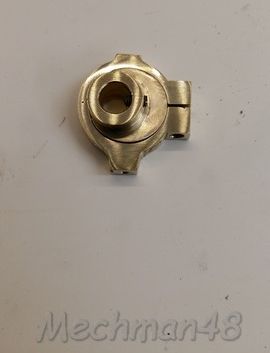

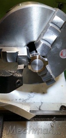

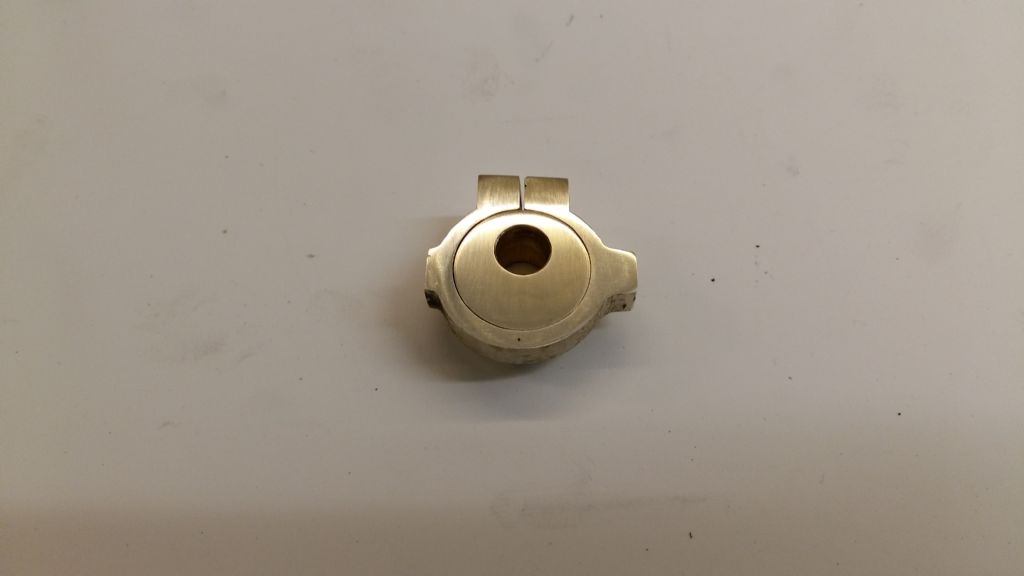

              S50 some more…
              ​Machining eccentric
              eccentric & strap polished up…
              eccentric assembly…

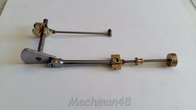

              ​Crank, eccentric, valve rod, piston, crosshead assembly
              George.

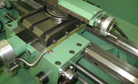

                  whoop took delivery today of a lovely little sieg sc2 lathe from Ketan and the team at arceurotrade really good service from them, 3 days from ordering to the well packed sturdy wooden crate being passed to my mucky dabs.
                  ive not done much apart from unpack at the moment, tomorrows job after work will be cleaning off the packing grease and lubing her up wink 2​ then onto mounting upon the made from salvaged wood bench

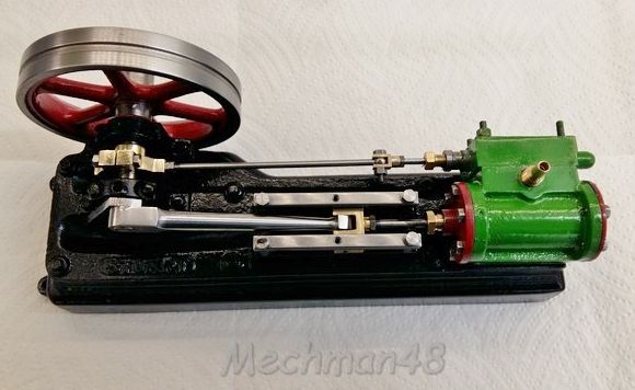

                        Nearing completion of my S50, sprayed up the castings, dried over a couple of days, then pre-trial assembly yesterday…
                        Steam chest faces to clean up, joint to fit, inlet fitting to make, check for tight spots, then to run in. Maybe look at improving the cylinder finish by cladding with stained wood… thinking
                        George.

                            Finished tweaking my S50 & gave it a final test run… runs nicely on 4 psi. Haven't decided on the cylinder lagging yet, maybe just leave as is dont know.
                            https://youtu.be/avCCVGVa7f0
                            George.

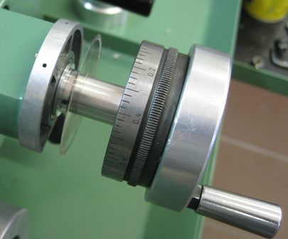

                                                      Finally got to do the Rotary Encoder for my EMCO V10 X Axis.
                                                      I have an old – 20 years – FAGOR DRO control unit with one working glass scale that I used on the V10 Z Axis, mounted behind the bed. The glass scale that used to be used on the X axis was smashed, and that's how I came to 'owning' this FAGOR unit – saved from the trash…
                                                      I decided to try and make a rotary encoder fitted into the handwheel area of the cross slide, and adapting that encoder output to drive the FAGOR Unit.
                                                      The encoder is a 1024 pulse/rev Quadrature encoder ( 2 pulse trains, one 90deg phase lagging the other). This gives in effect 4×1024 – 4096 edges per revolution. My leadscrews is a 2mm pitch, and the FAGOR unit glass scale gave 400 pulse per rev of the handwheel, ie, 400 pulse for 2mm movement ( 0.005mm resolution). So I used an Arduinio and some software to basically interpolate ( via Bresenhams, for those interested) the 4096 edges down to 400, and made the FAGOR display very happy..The whole thing is together, and works very nicely – Of course it does not measure axis movement, but leadscrew rotation, so does not take care of backlash, but on the cross slide, one tends to work in one direction anyway, even when using the handwheel dials..
                                                      milling the encoder housing to shape:
                                                      The front cover plate – yucky stringy aluminium alloy this..
                                                      The Housing:

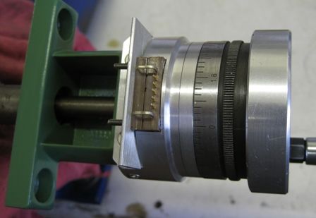

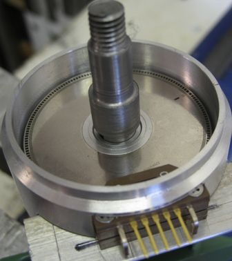

                                                      Trial fit of encoder wheel and optical sensor – also the extension to the leadscrew for the handwheel.
                                                      Trial fit without the Cover/Housing:
                                                      Coming together:

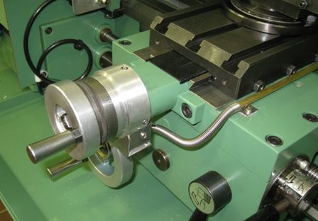

                                                      All fitted in place – Wires are routed in side two counter wound SSteel springs, and then down a brass tube,
                                                      over the saddle to behind the bed, and then to a flexible armoured cable to the Arduino.
